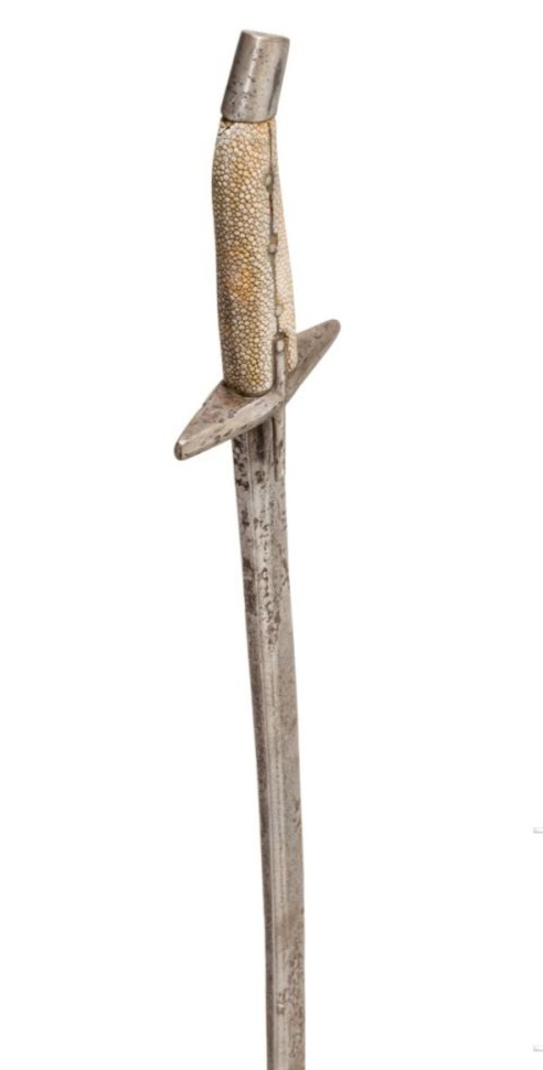

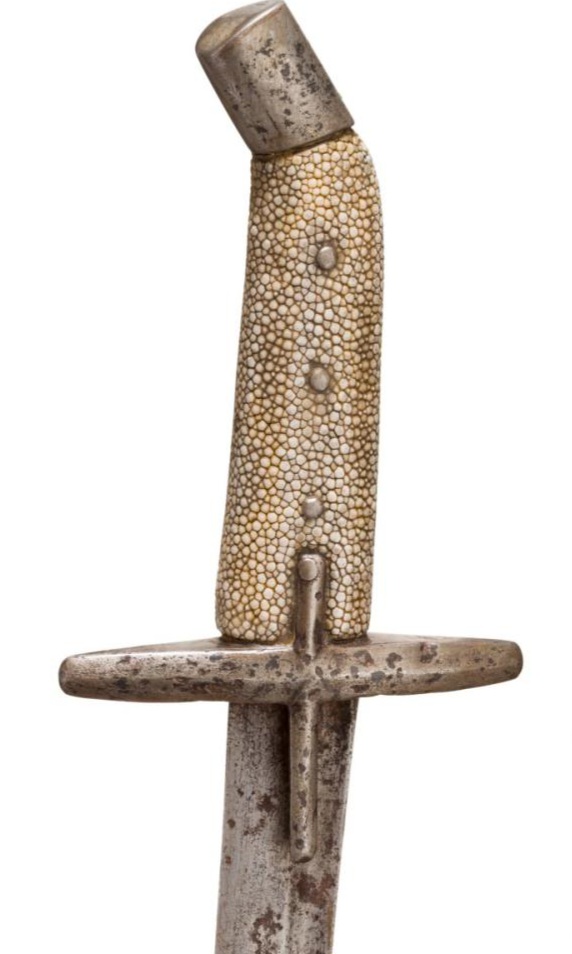

Hello dear members,
What do you think of this sword,
Said to be moorish from the 13th century.
Original ?
Strange the shagreen covered hilt, later replacement ?

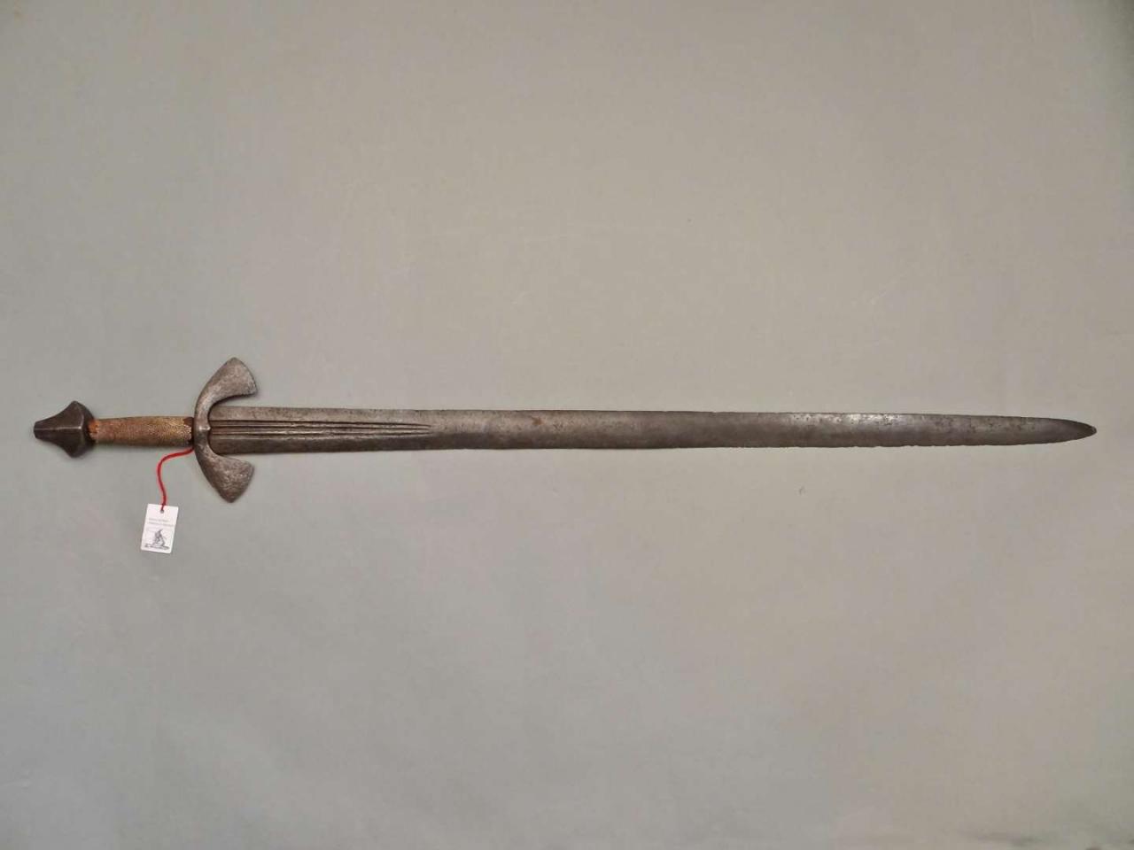

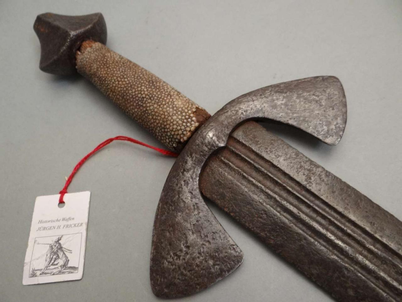

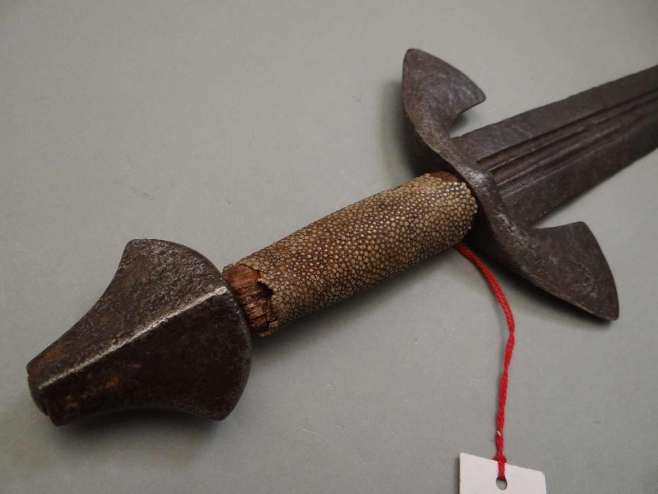

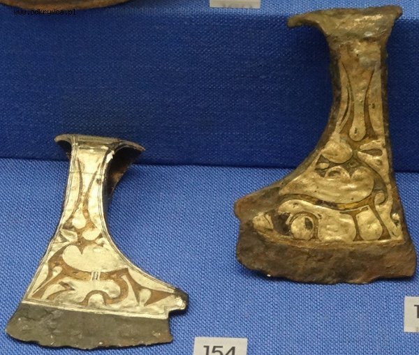

That one has been on the auction circuit for a while - the claimed origin has changed apparently. I do not think it is genuine, but it purports to be a distinctive Baltic type of hilt, from the area of Lithuania and Prussia. Several are decorated in a very particular style, as on this example in the Bargello Museum. (Note that here the Baltic hilt components have been combined with a much later blade.) The same style can be seen on a number of rare axe-heads. Vytautas Kazakevicius' book IX-XIII a. Baltų Kalavijai has more information about these swords, which he calls the Desiukiskes type, after one of the find-places.
Size:  205.3 KB Name:  Poznan, Arch. Mus. - Zagan, Gubin.jpg

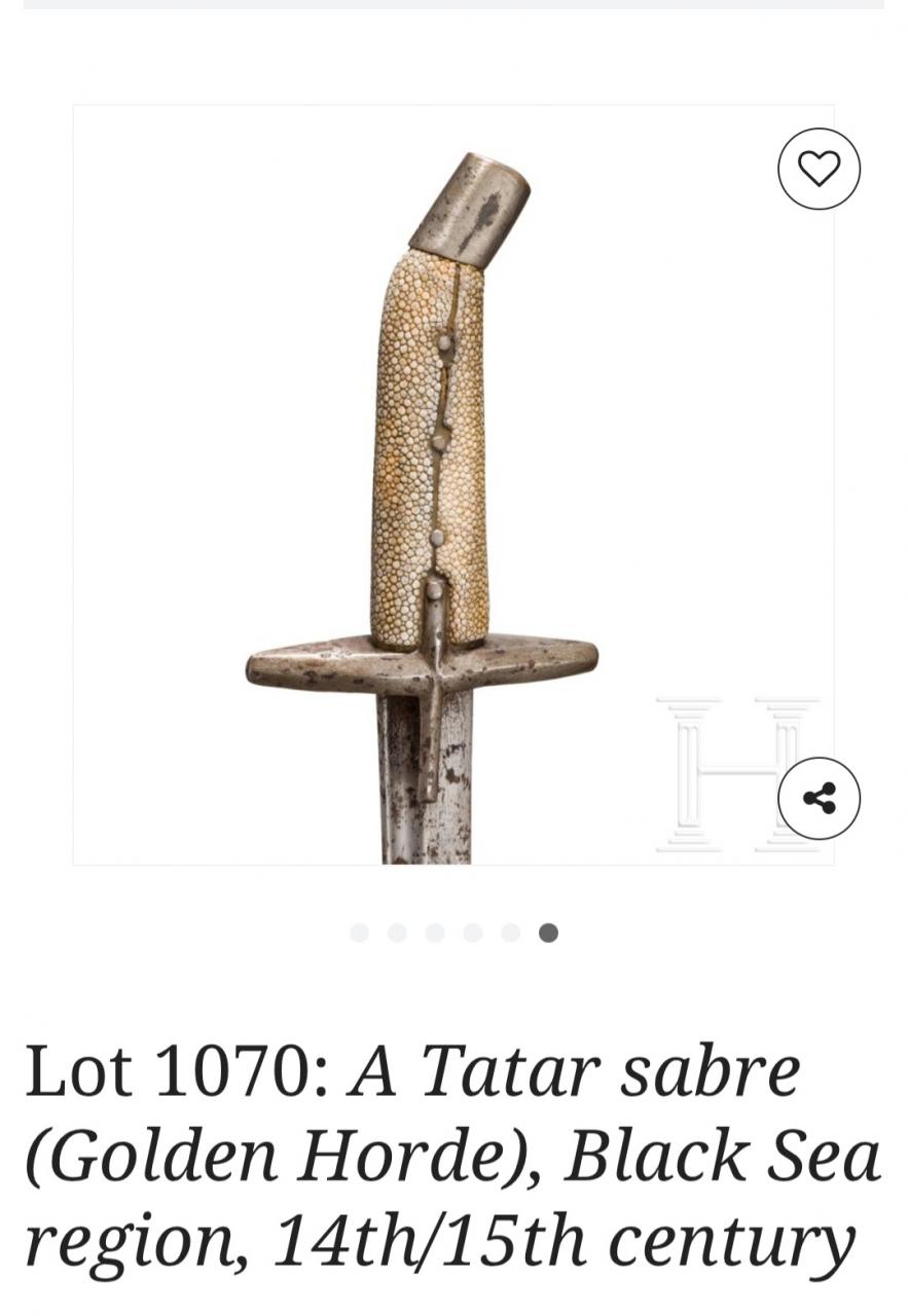

Regarding handles covered in ray ( or shark ) skin swords:
We are used to seeing katanas and other Japanese swords, recent and very old,as well as Chinese ones.
Personally, I appreciate the grip in hands, which combines practicality and pleasure: aesthetics, durability, and a non-slip function.
It seems to me that the connection with Europe is through the east, with the Tatars.
I found a particularly old sword here.
Perhaps the dating is also exaggerated...
I found others dating from the 18th century.
This style wasn't very popular in Europe.
If I'm not mistaken, we have to wait until the 19th century, especially in France and England, to find models again with a handle covered in ray or shark skin.
