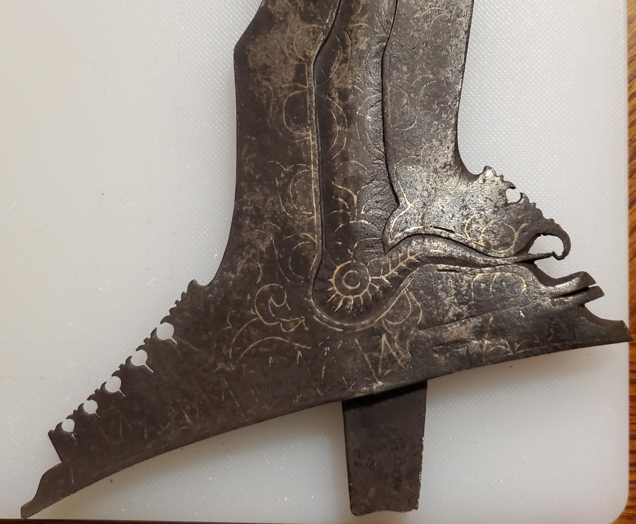

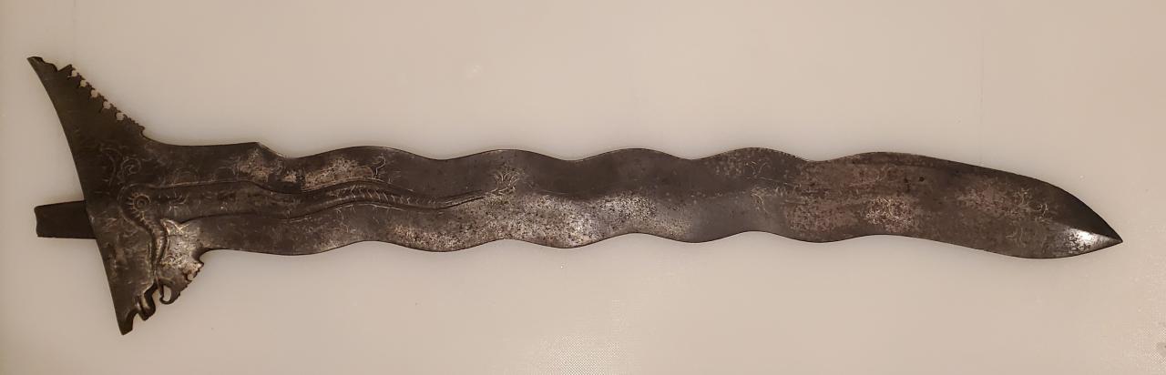

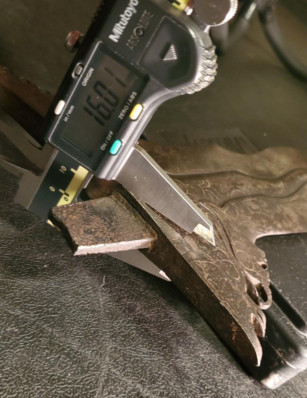

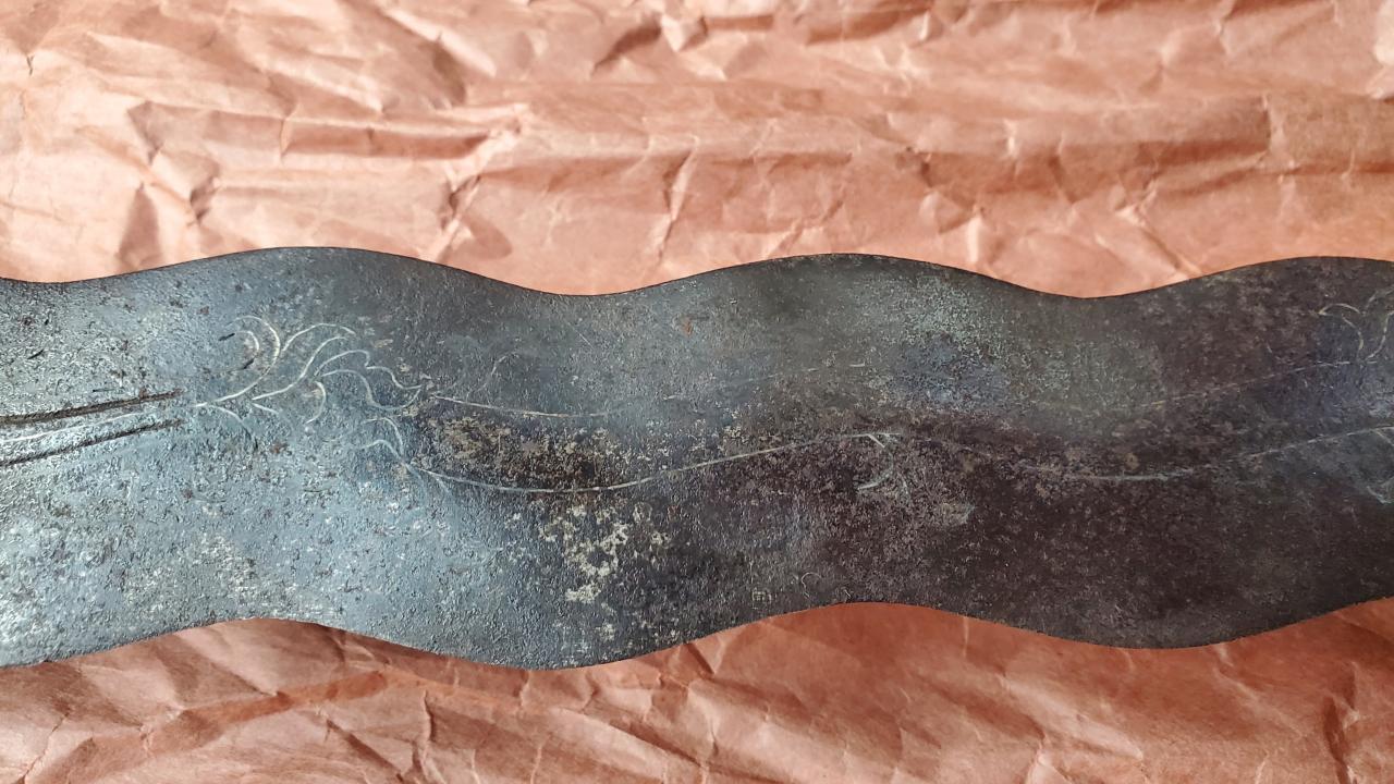

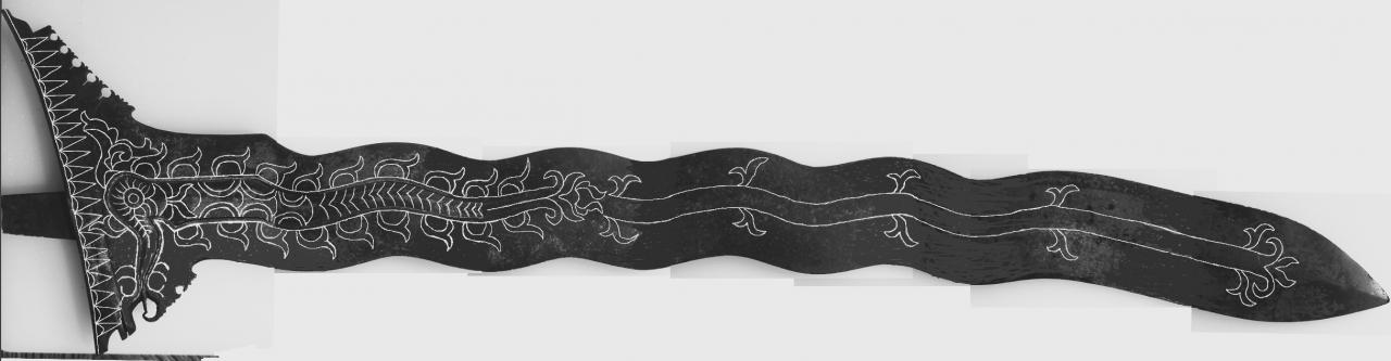

Hi all. New here and looking for advice/opinions on my keris. I inherited this from my father several years ago, and despite much research, I cannot find any published examples that are truly comparable - particularly the inlay. I'm hoping someone here has some insight. If nothing else, I hope you all find this half as fascinating as I have.
Details:
1) Luk-11, blade-only (no ukiran, waranga, etc.)
2) Weight: 1,023 g
3) Length: 57.3 cm (not including pesi)
4) Blade Width: 5.4 cm at luk-1, tapering to 4.6 cm at luk-11
5) Blade Thickness: 0.60 cm at luk-1, tapering to 0.44 cm at luk-11
6) Ganja Width: 15.8 cm
7) Ganja Thickness: 1.60 cm (at center)
8) Inlay: Both sides of the blade contain the same, intricate inlay (kinitah?) that extends from ganja to tip. Inlay material is almost entirely present, but the few voids present reveal deeply cut channels (~1.5 mm).
I believe this to be from central Java, possibly late 18th century, but that's I brave to speculate at this point. Any info or questions are welcome.
(Note: Final photo a sketch-over, intending to show the full inlay design clearly.)
Thank you,
another_rick
Last edited by Rick; 18th March 2026 at 04:33 PM. Reason: Moved to Ethnographic forum, Kris not Keris

Hi Rick, welcome to the forums. As noted at the bottom of your post this has been moved to the Ethnographic forum.
This Kris is from the Philippines, not Indonesia and is from one of the Muslim Moro tribes.
An Ethnographic forum search using KRIS will provide lots of examples and information on of this type of sword.

Welcome to the forum! Like Rick noted, it's a kris from the Philippines, around 1900 would be my guess. I think it's from Mindanao but I am not sure but we have members here who will be able to tell you more.
You need to clean the blade from rust, the blade will benefit from a good clean-up. To restore it to a complete kris would be what the most of us here would do, adding a fitting handle and clamps would make this a beautiful kris, the blade has beautiful inlays! The inlays have a talismanic purpose. See here for kris with talismanic inlays: http://www.vikingsword.com/vb/showth...ght=kris+inlay

Welcome to the Ethnographic Forum! As Rick has noted, this is an example of a Moro kris. It has a complicated inlaid pattern that is very unusual.
I don't think this is an 18th C blade, but rather late 19th or even early 20th C. judging from its width and the way the terminal luk and tip have been constructed. The dark patina and mild surface pitting suggest that the blade has not been well maintained over the last century or so.
Of note is the very short tang. It is possible that this is a broken tang, but short tangs such as this one were made that way on some early 20th C kris. I do n ot see a separate gangya, and the tang has been welded directly to the gangya rather than passing through it. Again, this suggests 20th C work.
We need some help from our Filipino colleagues to explain the significance of the motifs on this blade. Some of them appear to be influenced by a naga (snake).

Thanks all for the feedback.
I too thought the ganya was separate and agree with the naga influence, hence, my original assessment.

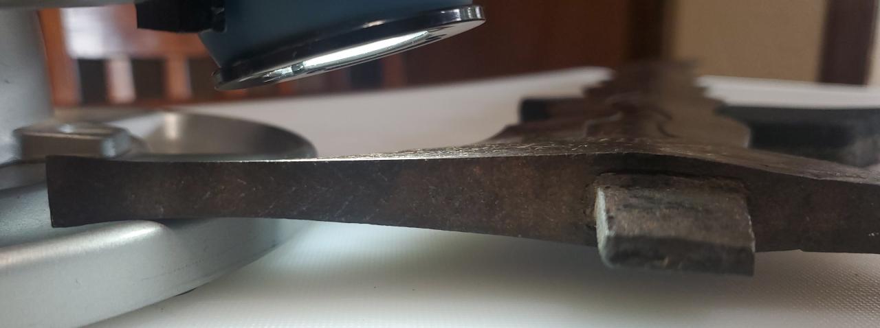

More photos of the underside with different lighting. I don't see evidence of modern welding but forging, perhaps.
The closeup (60X) is the face of the pesi/tang, at juction/joint with blade/ganya.
Thanks again,

I'm trying to figure out how the fitment was achieved at the intersection of tang and gonjo.
Old 19th March 2026, 06:37 AM   #12
another_rick
Join Date: Jan 2026
Location: Washington State, USA
Posts: 11
Me too. Here's another angle.
To my eye, it passes through the gonjo. The tang thickness steps down after emerging from gonjo, and there is heavy peening on that fillet, all around. (I think this is what's getting confused for weld marks.)
Is there a way to confirm this one way or another?

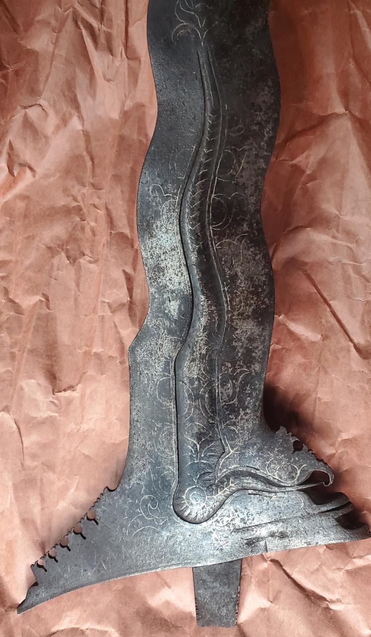

Because I can't leave a debate unsettled, x-ray is below. Separate ganya, yes?

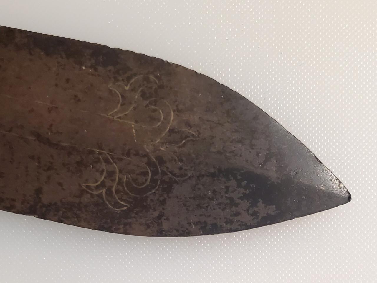

Also, I spent a few minutes cleaning the blade. Some photos are below, as well. Feedback welcome!
Thanks again,
another_rick
another_rick is offline   Reply With Quote
Old 17th April 2026, 03:12 PM   #26
Posts: 4,719
There you go Rick! Clearly a separate gangya.
The X-ray removes any debate. Did you lose the elephant trunk in cleaning it. It seems to be missing on the X-ray.
Nice picture.

It came out very nice, with almost complete inlays intact!
Interesting to note, the elephant trunk also is a separate peace, like most probably the one in #21.
