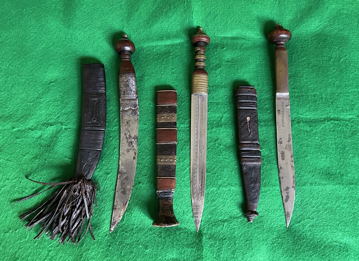

There is a tendency to label every West African dagger as Mande. Not sure is this is always correct, but I do believe the group of daggers shown here is indeed Mande. This is still a very broad definition, similar to labeling something as Slavic or Turkic in a way, so it would be great if at some point we can do a little better.

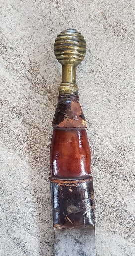

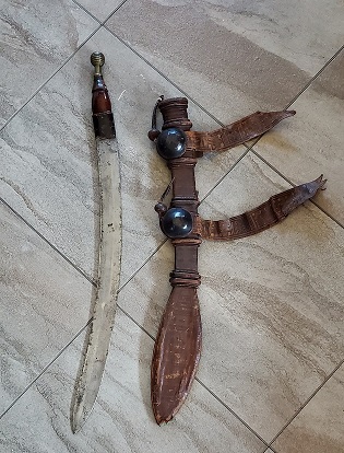

This is an excellent topic Teodor!!! and it is indeed perplexing when trying to classify these areas of African edged weapons by using such a broad brush. With my very basic understanding of these weapons, mostly I am familiar with the familiar sabers with open hilt and knob type pommels. I have one (pictured) and I have always regarded it (and the type) as Mandinka, from Mali regions.

One of the most notable features of the Mandinka saber that always intrigued me was the FLARED SCABBARD TIP, very much like those on Sudanese kaskara. I always wondered why this feature became situated on these sabers of the Mandinka, but were inherent to the Sudan, exclusively as far as I could find.

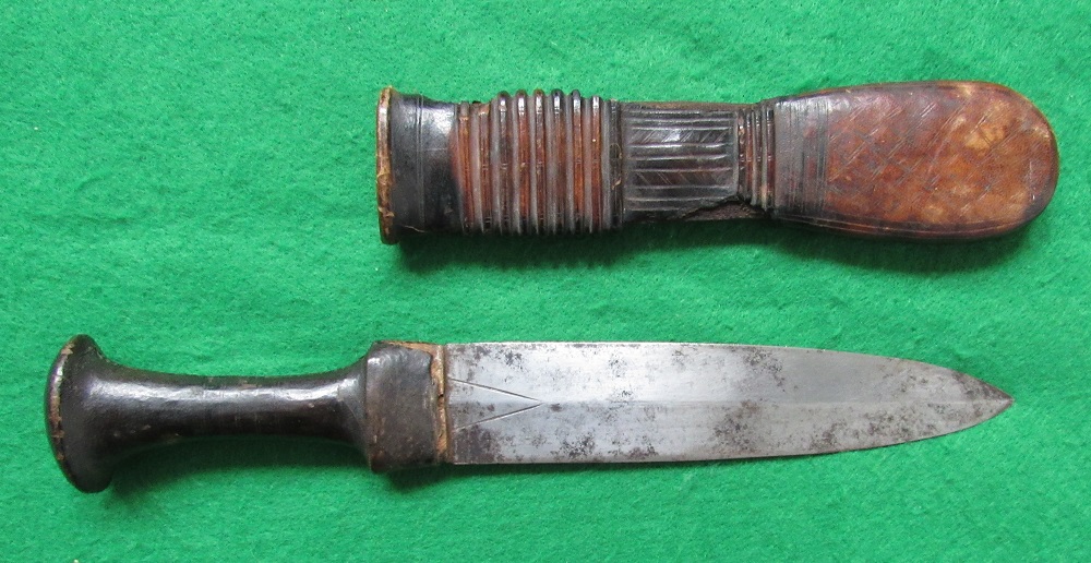

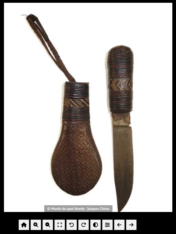

In "Panga Na Visu", the first dagger shown is similar to the group in my opening post. The second is one with a flared tip scabbard. I have one of these as well. A knife in the Quai Branly with a similar scabbard is described as Wolof, from what is nowadays Senegal and Gambia.
