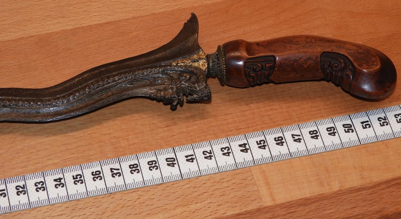

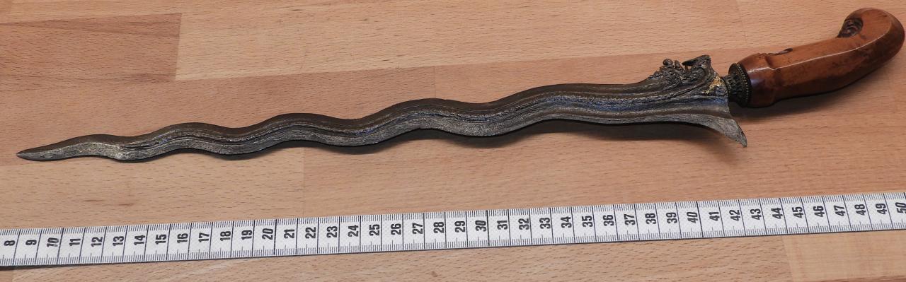

Question Introduction and Assistance request - Naga Sasra 11 Luk?

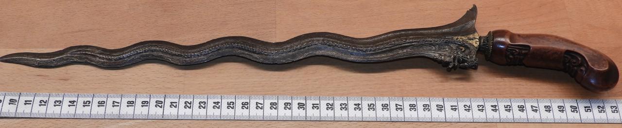

Hello dear Vikingsword community and especially hello dear Keris enthusiasts,
thanks for having me in your community As this is my first post, a few brief words about me. I like collecting beautiful knives and swords. Not necessarily for their historic value, but because I think they are pretty. Think Manfred Sache, german damascus steel smith, for example.

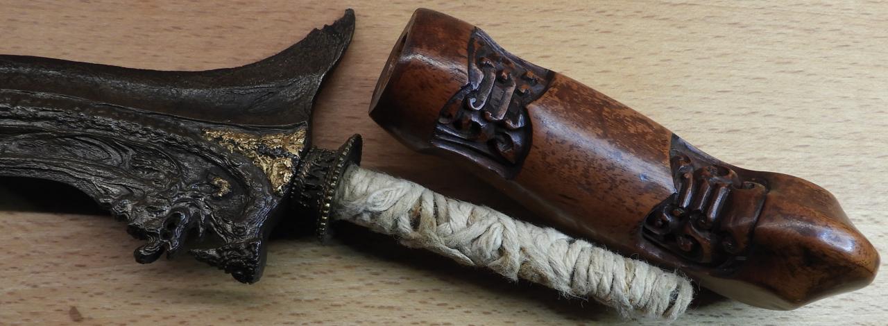

Around 30ish years ago, I bought a Keris at a knife fare. I just thought it looked pretty, it was a nice wavy dagger that seemed pretty old and it was an example of south east asian steel that looked a bit like the damascus steel I so adore. The Keris has been in my possession ever since, but I never really bothered much with it. However, I have recently decided to research its history a bit... and have discovered that this is an incredibly complicated topic :O In my search for a community passionate about this subject, I have stumbled across your community. I thank you in advance for the chance to present this Keris to you and I hope you can help me gather some information about it. My preliminary research has taught me that this might be called an 11 Luk Naga Sasra Keris? However, please note that I am incredibly new to this field of research. I am sure, some trained eyes can immediately see a lot of things that would take me years to find out. So: thank you for lending me your trained eyes
Any information will be appreciated If more pictures might be helpful, let me know!
Thanks in advance
Jay

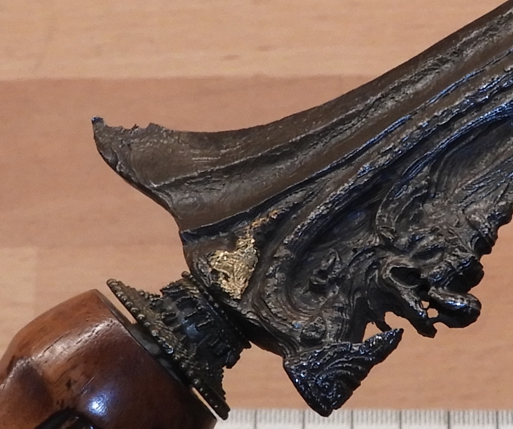

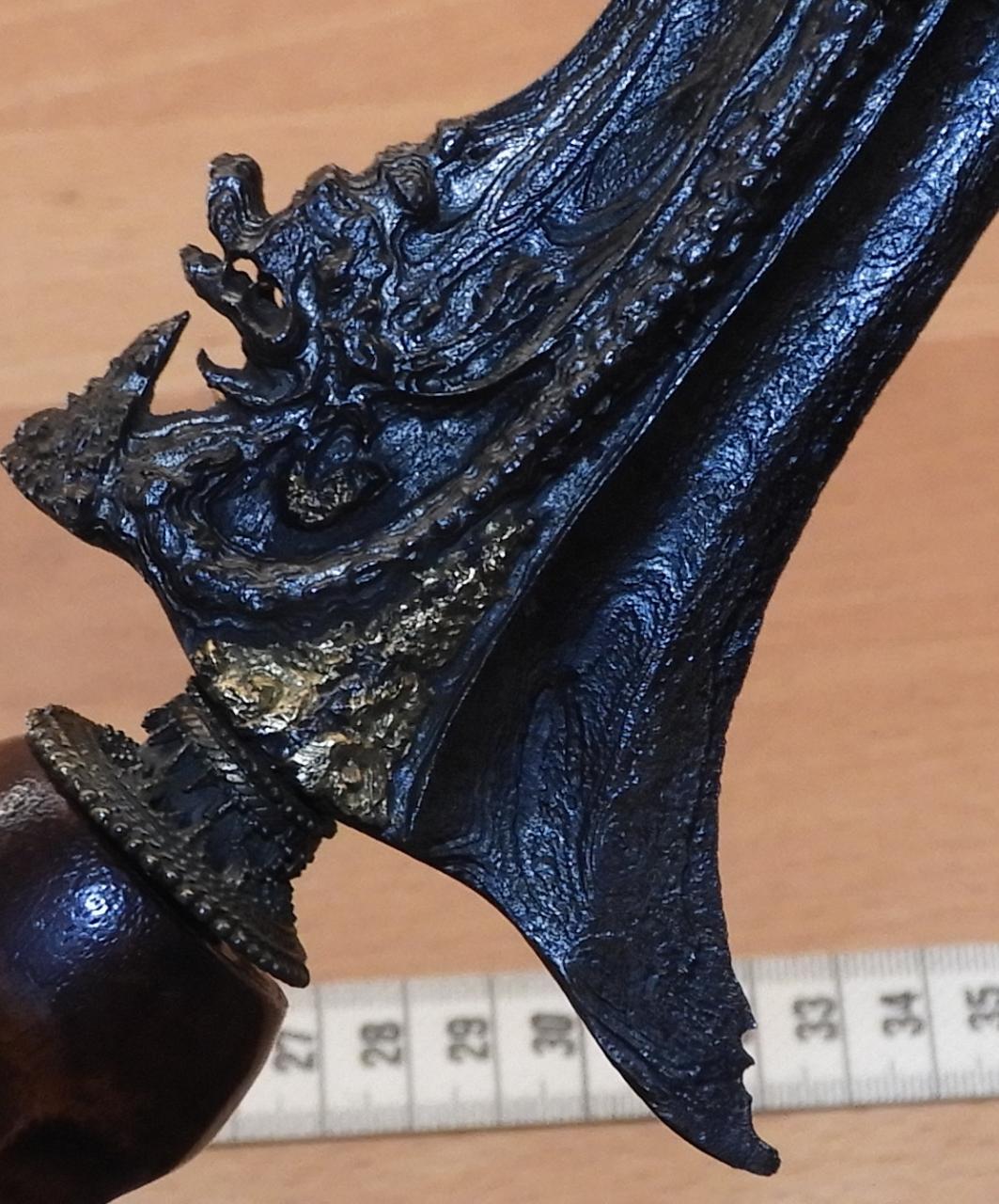

I think the Gonjo is missing on this blade (no Grening* to speak of).
The Gonjo is a separate piece that fits on the base of the blade and follows the same humped curvature and usually carries the file work *(Grening) that is seen on the trailing edge of the blade as below..

Yes, I would accept Naga Sasra, luk 11, as an acceptable description, probably originally in Jogja ( Jogjakarta, Ngayogyakarta & other spellings) dress. This form is often associated with the late Mataram period, +/-1700 & later, it is not possible for me to give an opinion on age from photographs.
As Rick has noted, the gonjo is missing, in Jawa it would be a simple job to have a replacement made, outside of Jawa, if one cannot make it oneself, it is best left as is.
Not a bad keris, does it have a scabbard(wrongko, warangka)?

Yes, the gonjo is definitely missing. The keris is exactly as it was when I bought it (except for some camellia oil treatments). So sadly I apparently bought it without a gonjo... as I am rather far from Jawa, I suppose it will have to stay this way a while! It also came without a scabbard, what you see is what I got. As I said I just thought "nice wavy dagger" for decades... feels a bit silly already after just a couple weeks of research (felt silly after a single day of research...), but hey, at least I can start finally appreciating it properly now, better late than never! It was the last piece in my collection I knew nothing about, but it turned out to be one of the most interesting pieces.

Hi Jay. Welcome to the forum. It is a shame that the gonjo is missing from this keris, but it is still a nice and authentic naga keris. Just to be clear, what i believe Alan was getting at when he stated that he could not give a good opinion of age based solely on the photographs is that this is a form that, when made correctly, has maintained a very exacting form since it's introduction into the keris world sometime +/- 1700. I would not think youyr particular example to be as old as 1700s, but it would probably be safe to say it is at least antique (100+ yrs. old).
To understand this keris better you may want to acquaint yourself with the symbolism and significance of the naga/nogo within Javanese society of the period. Naga is often translated as "dragon", but it is more serpent-like than a dragon. Though i generally hate AI overviews, i will present one just to give you an introduction into what can be a very complicated and dense study.
"In Javanese society, the Naga (serpent) is a potent, syncretic symbol representing a combination of ancient animism, Hindu-Buddhist cosmology, and, later, Javanese royal identity. As a "crowned giant magical serpent" (sometimes winged), the Naga acts as a guardian of treasures, a symbol of fertility and water, and a stabilizer of the world."

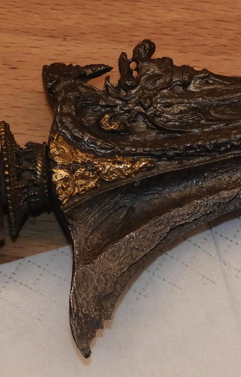

Like many Naga Sasra blades, yours is decorated with gold embellishments, something known as "kinatah". These embellishments can sometimes be vegetal and at times zoomorphic, presenting animals such as deer, elephants water buffalo and mythical creatures. Traditionally it can be used to denote status or rank or added to a keris as a reward for service to the keraton and the Sultan.

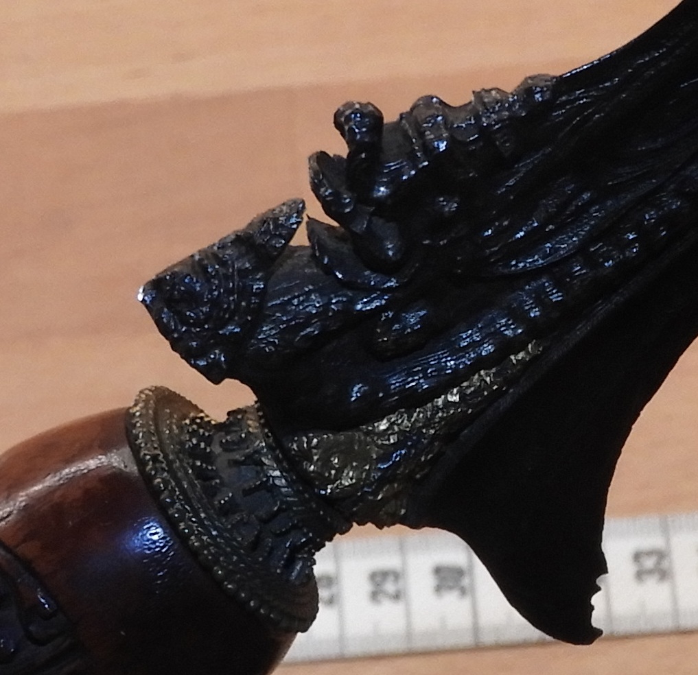

Since I received the first comments I went looking around a bit more... The rabbit hole this keris has led me to explore is getting deeper and deeper, very fascinating! It has also taken a weird turn by chance... another user mentioned a Pangeran Diponegoro today... never heard of that guy either, but basic information is available about almost anything these days, including him. Interesting figure for sure! It also mentioned a famous keris of his that has been returned to Indonesia from the Netherlands. Never heard of that before either, but I'm sure you have. I went to have a look at that keris and I felt pretty weirded out... to my untrained eyes, it looks very similar... although with the gonjo intact and in much better shape... hardly any gold left on mine.
Any plausible explanation for that? :O

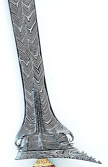

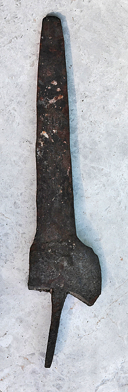

All of the details in a keris are carved into it, not forged into it.
Iron & steel are actually pretty soft after they have been annealed, & not at all difficult to carve with the correct traditional hand tools. These days most makers use electric tools for the carving, but you can still carve pretty quickly just using the traditional tools.
The picture is a keris forging as it has come from the forge. This is what we start with.
Yes, the naga here does have a crown, that's one of the things that makes him a Naga Sasra.
As for learning, well, there is no end to that. I've been studying the keris for over 70 years & I've only scratched the surface of what there is to learn.
There are many aspects to the keris, & study of it must go hand in hand with the study of the related culture & society.

Is there anything more one of you can tell me about the pamor pattern on my keris? It is sleeping under the patina, but I think due to the groves from the etching it should be visible enough maybe to give it a name? I can't make a guess, this is so new to me... But as I said, I'm in it for the patterns I'd appreciate a Bob Kramer knife as well, not that I own any. I do not want to direspect keris in any way, just pointing out my usual interest would be "pretty damascus steel patterns". Hence my special interest in the keris pattern If any more pictures would be needed to better judge it, I'll be happy to try and provide better shots

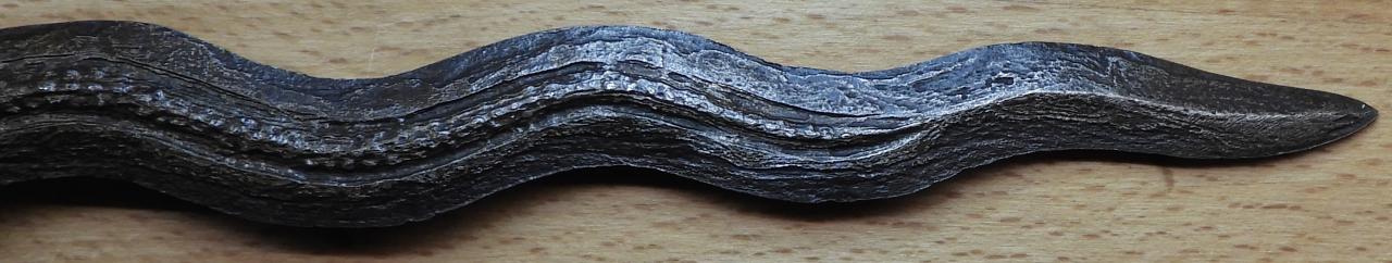

The pamor motif of your keris appears to be a random motif, something that we call "beras wutah" (wos wutah) = scattered rice grains, the talismanic value of this motif is that the possessor will never know want, he will never go hungry. It is the most common pamor motif. Keris blades that have been heavily carved with nagas or some other enhancement very rarely have complex pamor motifs.

I would most definitely remove the wrapping on the pesi, lightly clean & oil the pesi, and replace the wrapping with knitting wool.
Thank you very much I am reading through all of your website and this is among the first I looked at, it is very fascinating! I feel very grateful such a knowledgable person is answering my newbie questions. I feel like talking to the David Attenborough of the Keris world.
If you seriously do not mind, I would probably have dozens of questions to ask, but I really do not want to waste your time. Thank you very much for your insight on the pattern. I guess it makes sense to not use an overly complicated pattern, it would distract from the nagas central role? I am in my mid 40s, married and with children, so I would fulfil those basic requirements I would not be able to be taught the way you have, married with children means my main responsibilities are elsewhere... but when interested in a topic, I try to study it thoroughly.
If I judge your approach correctly, you might think "he posed questions before that he has not yet received answers to. If he thinks these questions are important, he should ask them again". You were right, I asked about the pamor again and you once again gave me an incredibly insightful answer So let me pose the other question that I haven't been able to find the answer to yet... what is my naga "holding"? Could you give me an insight on what the pointy thing below his mouth is?
Thank you so much

The pointy thing below the Naga's mouth?
I do not think that our naga is holding it, based upon what I believe I can see in the photos I think it has a couple of functions, firstly, it occupies a position that would be taken by the gandhik if the Naga had not already taken most of that position for his head, secondly it is in a form that might well be able to be interpreted as a representation of a meru, or tumpal , these motifs represent Mount Kailash, abode of the Gods, resting place of the ancestors before they merge to become one with their own personal deity.
The meru has the nature of a shrine, the tumpal is only the name of the motif, but that tumpal motif relates to the meru & of course to Mount Kailash, these come back to the gunungan , gunungan from gunung, gunung = mountain, all mountains are related to Mount Kailash & are thought of as sacred. Mountains in turn can be thought of as not only related to the Gods, but to Siwa (Shiva) in particular.
The lower slopes of Mount Kailash are covered in foliage and these forested slopes are the home of Bhoma, son of Dewa Wisnu & Dewi Pertiwi. He is the guardian of the boundary between the seen & the unseen world, he is a protective spirit who symbolises growth and fertility. We often find him guarding doorways and gateways, especially temples & holy places.
In the wayang, the first puppet that is presented to begin a performance is the gunungan, the other name for the gunungan is "kayon" or "kekayon", this is from the root "kayu" = "wood" but what is inferred is "tree" & specifically, one tree, which is the Tree of Life.
Now, the Tree of Life is also known as the Kalpataru. So symbolically that gunungan or kayon is also the Kalpataru Tree, or more specifically, the Kalpataru tree grows upon Mount Kailash, but Mount Kailash itself then becomes symbolic of not only the earthly meru, but also of Shiva, the Gods, the ancestors, the Kalpataru. Life itself.
If we go to post #3 in this link that Rick previously gave us:-
http://www.vikingsword.com/vb/showth...t=pamor+poleng
we can see Pak Pauzan looking at his keris with Kalpataru pamor, this pamor symbolises life.
Now, if we look closely at the our little pointy thing, I am inclined to think I can see that curling upwards from its base we can see some ornamentation that looks like a lung-lungan motif, ie, a vine motif, and this motif symbolises growth & the natural world, so, the lower slopes of Mount Kailash.
It is a good idea to remember that in Javanese culture the more meanings & interpretations that can be attached to something, the stronger that something is. There are many more ways of thinking of just about anything, than only one.

Mr. Maisey, thank you so much again for your incredibly detailed explanations. I can't pretend I can fully comprehend your answer yet, but it gives me more to read up on, which I am grateful for! The layers upon layers of symbolism in these blades are stunning.
I have many more questions, but I need to pace them a bit, have to work on the backlog of things to understand first
Going back from the spiritual side to the object of metal, I followed your advice and removed the wrapping. It seems it has been there quite a while, and there was active rust under it, so I removed this (only with camellia seed oil) as best as I could. For the first time, I could also see the white metal that I have learned to associate with the pamor, quite interesting. Definitely not a cheap fake, I can rule that out from the metallurgy.
What I find fascinating about my keris is that it has a spiritual meaning to (try to) understand, a history to research and a historic meaning and on top of that is a fascinating object artfully crafted from different metals. A kind soul has sent me a lot of pictures of various other Naga Sasra blades from a book I do not have access to... that has led to many more questions, but appreciating the metal side of it while cleaning the pesi has led me to comparatively rather simple questions for today: How many hours would it have taken to make a Keris like that? How long for the forging, then how long for the carving? And would the bladesmith/empu be the one to work in all the gold inlays as well? From the pictures I have seen, my blade probably used to have a lot more gold than it does now, and that is a very interesting topic in itself, but for now I just wonder if the empu would do the gold inlays or if a different craftsman would take over the finished blade.
Thank you for your guidance in understanding and appreciating my Keris better

Congrats Jay on the kris and opening the door to this rich world of tosan aji ("sacred metal"). I myself have only recently started to learn about keris and looking forward to learn more in this forum.
To share about my learning journey so far, while this forum has been an invaluable part of my study, I would suggest reading some books/literature for a more structured foundational knowledge base. I find the list of books compiled by Alan to be hugely helpful (https://www.kerisattosanaji.com/keris-information). Of note from the list for me would be the books by Solyom, van Durren, and Haryoguritno which I hugely recommend if you can find/borrow a copy of where you live. They also cover the kris-making process as well as some amount of the spiritual/belief system behind kris.
on your keris:
dhapur (lit. 'kitchen' or general structural design) nagasasra (luk 11) - a ganan (i.e. those with a fauna carving on the gandik/front face of the blade) design where the body of the naga is fully formed and follow the blade (there's other naga designs of salira, tapa, siluman, temanten, etc.), typically luk 13, but can also be luk 11, 9 or even 7 (more specifically called 'naga sapta'). as Alan mentioned, 'sasra' comes from 'sahasra', an old Javanese word that mean one thousand. There's an interesting folklore on this particular dhapur - purportedly the thousand scales was made to represent one-thousand kris blades required to 'ruwat'/cleanse the land of Java after the curse of 'condong campur' kris in the Majapahit era.
The naga in your kris has a crown so some would call the dhapur to be nagaraja (raja='king') - in this case it is a Kreshna's crown (in Javanese version of mahabharata shadow puppet design), there are also specimens that use Karna's crown. However, as Alan mentioned, please don't be overly concerned about the terminologies as it differs from place to place and from group to group.
the kris definitely missing its gonjo, which likely to be of wilut design which would've contain the greneng. this is unfortunate as the form of the greneng and gonjo overall design can contribute valuable information on the 'tangguh'/ estimate of when the kris was made.
the blade is of mataram/jogja/ngento-ento style, with medium undulation and medium blade proportion. I dare not do an estimate of its age, but the luk design reminds me of a nagasasra kris I own, luk 9, made in the 1990s by the late empu djeno from Jogja (of ngento-ento tangguh tradition).
to my eyes this kris has a fine workmanship with good proportions and carvings - would be great if it can be cleaned and re-stained (warangan/arsenic staining) to bring out its full beauty. Judging from the lines I think the pamor can potentially be pedaringan kebak or illiring warih (flowing water) as well, though indeed as Alan mentioned usually krises complex carvings keep simple pamor.
likewise, if you have the opportunity, it would also be great to give the keris proper 'sandangan' (clothing). Does the kris come with a scabbard? Seems like the deder (handle) is in the jogja style and still in good condition, but the mendak/ring is rather in poor shape. The remaining hilt can thus follow the same Jogja style - mendhak (ring) and the warangka (scabbard).

The blade, hilt an Mendak are all earlier then 1850, and in fact could be earlier then 1800.
