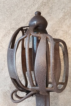

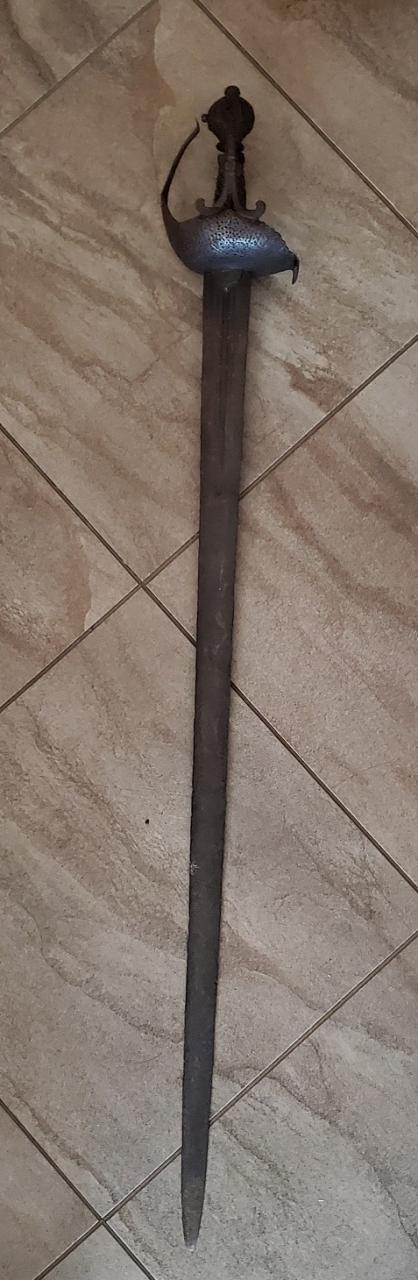

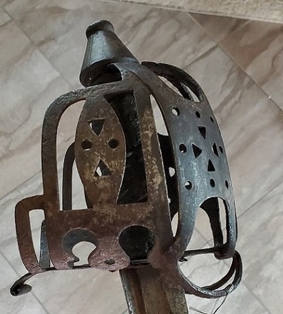

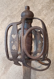

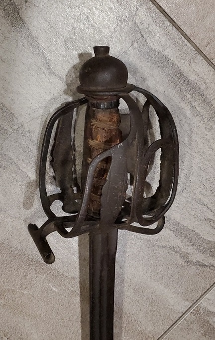

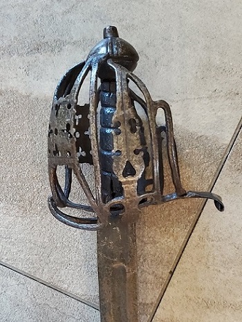

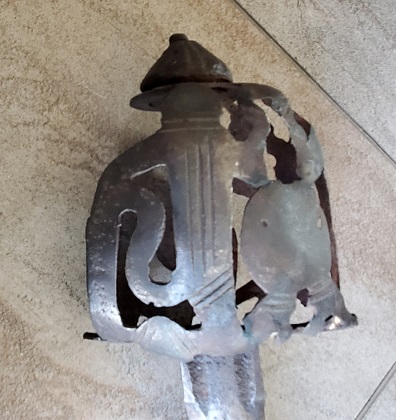

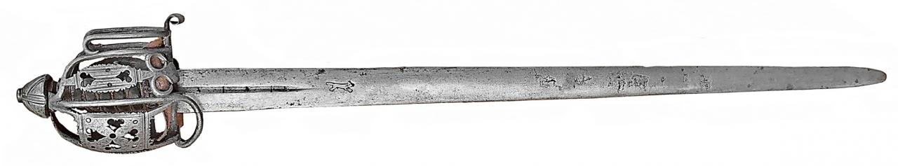

1 Ribbon hilt (beak nose) Highland c. 1650-80s pre Glasgow form ANDREA FERARA blade
2 Glasgow form, c1700 early 17th c Solingen blade Wirsberg.
3 Glasgow form c.1715, ANDREA FERARA blade
4 Glasgow form, British cavalry, poss. Scots Greys c. 1760
Note: English swords typically used German blades through 17th century, but the Hounslow enterprise 1630s and Shotley Bridge 1680s-1700 were using German makers relocated to England for production of blades. However, while a nominal number of blades were produced, there was still a large import of German blades.

The illustration is of one of Jeffries hilts c.1750s of form used by the 42nd Highlanders (Black Watch). This example has a curved M1788 light cavalry blade probably mounted in 1790s after British infantry ceased carrying swords.
The basket hilt in my previous post (with the oval aperture) is of Glasgow form and made in Scotland for British dragoons by a craftsman likely in those Highland regions c. 1760, possibly earlier. Most such hilts were made in Scottish shops, however there are indications of some with English rather than German blades.
The next example shown has a Scottish style basket, but the blade has a fluer de lis mark, which was actually sometimes known used by English cutlers. However, it is possible the blade might be indeed French as there were Scottish forces assembling there before Culloden in 1746.
There were actually very few producers of munitions grade swords in England until towards the end of the 18th century aside from those in Hounslow and later Shotley in the 17th century. During the 1790s, it was noted there were only three blade makers , possibly 4 or 5 throughout England. With the introduction of regulation swords in England in 1796, those numbers began to expand notably.
Keep in mind that officers had their personal swords assembled by various cutlers and outfitters, so the numbers of their weapons were quite a different matter, so here there were exceptions to the rule as far as sword production.
Most of what I have noted pertains to arms for rank and file military components.

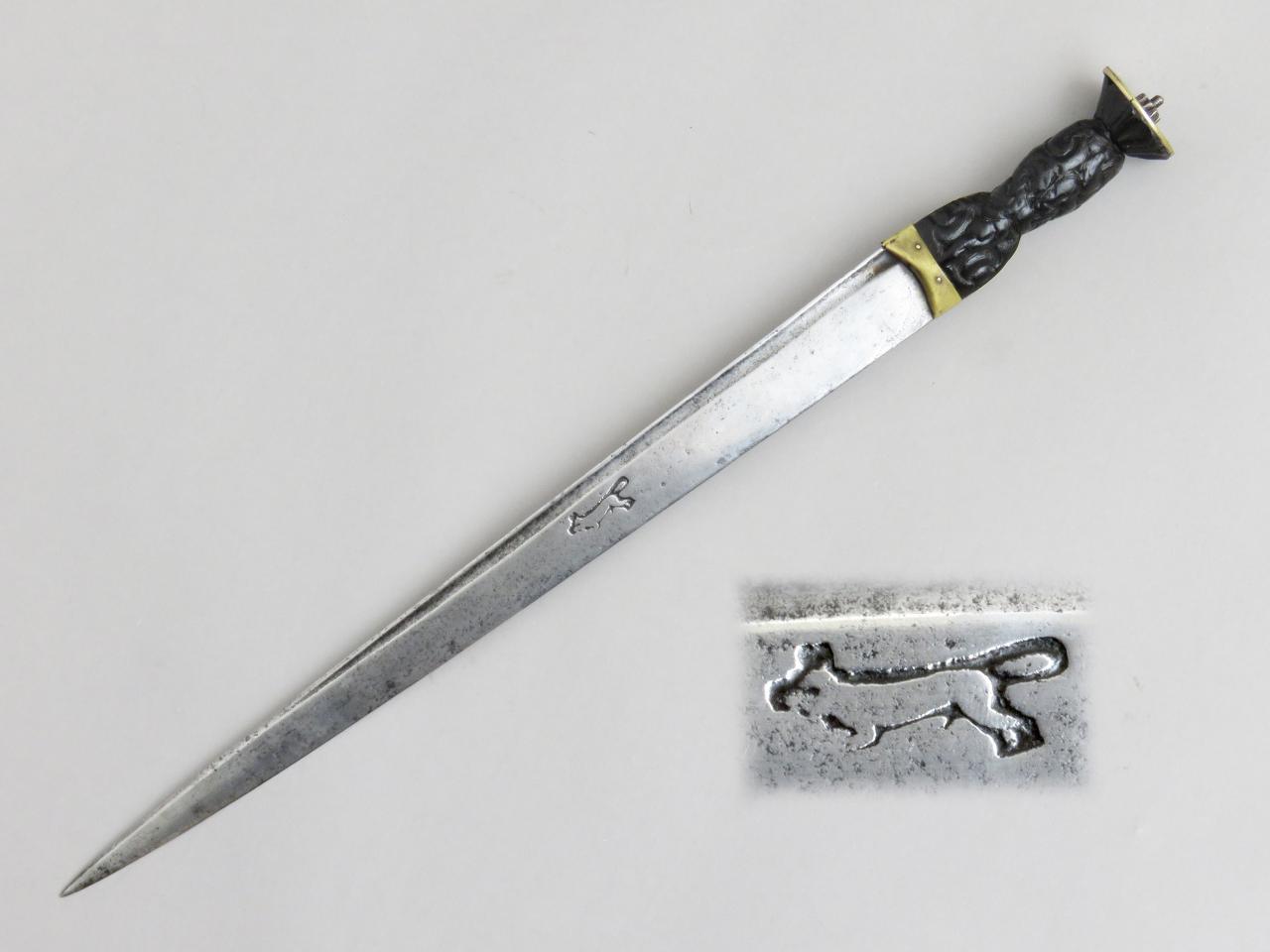

Which brings me to Andrea Ferara, the mysterious blade maker of Belluno in the late 16th century. For generations there have been myths about this famed Italian maker. Some have said he worked in Spain, others even insisted he had worked in Scotland.
Most of this derived from the fact that his name is ubiquitous on Scottish basket hilt blades through the 17th century into early 18th.
In reality, Andrea Ferara and his brother Donato were indeed bladesmiths in Belluno, Italy in the late 16th century. There were apparently dealings with factors in Scotland establishing contracts to supply blades in notable numbers established, but it is unclear the outcome and if that was completed.
It seems that the Scots took to the name Andrea Ferara with its literal meaning in Latin, Andrea= true, good, for St. Andrew the patron saint of Scotland....and 'ferrara' =iron/steel .
This evolved into the Scottish penchant for ANDREA FERARA on their blades.
The industrious Germans in Solingen naturally took this to create a 'brand' which would be eagerly sought in Scotland, and the rest of course is history. This practice in Solingen was the backbone of their suggest, not only in the production of quality blades, but the marketing of them to select clientele.
While obviously the volume of ANDREA FERARA blades from Solingen went into Scotland, we do know that in some degree they did go into England as there was always notable volume of their blades to cutlers there. Interestingly, here is a 'mortuary' from Hounslow c. 1642 with Andrea Ferara blade.
The blades often bore the names and punzones of highly regarded Spanish makers, and Sahagum was one highly favored in Europe, particularly in the north. As Toledo was all but defunct by the end of the 17th century, its reputation lived on in the blades produced in Solingen.
As always, I fear I have gone into lecture mode again, but it is hard to describe these matters without detail, and of course wanted to offer as much information as possible to the volume of readers.
This esoterica as we know on these topics on Shotley Bridge as well as Scottish edged weapons typically remains notably 'visited' on these pages, with little response. Just the same, it is good to write on them as this query by Sakalord has truly rekindled my interest in the basket hilts!

The enterprise at SB was the most complicated and obfuscated affair ever in the British sword-blade industry's history.
Originally, the story was put about that a secret machine was arriving that could make hollow blades at a fraction of the cost. That had been talked about long before the 1687 beginning of the works, because given the high German fees, plus exclusivity, plus tariffs and restricted numbers of imports, this made it a very plausible proposition: the facade was ideal. Of course its true purpose was to arm James VII/II's loyal supporters with munition's grade battlefield weapons.
For a brief moment between the start in 1687 and the arrival of a new governing (Williamite) syndicate in 1691 there were many blades made for the Jacobite militia, and it seems certain that included the Scots. These blades featured the bushy tailed fox and/or the script SHOTLE BRIDG. Of course those markings were also used on blades for the Williamite forces: John Holles, Duke of Newcastle, for example.
After 1691 blades were ostensibly all sent to the Tower to supply the Parliamentary forces and also to the syndicate's much advertised warehouses in London, from where many were subsequently sent to Glasgow to arm the Williamite supporters. Not all Scots were Jacobites… ever
None of these blades were marked in any way and neither were the ones the village secretly sent to Jacobites after 1691. For a time they were supplying both sides of the conflict. According to Kalmeter, the first Swedish industrial spy to observe the works, the potential output of SB was 21,000 blades per annum.
As well as munition's grade blades they did actually have secret machines, and they did actually produce hollow blades. Their hollow blades featured a constant width groove in the lower (wide) face and are instantly recognisable, as the Solingen handmade versions had a reducing radius that could not be produced by a machine, only by hand.
By 1715 Oley was autonomous and by around 1740 was marking his munitions grade blades with the more stylised bushy tailed fox that were often bought by Birmingham cutlers who added their names or initials to ensure the Tower paid them.
By the mid 1750s, according to Swedish spy Angerstein, the production in the village was (he understood) predominantly of hollow blades for smallswords, especially Colichemardes. (n.b. All hollow style Colichemardes feature a machine made groove.) William Kinman was a typical, constant customer as can be seen by his output that features the machine-made groove; but they supplied many other cutlers as well. In that respect, the original advertised function of the enterprise was fulfilled.
