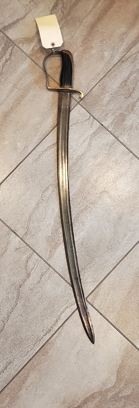

In a concurrent thread a British fighting saber with brass hilt and fluted ebony grip was brought up. This is identical to one I have by Wooley& Deakin, generally presumed as partners from 1801-1803 (some research somewhat expands this). Another by the same partners is known, along with one shown by Wilkinson by Durs Egg.

Then we come to the interesting fighting sabers by Wooley (&Deakin) which again reflect Wooley's affinity for French style, the fluted ebony grips and of course, again, Montmorency blades. These do not seem to be 'one off' though not a 'pattern', but must have had a reasonable run for naval officers. It is well known that stirrup hilt 'fighting swords' were popular in naval context in this early 19th c period.

Left : the 1800 fighting saber
rt: the Wooley M1788
