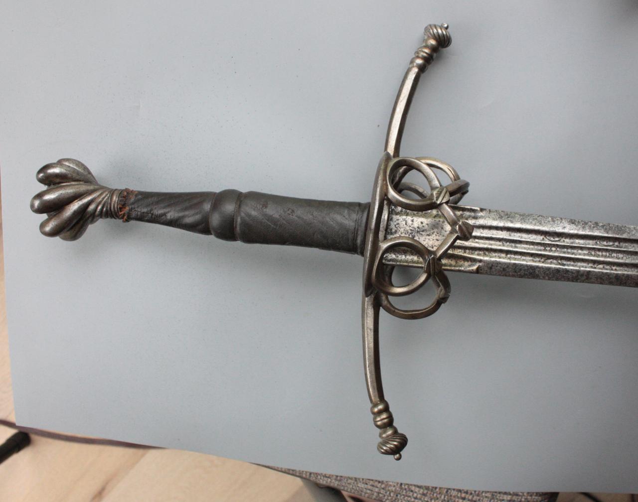

Bought this at auction some time ago. I am not sure if I posted it but if so, apologies.
This might be my favorite "thing". It is real, it is not a gold inlaid cutsie thing, this was a working sword of a well off soldier.

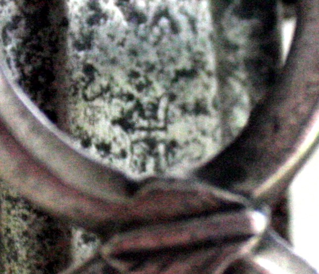

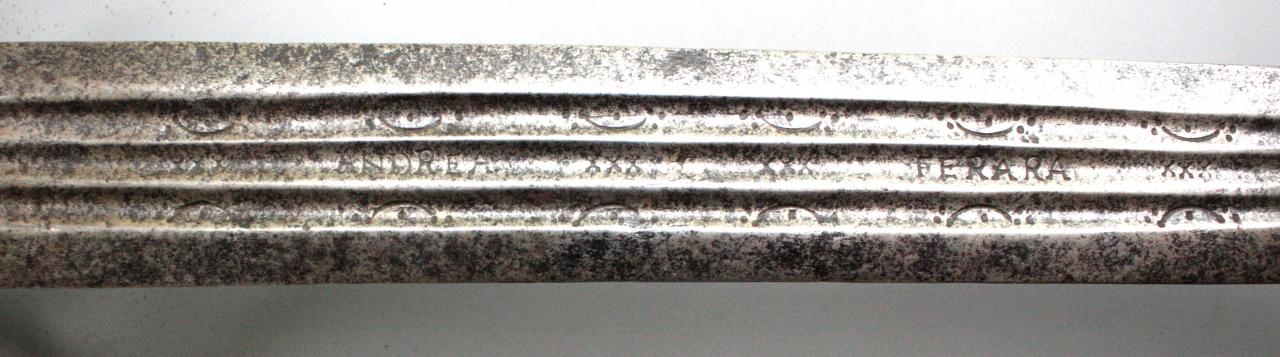

Note the Andrea Ferra mark on both side. Also there is a mark on the ricosso which, I am embarrassed to say, I just noticed. An eagle maybe?? Thoughts appreciated.

I can surely see why this would be a favorite! 16th century? Would this be classified as a writhen hilt?

The counterguard is exquisite work!

Its south German or Northern Italy around 1550 - 1560 , the blade type is the typical type found in this guard , its the first Andrea Ferara 1530 - 1586.
Could you post a picture of the back of the guard and a clear picture of the ricasso ? is the ricasso flat in the middle or has it two shallow fullers ?

I think that this hilt would properly be called "writhen":
writh·en
2.
(of antique glass or silver) having spirally twisted ornamentation.
I had always thought that this sword was "untouched" and that it was as it was during it's working life, even down to the leather. I wonder if one did a careful examination if one would find traces of blood? I think that is likely.
This is a favorite because I think that it is an object that was actually used by some ordinary guy, not a lord, just a bloke so to speak. My ancestors, of course, would have been running around with their bill hooks and ground scratching implements.

And what is that bloody mark?
It is reminiscent of the eagle proof on german firearms.

Thank you for your reply. The blade mark isn't clear enough to distinguish with certainty, but there are similar marks in the book Armi Bianci Italiane circa 1560, though not the same one.
These types of swords were not worn by ordinary soldiers, but by lords and knights. There are several swords of this genre in the Kunsthistorisches Museum in Vienna, all belonging to noblemen.
However, it is definitely a sword for combat, not for ceremonial use. I agree that it is in unmolested condition as found; a truly beautiful piece!

Forgive my possibly ignorant question: is it possible this is an actual Andrea Ferarra blade?

I doubt it. I think the mention is totemic.

Yes, it's a blade from the maker himself. The sword's hilt dates from the mid-16th century, as does the shape and type of the blade. The other symbols in the blade's fullers all date from around 1540-1550.

This is a beautiful sword in wonderful condition. What a piece to own. Thank you for the close-up photos of the developed guard and pommel. Could you perhaps provide some dimensions for the sword: overall length, blade length, width at Ricasso?

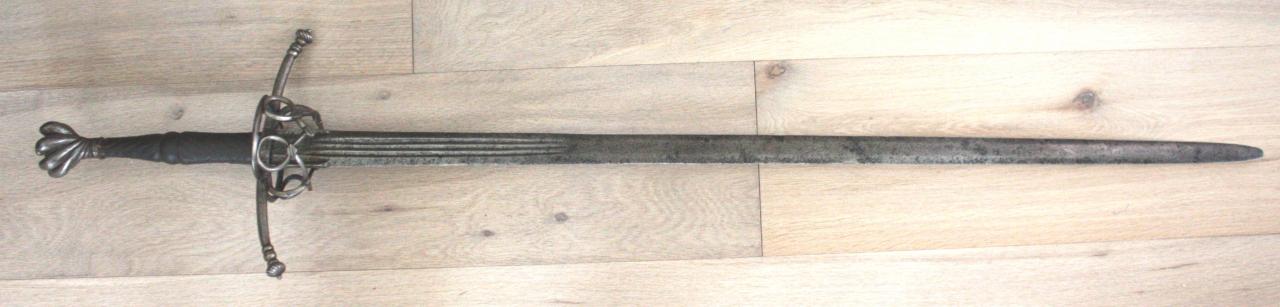

Posts: 284
Sorry ... I have been wool gathering ...
3lb 8oz
Length o/a = 47"
Blade=38.25"
Cross guard= 10"
Grip = 6"
I noted that the Christie's description description describes it as "composite". I see not evidence of that.
Thoughts?

I wonder if some features seemed possibly asynchronous to the cataloger at the time, then logic was to better call it composite to be on the safe side if someone later had doubts. When and if it turns out to all be contemporaneous on further study, then the buyer will not likely be unhappy.

during that period, you'll see the same thing with good pieces at that auction, where specific knowledge is required, this went on for years.
However, items described as "composite" were never specified as to which part was actually composite. In some cases, you could see that the leather on the grip had been replaced.
Almost all the pieces were simply "good" not only that, it also happened a few times that good pieces were described as 19th-century.

Ed, this is astounding, and like me, so many weapons have remained quietly in solitude without attention for years, then brought out. Seeing them through new far more educated eyes, and into discussion, we discover we have held sleeping giants!
A true ANDREA FERARA blade !!! The rarity is legendary.
Note the arcs with triple dots at the ends....the famed 'sickle' marks in their infancy without dentation.
The discussions concurrent on the authenticity and quality of character in arms circulating through the community seem compelling as we see that not all weapons that become 'suspect' are less than they seem. ...diamonds in the rough they are, true sleeper treasures.
This is resoundingly one of them!!!
Thank you so much Ed for sharing it here, and letting us see a TRUE Andrea Ferrara!

If you mean the ANDREA FERARA, as far as I know there are few examples of his blades genuinely marked with his name, but clearly there were some, and those by his brother Donato are even more rare.
My own opinion is that the name ANDREA FERARA became a kind of eponym for sound blade in Scotland due to the literal meaning in Latin, Ferara=iron,steel; Andrea= true, etc. St.Andrew patron saint of Scotland.
While the actual numbers of blades going directly to Scotland from Italy and the Ferara's is unclear; what is known is that Solingen quickly picked up on the convention and began using the ANDREA FERARA name, virtually as a 'brand' destined primarily for Scotland but also into other British regions.
As noted, the blade on your sword seems original ANDREA FERARA of mid 16th century and N.Italy/S.Germany hilting.
The grouping of surrounding markings are contemporary to that period.
Later use of the ANDREA FERARA was by numerous other German makers, and often applied with varied spellings and assemblies of other marks of the earlier periods, most often the so called sickle marks of Genoa. It does not seem the running wolf usually was paired with ANDREA FERARA, but surely was possible as these spurious marks and names were applied.
