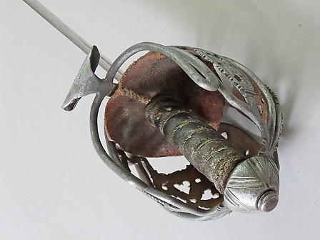

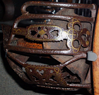

The Scottish basket hilt form has a fascinating history and has remained one of the most arcane areas in the study of arms, with probably more questions than answers still at hand. While over many years Ive learned a lot, but have barely scratched the surface, and hope that discussing here that will bring members and readers together in compiling material, observations and ideas to advance our knowledge base on this intriguing topic.

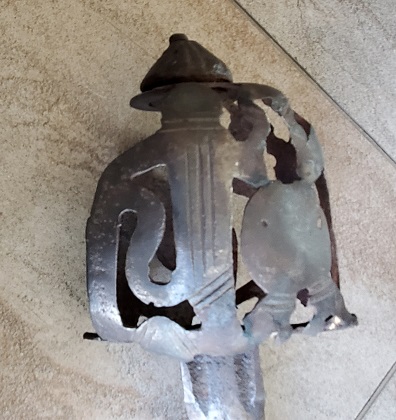

I would open with a basket hilt which I acquired many years ago, and came out of an obscure estate sale where it had been static for apparently many years.
As it was examined hands on by important figures in arms study who noted it was virtually 'untouched' overall, it might provide important insights into the early dynamics of these swords.
The example appears to be a hilt construction of third quarter 17th century and is of what is known as a 'Glasgow' hilt, by the shields with piercings, often hearts or other shapes. The pommel of low cone style (Mazansky, IVa ,A15) which seems to align with hilts by John Allen (op.cit Mazansky, p.89). These resemble earlier low cone pommels seen on earlier 'ribbon' or 'beaknose' hilts thought to be third quarter 17th, but now deemed even earlier in many cases.
This hilt has the added feature of an extended quillon or wristguard (known as a 'backward' in period) which came around near close of 17th century, wide often terminating in a scroll. This feature (per Whitelaw, 1934, p.303) was for protection from the sawing cut to the wrist often used by Highlanders to an opponents attack (as noted in 'use of the broadsword', Nowrich, 1746).
While I cannot tell if this is original to the hilt, or added at later time, its presence suggests the terminus post quem of the hilt in its state as latter 17th c. Whatever the case it is likely within the period of Jacobite uprisings beginning in 1689 and ending nominally with the tragedy at Culloden (1746).
The blade is of interest as these were invariably imported and mostly of course from Germany (Solingen), as is this one which has the mark associated with the early Wirsberg family. This is typically held to represent a hunters horn or bugle as was used by the senior Wirsberg in late 16th into early 17th,as typically noted in compendiums (Gyngell, Lenciewicz) however Wendelin Boeheim ("Handbuch der Waffenkunde" Leipzig, 1890. p.654) refers to this differently. He claims it is 'dashalberd (sic) which means 'the half wheel'. Regardless, the mark on the blade suggests it is from early in the 17th c.1620-30.
While most blades circulating in Scotland seem to be from the 17th century with most of the swords in use, into the 18th c. it does seem that they were occasionally remounted, especially of course in the case of damaged examples. It would seem likely this blade reached its current incarnation in any number of such scenarios.
What is of most interest is the obviously spurious attempt at adding the highly regarded name 'SEBASTIAN', which while German in character, was the name of one of the most highly esteemed Toledo swordsmiths of the late 16th century. ...in full SEBASTIAN HERNANDEZ.

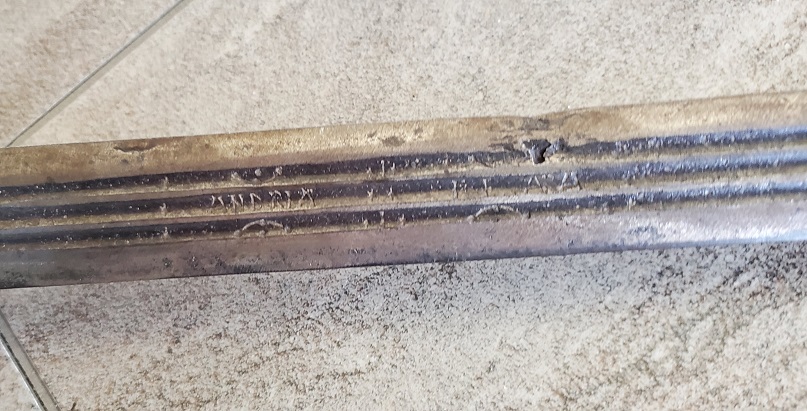

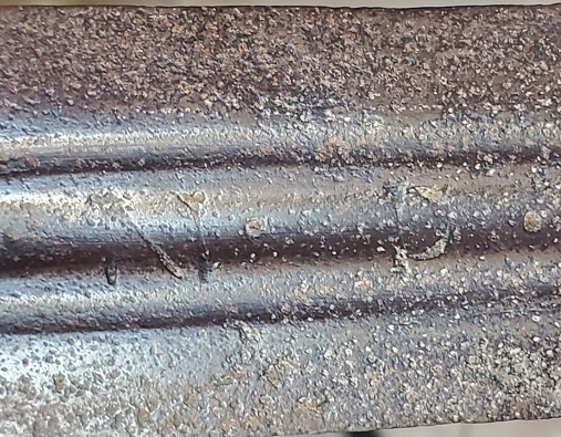

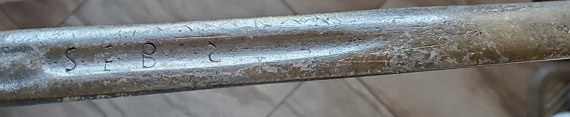

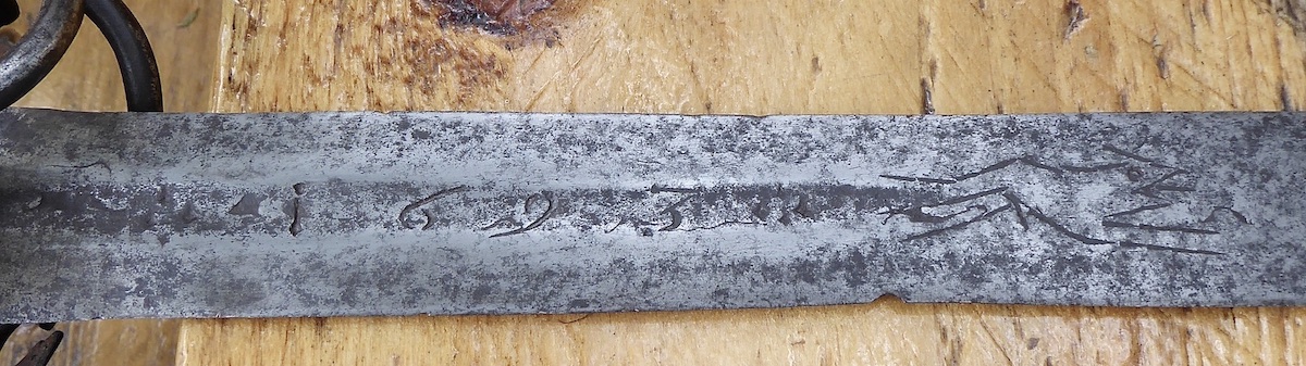

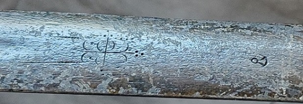

The inscription on this blade is a crudely carved version of the name SEBASTIAN, which though seemingly German, appears to be toward the esteemed 16th c. Toledo maker SEBASTIAN HERNANDEZ. The court in Toledo had moved to Madrid in 1561, and German makers by mid 17th century had been capitalizing on the waning industry there.
The use of Toledo makers names, marks, phrases and conventions were placed upon German blades, often it seems not for deception (as they often still placed their own marks as well) but for the magical properties associated with these Toledo products. There are numerous variations of the Sebastian Hernandez name applied by various German makers of the time, so the name as a whole was not necessarily required.
In this case, the SEBASTIAN name though crudely applied, seeming not intended to purport to be an actual blade by the maestro, still, in Highland perception, carried the necessary imbuement so valued by the owner as this heirloom blade was once again mounted to defend the honor of the clan and warrior.,

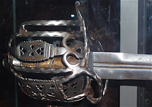

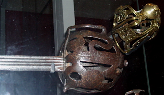

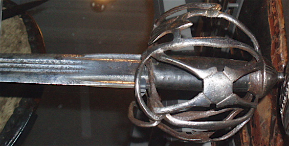

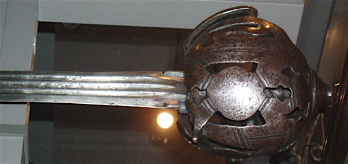

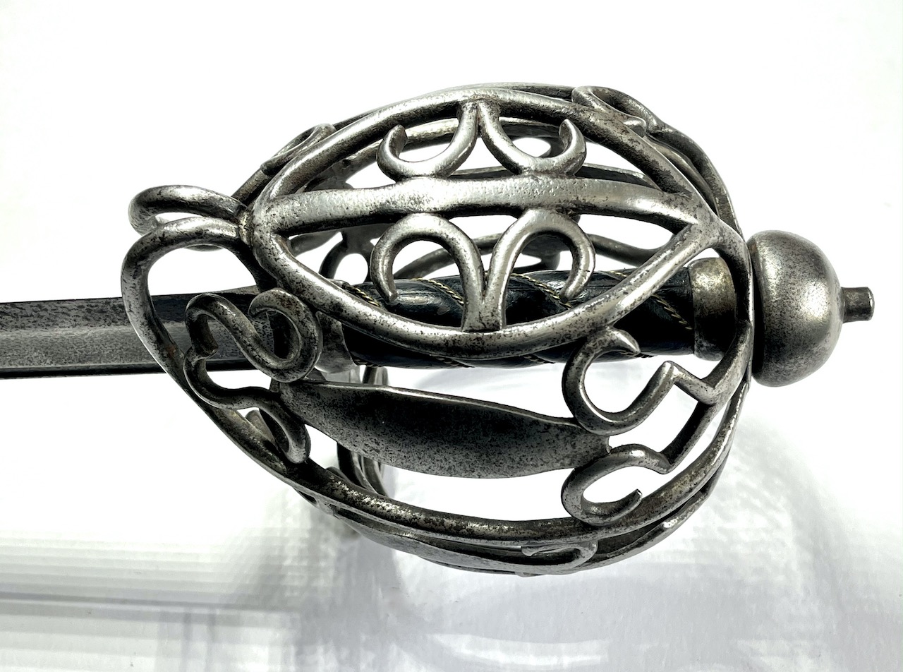

Hi Jim.

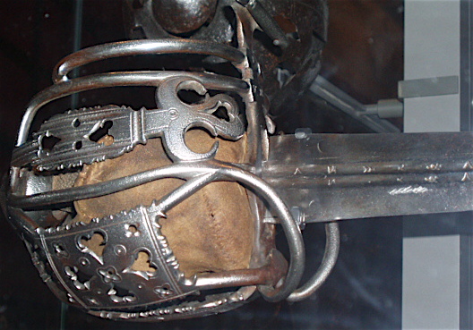

First lot from Kelvingrove Museum all with German made blades.
Norman.
Old 14th July 2025, 07:09 PM   #4
Norman McCormick
Norman McCormick's Avatar
Posts: 1,631

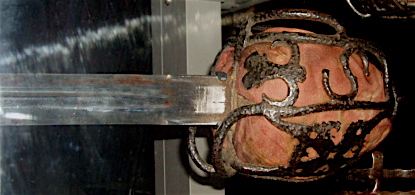

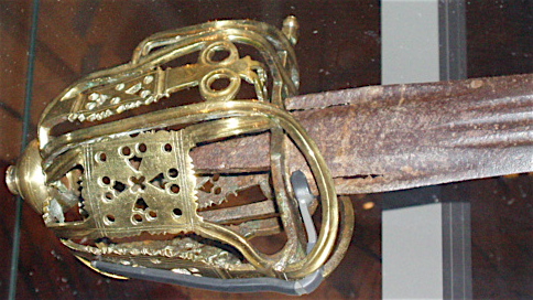

Hi Jim,
Second lot from Kelvingrove Museum, can't remember blade origins I'm afraid. Will try to get to Kelvingrove and retrieve more information as soon as I can.
Norman.
Old 14th July 2025, 07:11 PM   #5
Norman McCormick
Posts: 1,631

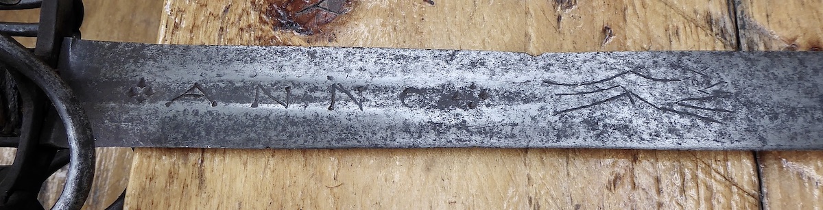

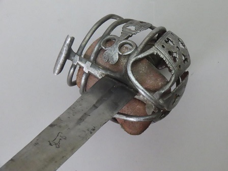

Hi Jim,
My only Scottish broadsword discussed here http://vikingsword.com/vb/showthread...17thC+scottish
Norman.

These are so breathtaking, as are all basket hilts! It is so overwhelming seeing so many at once, though in looking at them I want to individually itemize the various features and elements to learn more on them.
I recall Dr. Mazansky when writing his book, was following the path of Nick Norman in categorizing the character of hilts by period and features. I was hoping for more historical background and perhaps developmental notes, but his work is profoundly useful in itemizing categoric forms and character of elements for discussion. His glossary of terminology and nomenclature is extremely useful.
Your example shown is amazing! and the blade fascinating as the running wolf is not widely seen on Scot blades and with ANNO etc. As noted, these are all 17th century German blades and interesting variations. I am trying to find the references noting the talismanic properties of these often familiar markings on blades. I have long believed personally that the 'running wolf' of Passau, later Solingen, was a talismanic marking placed on blades in these types of thinking.
I noticed one of the hilts was in brass. I had always thought the brass hilts came about in the Napoleonic period with the swords for officers in the Highland units. Apparently there were instances of brass hilts as early as 1721, possibly earlier, and the challenging weather up there often called for more durability in hilts, with japanning or browning common, so as with naval hilts for damp climates, brass seems understandable.
I think the only prohibition in using brass is the softness of the metal not standing up well in combative interaction.

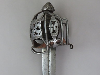

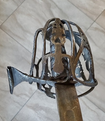

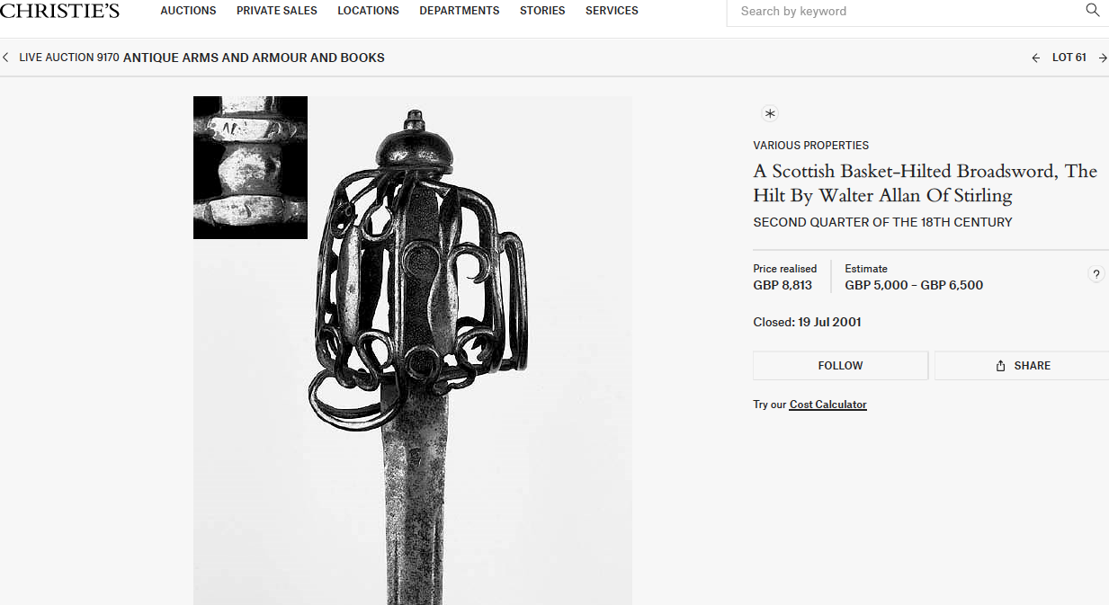

Glad you're in, as the northern English regions are not only a key factor in the production and development of the basket hilt, but the Border Reivers were keenly a part of the diffusion and use of these distinct swords. While the original 'CLOSE' hilts, that is developed hand guards made up of bars and plates/shields were in use in England as early as late 16th c.....it is primarily the evolution of the HIGHLAND forms we are focused on at this point.
I have added your fine example of what is regarded as the 'conventional' or 'traditional' form of Highland hilt, which is known as the GLASGOW style of hilt. It has been held (Whitelaw, 1934) that John Simpson, a Glasgow hammerman who was working 1683, becoming master in 1692, was the originator of what is now recognized as the 'Glasgow' form hilt.
These hilts with the bars holding shields forming the 'basket' became distinctively recognized by the pierced shields which had the designs with various shapes of hearts, circles and other forms in characteristic formations. There are other features which we will discuss later.
John Jr. his son was working by 1711.
There were two journeymen, JOHN ALLEN(1702) and James Allen (1706).
What is important here is that John Allen went to STIRLING by 1714, and here evolved the second form of Scottish basket hilts.
These were distinguished primarily from their notable departure from the conventional pierced plates, and into more elaborately designed elements of the basket structure. These often incorporated not only artistic designs, but many features including Jacobite symbolism.
John had two sons, Walter and John who later worked in Stirling as well.
Most notable about these men is that they developed a unique way of signing their hilts, which was how Whitelaw identified and was able to categorize these hilts basic forms.
With this, we can see that the GLASGOW form hilt must have evolved around the 1680s with John Simpson. It is notable that he and the others listed seem to have been the only slippers who signed their work (initials) aside from one or two other cases.
So with Keiths sword, the 'Glasgow' hilt seems likely mid to late 1690s possibly later into early years of 1700s.
My question/theory? is, could John Simpson Sr. have developed the guard system while he working toward his mastership in 1680s? Using the known elements from the long extant 'ribbon or beaknose' hilt with wide curving bars and the variously structured bars of earlier English forms circulating, perhaps he created the use of consistently placed shields. He then may have embellished these with the piercings which became rather a trademark style.
I would note here that the otherwise 'standard' Glasgow hilts which factor in the S shape element (as in Normans example posted earlier), seem to have been a likely variant used by other hammermen in Glasgow regions in the period from turn of century into early 18th.
Another important development here with the Glasgow hilt, as seen with Keiths example, is the notably extended 'wrist guard' (backward) which as per Whitelaw was added in latter years of 17th into early 18th. This feature was to protect the wrist from the sawing cut often used in Highland swordsmanship. This does not seem to be included in the basket hilts of Stirling and lowland forms.
Going to the blade....clearly a Shotley Bridge 'Oley' example, and from 1680-90, with the familiar bushy tail fox (BTF), it seems evident that blades from these Newcastle regions were in circulation into Scotland as well as into England. It has been of course plausibly, if not compellingly noted that the Shotley conduit was a key center for Jacobite sword supply.
I have wondered if Shotley was indeed a point of entry for the immense numbers of German blades who supplied Scottish sword slippers of these periods of Highland basket hilt development in mid 17th into 18th. It is well known that German blades mostly, and of 17th century, comprised the blades invariably mounted in these swords.
Could this been one of the entrepots for the ubiquitous ANDREA FERARA blades which appear so constantly on Highland basket hilts? We know that while the Andrea Ferara blades are forever aligned with the Scottish basket hilts, these had been coming to Great Britain much earlier in the century.

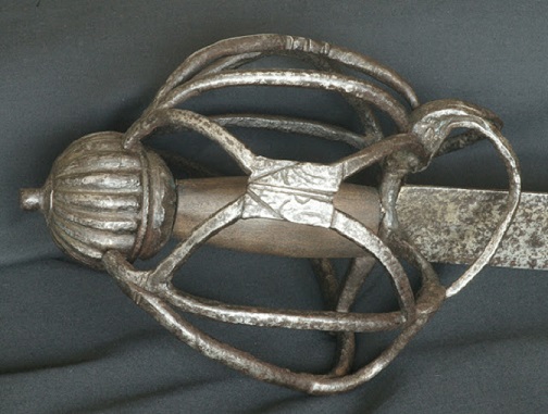

I have a 'mortuary' which is of Hounslow c. 1640 with Andrea Ferara blade. Also, here is one of the 'ribbon hilt' the forerunner of the 'traditional' form hilts in Glasgow, also with ANDREA FERARA blade. While these hilts are typically conservatively placed third quarter 17th c., more recent literature has suggested they were from earlier, perhaps 1640s, as would be supported by this comparison.

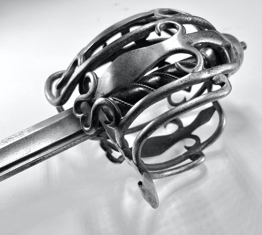

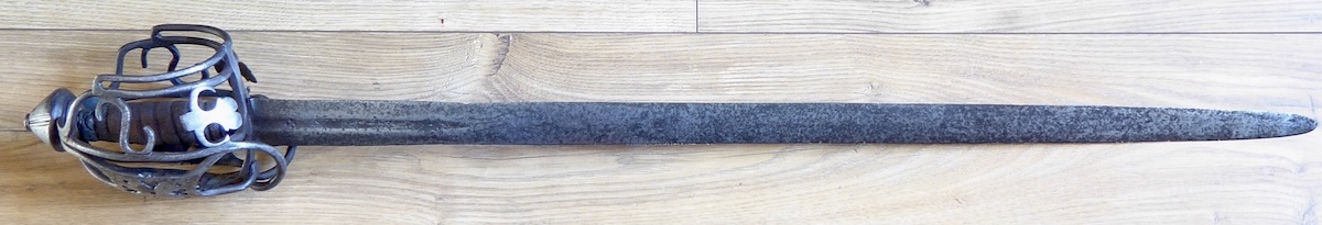

First three pics of Keiths Glasgow c. 1700 w/Shotley blade 1680s BTF
Next, the ribbon hilt mid 17th ANDREA FERARA blade..., Note the 'S' shape in hilt

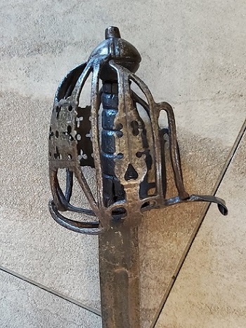

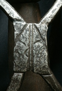

It is well established that the basket hilt (close hilt) form had already evolved in the Continent and in England long before the form evolved as the Highland hilt in Scotland. In this early form in England, it seems that arming swords with simple hilts were in use c.1530s with more half basket. However around the 1570s more bars and structure was added creating this form termed British 'globe hilt'. This example from 1570-80.
It seems that the Border Reivers of northern regions of England may well have been instrumental in the evolution of what became the Highland basket hilt.
Naturally it would be hard to declare this situation as monumental, but it was certainly a factor, likely of key importance.

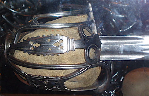

In these hilts there seem to have been certain decorative features practiced, especially as the Scots began following the practice of more developed hilts.
While the Border Reivers were understandably neither exclusively Scottish nor English as their domains were on the diaphanous borders between the two.

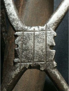

The stylized decoration on the junction plate is believed to pertain to the pine cone which has to do with long life and resurrection.
This scalloping or notching seen in the next image is deemed profoundly Scottish, this from an example c. 1530-40, and seems to be applied in varied fashion on the shields serving as junction plates on the Glasgow hilts as they evolved in latter 17th century. It is unclear how often or instanced these occurred in the interim evolution, but illustrates the traditional symbolism that became notably used in the established Highland forms.
In the example of a junction plate shown, the highly stylized decoration (center illustration)is referred to as a representing the pine cone (termed cone and pouch in design), which symbolically has to do with long life and resurrection. Tenuously of course we might consider the affinity of Scots for the cone shape in pommels.

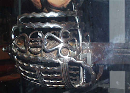

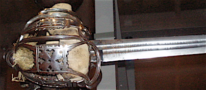

One of the fundamental pierced designs seen in shields of the Glasgow hilts has been the familiar heart shape, which according to Wallace (1970, #26), "the heart decoration was used extensively on the structured basket hilt from the late 17th c. and afterwards".
I have tried to discover what possible tradition, symbolism or convention might have prompted this shape for many years, even contacting certain well known authorities on these topics, but thoughts toward such matters are typically avoided. While the pierced shields on Glasgow hilts use various geometric designs and circles in the pierced configurations, I often wondered if perhaps this familiar design in this context might be one of the number of secret Jacobite symbols.
The Scots, well known often as mercenary soldiers fighting in other lands, fought Turks in Poland and Austria. In these places arms and armor often used pierced heart designs as seen often in Catholic themed blade motif. I thought possibly the Stuart/Catholic association might be at hand....obviously tenuously speculated, but we are dealing with highly subjective matters.
I have seen heart shapes in Victorian Scottish furniture, and Im sure it occurs in other material culture as well, but I am curious about this context.

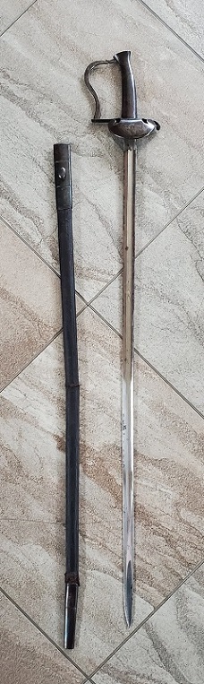

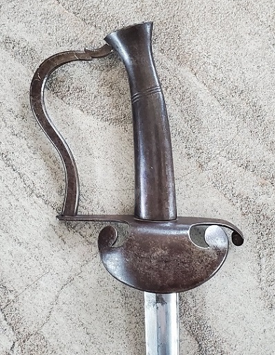

Old Today, 04:00 PM   #19
jezcott
Join Date: Apr 2018
Location: Cambridge, UK
Posts: 13

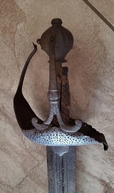

Default Stirling hilt with English dragoon blade
Jim, many thanks for starting this excellent thread on a topic of interest to so many.
This is an example of a composite Scottish Stirling hilt, I believe 2nd quarter 18thC, with an English dragoon backsword blade by Drury.
The screenshot below is of an almost identical basket-hilt sold at Christie's in 2001, signed by Walter Allan of Stirling. Mine isn't signed, but seems likely to have come from the same workshop, same period.
The blade is most like 3rd quarter 18thC when Dru Drury was supplying blades for munitions grade basket hilts for highland regiments and for officer's swords.
It seems likely that this hilt would originally have been fitted with an Andrea Ferara blade from Germany. Interesting to speculate on the rehilting with an English blade, could this have been for an officer in a Highland dragoon regiment in the post-Culloden era? Rehilting does seem to have been a common practice with favoured hilts or blades refitted.
Jim - you mentioned the imagery on these Scottish hilts. On this hilt there are hearts, but also unmistakable fleur-de-lys which presumably celebrate the Auld Alliance of pre-Culloden Scotland. Hard to imagine this being popular down South, but maybe you could get away with it in a highland regiment!

Jerry, thank you so very much for coming in, and especially for entering this fantastic Stirling example! and sharing the corroborating example from auction detail.
As you note, your hilt does seem to be from the 2nd quarter 18thc and pretty much mirrors examples signed by Walter Allen, so certainly likely from his shop or closely associated. Stirling hilts seem to typically be pretty much free form rather than adhering to the shield and bars systems of Glasgow. The round bars are of course key to Stirling examples.
Well noted on the Drury blade also as by third quarter 18th he had taken over for Jeffries, who he had partnered with in London since mid 18th or slightly earlier. They were producing swords for British army, mostly munitions grade hangers and basket hilts. It seems that Drury, like Jeffries were primarily cutlers, and assembled swords so blades were probably imports but as yet unclear on their source.
After Culloden (1746), while weapons were proscribed for Highlanders, the officers of Highland units were still entitled to heirloom swords and blades and it seems likely this pairing came out of these circumstances. Many basket hilts were 'taken down' rather than being given up, and the blades cut down for dirks, which as utility knives were still permissable.
The 'fluer de lis' element is commonly referred to as the 'rams horn' in Highland hilt nomenclature, which is likely to simply be an eponym rather than any symbolic significance. This is like the case with the 'S' element in many hilts which is simply an aesthetic structural element and does not signify "Stirling"; Scotland or Stuart as many have suggested.
While I have searched for many years to find such imbued symbolism in the motifs and elements of these hilts, the only examples that can be definitely aligned are thistle, oak leaf and a number of 'secret' Jacobite symbols with many still debatable.
On the hearts.....jury's still out
Yours is a magnificent example of a Stirling hilt, and with notable history with possible Culloden period use, and later remounting of hilt into English blade suggesting further service later in the century.
Outstanding! and thank you again.
I hope others will join, and I welcome any observations on my comments..this is all a learning curve and I only suggest what I have understood from research thus far.
