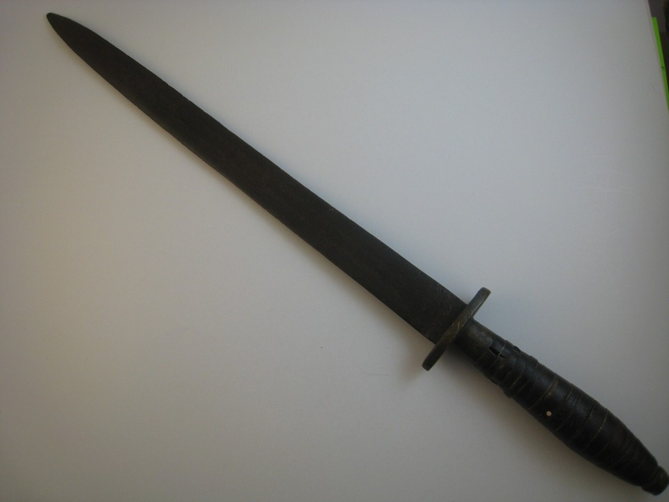

I just bought this piece but it has not arrived yet.
The seller described it as a "large hand made fighting knife" which is 18.5 inches overall length.
I am curious whether this is a naval dirk.
Thanks

Hi Mark. It could very well be a naval dirk. many of them were very pain, with spear-point blades and very simple cross guards such as the one on this dirk. Better pics might help in determining for sure. Likewise, this could be a "boot dagger" type from the Old West setting. Naval dirks ranged in size from a mere 8" or so for dress dirks up to very large examples over 20"! Hard to tell from the pics what the grip is made from. Is that wrapping?

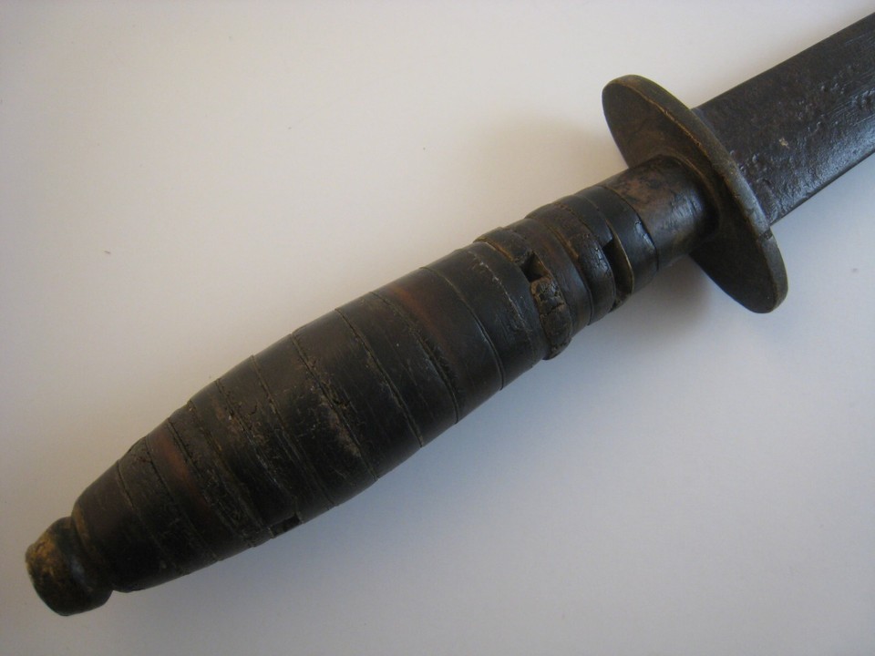

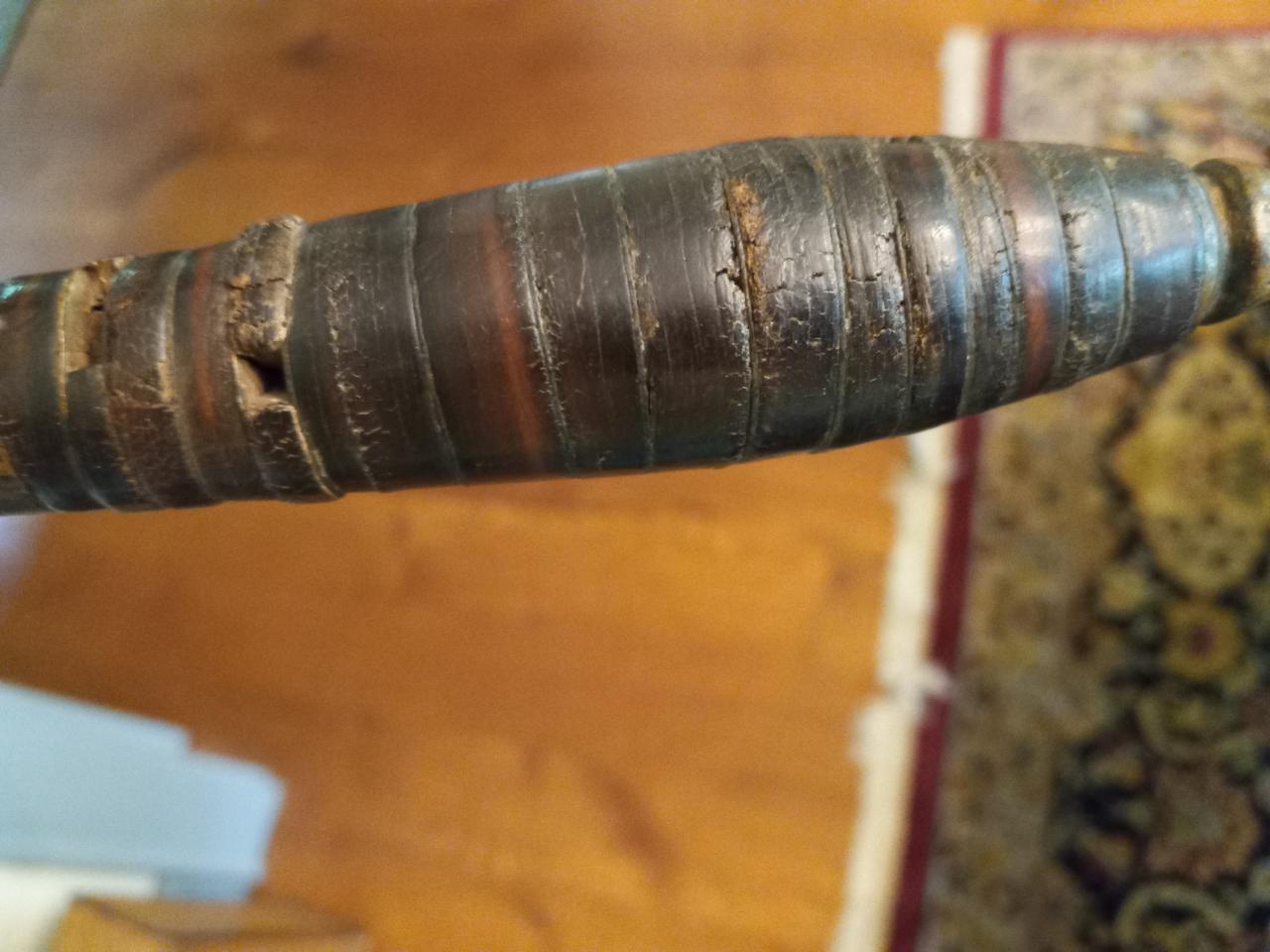

In looking again at this piece, I think this is more of a gambler's dirk versus a naval piece. During the last quarter of the 19th into the early 20th, knives like these had leather 'banding', almost like little washers all pushed tightly together to make the grips. Still, it is a great piece with an undoubtedly colorful history! These things were sort of the precursor to later knives, including trench knives. In profile, it even resembles the Fairborne-Sykes types-

Yes, please do. It appears early, at least mid-19th and the simple cross guard as noted is similar to naval dirks. The stacked guard has washer-type 'disks' of material, probably leather or possibly gutta percha, to form the grip. It is also possible the grip was a replacement? We'll now more with better pics. She's a monster dirk at 18+ inches!

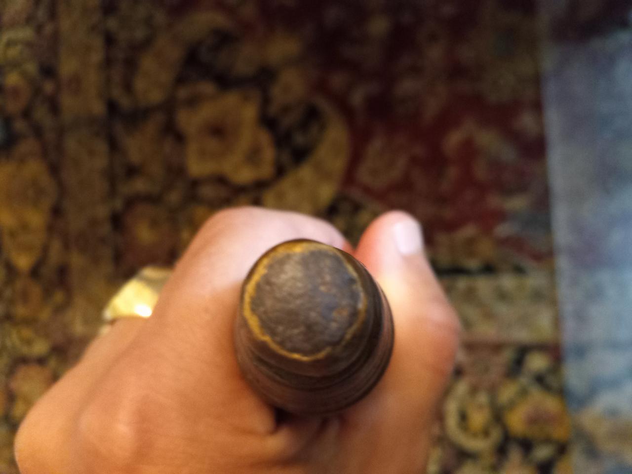

Finally received it. Blade is 13.5 inches long! 18.5 inches overall. additional images attached. Blade seems hand forged to me. Guard seems brass, very old.

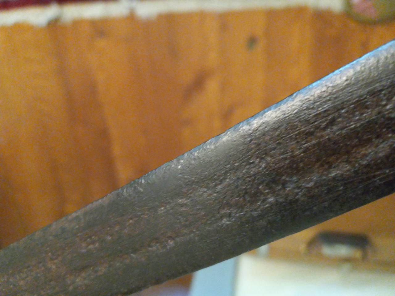

blade also appears to have a double fuller?

Very nice piece! To my knowledge, no naval dirks had leather-bound grips. The leather-washer types seemed to have started popping up around the last quarter of the 19th century up until around the '30's. From the patina on this one, it's easily from the older period. I'd stick with it being a side knife/fighting dirk (not a naval one, though). The guard is of the type used on both naval and fighting knife types. Due to its size, we can rule out a 'boot knife' or gambler's dirk.

Thanks Mark. I appreciate the feedback. I am curious whether the grip was redone at some point in the late 19th century, similar to a tomahawk re-hafted in its life.
I only ask because that blade seems really old to me. For some reason, I get a Spanish feel to it.

Very hard to tell from photos, and age from various conditions that it may have experienced lend to the degree and forms of corrosion. The original forte seems to remain, so if the blade was cut down and reprofiled hard to say. While this was often the case especially with broken blades, not always so.
The classic case for this has long been with the Scottish dirk. When the proscription of arms was levied on the Highlanders, the exception was they were allowed dirks for utility purposes. Many Highland broadswords were thus cut down and remounted into dirks, leading of course to the industry of producing these specifically.
My guess from photos shown it is likely late 18th c. possibly slightly earlier.
I have seen elliptical type blades with similar narrow forte c 1820s.
