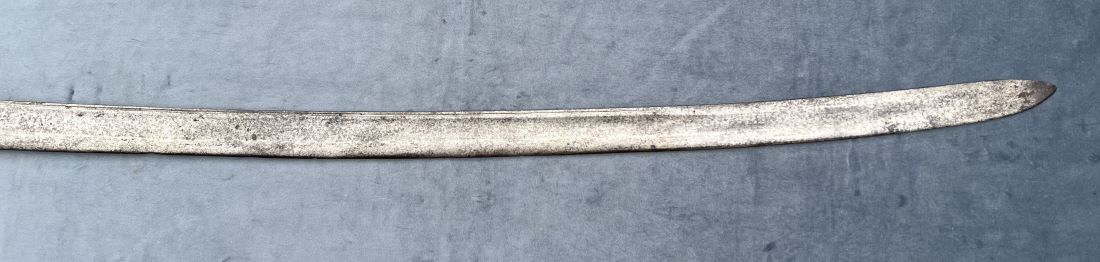

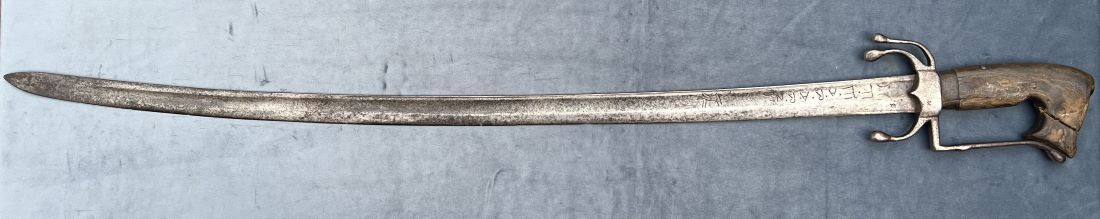

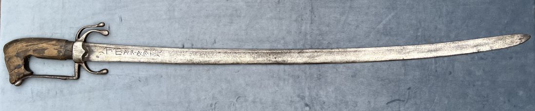

I got this curious specimen.
The blade has imitation marks of ANDREA FERARA, wolf of Passau, Genoese "gourdes" and probably a trade mark of a European supplier (shop).
Imitation marks of famous marks are also often found on takuba blades. But here the local blacksmith generously put everything he knew and saw into this blade.
Total length 945 mm, blade length 795 mm, width at guard 34 mm, thickness of the butt at guard 6 mm, weight 824 g.
I will be grateful for any thoughts and comments.
Yuri

nice one.

Well noted that this clearly desperate attempt at the fabled ANDREA FERARA inscription is far from the mark by a native individual in one of the countless trade entrepots across the North African littoral once known as the BARBARY COAST.
It is important to note that while it seems invariably that these distinctly recognizable and ubiquitous sabers are mounted with many variations of European cavalry blades, many later examples of 19th did not carry the kinds of markings long appealing to these native people.
With these familiar markings, which usually consisted of the 'running wolf' of Passau/Solingen; the 'sickle' marks (dentated arcs) of Genoa; the powerful name ANDREA FERARA and others........typically held for centuries as marks of quality in Europe...........with native people, they viewed these in far different light.
Despite the Arab predominance and of course the Muslim Faith, the folk religions and superstitions prevailed, and much as with the complex systems of symbolic devices, these distinct markings were seen as imbuing the blades used in these swords with magic and power..
Interestingly, though most of the blades coming into North Africa by the 19th century were of course German, however with notable diplomatic and trade connections between England and Morocco through 17th century well into 19th, the diffusion of English blades filtered into the Maghreb.
This was the conduit which brought in the numbers of ANDREA FERARA blades (which were actually Solingen made for the Scots).
These kinds of traditionally recognized awareness of these earlier markings led this unknown trader to embellish the blade on this example nimcha accordingly, and NOT to deceive but in the belief that these markings all held talismanic significance. The compounding of these together presumably would add even more potency.
Though naturally I would expect disagreement with my perspective, however IMO it is certainly compellingly plausible.
While these nimcha are typically regarded as from Morocco, Stone (1934) noted them as Algerian, but ALSO used in Morocco. Briggs (1965) who was situated in Algeria used examples he acquired locally in his study on Tuareg blades.
Though this example is likely from early 20th c. the blade is quite possibly from the many European blades circulating through trade centers in the North African littoral from earlier years. It would be hard to define use distinctly to region or whether Arab or Berber as these were so widely used for centuries overall in these regions.
This is a rugged example which is of the type used by the notorious Barbary Pirates from Morocco through Algeria, Tunis and as far as Libya throigh the 19th c. and even by Berber tribes in the Rif Wars in Morocco in the 1920s.
On a more specific note, blades with the 'Genoan' sickle marks that are remarkably similar to those seen on many nimchas, have been found in areas of Black Sea coast. The Genoan presence there in trade since medieval times brought those sickle marks into the Caucusus (there called 'gurda') and Styria (Austria).
These areas were the source of many blades found in North Africa through Arab trade, as these blades were enormously popular there.
While this may be seen by many as 'simply another nimcha', those of us here who have been intrigued by them for many years see the complex history behind them. They have become increasingly harder to find, so this is a wonderful acquisition.

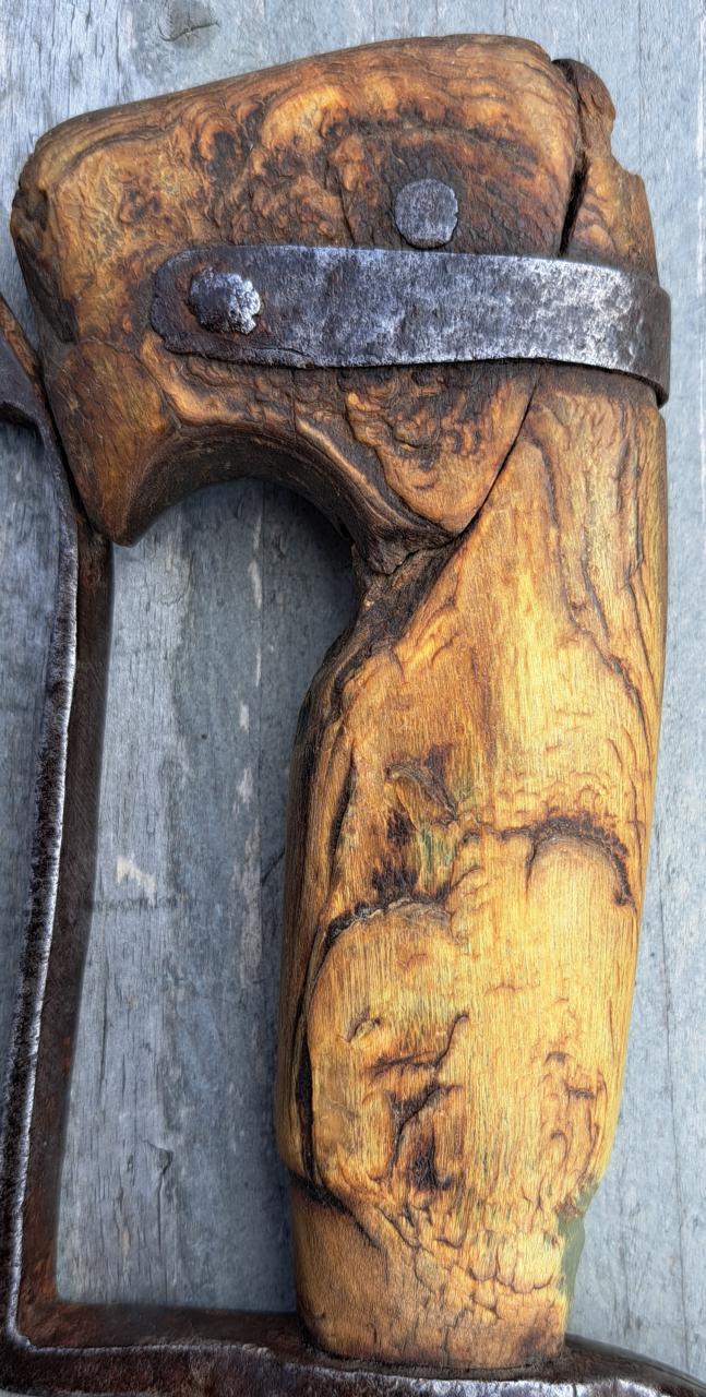

A fine looking Nimcha (in my eyes, though it is not my field of collecting, so my knowledge of these is far less than some others here, like Jim).
Though I am intreged by the history of the Barbary coast 'pirates', I recently bought a rather similar Nimcha as yours. It has a different marking in the blade though.
When first handling it, I was surprised of it's length and weight. It has a great balance too!
Mine had an incredible patina of use, and I cleaned the dark blade superficially.
It aso has a native restore at the (bovine?) hilt.
I hope you don't mind me interfearing your thread, as that is not my intention. But because mine looks like a similar type as you have, I thought it would be ok to discuss both nimchas in one thread.
Maurice

As can be seen, while the 'nimcha' style hilt with its distinct quillon and guard system was widely used throughout the Arab world, and while some examples remain in remarkable condition, many had long working lives throughout the regions of North Africa.
In my view, examples like Yuri's and yours are most exciting, as they were indeed worn, and perhaps used over long periods, and often within various groups as they changed hands.
With colonial actions and intertribal warfare along with trade and many types of interaction through the 19th century, well into the 20th, these swords were not simply traditional fashion, they were worn to be used as required.
Evidence of this is seen with the bolster strap holding the hilt together on Maurice's example.
These hilts were indeed made of horn of some sort, but I'm sure it varied, and while rhino was of course much desired, it was not as readily available and expensive. Horn itself was durable and surely had certain values in the sense of the traditions and nuances of the culture itself.
Going to certain elements on these nimchas, as a form, I notice on the example shown by Maurice, at the forte there is a stamp which comprises what looks like a dentated arc (as seen on Genoan sickle marks) and a star.
This seems to be seen on certain Moroccan examples (as seen on my example attached) and is tempting to suggest it is some sort of 'state' mark of Morocco, but cannot say for sure.
In Morocco, according to Tirri (2003, p.19) it is noted there were numerous weapon making centers in Fez, Meknes, Marrakesh and Rabat where there were apparently favored designs for daggers. Also centers at Tetuan, Taroudent, Ras al Oeued and through Little Atlas there were centers for guns and assembly. Any of these might have been sources for established supply of arms which may have included these swords.
It is noted as well that there was extensive use of imported weapon components (which has been well established), and via the many trade routes, might have come in through any number of the entrepots receiving foreign blades.
This is the reason it is so hard to establish the regional classification of extant nimcha examples. The 'Barbary Coast' (the exonym previously used and derived from 'Berber') extended entirely across the North African littoral from Morocco to Libya. The 'Barbary Pirates' refer to these outlaw raiders who were active throughout roughly 15th c. well through 19th, but as with historic periods, there are no specific limits to exact times, any more than defining the age of piracy itself.
Often it seems surprising that full length swords would be used as a 'pirate' weapon, with shorter stout blades being expected for close quarters on deck fighting. Here I would note that typically, these 'pirates' would transport in their galleys, but raid ashore, thus the full length swords.
