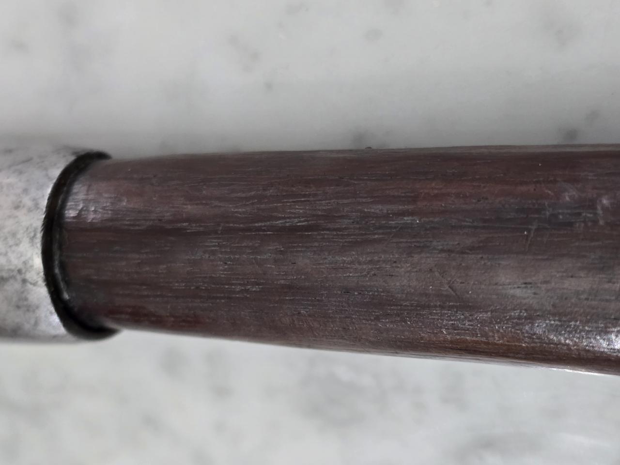

Hello Mandich,
The most important part of the spear to judge its age or use you haven't shown! We need a picture or more from the wooden part IMHO.
Hello Detlef,
There is patina on the wood, its hard to take proper photos because of reflection. I cleaned it and its a little greasy so there is reflection.
Mandich is offline   Reply With Quote

Sajen,
I don’t know if the wood center section is a reliable indicator of age as it could have been replaced (maybe more than once) during the spear’s life time and thus be far newer than the metal parts. Conversely, even new wood can take on a good patina in a relatively short time (especially if it is deliberately treated to look old).
Hello Rob,
Yes, I agree that the wooden part could be replaced during the lifetime of the spear and surely would have been replaced by an old or antique spear.
I've had several of these so-called lion spears and I always bought only ones where the wood shows a dark and glossy patination. I am unsure if there could be a better judgment of the age of such a spear.

Originally Posted by Mandich View Post
Hello Detlef,
Hello Mandich,
The colour of the wood and that you had to clean the wood and that it shows afterwards a glossy and shiny surface is a good sign of long time use. I think personally that your spear is the real deal.
