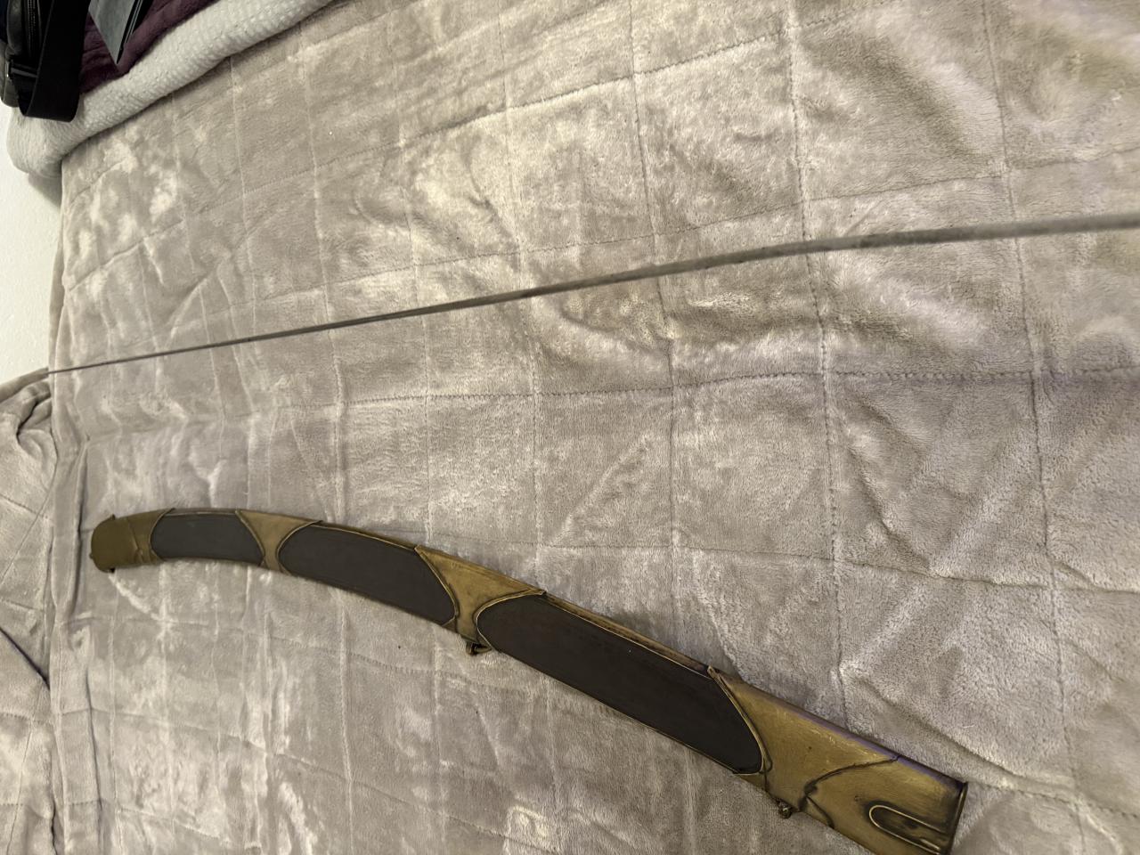

I took pictures, but after i examined the saber completely( i bought it and put it aside didnt examine it) im a shamed that i bought this fake, it is sooo good made on surface, i was sure im buyng real saber in great condition, but blade is so soft i bent it with ease, ring holders got no wear, and wood in scabbard is darkened on the entrance 10 centimeters later, it is new!
This is so emberasing, i bought something in a hurry that im not familiar with, and boy i bought it!
Every school costs.
So please be careful, examine things you buy in peace and 100%, and treat them as if they are fake, when you relax a too much and get secure that is a moment you fail and trip.

As you can see, there are no signs of wear or age on the rings, which would be expected if it were an old, worn piece. Unfortunately, that is not the case, so this is probably not an original saber - as beautiful as it may be!

Yes, i didnt checked that when i was purchasing it, on this type of "military saber" i would definetly expect that place to be worn out, if it was caried, but why i didnt check it out is becouse saber in general looks little carryed, so there wouldnt be that much wear there, but there is no wear at all, not even 0.01 mm, as other things on saber indicate (leather on handle worn out, bruises on scabbard (metal parts), blade etc, but leather on scabbard is also in too good condition for saber that is worn, it is relatively soft leather.
But i encountered on some turkish and persian saber which are original and 100% genuine, that there is no wear in ring holders, why i realy dont know, maybe they werent caried on the body like this saber but was fixed to horse, they were caried by high ranking warior and saw little use, on the back secured by strings etc.
But it is interesting thing, so wear on place where ring is isnt allways indicator of age, and doesent wear out like on others, materials, way of carry, way of construction of ring holder etc.
But this saber is undoubtadly not genuine, somebody gave a lot of efort to make her that good looking.

I looked at the photos of the FRINGIA saber again. It seems possible to me that the forger only made the then missing scabbard. At least I can't see anything on the saber based on the photos that suggests it's a fake.

If you look at the pictures in post #15 you see that it was easy for serdar to bend the blade and deform it permanently. I can't believe that this is possible with an original piece.
Also the patination of the brass fittings of the handle looks as artificial as that of the scabbard fittings. Regarding the authenticity of the saber, I'm not as optimistic as you are.

I overlooked the bended blade, now it is finally clear.

Ouuu blade is so well made, it looks real 100% BUT it bends like butter, im not egsagarating it is so soft that there is no way you could make a sirious damage with it.
I dont get it if they put so much effort in that forgery, why not make good tempered blade....?
One thing blade when struck with nail sings like its tempered but it definetly is not!
And on that other fake polish saber, blade snaped when i bent it, martensite like steel structure, some mix of steels acid aged.
