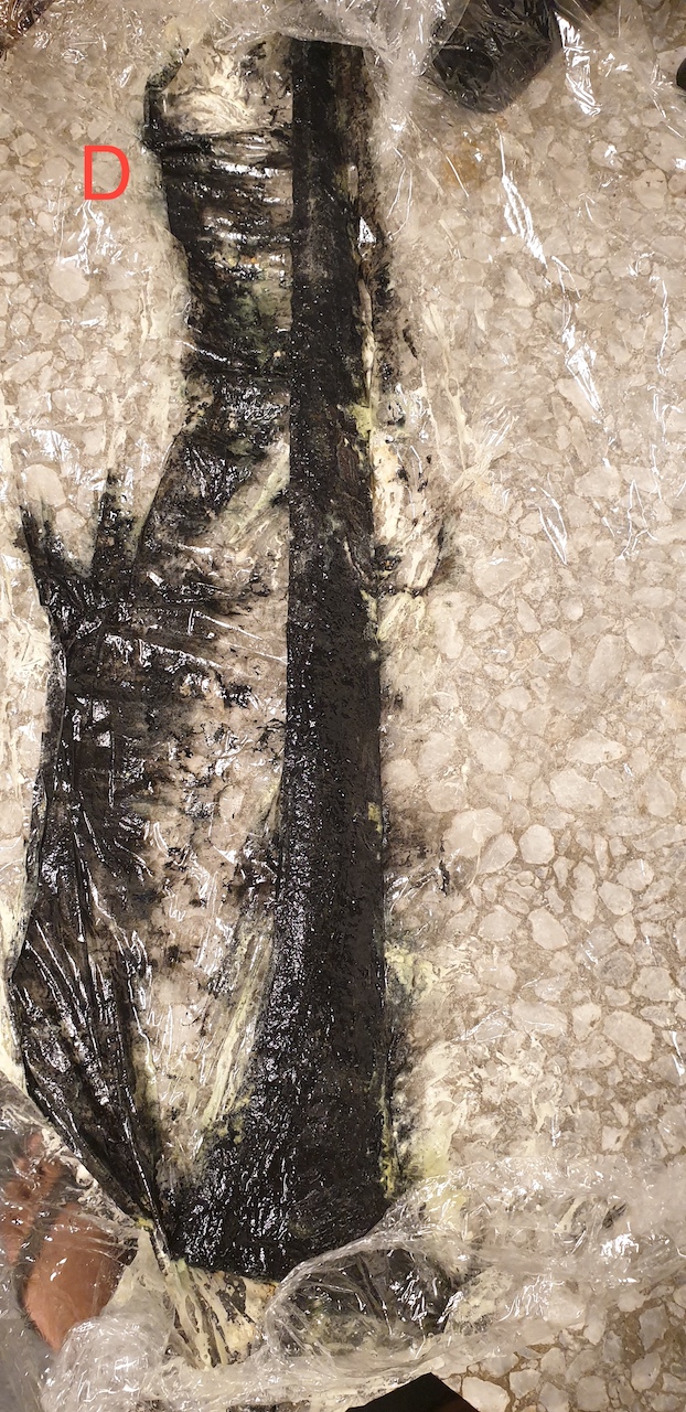

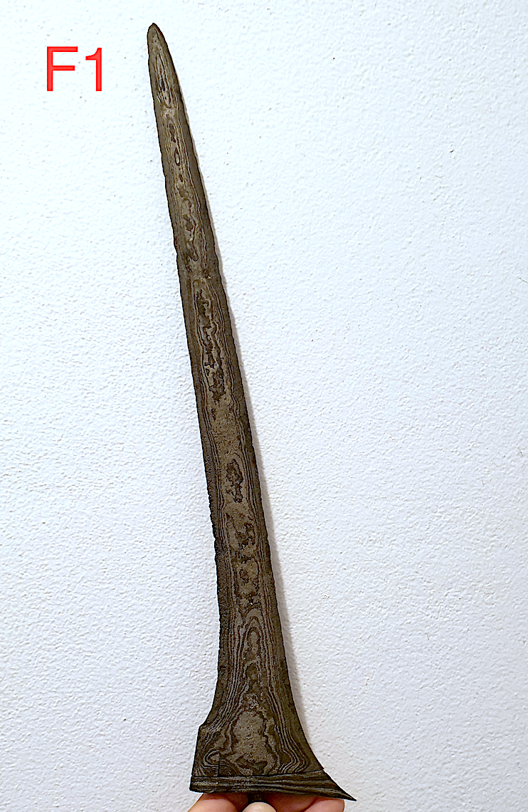

This post is to show the results of staining using a sulphur, salt and rice water slurry on a keris lurus Bugis.
I had attempted this in 2018, the year I acquired it, though I abandoned mission after less than 24 hours because I was a bit more precious about this item than I am now. You can see the results in post #27 here.
Now this keris has become somewhat of a learning vehicle for staining.
I had tried realgar and it did absolutely nothing so I wanted to try sulphur again but this time for a full 7 days.
I am quite happy with the result. It is a little patchy in some areas but I expected this to happen and controlled for it as best as I could. I would definitely try this again with another blade if I needed to stain it, and in absence of good warangan.

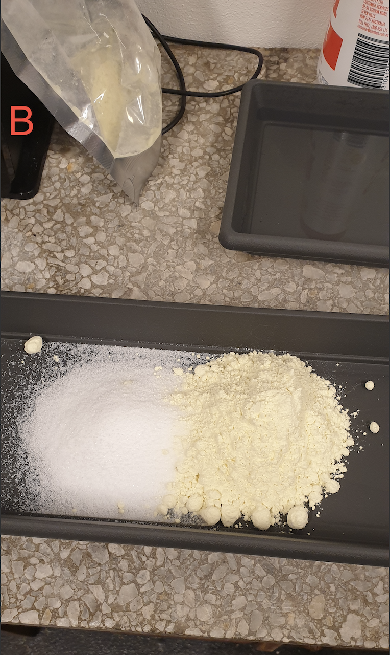

Ingredients
* Sulphur, pulverised. Generic off eBay.
* Table salt.
* Rice water - collected off the first rinse of a pot of jasmine rice I was making.

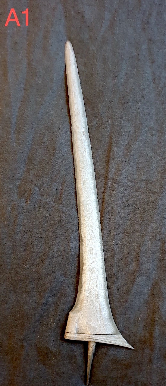

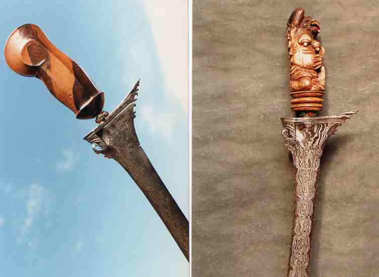

(A) Before the staining
(B) The salt and sulphur in a plant pot tray. Roughly equal amounts.

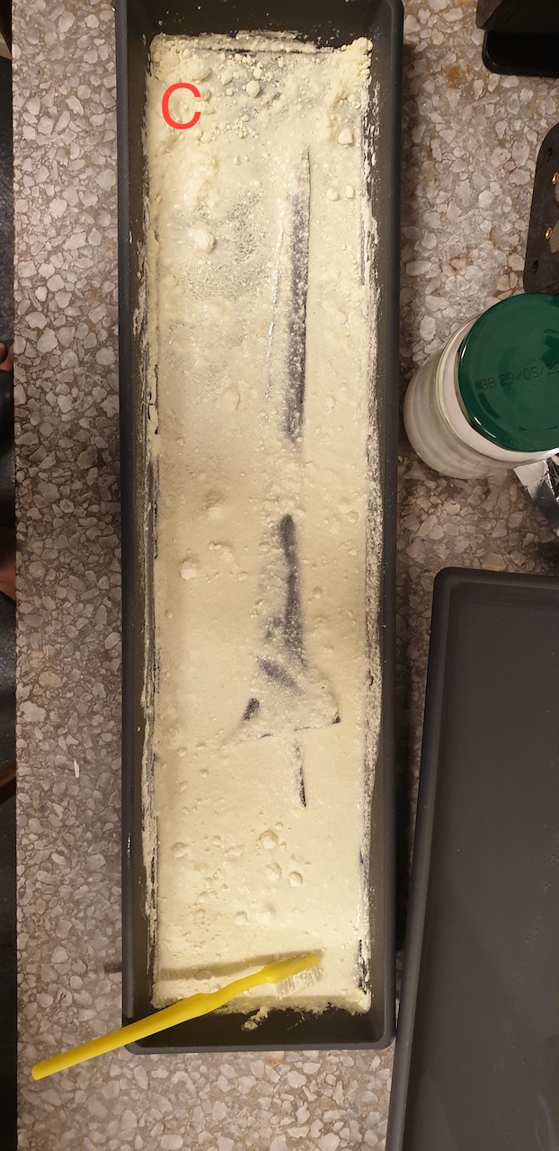

(C) The consistency of the slurry after adding rice water. Sulfur seems to want to stay powder dry and it does not dissolve well. This slightly improved over the days.
(D) After 24 hrs. Jet black thick ink-like substance. Some areas were a little more exposed so I reapplied the slurry using a tooth brush. From this point on there are no more reapplications.

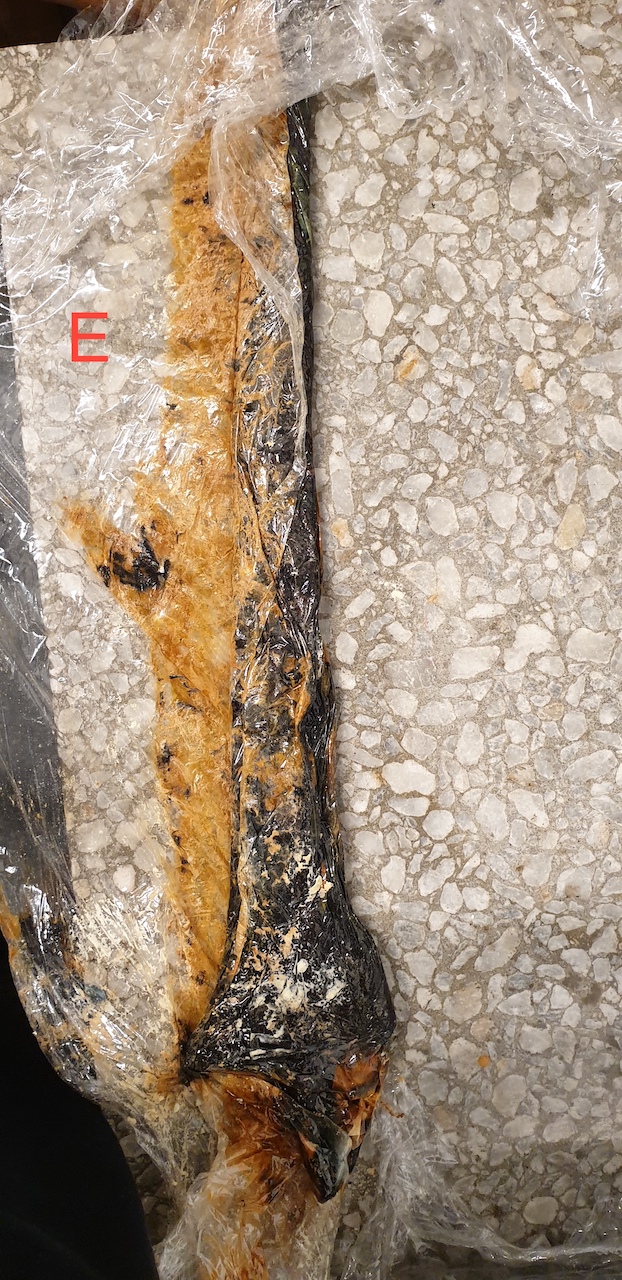

(E) After roughly 4 days. A rust-coloured residue developed. I have not reapplied anymore since after day 2.

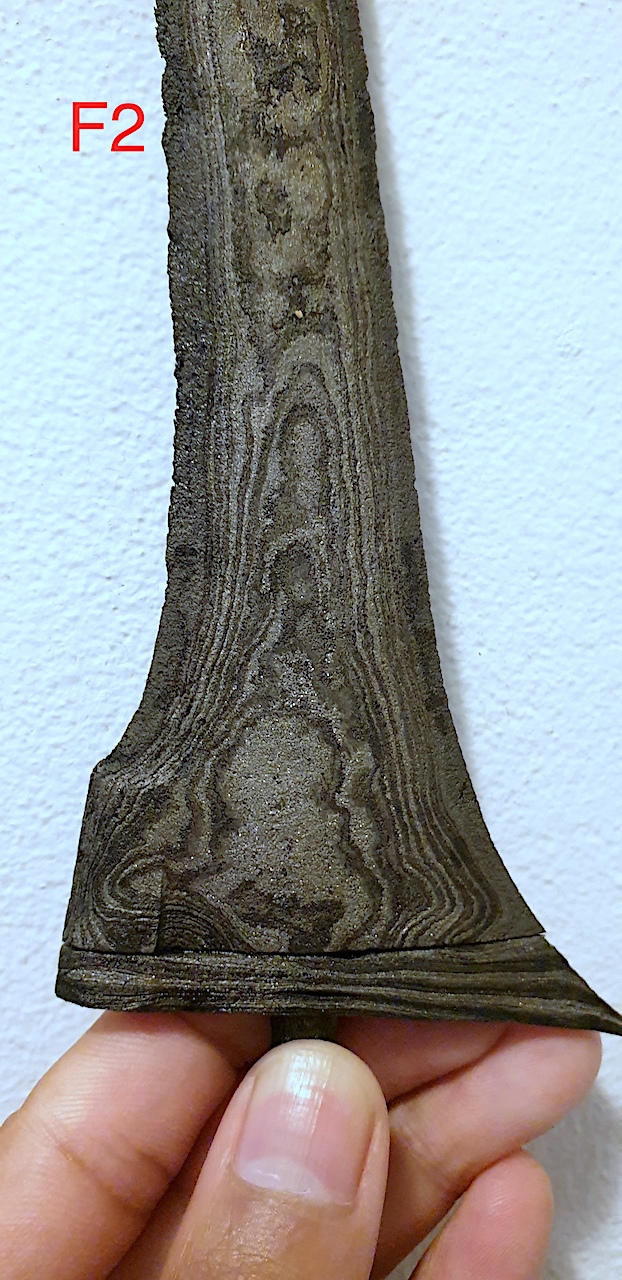

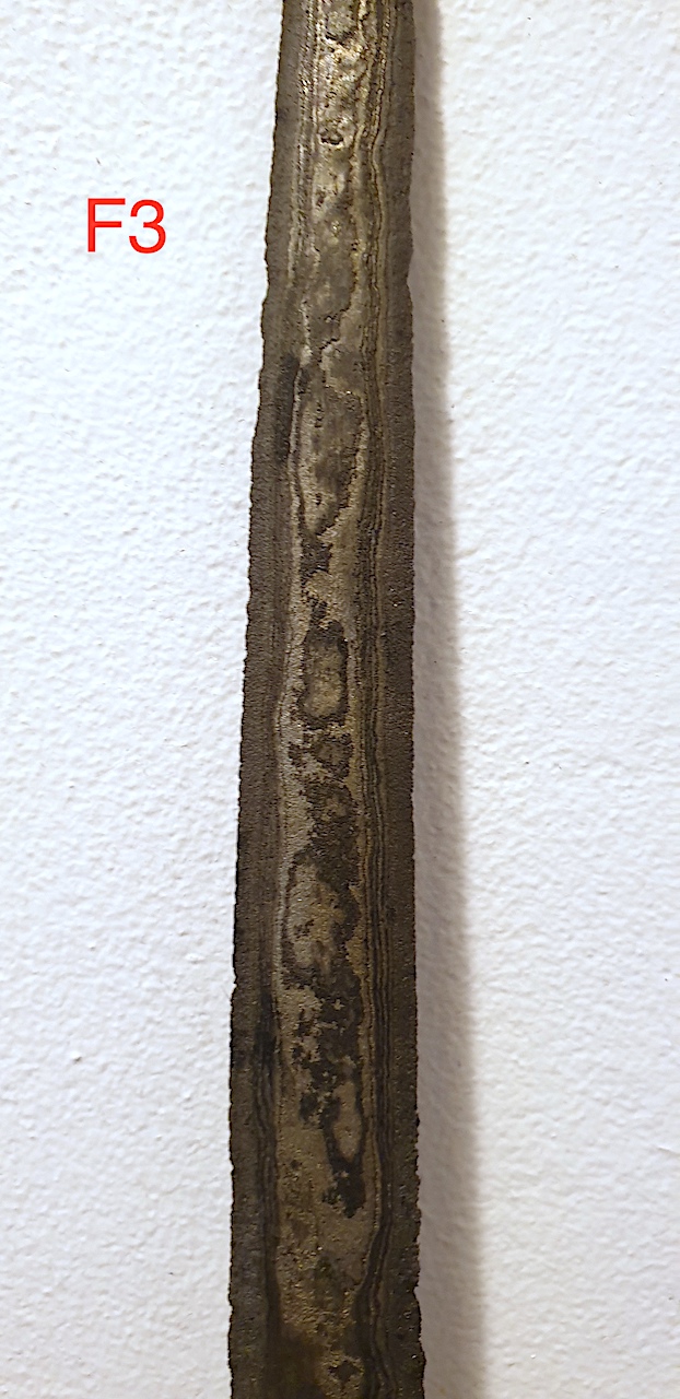

(F) Results after scrubbing (see 9-11 in the Method). As you can see in F2 and F3 there are tinges of surface rust starting to appear due to being exposed too long to air without an oil to protect it. I spent too long between drying and applying WD40.
