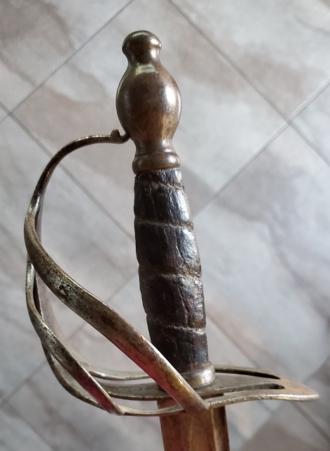

This ivory grip lion head officers sword appears to be for light dragoons officer of c.1770. The four slot guard was well established at this time with its apparent advent in c. 1760s, and light dragoon troopers had this type guard with some having two branches, iron, and tall olive pommel.
There are no markings on the montmorency type cavalry blade, similar to other blades of light dragoon swords of this period.

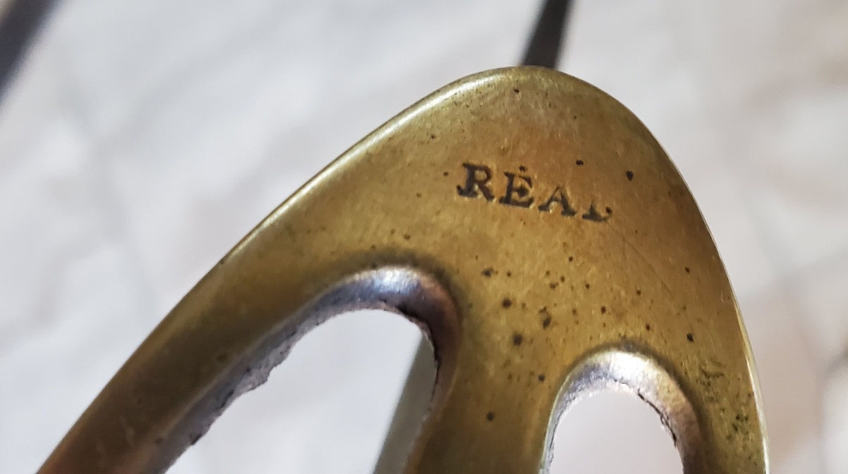

The only visible marking is deeply stamped READ on the hilt.
Read may apply to several cutler/outfitters in Dublin around 1770.
The most likely would be John Read, at 4 Parliament St. Dublin whose brother Edward was apprentice there as well . (as per Annis & May, 1970. p.331).
These lion head pommels were well known around this time and are known also on other hangers etc.

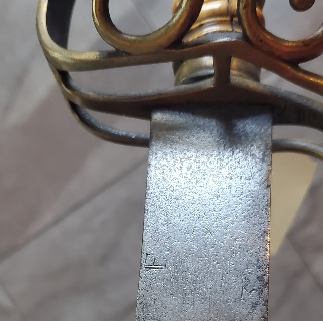

Is that something inscribed on the blade?

Yes, it is a capital F near the edge.........a 3 near the back. ??????

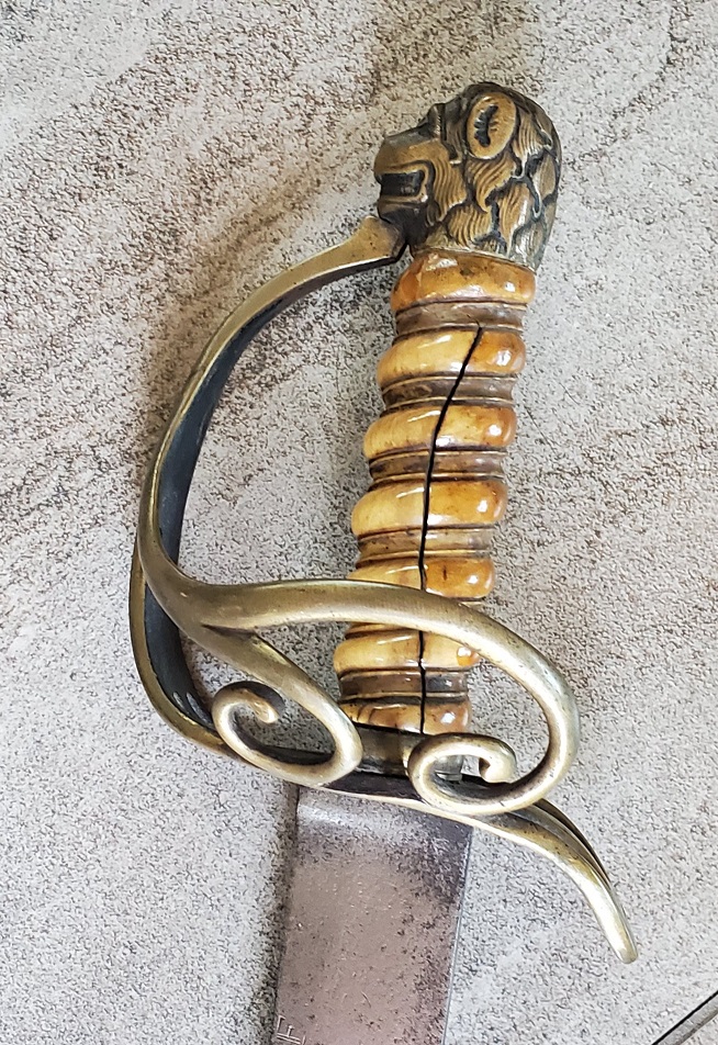

Here are more photos of this British officers lionhead dragoon sword, which appears to have been retailed by Read, a cutler in Dublin c. 1770.

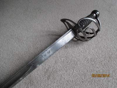

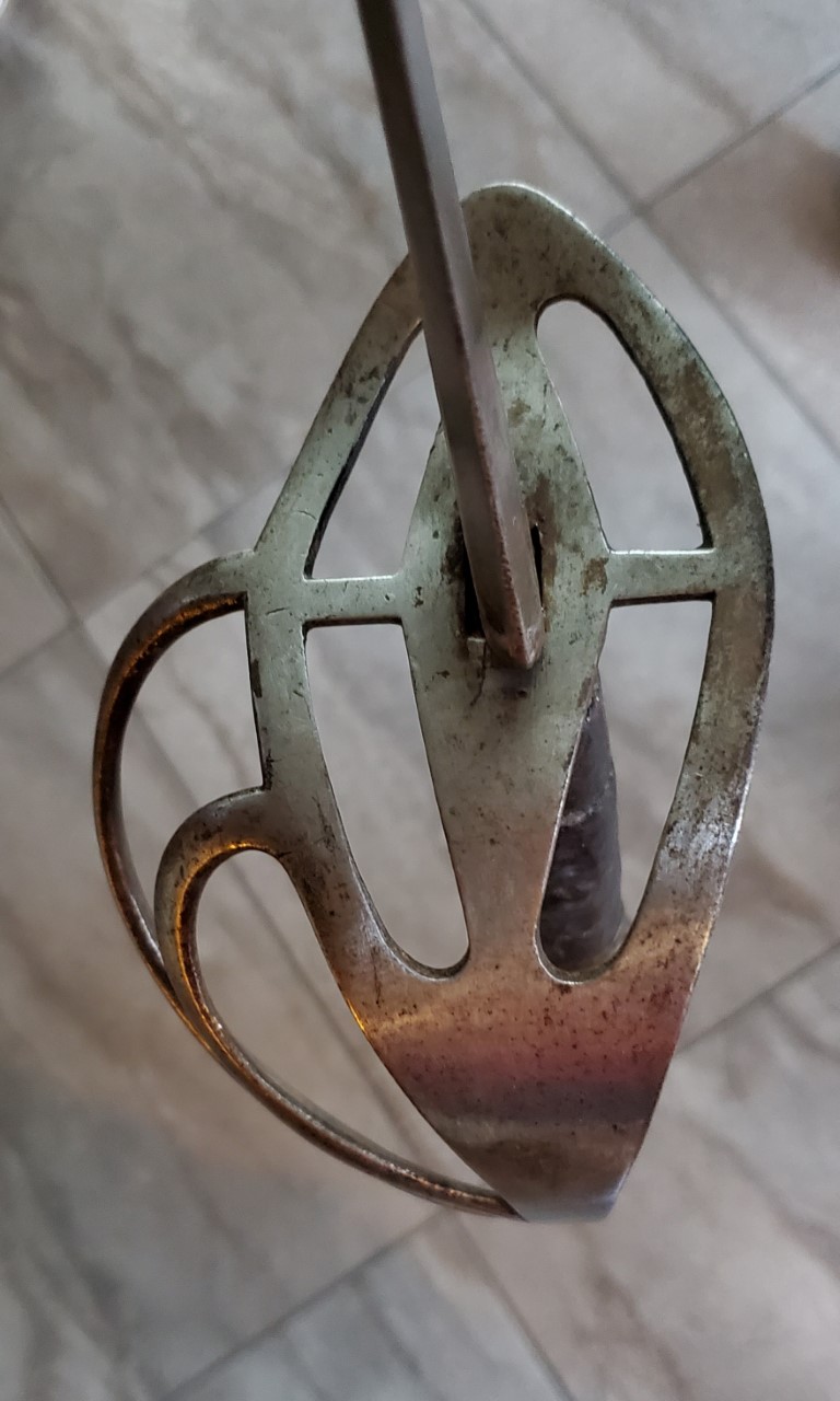

I have added another light dragoon sword of the four slot category but with two guard branches, also of c. 1770 for comparison.
I have added photo of the F and 3 which are seen on the blade parallel near back and edge.
The light dragoon is unmarked and with a German montmorency section blade of 35.5", and iron hilt.

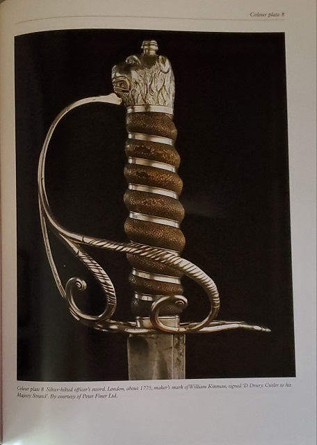

The illustration from "London Silver Hilted Swords" (Leslie Southwick, 2001, plate 8) is of of a similar hilt style, lionhead c.1775 by Willian Kinman and the blade from Drury (Birmingham cutler). This illustrates the lionhead pommel style hilts popular in 1770s.

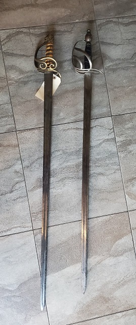

Jim those are two very good swords having style and function.
Two similar swords of mine pictured.
