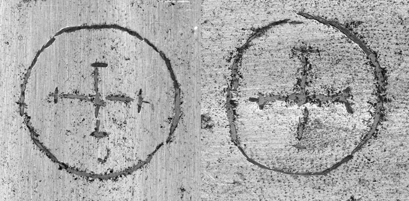

Not the same as Iain's marks, but executed in a similar manner, are a pair of 'cross in circle' marks from either side of the blade of a great sword of war that Christie's opined to be 14th century that subsequently met the fate of being tarted-up in the late 16th century into a bearing sword, though some of the structurally shabby decorative mountings are probably even later. Or maybe the whole thing is an atavistic exercise from the late 16th century, though I feel Christie's interpretation is quite plausible.

Thank you Iain, and Lee for addding the additional example. I am inclined to agree with approximate 14th century period for this blade shown in Christies, as these kinds of crosses (various forms of Greek cross) were well emplaced during the crusades. As earlier explained, the placement of crosses were not only a component of ecclesiastic authority in signatures of bishops and abbots which appeared on blades, but attained probable talismanic properties, as noted in the practice of placement on scabbards and blades.
While the cross and orb is known to have presence into antiquity, it seems that these medieval interpretations carry similar allegorical symbolism, which of course the orb, or in this case circle represents encompassing the world..the triumphant cross concept. The placement of the lines on the arm terminals on this Greek cross is simply another of the many variations used with the fourchee (forks or more embellished 'moline') being another.
I am inclined to doubt that the use of these types of marks can be attributed to a particular workshop or exact period, but a range of period may be established in grouping examples which have similar types. As far as makers, there are cases where certain ones have been associated with having been known to favor certain types...such as Heinrich Koll (Coll) often used the cross and orb..to the point that observers felt it notable. The case of the flourished 'anchors' which likely developed from cross and orb symbolism seem to have signature type embellishments which may be attributed to certain makers, but that is far from being accomplished as far as I am aware.
As Iain has noted, and Lee is keenly aware, the character of the blade becomes one of the prevalent identifying factors in cases like these. While many marks can offer compelling evidence, they were of course used extensively and often relatively randomly by many makers over extended periods as well as being copied widely. This is in no way diminishes thier importance, but often requires considerable supporting evidence by other comparitive examples and detail to accurately use them in identification.
As Lee has noted, atavistic renovation using heirloom or venerable blades was practiced in western settings much as is typically the case in ethnographic native situations. Blades often had extensively long working lives and were often remounted through many generations. In looking through the Wallace Collection reference by Sir James Mann it is interesting to see how many instances there are of older blades on later hilts, and incongruent nationality in blades and hilts. Often many swords described as 'composite' are actually these kinds of weapons, refurbished with components of other usually similar weapon types during thier working life to maintain serviceability.
Many venerated old blades which had become in degree 'relics of combat' were remounted and did become as I understand, bearing type swords used ceremonially as symbols of authority.

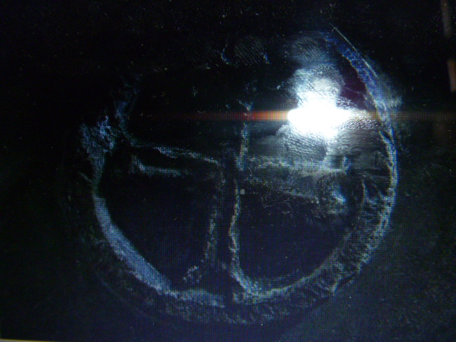

Still doing as much reading as possible, but thanks to a kind chap on a more European oriented forum, I was pointed to this sword that Christies auctioned off. Mid 14th century, same type of cross, same type of incised lines. Similar blade profile.
http://www.armsandarmourforum.com/fo...der-the-hammer
A photo of the mark attached here as well for forum archives. There are other examples as well I am finding, some with the double circles as in this case.
In light of this, I can only say I think Lee (and Jim) have been spot on and I am quite happy about being able to realistically say I think my example should date mid to late 14th century.
