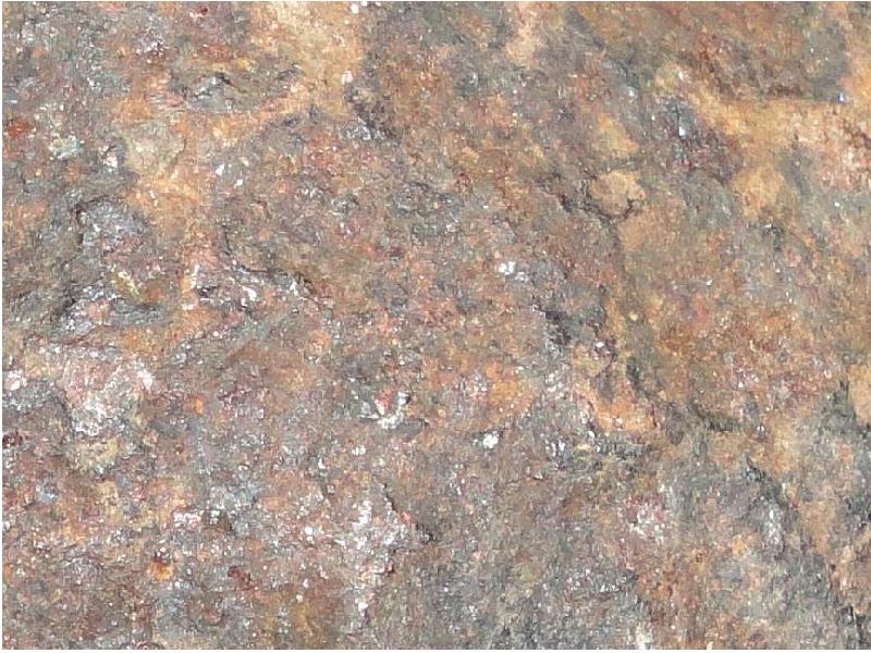

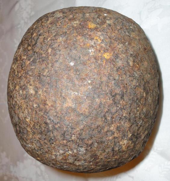

Default Ever heard of a cannononball .. ovoid?
This item lacks the basic condition for a ball, as it is not round ... but ovoid.
However the (non professional) seller guaranteed this is surely a cannonball, kept by the family for a long time and having been found in a place where actually plenty war confrontations took place, both internal and Napoleonic.
The weight and average diameter coincide with an 18 pounder.
Byt i don't think this thing could be fired as it is; neither its deformation could be achieved by rolling on the ground after being shot ... it wouldn't become so perfectly ovoid.
On the other hand, its texture looks exactky like that of a 18th or 19th century cannonball.
What do you gentlemen think of this?
Ever seen one like that?

Hi 'Nando,
I am afraid I've never seen or come across a cannonball of such unique shape - ovoidal!
What practical sense could it possibly have made?
Fitting and rotating in a cannon barrel? No way, I would say.
The only use I can think of would be throwing it from a catapult but then we would have to seek its "date of birth" in the 14th and 15th centuries.
Highly interesting piece anyway and one of the unsolved riddles in historic weaponry ...
Thank you for sharing this, and I do hope for some brainstorming from our members!

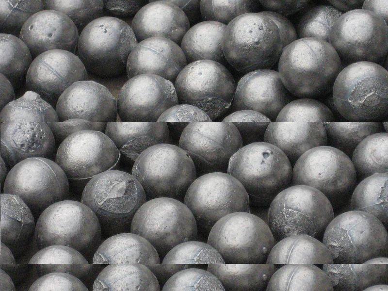

interesting cannonball site:
Linky
my first impression of the faceted surface was it was a worn ball mill ball....

I really dont know much on artillery or ballistics, but I am inclined to go along with Krockew and think it might be a mill ball, from another field foreign to me, metallurgy. I have learned a lot from discussions with you guys and others outside our discussions which have included some that brought up these rather mundane utility type objects, which still in thier own right, have become interesting antique items.
I would think that the ovoid shape would lend better to tumbling action, which would be important in crushing ore.

Thank you all gentlemen, for your input.
I had already been in that link website during my browsing, Wayne.
It appears to me that this is not likely to be a mill ball.
Those spheres are usuallly hardened steel, whereas my example is iron.
I have phoned a cement maker technician; the wearing of mill balls has a smooth texture.
Also i think that a mill ball, worn by continuous random tumbling, would get a alietory shape due to its variable movimentation and not such a regular one, which looks to have been submited to a specific rotation, orientated in a linear direction.
I know nothing about metalurgy either, but probably a steel mill ball woud not degradate through time in the same manner, with such corrugated and scaled look.

The shape of this ball could also be a result of poor casting.

Sorry to come in late on this one with my .2 cents. Agreed it does resemble an iron cannon ball more than a mill ball. I bought what I thought was a cannonball a number of years ago, but under the grime, it proved to be a steel mill ball ( ).
I think this is a cannon ball, perhaps used as hotshot and deformed on impact. I have seen (hee hee) balls with flattened sides and bent/deformed bar-shot that struck hard structures.
Still another possibility is that this is a cannon ball made using the 'shot tower' method. I've included two sites explaining this innovative method of making cannon shot, and although one confesses that the balls produced were perfectly round, I beg to differ. Confederate cannon balls were often ovoid, had rough seams, were oblong, etc. In any case, a dropped shot could explain the deformity in times of desparation during war-time. I imagine it would still have fired poorly, though...

I keep looking at the dented surface of the thing. I suppose that could be corrosion that was cleaned off, but I keep thinking that some poor blacksmith got the job of trying to hammer a sub-par cannonball (or a too-big cannonball) into a diameter narrow enough for them to use it with the gun they had. It could also have been a really ugly cannonball that was discarded as too crappy/dangerous to fire.
After all, we've been assuming that it was fired, and I don't see that anyone has presented evidence to support this idea.

How would i guess that the posting of my atypical ball would result in such a treatise on cannonballs.
Hot shot and shot towers would certainly never dream of making part of my vocabulary!
I finally located some data on the use of hot shot in old Portuguese (and Brazilian) coast forts. It was a question of having not browsed with the right term; here they call it bala ardente (burning bullet).
Considering Fearn's reasonable suggestion that this ball was not even fired, having been discarded due to its faulty construction, one question arises: why then wasn't it discarded right after casting inspection, instead of going to take a risky chance to be used in campaign?

You will forgive me Fearn but, resizing cannonballs on the battlefield, sounds pretty fictional to me, even assuming the artillery officer had flour in his head, instead of brains.
Even if the issue were to adjust only one ball, which seems rather insolit, it would have to be a sculptor's work, to reshape the thing with the necessary profile ... not a task for rank and file .
More plausibly i would accept this is not an actual cannonball.
