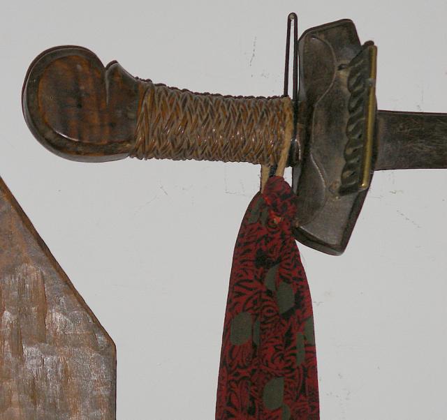

Hi all!! I know you have seen a plethora of these, but it's my second one and I'm really happy with it: nice blade lamination, nice carvings, nice patination of the wood, iron guard... I'd like to restore the hilt rattan wrapping so any suggestion is welcome!! I already find the old treads to how weave rattan.
Especially I'd like to know the width of the rattan I need. Attached are also a couple of pictures of Rick's kampilan, I'd like to do something like that.
Thank you an HAPPY NEW YEAR!!!

Thank you Rick, you are very kind Can you give me the width of the rattan? the one used for the handle and the other crossing over the first one (yellow color)? Thank you so much!

Hi Flavio, here are the widths of the rattan strips .
I hope you don't mind doing the conversions from inches to mm .
The three bands on the handle are 1/32 of an inch wide strips; they are plaited double strands to make the bands .
The outer wrap is of rattan a bit wider than 1/16 of an inch .
As I say, if you'd like 360 degree shots of the overweave etc. I'll be glad to provide .
That is an old hilt with a beautiful patina from long use .
Good score !!
Have you thought about staining the rattan with either strong coffee or tea ?

Hi Rick, thank you so much!! Yes if you can I really appreciate 360 degree shots, thanks again and yes I was thinking of staining the rattan with a mixture of coffee and tea. Than I will pass on the rattan something like shirluk to protect and to make shiny the rattan.

Ok, I think it is finished, but I'd like to know from you what do you think on this: maybe I have gone over the restauration... I have added also an old (more than 100 years old) piece of rope, maybe it is better to remove it? what's your idea? and about the over wrapping? it's better the first version with a more simple wrapping? Sorry for the dark pics and the others with flash on, but here is already night...

Thank you Tim and Rick! So do you think that is not "too much restored"? something like a "fake"..... How much far one can go with the restoration?

IMO it's fine; I'd even darken up the overwrap a bit .
Are you having second thoughts ?

I was thinking that maybe I have esagerated when I have added also the red rope... You know that if you believe that the rope is like an amulet, well in this case is really a non-sense to put the rope, but I have done this because another explanation, as Cato says, is that this pieces of rope were used also to assure a better grip...
About the overwrap is just a bit clearer than the wrap under, just the flash do not show the real color

The sash ?
No problem ...
Adds a nice touch !
