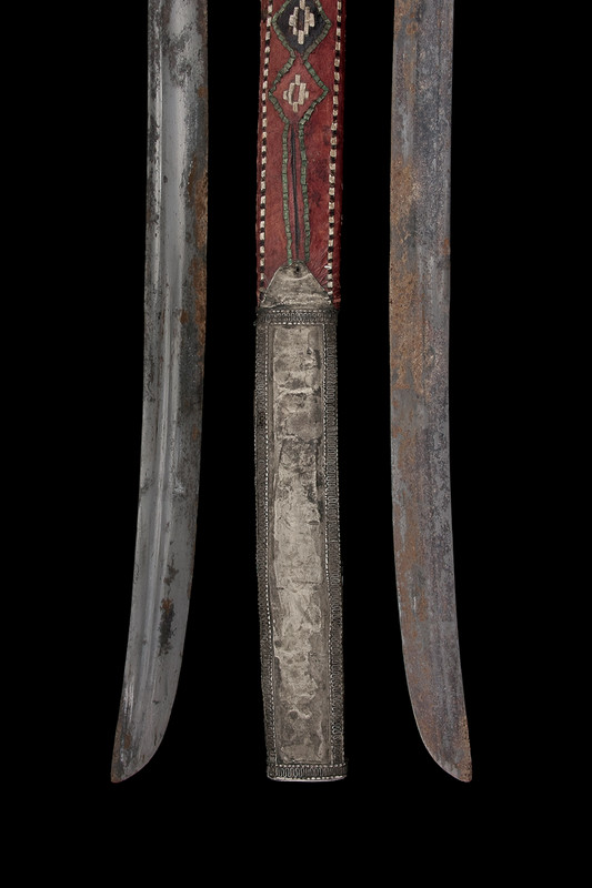

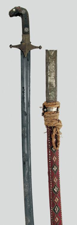

hi,
I ve just bought this arab sword... I think it could be an arab saif ... but im not sure...what do you think?
Heandle is horn with silver , blade is little curved with silver scabbard.
thanks

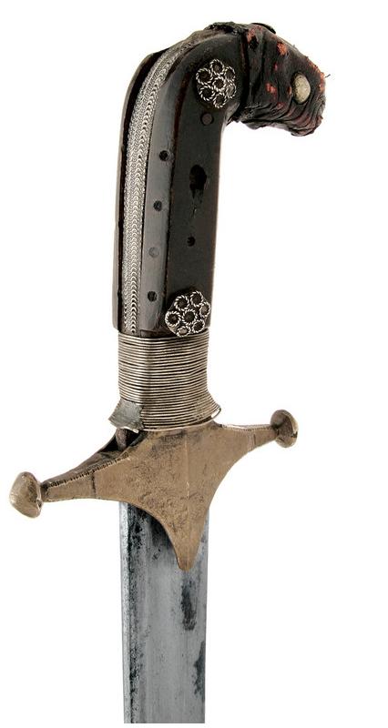

saif just means sword in arabic. This is a shamshir. blade is cut down silver on hilt decoration is new. that crossguard looks new and does not fit. pretty much it looks like a put together piece

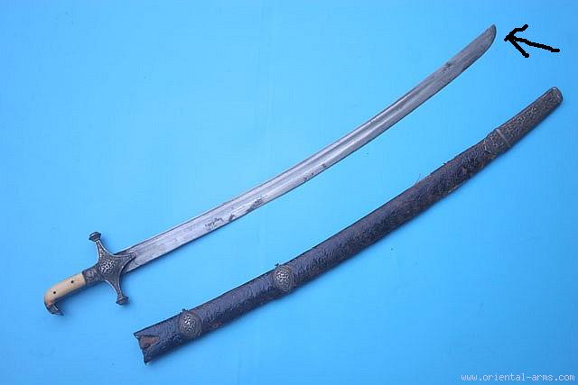

but i think thant is not cut...it is long 90 cm ... is impossible that it was more longer...or not?
please see this saif sold on oriental arms ,blade is similar...
Old 12th March 2008, 02:31 AM   #4
ward
Join Date: Feb 2006
Posts: 637
look at the fullers on yours and how far they go to the tip of the blade compare to the pic of artzi's shamshir.

yes, but blade is not curved like turkish or persian shamshir....
becouse you think that it is shamshir?

Yes, it is definitely an Arab Saif. And I agree with Ward - based on crossguard and hilt assembly, it looks like it had been put together/repaired recently (not necessarily yesterday, but not too long ago:-)... and nothing wrong with it, as many swords are this way. The handle is old. My first guess was that it had been put together in Yemen (based on wire decoration on the scabbard). Since the blade is 90 cm long, I am not sure it was cut (90 cm is a long blade already). Ward, what do you think?

The only reason I am saying it is cut is because of the fullers running all the way out to the tip. The length is correct. I think the original sections of this sword probaly date to around 1900-1920 the rest 1970-2008

As Don, said, i would also say ive never seen anything like this..... The scabbard throat, chape, and the hilt and fittings are all in the Nejdi manner, a "Gurda" the blade most probably European. Although the hilt has some strange "syrian" influence to it.
May I ask about the the scabbard material?? is it of woven wool?
S.Al-Anizi is offline   Reply With Quote
Old 13th March 2008, 10:30 PM   #11
BerberDagger
BerberDagger's Avatar
Join Date: Jan 2007
Posts: 247
thanks for reply...
Scabbard fittings are made of good silver.... wood and red leather...
please if you want other details let me known
thanks
