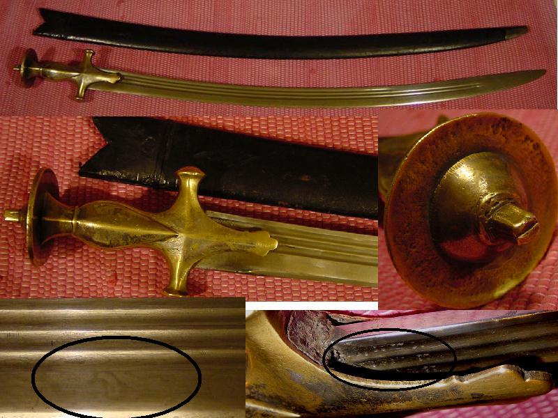

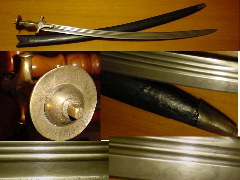

I am not sure on the seriousness of this one, on what touches
the hilt, which is nickel plated (chromed ?) brass. The seller says it's 18th century, but that could be his story.
The blade looks fine, with its three fullers, the top one ending where the false edge starts. Some "intentional" dots at the forte, mostly under the langet, look like some kind of mark.
I think i see some activity on the steel ... could it be wootz?
The scabbard is recent. Seller says 19th century, but i wonder.
I will be glad to receive some coments.
Thanks
Fernando

Hi Fernando ,
Sorry to say ...but I am certain it is not wootz A lot of Tulwars have similar forge patterning but the majority are not 'pleasing to the eye' when etched. How thick is the spine?
Regards David
the hilt, which is nickled (chromed ?) brass. The seller says it's 18th century, but that could be his story.
Commercial Nickel plating started in Europe about 1850, so mid 19th century is the earliest possible date. {IMHO]
spiral
Old 17th November 2007, 10:42 PM   #4
Hi David
Thanks for reacting .
The spine is hardly 5 m/m.
I know nothing about wootz. I have made such question because i distinctly see the reflexes of a low intensity "waving" on the blade edges, as if it were a Japanese blade (hamon?) ... or some sort of that. Whatever it is, it sure is not plain .
Fernando
Old 17th November 2007, 10:52 PM   #5
spiral
Thank you Jonathan.
I suspected so. I wonder wow quick did the nickel plating process reached India. -That would count also.
Fernando

Posts: 1,097
Hi David
Fernando

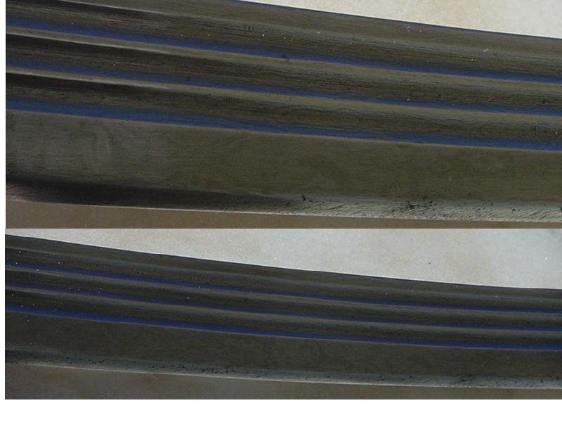

It is not uncommon for Indian blades to have this wavy "hamon" effect along the edge and this is due to a tripartite blade construction where you have a high carbon edge inserted between softer "cheeks" of pattern welded steel. Heat treatment along the edge will give this wavy undulating effect and I wouldn't be surprised if the blade is quite sharp or would take a good edge. The blade seems a good one given that construction plus the fullers are crisply done which shows a bit more attention to details.
Old 17th November 2007, 11:43 PM   #7
Thank you for your knowledgeable coments, Rick.
I am glad you got my meaning.
It is indeed a sharp edged blade. No wonder the seller kept emphasizing its quality, as he knew what he was offering.
Probably if i was at home, with more conditions and a camera tripod, these efects would be more noticeable. But i trust that you saw them in the present pictures.
Thanks again
Fernando
Thank you Jonathan.
Fernando
I was thinking ... the hilt could have being plated long after being originaly cast ... not necessarily ... just measuring the possibilities.

Posts: 2,718
Fernando,
What should be said about the tulwar has been said already. The square on top of the hilt is however strange. I don’t remember having seen such a square before. The tulwar may not be very old, but I don’t think it is as bad as many other we see, and it does have a nice looking blade with nice fullers like Rick says. It is hard to tell if the plating of the hilt was made when the hilt was made or later, but both are possibilities. We see the pictures but you have the tulwar, how is the balance of the blade?
Jens

Posts: 4,281
tulwars, like kris, were often re-hilted. there was even a thread here discussing that the indian armouries would keep the blades and hilts dismounted until just before a war in order that they were not available to mutineers, casual rioters and revolutionaries.
thus the hilt may not be the one the blade started it's life with.

Hi Jens
Thanks for your coments.
Concerning the "cubic" finial on the hilt, i am pleased that, at least something in this tulwar is unusual to your experienced eyes, for the good or for the bad
I must say that, after all, im am not so unsatisfied for having bought this piece. When i feel in doubt about the hilt, i just have to look at its nice blade.
About its balance, i am not a good judge, but i find it quite easy handling, discounting the usual problem with the hilt size.
It is quite a light piece, considering its 68 cms. blade and only 647 grams weight ... the three fullers counting on this.
Hi Kronckew
Thanks for your support
Eventualy it was i who posted about tulwar hilts being stored apart from blades, according to a book i have read and which caused some skepticism from the part of some members. I later had talks with the author of such book, and precisely as you note, he comented that tulwars were often hilted and rehilted with unfamiliar components, something hard to happen with European swords.
All the best
Fernando

Posts: 10,824
I just wanted to join in, and as Jens has noted, most that can be said on this sturdy tulwar already has been said. I agree it is of 19th century, probably late, and the blade is of cross section and profile that seem pretty well established on tulwars of this period. By this time, the British Raj had created considerable commercial enterprise with weaponry and outfitting for the occupying forces there.
I wonder also about the square nut on the pommel. It seems tulwars typically had a capstan with pierced hole that I understand was for unscrewing and disassembling the hilt. Is it possible that this square capstan might have been for similar purpose but with more industrial application, a socket or wrench?
If indeed weapons were kept disassembled as has been discussed (I would presume this practice was applied in some cases but certainly not universally in various armouries) then such a feature would better facilitate assembly.
I honestly have not seen the square on tulwars either, but knowing the volume of munitions activity undertaken in arming the many Native Cavalry regiments for many years it was undoubtedly quite an undertaking. There were specific regulations for tulwars to be carried by these cavalry and I have seen listings indicating which type swords were to be carried. Some units had selected the standard tulwar, and blade lengths varied..I believe that Bengal for example were 31" while Madras was 33" or vice versa, cannot recall exactly. While the question concerning military inspection or armoury marks would be valid, many times such markings did not appear on weapons.
If interchanging blades to meet regulation when arms moved to other armoury, perhaps an explanation?
Just thoughts!
In any case, a solid example!
All best regards,

As resin was used to fix the blades ...it is not surprising that Tulwars could easily be re-hilted. Damaged hilts (broken knuckle guards, cracked quillions etc.) could quickly be 'fixed' in the 'field'. All you would need is a fire (to gently heat the blade), a replacement hilt and some resin. In a prolonged conflict this must have been an advantage to keep swords serviceable. It would also be easy to 'up grade' the hilt in peacetime. Bearing in mind many early European swords were rattailed which were 'peened' over at the pommel, hilt replacement would require skilled hands to replace.
Another, interesting property of the resin is it had 'shock absorbing' qualities relieving 'shock' to the arm as the blade made contact.
Jim, it has just occured to me.....could the choil be there ...so that the blade could be held securely whilst rehilting !!! Or is this idea not new.
Regards David

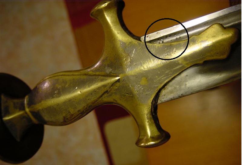

You and others will know better, but the purpose for the hole in current tulwar hilt finials is, or also is, that of fitting the hanging ring, for the use of a lanyard or the like.
As for my example, and to be precise, its finial is more a rectangular piece than a square one ... crudely made, so not impeaching the intention to have made it square. I wonder why it is split in two halves, at least in all its visible part.
In view of that, at first sight i don't see in this device a mechanical convenience for its dismounting by literaly turning it off. It could as well be embodied to the hilt, the disc and dome (pommel) being the moveable parts, both held by the dome, fixed by hammering ( welding ) it to the finial.
On the other hand, this assembly is restricted to the hilt per se, as the "hilting" of the tulwar is an operation that joins the blade with the allready set up hilt ... the tang not trespassing the whole grip, ending somewhere inside it.
As for marks, what i have in this specimen are certainly not explicit Ordenance marks, and maybe neither Armoury ones. Assuming they are not graphic symbols, they surely are intentional marks, with three repeated equal rows of dots ... not just steel or handling defects; possibly some maker's code ... what do i know.
I hope i made myself understood and with a low % of nonsense .
Kind regards
Fernando

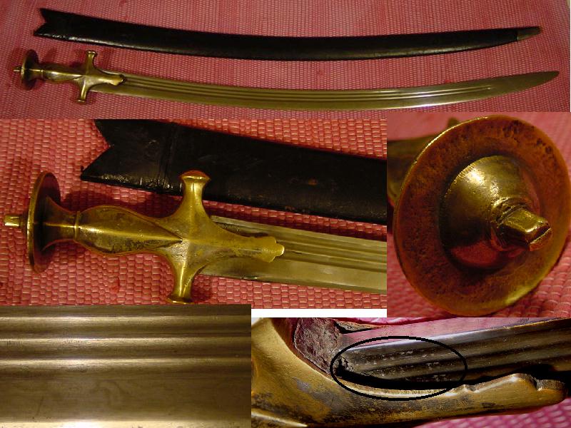

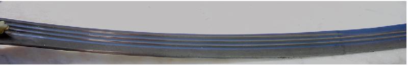

Here are pictures with different light ... and maybe some more accurate

Nice blade !!!
I think this blade is of traditionaly old Indian forged damascus steel with cloudy patterns.
I am saying this because some cloudy patterns are visible in the blade pic, i might be wrong.
Can you provide detail pics of blade???

Are you referring to the same situation quoted by RSWORD in earlier posting #6, where he used the terms "wavy undulating efects" ?
It happens that the cloudy efects in this blade are not so dense and i can not manage to get better pictures of it. Or are you referring to a different type of details ?
Could you also coment on the multi dots stroke near the blade forte ? Are they any kind of markings ?

Hi Fernando,
Thanks for observing my views, according to my view its a Cloudy or Wavy patterns. These days the damascus steel is generally made up of 512 layers while in old damascus steel there are not so much layers it may be 64 layers or lower layers only thats why it have cloudy or wavy patterns.
In my views its not an effects its a damascus steel only with Cloudy or wavy patterns.
These marks are makers mark only.
These types of blades also comes in plain carbon steel with fullers.
But i steel need a detail pic of blade for my conclusion.
sandeepsingh is offline   Reply With Quote
Old 12th December 2007, 03:22 PM   #23
Hi Sandeepsingh
This is the best i could get, hoping these were the blade details you meant. These situations are dificult to capture; they are certainly more visible at naked eye, although not much pronounced, as i previously said.
So the dots are maker's marks ?! Could you tell what region they are from ?
Would you agree that the brass nickled hilt is end 19th century, and the blade is certainly older ?
Thank you for your further coments
Fernando

Thanks for the more detail images.
Now i can conclude that the blade is made up of Damascus Steel with Cloudy or wavy pattern.
The hilt seems 20C. but the blade is 19C.
Dots or strokes are the makers mark probably from Rajasthan or Madhya Pradesh region.
