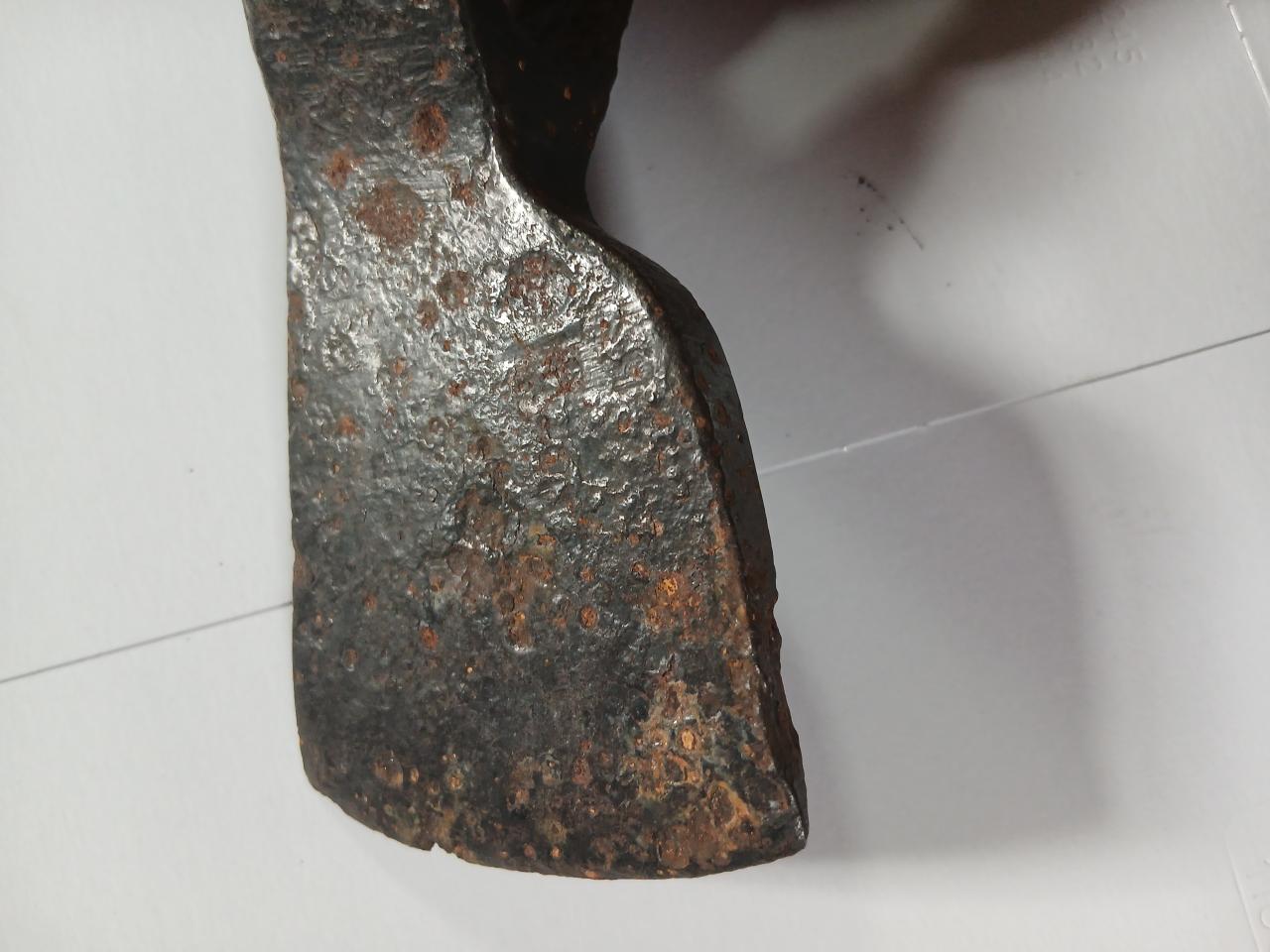

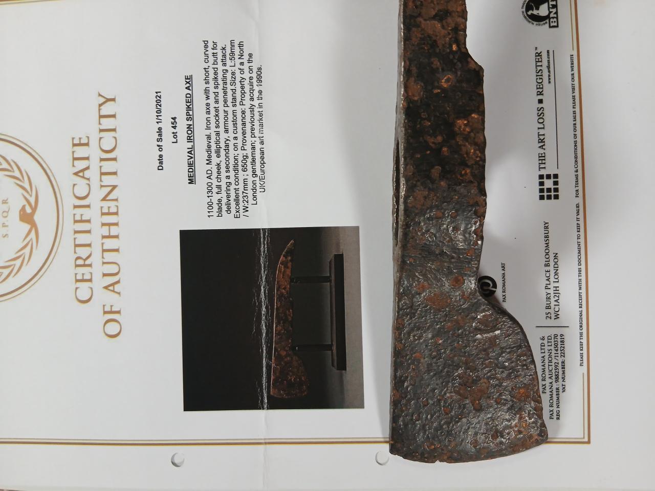

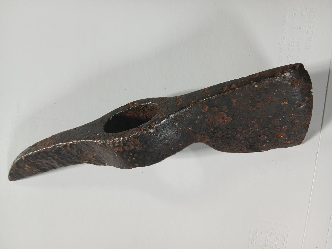

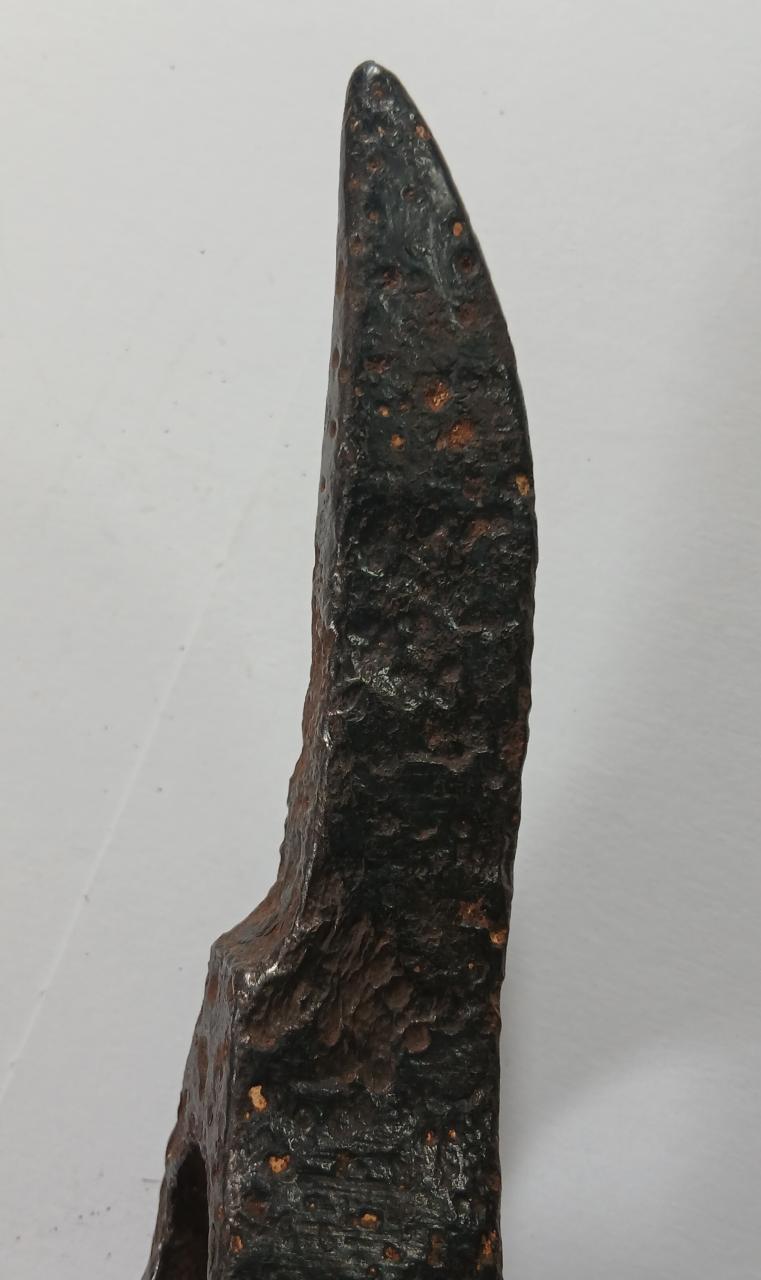

Old Yesterday, 05:03 PM   #5
francantolin
Posts: 969
Here it is
