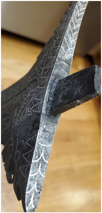

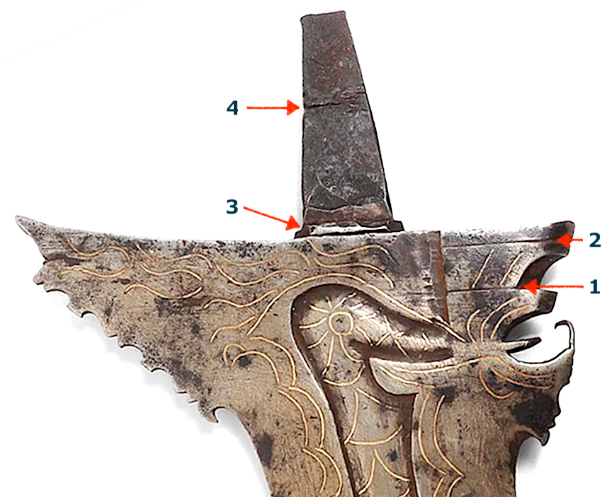

Interestingly, there appears to be a horizontal crack in the tang (4) at a point similar to where your tang appears to have broken. Perhaps a forging flaw that may have eventually led to this one also breaking."
Now this comment is really interesting (at least to me).
How to interpret this has me more than a bit stumped.
Same area, same forging fault; same Smith ?
