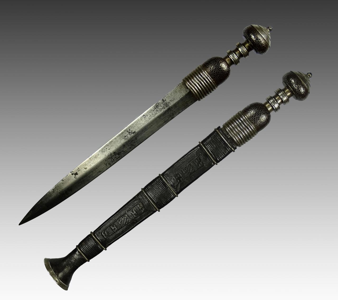

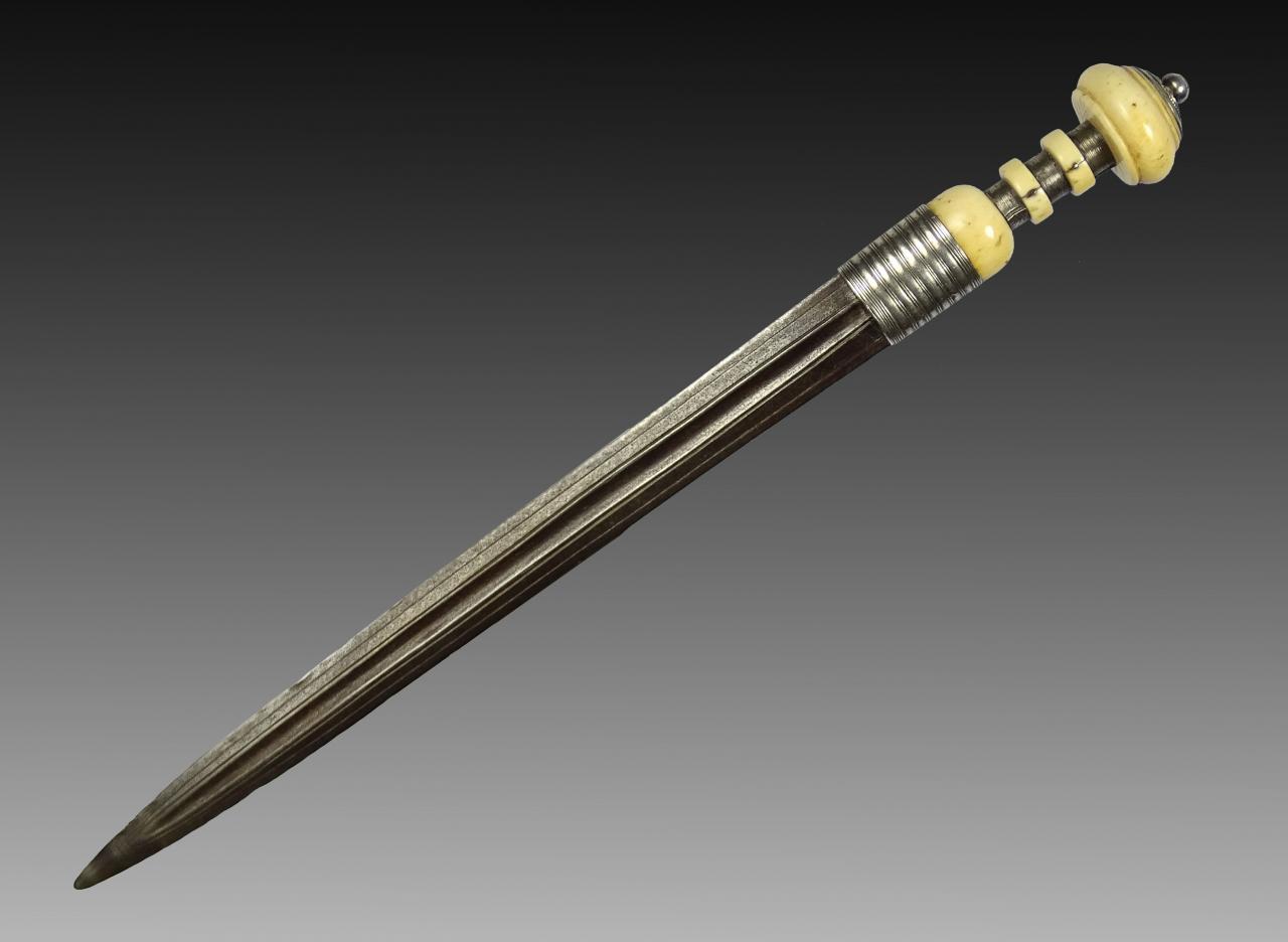

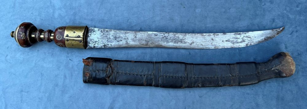

There is a tendency to label every West African dagger as Mande. Not sure is this is always correct, but I do believe the group of daggers shown here is indeed Mande. This is still a very broad definition, similar to labeling something as Slavic or Turkic in a way, so it would be great if at some point we can do a little better.
The British Museum shows three similar daggers, all collected in the first half of the 19th century, one of which was collected in Guinea, one in Sierra Leone and the final one in the Bijagos islands.
https://www.britishmuseum.org/collec...1852-0930-35-a
https://www.britishmuseum.org/collec...ject/E_Af-5319
https://www.britishmuseum.org/collec...f1878-1101-521
Based on this, a distribution from what is today South Senegal to Sierra Leone is possible. It would be interesting to learn more about these knives.

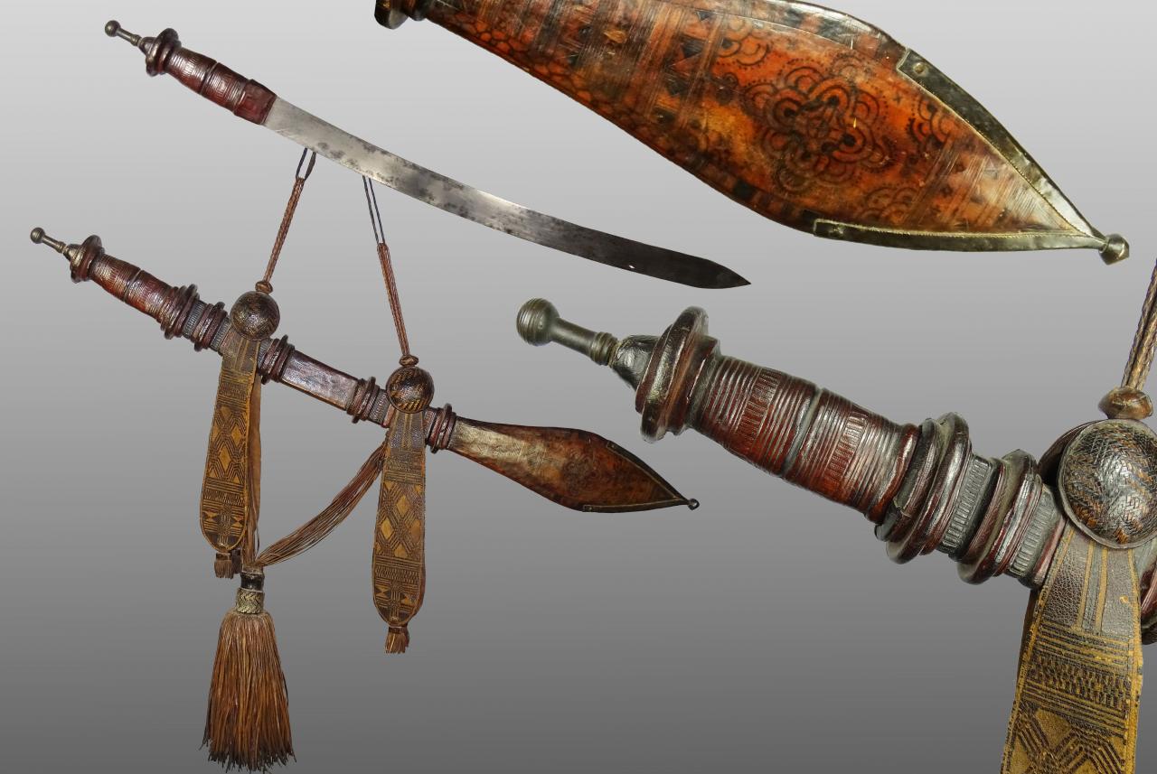

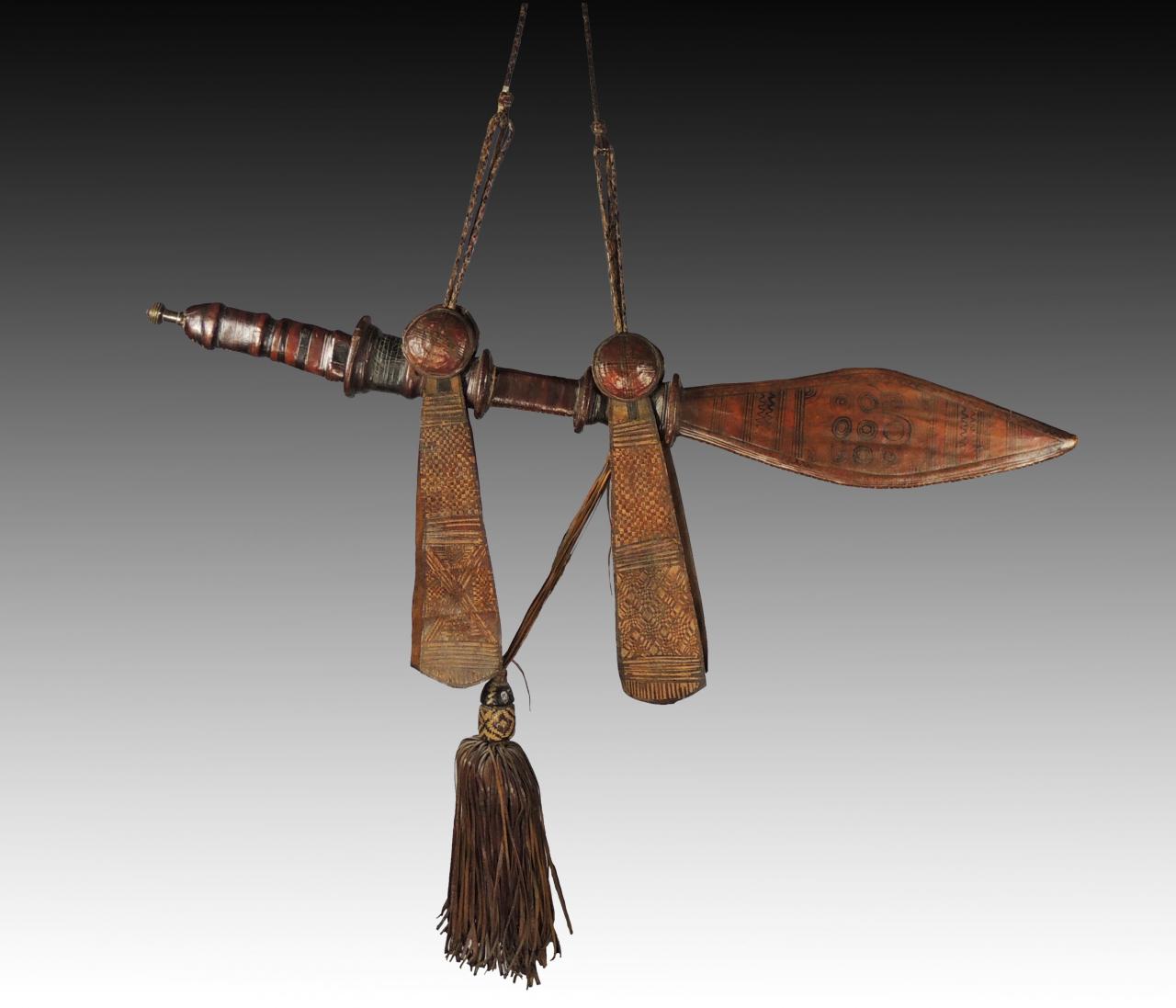

In "Panga Na Visu", the first dagger shown is similar to the group in my opening post. The second is one with a flared tip scabbard. I have one of these as well. A knife in the Quai Branly with a similar scabbard is described as Wolof, from what is nowadays Senegal and Gambia.

Begs the question, what does this 'flared' or 'spatulated' design element on scabbards represent, and which region did it originate? Years ago an archaeologist specializing in the Sudan told me this design had iconographic origins from ancient Meroe.
If that was the case, then how and why does it become significant in the Mande linguistic regions?
Not meaning to deviate from the original topic concerning classification, but these 'regional' characteristics do seem to have bearing.

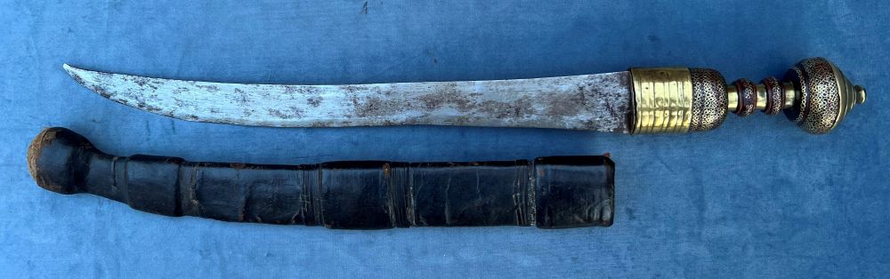

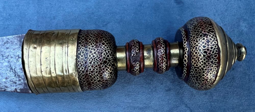

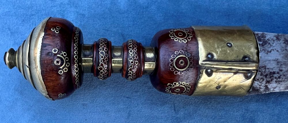

I've already shown this short sword/dagger; the tip of the scabbard has a completely different shape.
I'm more interested in the brass wire inlay on wood. Inlay is also found on Ikul (Cuba) daggers, but the technique is completely different there. The handle shape is also somewhat similar.

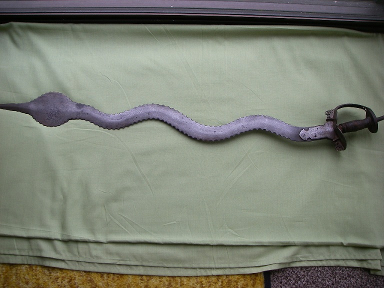

But the flared tip might be drawing on indigenous traditions. Leatherworking in the Mande-speaking world is very associated to the Soninke and lineages of Soninke descent (for example, Mandinka leatherworker lineages often claim a connection to the Soninke). After the fall of Ghana, there was a diaspora, and the Soninke people became dispersed around the region, and often had connections to trade. An element in Soninke mythology is the Bida snake, that in oral traditions is related to the rise and fall of Wagadu (Ghana). And snakes are also important in general in traditional religions of the area. So the flared up scabbards might be drawing on this theme.
But was this actually the case? We do not know, because there is no evidence. Until someone digs up a 16th century tomb in Sierra Leone, for example, and finds one, we do not have a clue of the origin of the flared tip.
The serpent symbolism makes a lot of sense.
The similarities between these hilts and Ikul dagger hilts are interesting, but the pommels seem too different to me - the West African form has a distinct pommel cap. Also, on Ikul daggers the inlay is typically aluminum or some white metal alloy, and like you point out, very different in technique. Nice dagger/short sword by the way.
So far I know it's zinc.

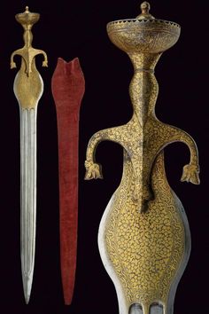

While the discussion originally pertains to the classification spectrum of Mande sphere weapons, I had noted the distinct feature of the flared tip scabbard which occurs also in Sudan with kaskara scabbards.
So using the occurrence of such features on other 'Mande' associated weapons with similar features, actually which are bulbous rather than flared, the question is what do these represent, as well as decorative character. The potential for snake related potential is brought up.
By analogy, in India there are the swords with disc like features which are termed by collectors, 'cobra swords' referring to the flared hood of the cobra snake.
These seem to be primarily situated in Uttar Pradesh in Northern India with the Pahari people and also connected to Hindu Rajputs. The chakra (=disc, wheel) is a weapon of Shiva, which is what this feature actually represents, not a cobra or snake.
The disc appears typically at the root of the blade, however there are examples of Hindu basket hilt with the disc at distal end of blade, with a serrated (nagan) blade.
These are the kinds of situations we end up with in trying to determine what sort of symbolism is being represented and hoping to apply that to the determining regions the feature commonality might denote.
Again, while off the course of the subject weapons, just an illustration of the situation.
