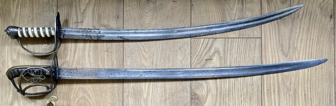

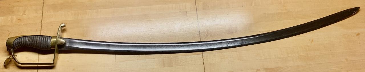

In a concurrent thread a British fighting saber with brass hilt and fluted ebony grip was brought up. This is identical to one I have by Wooley& Deakin, generally presumed as partners from 1801-1803 (some research somewhat expands this). Another by the same partners is known, along with one shown by Wilkinson by Durs Egg.

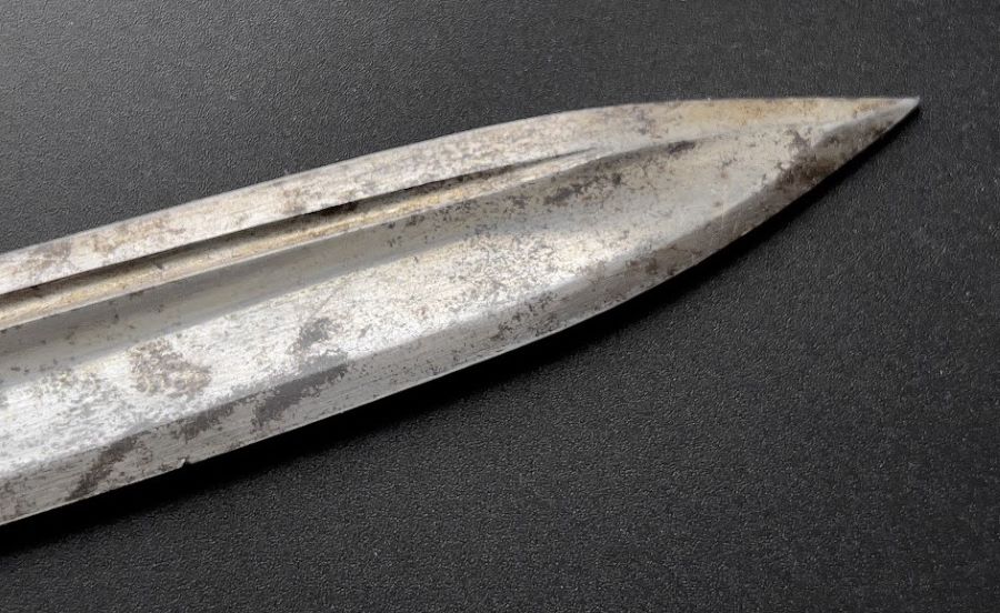

A key element in the James Wooley (Birmingham) examples is the use of the blade in the 'montmorency' type cross section. This seems to have originated in France in earlier in the 18th c. but seems to have been obscure until about 1780s.
Its primary advantage is the hollowed faces (pan creux)were of course great for lighter blade, but only the single stiffened edge for support. The montmorency added an extra back fuller, for notably more strengthened support. During the Revolutionary years there seems to have been some crude wartime production which advanced, and it seems that there was a regiment of chausseurs who had these (may have been 2nd?) around 1799.

Left : the 1800 fighting saber
rt: the Wooley M1788

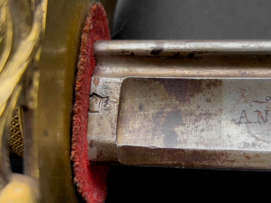

If we believe the inscription, this is the oldest Montmorency blade I know of.
On one side it says
NADIE SE META CONMIGO - AÑO DE 1700
QUE MATARE A QUEIN ME ENFADE
QUEIN spell mistake instead for QUIEN
Meaning
NO ONE MESS WITH ME - YEAR OF 1700
I WILL KILL WHOEVER MAKES ME ANGRY
Stilistically I believe the inscription looks rather 1770. I cannot give an opinion about the basket, looking English to me.

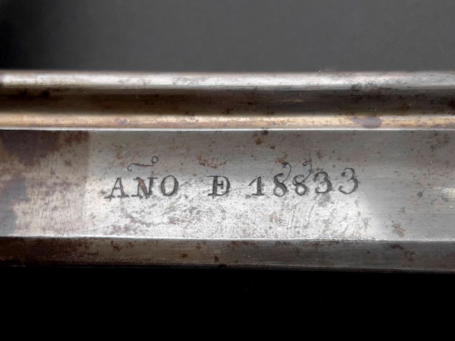

Hi Jim!

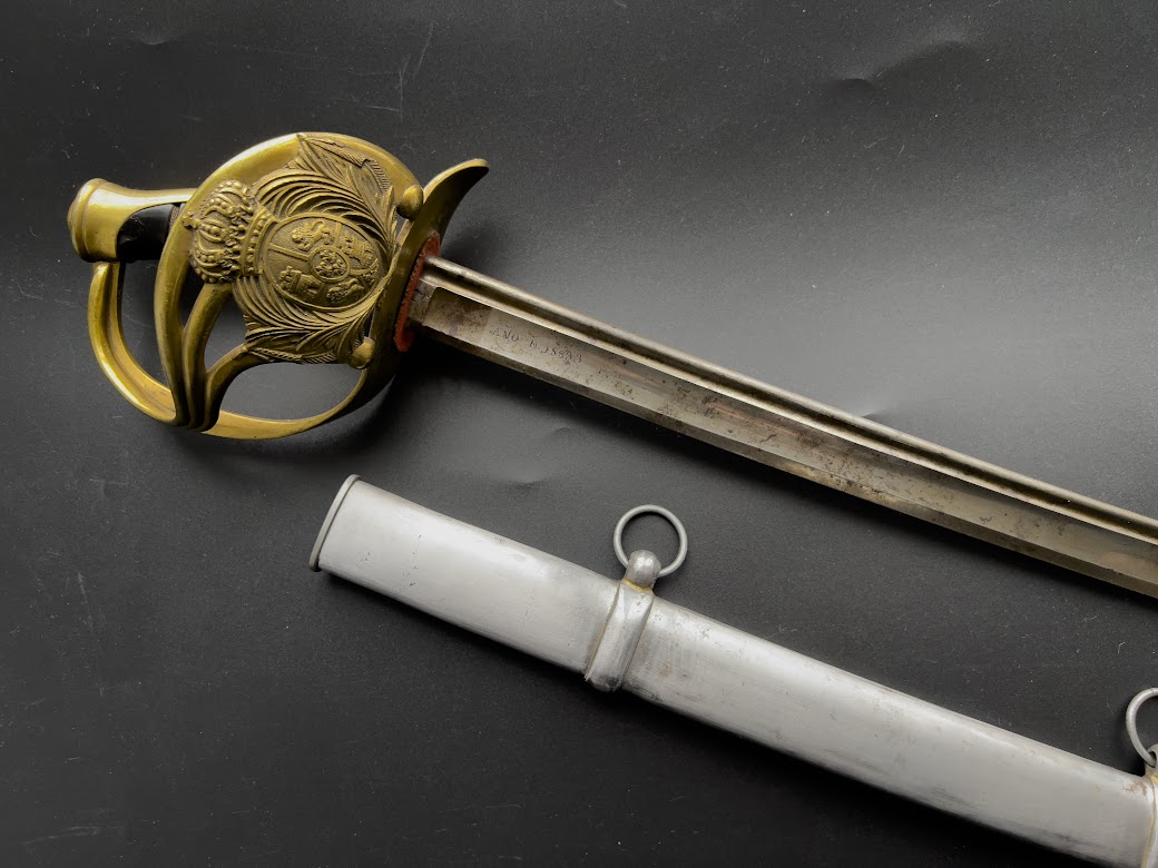

I've shown you this saber before.
Saber of an officer of the Royal Guard of Spain 1833

Anno 18833? It's a future sword!

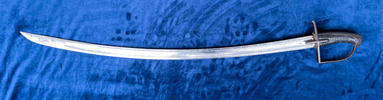

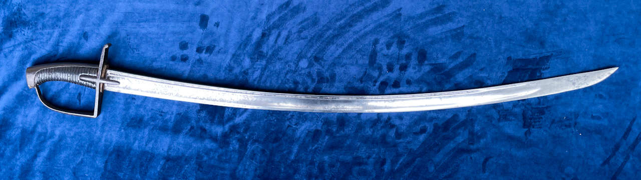

Here's my Woolley.

Yuri, thank you so much!!! beautiful Spanish saber!
Will, it seems like Wooley always favored the Montmorency blade cross section on his M1788 lt. cav. sabers, while Gill in same model preferred the hollow ground more standard cavalry blades typical of Solingen in these times which were curved.
It seems curious that Yuri's example with Weyersberg stamp at forte is Montmorency, which seems atypical of Solingen.

I have compared my Woolley sword with my 1796 LC trooper sword and other than the blade being longer and not as wide the curvature is very similar.

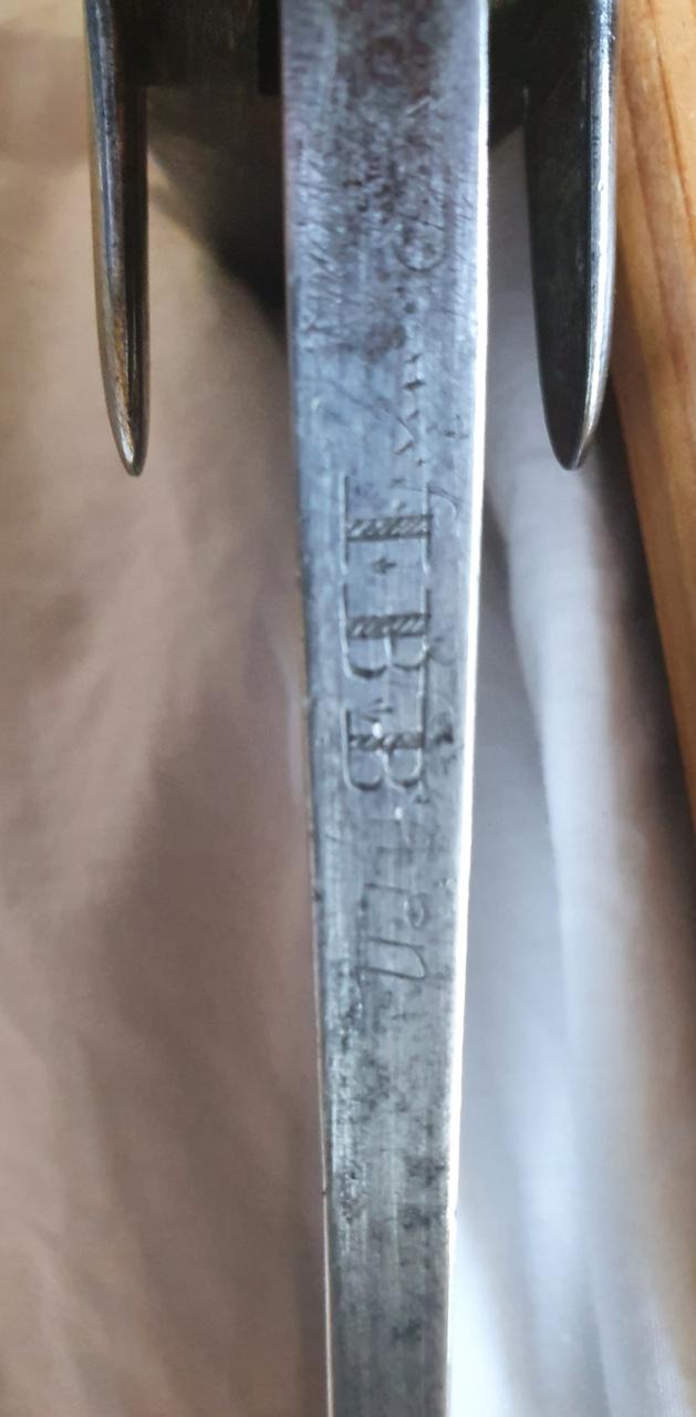

Here's one on what I called a 1788 - 96 type sword. I think the grip was ebony.
Triarii is offline   Reply With Quote

Nice sword, and interesting to see the Solingen mark get overstamped like that. I had heard of Egg doing this to Runkel imported 1788s. Have you looked into the I.B.B mark?

I haven't Radboud. I wonderted if it was the initials of the owner, for some reason.

I reference to the previous "NO ME ENFADES" blade now I know of another two similar ones, also dated 1700 and 1702, with Spanish texts.
So, these seem to have been used by Spanish Dragons before an Ordenanza in 1704 ordered straight blades.
The 18833 is obviously a Weyersberg inpersonation of Toledo, just as nowadays Chinese fakers make spelling mistakes.

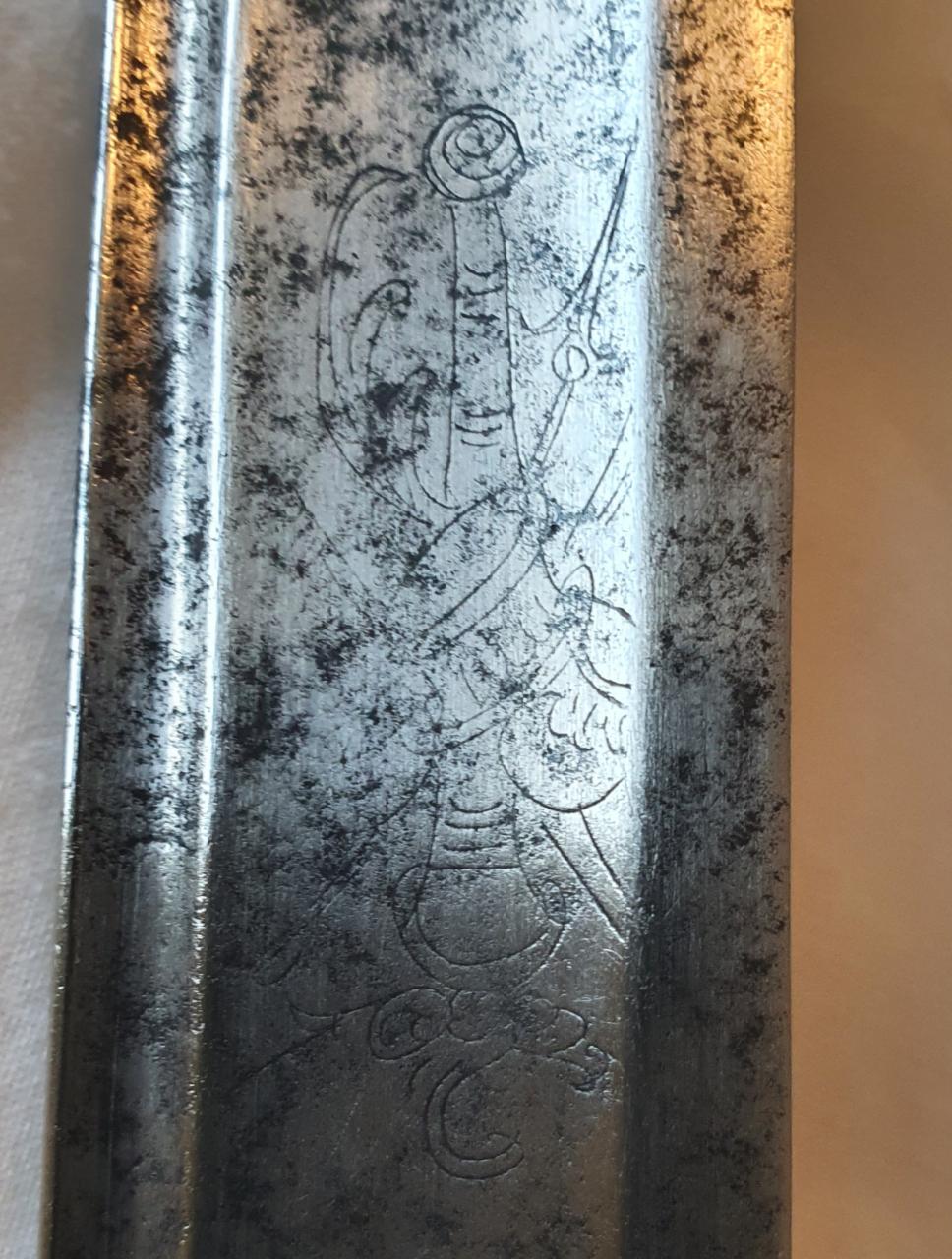

Only now I discovered that this blade can also be classified as a "Montmorency" type.
Pertinax is offline   Reply With Quote
Old 2nd March 2026, 01:23 AM   #24
Posts: 10,852
Indeed it is Yuri! I forgot about this fascinating nimcha.......what history it has. The local armourers really put the entire montage of 'magic' into the blade with these markings from the European armory. No doubt the pride of a Berber warrior.
