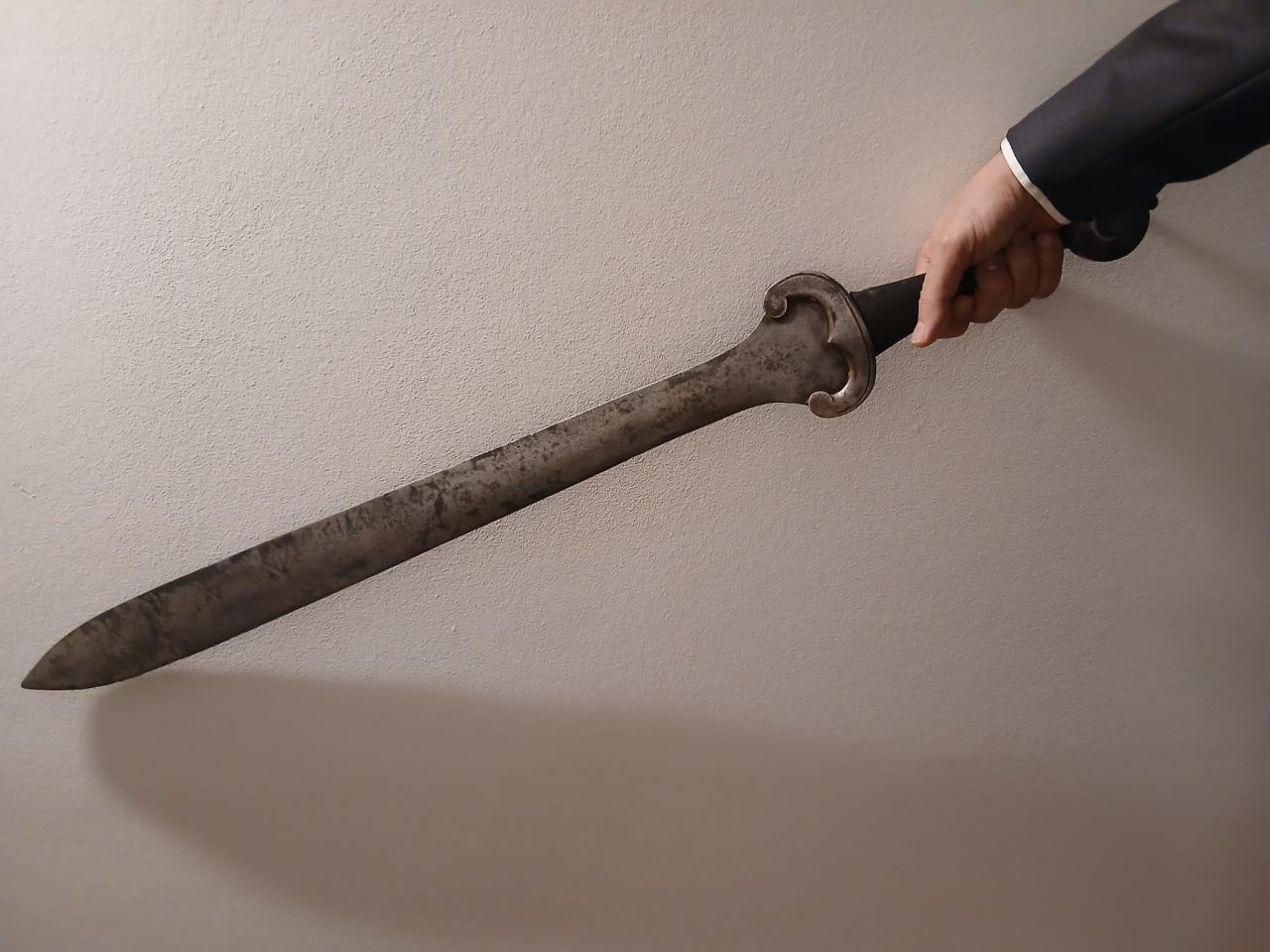

Hello all members,
I'm new here but I read a lot of the forum threads and like edged
weapons.
I have this strange sword to identify please.
For most of my friends it is just a fantasy sword but I think it is good.

Hello thank you,
I tried , now I hope it will be ok.
Sword is a mix of medieval pommel and hilt with a celtic ? ?
guard and blade
Almonzo is offline   Reply With Quote

Hello, OK thank you !
I put other pictures with more light,
The blade is really thin , sharp at edges and 3-4mm at the middle
With no visible central ridge
Thank you

I think that you are correct in your attribution of the styles of the various components. I do not recognize the whole, perhaps something along the lines of an militia infantry sword of the early 19th century, a hunting hanger or a particularly nicely made theatrical prop with some age. Hopefully someone will have more definitive ideas.

My guess would be a 19th century historicism piece, though I can't say I've ever seen another like it.

Possibly from the Hollywood sand &sandal era. I saw this one years ago, listed as a prop for the silent Ben Hur. B&W era stuff.
For some reason, my first impression was the type of stuff Kirby Wise may have made during the SCA years but this has real age showing.

The leather-covered guard is old, and the wide, flat, and sharp blade as you said , which shows clearly some age and is made of quality steel, reminds me of my 16th-century Italian sword/storta.
See my previous post: Strange blade on Italian(?) old sword
Is it a short sword or long sword?
The hilt, even though it looks like a Viking/Norman or Celtic type, reminds me of certain long cinquedeas from the same period, 1500-1600. Clearly, the leaf-shaped blade is anachronistic. Perhaps it was a special order with a beautiful medieval pommel. What is the sword's length and weight, by the way?
Kind regards

Thank you all members for the messages,
I will look for old European Italian swords .
It is a large sword, I would have mentioned that.
The total length is 97,5cm/ 38,38 inches
Weight is 1,4 kg / 3.09 pounds
Balance of the blade is 16cm away from the guard.
Largest part of the blade is 6,5cm large/ 2,56 inches and really thin ,
a little larger in the middle as I already said
It don't look like a deco piece ,
the blade is really really sharp all around the sword ; except the 5-6 first centimeters near the guard.
For a movie, I don't think it will be the best .

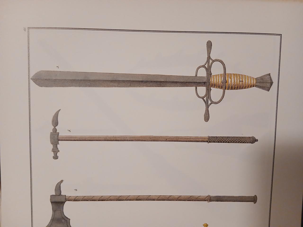

In the book "the history of chivalry and armor",
I found some interesting different types of medieval sword away from usual models
( like falchions...) ,
blades, are not so far away.
The sword was from John George I, Elector of Saxony
+ norman warriors drawings who match for hilt and pommel of the sword.
I think it was the principal influence for the bladesmith/ the owner- buyer
19th century or earlier ...

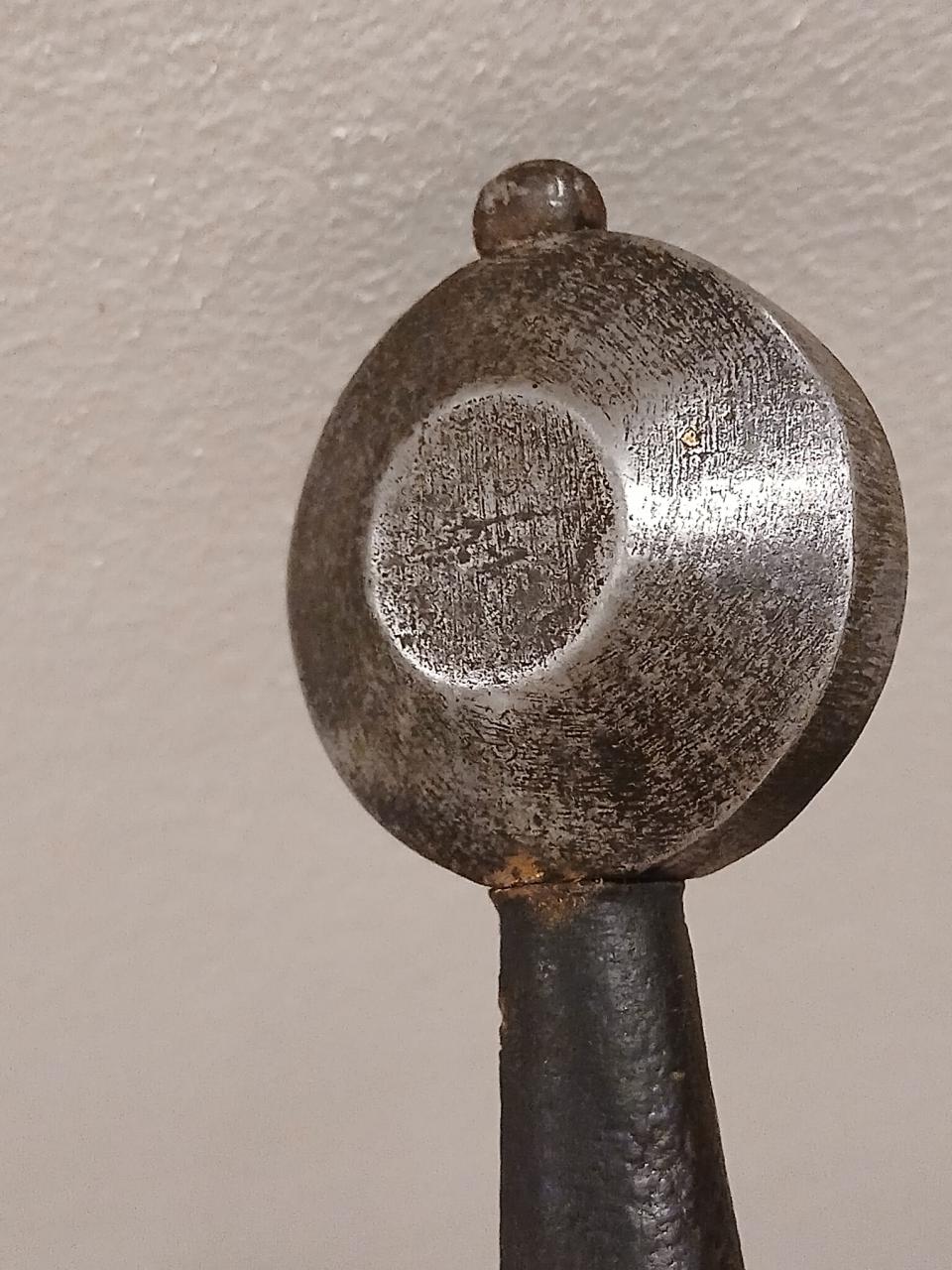

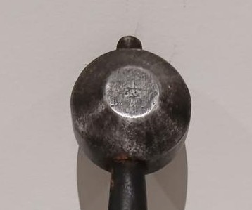

I am going to change my mind and go for a real weapon. 16th century possibly 17th. Looking and at the item, just looks too well made, great steel, really nice patina and as said before good for taking off body parts. Take it too a proper museum.
ps
Is that a mark , funny looking scratch? on the pommel. Cannot see it being used against armour. Still going with real 17th century.

On the pommel I thought there was a cross but it is not,
maybe just a big scratch because it was under rust and still is visible.
