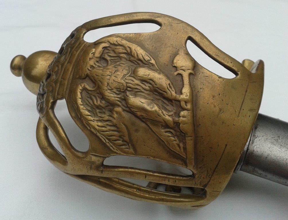

I know very small, to correct myself i onow nothing, i bought it becouse i love Highlander movies, and Schotish whisky, it should be 18 century, it is magnificent in hand and on the wall, it is very hard to say but it is much bezer made and feels better than all my schiavona swords, so if someone knows something i dont 😅😁

Outstanding example of a Scottish horseman basket hilt of Glasgow form (with the ring aperture to secure reins while firing pistol), probably of c.1720s-50s.
What is most interesting is the blade appears to be from an Austrian dragoon pallasche of early 18th c.
There were many Scots who served as mercenaries in Europe, and in the service of Austria in cases. What is an often distinctive feature of these Austrian pallasches is that the back of the blade near the point is often notched.

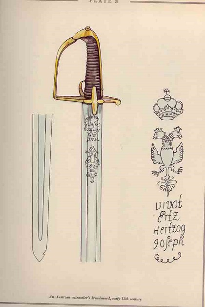

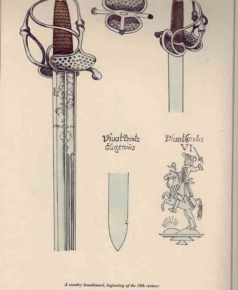

This seems to have been a convention most notable with Austrian cavalry in the early years to mid 18th century, as seen in the drawings of these swords in "Cut and Thrust Weapons" (E. Wagner, Prague, 1967). I first noticed these curious notches in the 90s in the book, and began a quest to find out why these were there.
In order to confirm these were actually present on the actual examples that the Wagner drawings were drawn from by contacting the museums listed as sources. I received photos of the examples confirming the notches were indeed there.

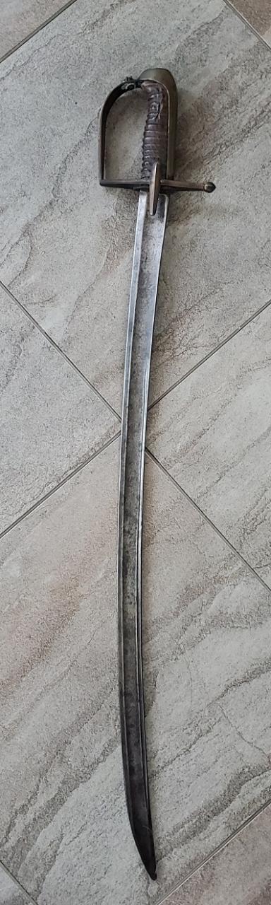

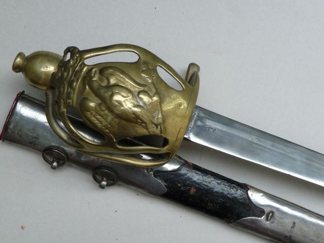

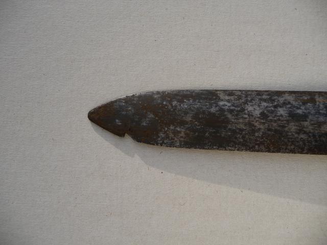

I would like to remind you of the discussion from 2017, which was about the "notches" on Pallasch blades (01/22/2017)

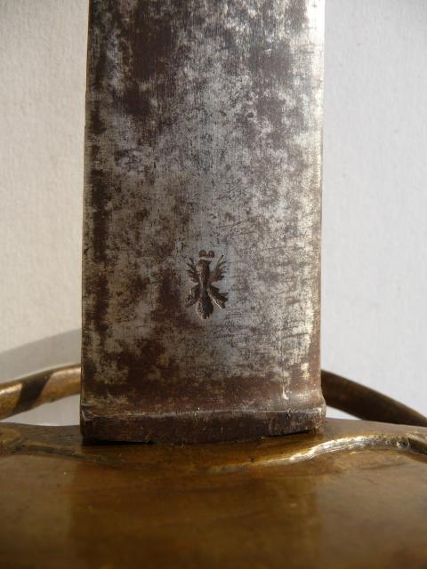

Here are the fotos of a Prussian dragoon sword 1732 with a notch at the tip of its blade. Remarkable is the Prussian eagle mark on the blade what proofs that this blade is no Austrian lute but made and accepted in Prussia.

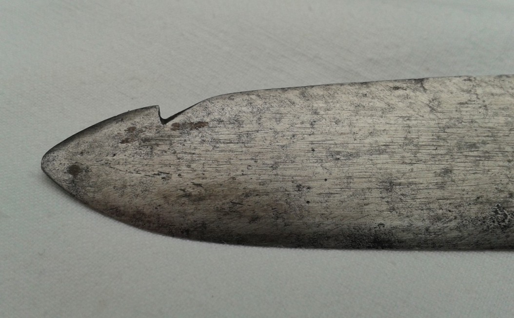

Regarding that notch on the front, i do have a austrian palasch with similar notch, will take a picture of it.
I was wondering why was that notch made there, it is clearly visible it isnt from damage it is intentionaly put there, this one look slike double notch.

Here is my 'pandour' saber, which is I believe Hungarian, but of course Austro-Hungarian (with page from 'Wagner' , 1967).

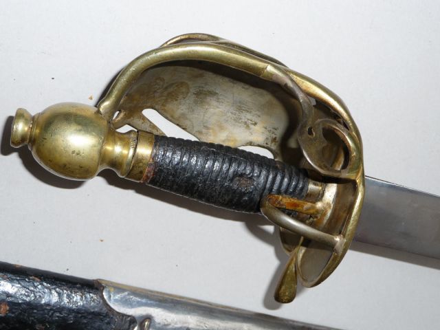

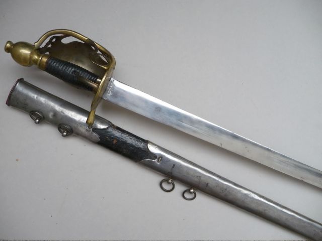

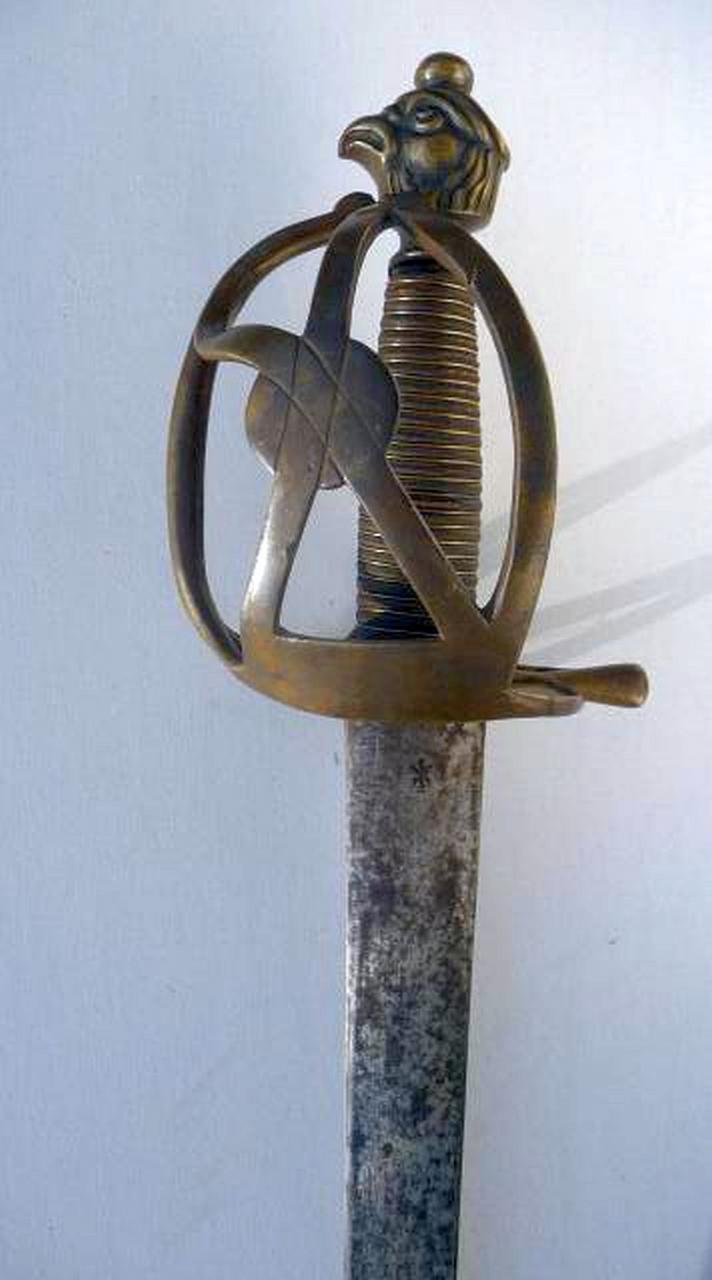

Here comes the Prussian 1732 Cuirassier Sword and a 1732 dragoon sword with notches

Thank you so much Udo!! Wonderful examples, and clearly the Prussian connection would be quite likely toward this basket hilt blade as well as Austrian. It is interesting how this unusual feature, most esoteric, did filter into the swords used by various national cavalries in the 18th century.
