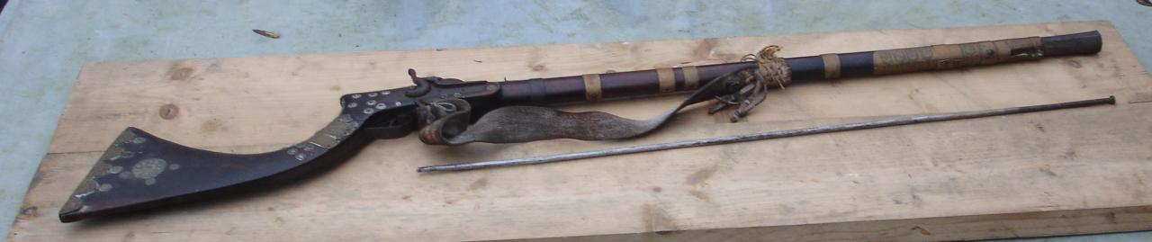

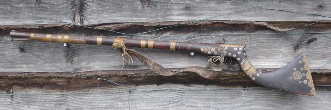

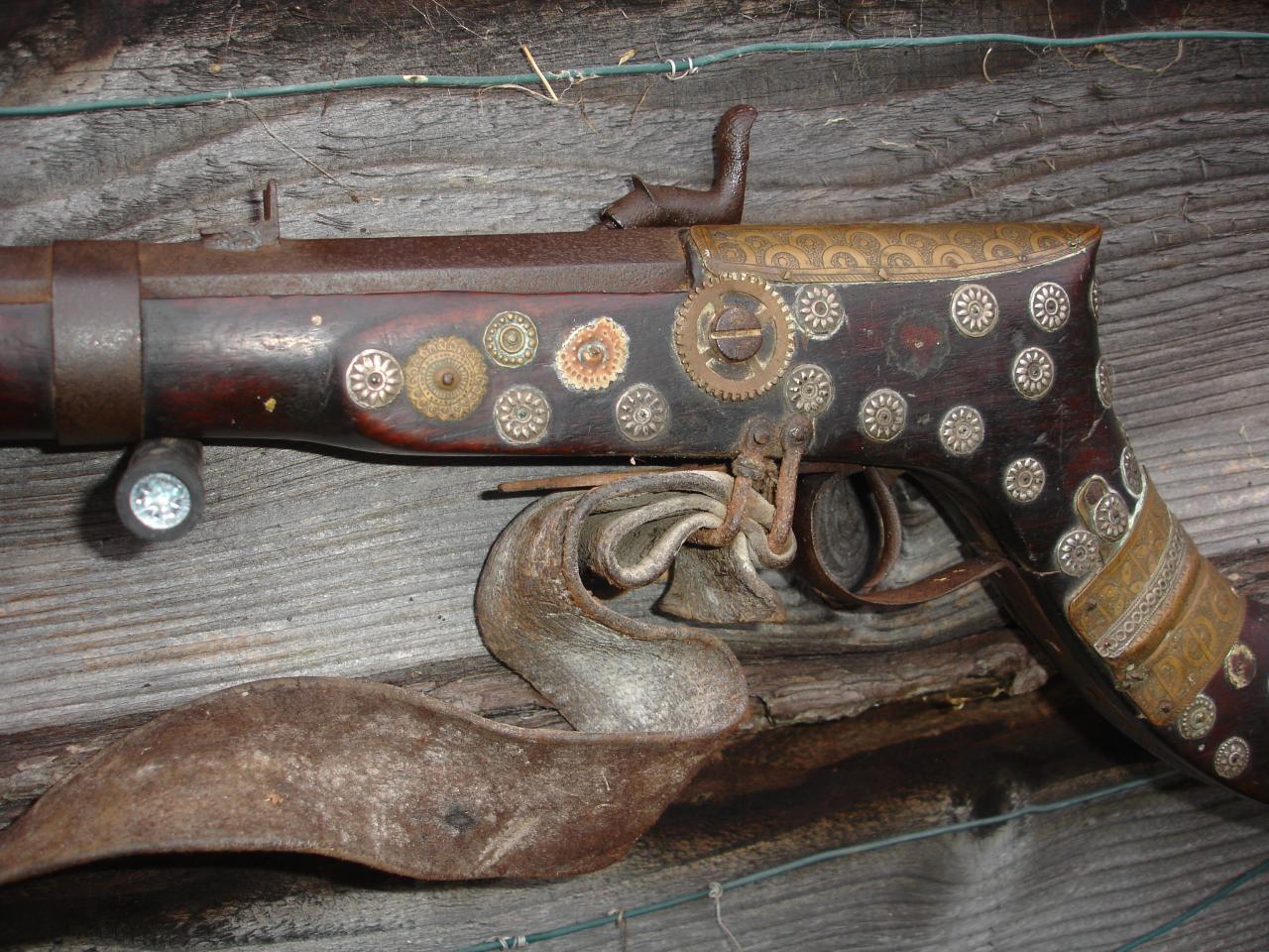

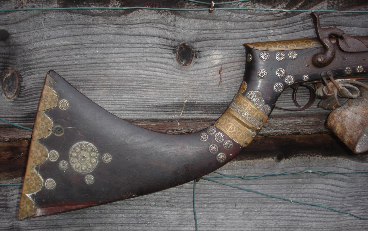

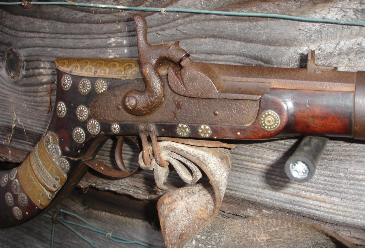

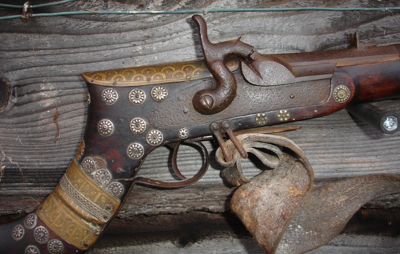

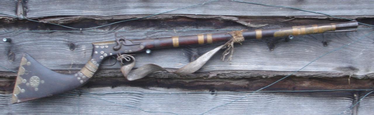

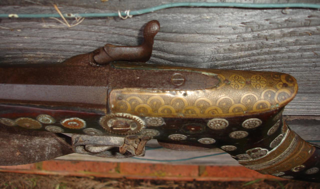

Hi all,
I am new to the forum this being my first post please go easy on me! Sadly a relative of mine recently passed away. His widow advised me that he had a couple of “rifles” that I did not know about in the garage, these where purchased from an antique shop in London some 50 years ago. Having a keen interest in air rifles I offered to do some research for her so she at least knew what she had and can decide what to do with it. This is what has led me to this excellent forum. The wealth of knowledge is amazing. I had not heard of a Jezail musket until now and find myself intrigued by them. Given the size of my air rifle collection this could be a bad thing!
From my research on here the musket would appear to be a matchlock from the Sind region. There is a thread started by “Fernando” which contains a very similar musket. Hopefully you will find this post useful and any information that you could provide would be appreciated.
The musket had a light colouring of red rust since being stored in the garage. I have given the barrel and lock a light clean with WD40 and a scouring pad.
I understand that valuations are not permitted but correspondence via a private message is acceptable. I have scanned the net to get an idea of potential value but these appear to vary considerably.
Anyway I hope that you enjoy the photos.
Cheers Jack

Triple Jack,
I don't know much about firearms but that's a really nice rifle you have there. It's a caplock not a matchlock. The caplock was invented by Reverend Alexander John Forsyth in 1807. Your rifle may be older and the original matchlock may have been replaced by the far more efficient caplock.
DON'T use a scouring pad. You have a rather valuable antique. Contact a knowledgeable antique firearms restorer before you take any further action. Using WD40 to stabilize the rust is ok.
Sincerely,
RobT

The rifle is not as old as expected: the barrel probably comes from a British M 1853 Enfield rifle and the percussion lock is certainly not older. But that doesn't change the fact that this is a really nice example of a Sind rifle

Definitely not an Enfield barrel.

Welcome Triple Jack, and thank you for your courteous entry here, as well as being attentive to the 'rules' which are intended simply to prevent issues.
There is indeed a great core of knowledge here, which is dynamic as we all learn together by sharing information and experience. Many are more specialized in certain areas, so that is most helpful.
On that note, you mention air rifles, honestly I know even less on those than I do on regular firearms so it might be good to see examples of these. It may sound silly, but these are the weapon form not BB guns correct? I know there were some type of guns using compressed air? even in Napoleonic times (an obscure article I saw).
Fernando was our Lead Moderator, who sadly passed away last year, and is deeply missed. He was an intent researcher and contributor on many topics especially when his interest was piqued in a specific area.
As has been noted by some of the guys here who know firearms well, the style of this example is typically regarded as from Sind regions, which are wide desert areas just below Afghanistan. These forms of course diffused widely with tribal interaction and trade of course extending into areas in Afghanistan. There are craftsmen who have assembled firearms faithfully for many generations, using components at hand, often from very old muskets and various firearms.
As noted, this example, like many of the guns out of these regions, is inherently valuable both ethnographically and historically. Its character suggests it was indeed a 'working' weapon. and its provenance from a shop in London suggests it may well have been an early souvenir from the notable British presence there from 1880s well into 20th c.
While often these guns were made to be sold as souvenirs though using genuine old components, many found as souvenirs came out of actual tribal use, as in my opinion this one may well have been. The key is to check the components, and viability such as alignment of touch hole and pan.

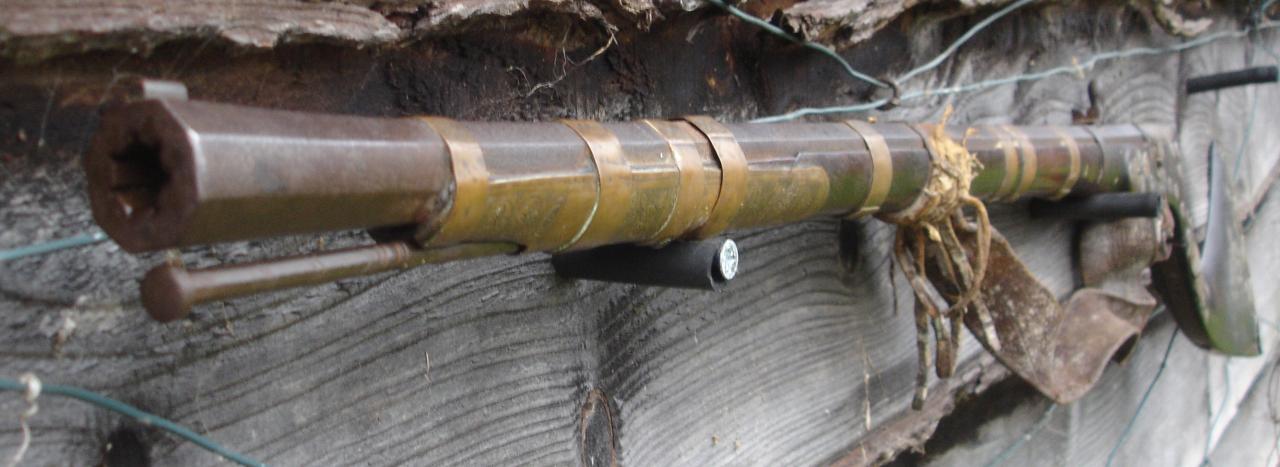

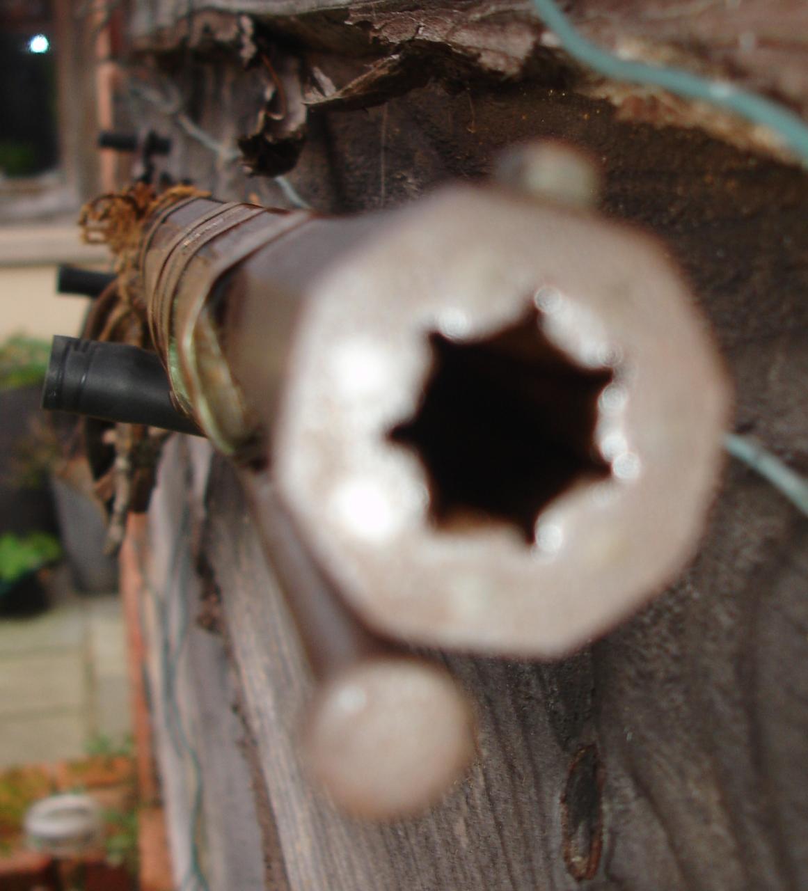

Old barrels from surplus guns were ubiquitous. The unusual star type rifling seems unusual.....what sort of round would be used is curious so I hope those with this knowledge might describe. The M1853 Enfield is noted, and these were popular in Afghan regions. The percussion (caplock) lock is from that period until I think c. 1880s?
Important note......conservation, not restoration on antique arms, just WD40 to stabilize and clean. Overcleaning destroys value.

Hi,
I have one like that.
Your barrel and lock are locals, and very common on most of these guns.
Probably from Thatta or Hyderabad.
These guns are from mid to late 19th c.
They are not very expensive as you can find many of them.
