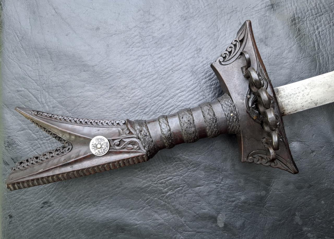

I first learned of this unique feature via Sir Lorenz Lasco's lecture, way back in 2018. I've always wanted to verify this feature by replicating the deployment on a test target. Many questions remained on my mind- did it really cut through the rope? When were the ropes cut, upon impact? What if the edge got stuck inside the scabbard?
Luckily, I acquired a late 1800s kampilan with an 1882 silver coin on its pommel. This specimen has a massive 33.3in heavy blade and a mostly-complete breakaway scabbard.

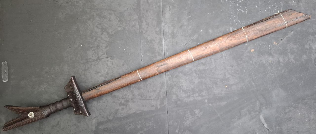

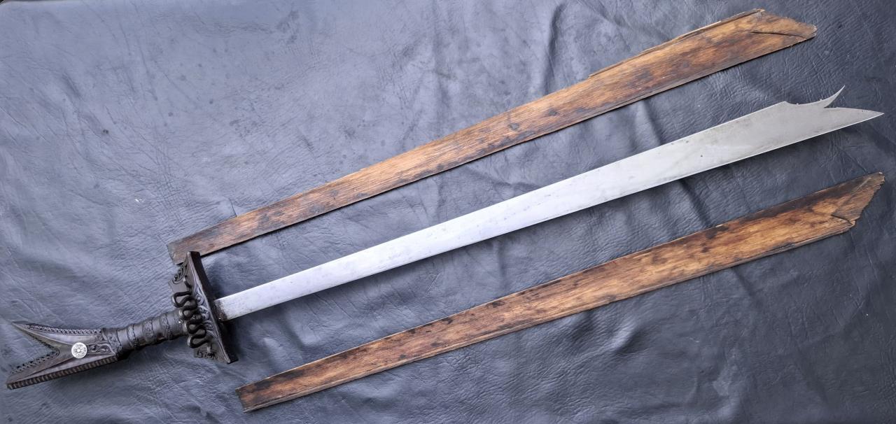

I restored my antique kampilan, patched up the cracks on the scabbard, then tied up the scabbard halves with cotton yarn (substitute for rattan), as advised by a Mindanao researcher. Then I proceeded to cut-test on soaked cardboard rolls. Here's the scabbarded strike verification: https://www.youtube.com/watch?v=j5sN-ng_DH0
I did that 4 more times on other targets, with similar results. Thankfully, the scabbard halves were very much reusable.
Enjoy

A beautiful Kampilan and an impressive video. I find it particularly interesting (after watching the clip at 1/4 speed) that the scabbard halves fall away BEFORE the blade hits the target. I wonder if this would happen if rattan bands were used instead of cotton.
Old 7th November 2025, 10:21 PM   #5
xasterix
xasterix's Avatar
Join Date: Oct 2018
Posts: 715
Thanks for the kind words and that qiery sir- rattan bands would have the same result; they're easier to break through because they're brittle (splinter easily). I was told that vines, cord, and cotton yarn were used to hold the halves together. The wind-up of the strike accelerates the blade and makes the edge slide and slice through whatever holds the halves, provided it's not too thick.
