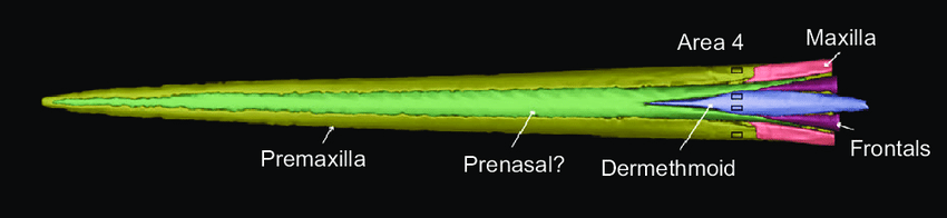

A filed down swordfish rostrum makes more sense and as you can see in the cross section CT scan, the holes at the base correspond with the frontals in that illustration.

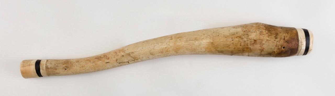

As far as straightness, some species (including the walrus) can have straight baculum. Attached is a picture of a walrus baculum that resides in the Medical Museum of the University of Melbourne not far from where I live now.

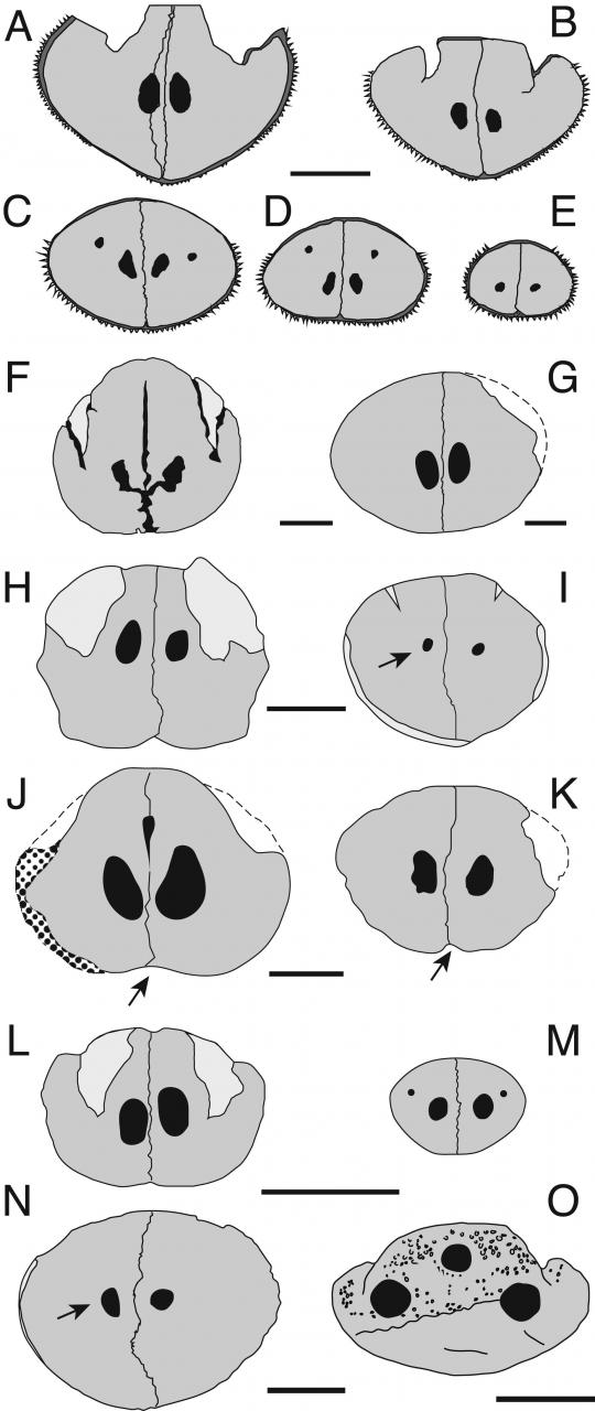

I cut several thin sections from swordfish rostrum (Gladius) and the internal structure is really similar. There are 5 other species of swordfish and the Blue Marlin have a rostrum more round in section with tow canals in the rostrum.
On the rod the sharp edges of the rostrum have been trimmed to obtain a round section.

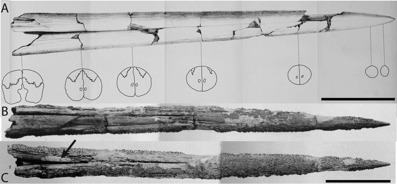

I had some image of cut section of various fossil rostrums of Marlins (from Miocene and Pliocene of Panama).

The images show fossils; the diagrams only show the bone area without detailing the bone's porosity.
But in reality, bone is very porous, crisscrossed with very fine blood vessels, cartilage, and adipose tissue.
Here's a post that illustrates it well.
https://www.researchgate.net/figure/...fig1_271389341

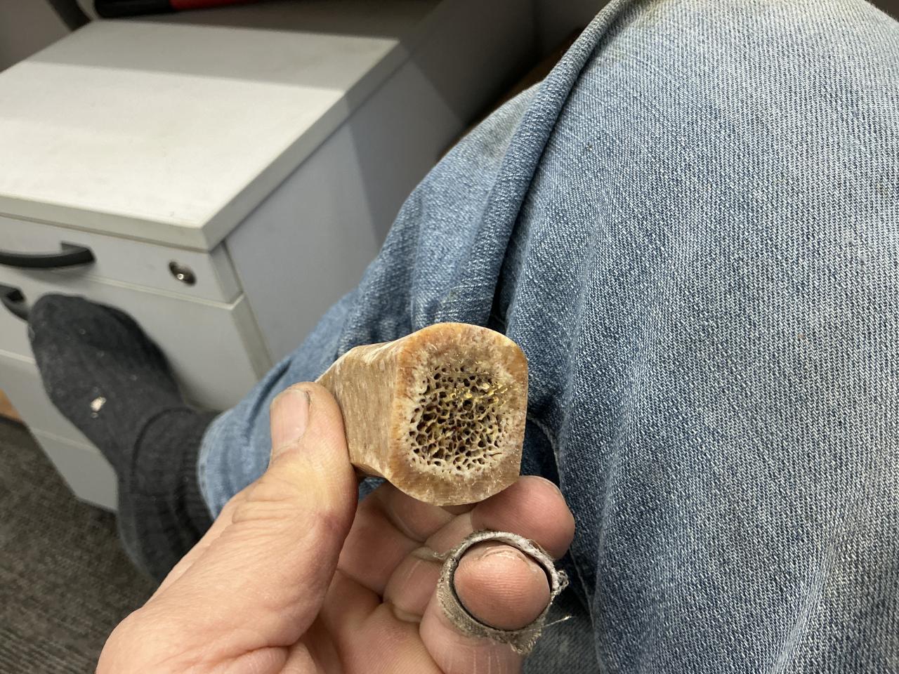

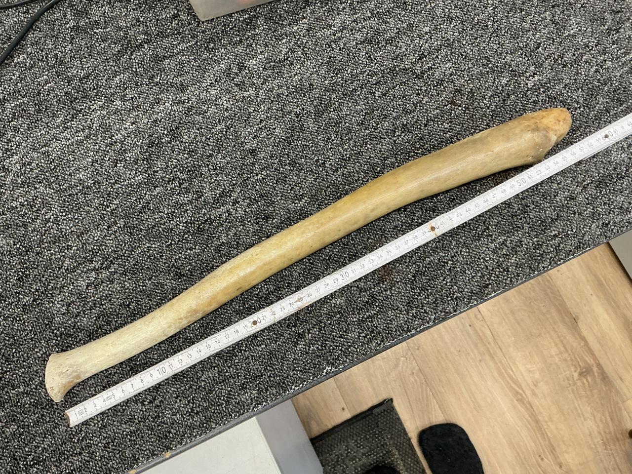

Some pictures to compare and for future investigations.
A complete Oosik/walrus-baculum with 55 cm.
A piece of oosik ( roughly grinded for a knifegrip ) and its cross-sections. The bigger end of an oosik will show more porosity than the thinner end. This piece was cutted out right in the middle.
