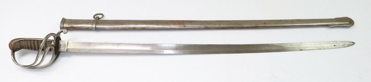

I am new to European + style of swords. I now have this Toledo export sabre. Has seen some better days with light pitting over most of the blade. Said to be influenced by the British m1821 LC sabre. I am new to these blades, It was listed as 1890s. To my eye the blade although a troopers blade so plain and functional with no frills or pomposity, is hand forged? The uneven fuller and there is some wavyness to the spine and edge. Hard to show with my photo abilities. By the 1890s Teledo sword makers had powered mill rollers. So I am assuming this sword blade is quite a bit older? It is in serviable condition. The hilt has some interesting marks on it. I made the leather washer. I don't like the hilt bashing asgainst the scabbard. I know there are some very well read members when it comes to swords like this, info please.

"Hand forged" is quite an open term. Most all blades are made by a human operator drawing the bar stock through the powered press by hand. They use dies in the press to get the fullers and overall shape correct. Then they are hand ground on grinding wheels to get the final shape.
Even before steam engines, water powered hammers were used for the vast majority of the heavy hitting.
The days of making sword blades with just two men and their hammers were long passed by the time this blade was made (and that includes the Napoleonic wars). If anything, the sheer number needed to supply an army necessicated more advanced production methods.
Looking at your sword, the blade profile is incorrect for the era of the Napoleonic wars, at this time fullers extended almost to the hilt and sabres tended to have more curve.
You can be confident that your blade is of 19th Century production. It has a later period scabbard with the single ring and if it's a good fit then they were made together.

Or it's just polished / finished to a lower standard. Or it's been repolished later on.

Doesn't look hand forged to me, but it does look like apprentice McNumpty's first day on the grinding wheel.

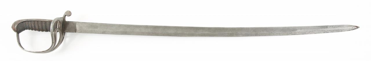

I can add these as they have been sold. Two more examples of apprentice McNumpty and repolisher handy work. There must be more than one McNumpty around .
https://www.antique-swords.co.uk/ant...edo-p148004024
https://www.invaluable.com/auction-l...9i65IPiBQjxjoI

But seriously Tim, all these examples show is that they weren't overly concerned with even grinds and the swords were made to a budget (big surprise there for trooper swords).
This isn't evidence of hand forgeing, what I'm seeing in the photos is uneven grinds which are all done by hand as both of us noted earlier.
And to be honest, I've seen (own) older blades with better/cleaner grinds than these.
But knock yourself out, believe what you want to believe.

very different finish to the blade on this examples to all the others I have added to this thread.
https://auctionet.com/en/2760914-por...images#image_0
