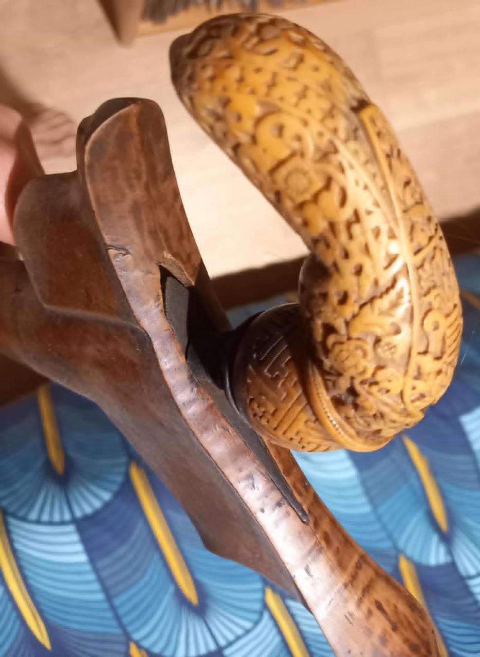

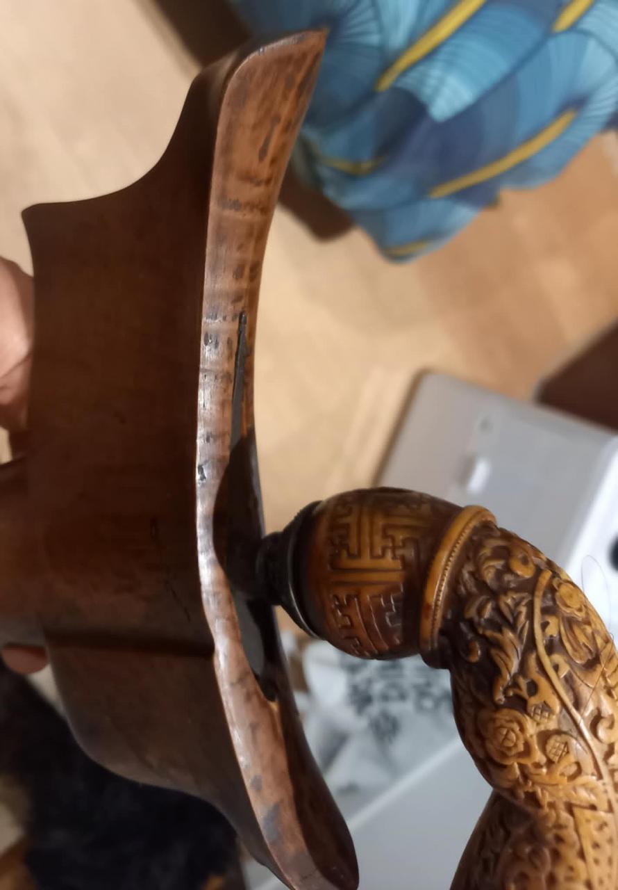

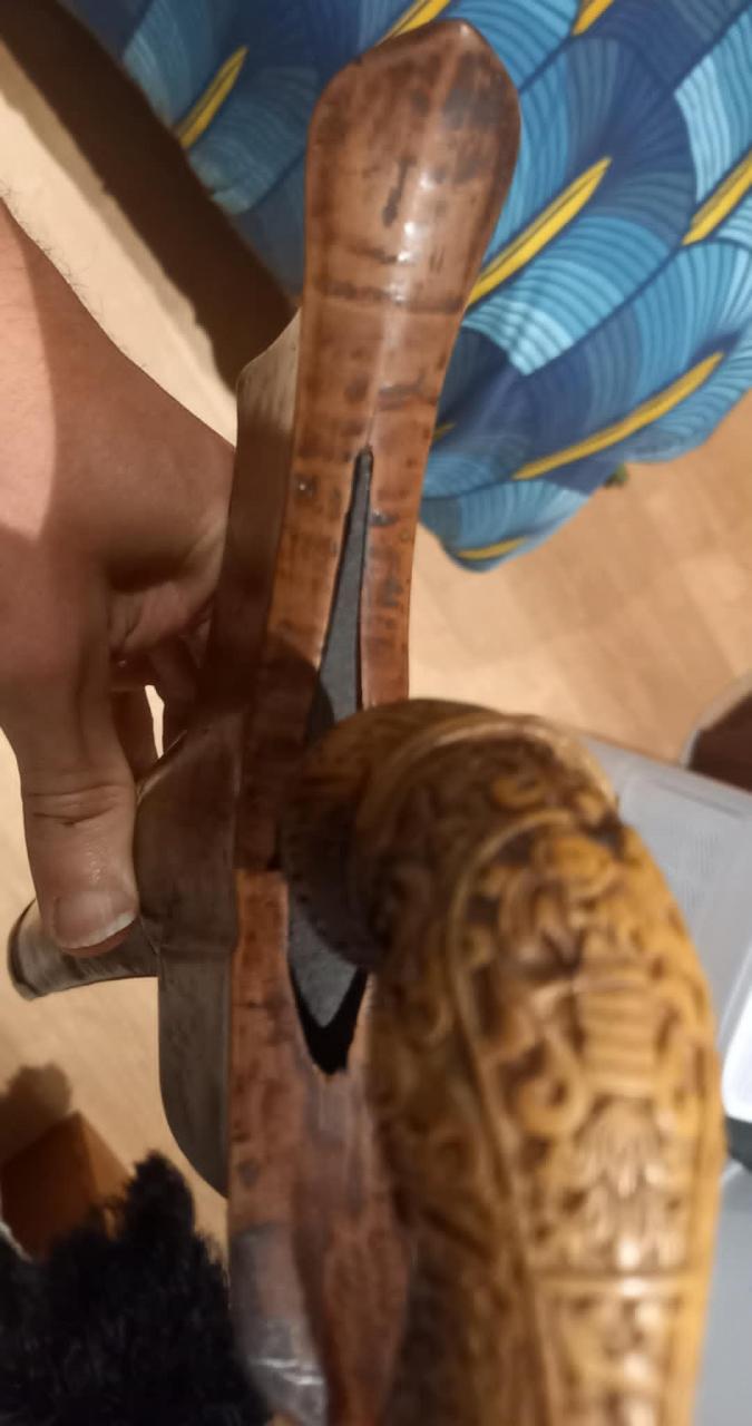

Here are photos of the blade in its sheath.
Old 21st October 2025, 10:49 PM   #12
Posts: 7,228
The form of the sirah cecak & the buntut urang is not typical of a keris that can be classified as Bugis, however, it is typical of a keris that can be classified as East Jawa or Madura.
If the blade does indeed carry flat faces, then we would need to consider the possibility of a gonjo replacement at some time in the (probably distant) past.

I checked, one side of the blade is very flat, the other is very slightly lenticular.
The blade seems a little thinner than more traditional Bugis blades with a hexagonal cross-section.

That hex cross section is what I mean when I refer to "flat faces".
Does the blade have a hex cross section?

I compared with Bugis keris and Javanese keris and... it's not so obvious, but it's closer to a hexagonal section, but the angle between the flat surface and the cutting edge seems to have been worn so it's not very sharp anymore (Too violent cleaning of the blade in the past?).
