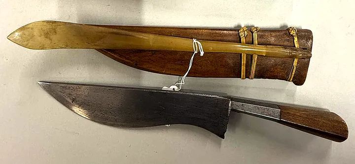

Default A Javanese Wedhung
Here's an antique Javanese wedhung. I've been chasing one for years. Cheers

Hi Sid. Congratulations on finally acquiring a wedhung.
Better, larger photos would be helpful, but i suspect from what i can see that your is probably later 19th century to early 20th. Not a high ranking piece since it does not appear to carry pamor.

Thanks Albert and David,
I think it had pamor at some time but is now not in stain. David do you have any reasoning to date it as you have as I have not found any guidance. I don't necessarily think that pamor in itself is a 100% guarantee of age or the fact of it being a high ranking piece though as that can easily be replicated in a modern setting. In fact I have seen a few of these pamored ones that look decidely recent.

Thanks Alan
I will post better images soon. You may well be right. On pamor and princes though it is possible is it not for new wedhung to be made with pamor on them? Most wedhung images I have seen online have pamor. There could be a bias to these being pictured but there must have been a lot of princes about or replicas are being made or all of these may apply. Leaving that aside my knife has very subtle if any, greneng.. The blade is also 8.5 inches. Can that indicate age?

Sid, as Alan has mentioned, dating wedhung can be very tricky since it is not a knife that has changed very much over time, though when we get further back in time to Mojopahit and Mataram we do see some differences in the profile of the blade. Again, better photos would be helpful, but no guarantee that a more accurate dating can be determined. I feel confident that yours is at least antique, but could possibly be a bit older than late 19th century.
I have attached some images of mine which probably dates back to the early years Mataram and you will notice a more elongated profile to the blade.
Alan has already addressed your questions about pamor and hierarchy. The other thing i note with yours is that it is a somewhat more simplistic form of the blade since it doesn't really present any wideng (like the greneng on a keris) at the backside of the base of the blade. I could be wrong, but i would image that more attention would be paid to this detail on wedhung intended for higher ranked court officials.
