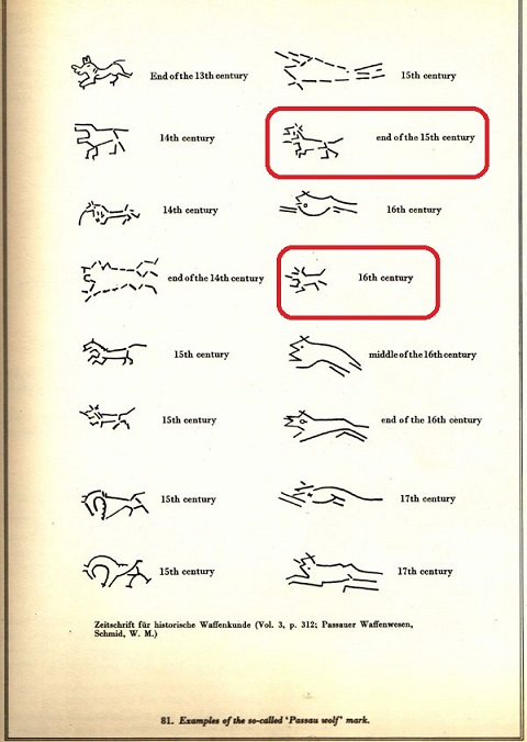

The running wolf has intrigued me for more decades than I can say, and remains one of the most noted blade markings seen on various sword blades.
Passau was once one of the most prolific sword and edged weapon producing centers actually from Roman times, as this had been an encampment for Germanic tribes serving as auxiliary forces for them.
This tradition seems to have prevailed as the location remained a center for the gatherings of mercenary forces through the renaissance and into later centuries. While not exact, it seems that the running wolf had been the symbol of the bishops of Passau since at least the 14th century, and it is important to note that in these times and for centuries, the bishops were essentially those in charge of arms and armor. In times where there were principalities instead of countries, the Diocese was the administrative denominator, so the bishops were in control in a prince-bishop role.
The red wolf was the heraldic symbol for the bishops in the diocese that controlled Passau from those times, and the stylized wolf which was placed on blades, probably in an ordained or authorized sense initially became known to superstitious warriors as a symbol of power and invincibility with divine protection. The use of talismanic symbols and amulets was well known in Passau, and this became one of the most notable in what became known as PASSAU ART.
The practice of emplacing the 'wolf' became an essential and sought after 'trademark' with these talismanic virtues, and perhaps the association of the wolf even before use by the bishops of Passau as significant to Germanic warriors as a totem of fierce power was a significant tradition.
This symbol was important and served equally simply by placement, regardless of the artistic merit of its rendering, in many cases added by less than artistic workers. This is why there are so many variations, some almost indiscernible. Contrary to the implications of Wagner (1967) there was no chronological evolution of the form, and his dated figures in the plates probably reflect the period of the weapons he drew them from.

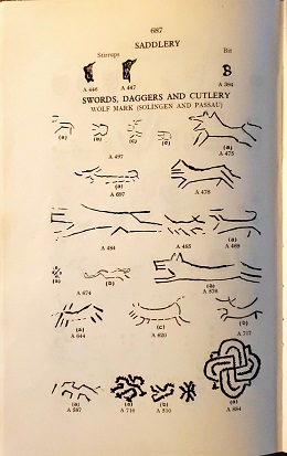

The images show the Wagner plate with variations; the red wolf heraldic

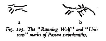

a image from Oakeshott where there appears to be some early variation regarded as a 'unicorn' (?) which has not been fully explored.
We know that the Romans in these regions did apply highly stylized images of virtually indiscernible creatures on blades in a few cases.

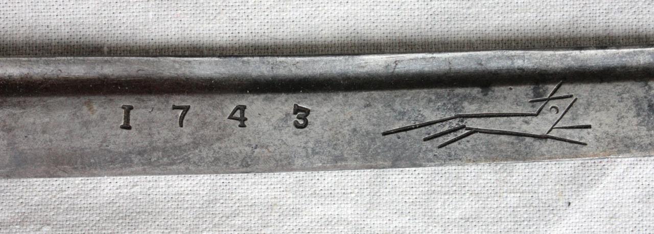

Old 10th September 2025, 02:37 PM   #7
Ed
Ed's Avatar
Posts: 296

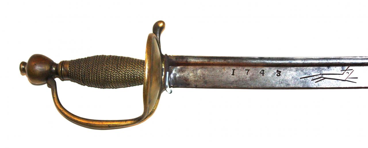

Another, late, example.
Old 15th September 2025, 10:52 AM   #8
JeffS
JeffS's Avatar
Join Date: Sep 2005
Location: Singapore
Posts: 442

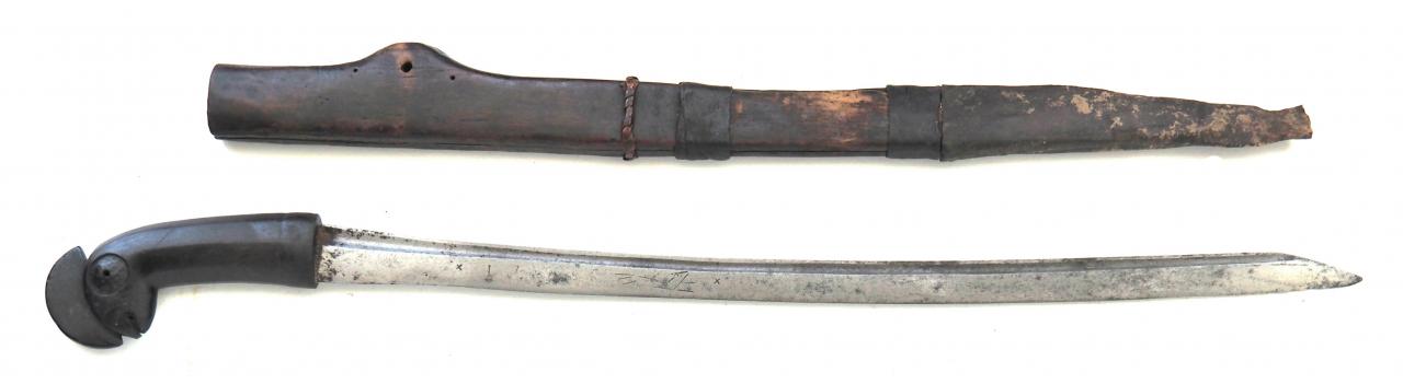

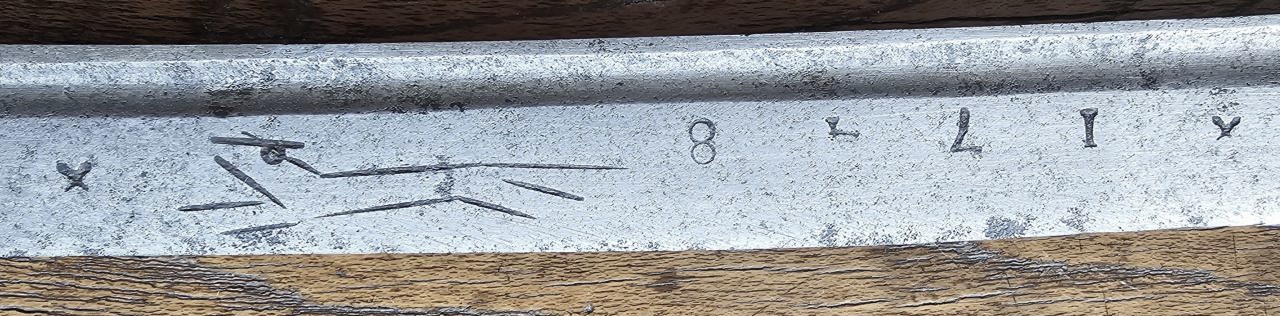

Another late one found on a Timor sword which resembles Ed's blade. Ed - is it possible to show the full sword?
