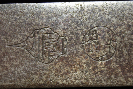

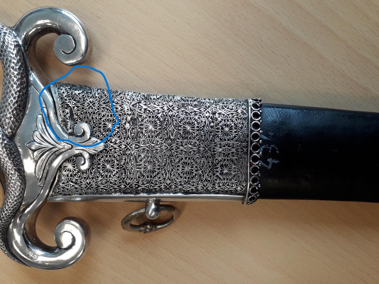

I recently acquired this sumptuos and heavy Tulwar. The hilt is made of silver and decorated with a fine worked snake, which entwines it. The finely pierced fittings of the leather covered wooden scabbard are made of silver, too. Only the suspension rings are probably made of another, harder white metal. The blade seems of persian origin to me and is made of Wootz-steel. It has some inscriptions I can not read.
total length: 95 cm
length without scabbard: 90 cm
blade length: 74 cm
maximum blade width: 3.6 cm
total weight: 1.573 kg
I am interested in a translation of the blade inscriptions and your comments regarding the age of the parts of this swords, it's origin, the meaning of it's decoration and so on.
Kind regards
Robin

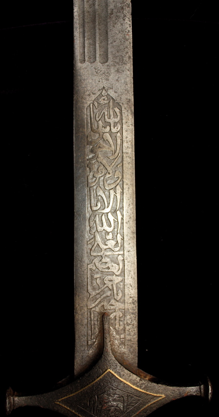

Posts: 10,845
For comparison: from Persian trade blade c.1800-20, the pictograph of the lion and cartouche Assad Allah.

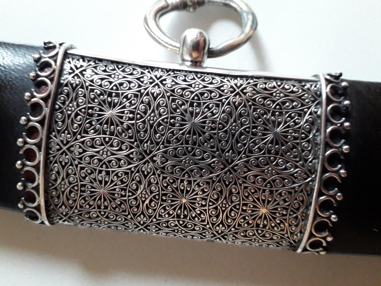

The beautiful filigree of the scabbard reminds me of Hyderabad style work though typically it is embossed silver in the mounts, The European style carry rings seem likely to be of course from those influences in the British Raj as the rococo leaf type decoration .

Unusual hilt for this however that is a very nice persian dark wootz blade. The cartouche I believe may have been filled with gold at one point.

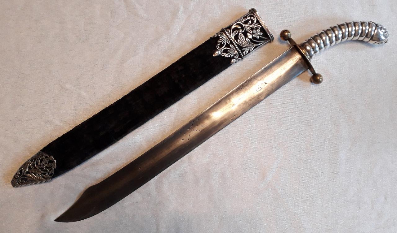

Nearly three years ago I postet a distantly similar hanger from my collection. It has an interesting silver hilt, too, but is also a bit mysterious and maybe not helpful.
Here is that piece:
http://www.vikingsword.com/vb/showthread.php?t=28242

You are very fortunate to have acquired these two weapons which seem to have remarkably similar character in the combined interpretations of styling and silver reflecting traditional elements and the potential for diplomatic associations of these times.

That blade profile and AA acid markings are indian, cartuches are too big and over dimensioned, and engraved by acid, indian blade 19 century maybe end of 18.
Filigree is not at all real filigree work with wire but a cast piece that is clearly visible from photos, real goldsmith filigree is braided silver wire, there is no wire on this piece, it is cast in a mould from uniform metal, and definetly it is not a real filigree work. And that cape and handle pieces doesent seem old indian work.
It should be examined in hands, but to me that doesent look older than 20 century, second half of 20.century (handle and scabbard).
It isnt similar to non of old tulwars or indian swords i have examined, but that fake filigree casting i have seen on a few indian tulwars and pulwars from 20 century.

Hello Serdar,
Possibly you are right, but you can find many Assadullah-blades with etched cartouches in the internet and I doubt that they are all Indian. Also there is a long tradition of etching steel in Persia. So I would be carefully to argue with that against a Persian origin.
I never wrote that it is filigree, as I stated in my opening post the fittings are pierced, which is clearly visible. I don't see an attempt to imitate silver filigree.
Before I posted the sword here, I looked in the internet for similar decorations on old or modern Indian swords but didn't found one, not pierced and not in filigree. That the handle is not typically Indian is very clear, too. So of course the whole sword is no traditional Indian work at all. It seems highly influenced by European and Persian style, which causes my questions about the purpose and the origin.
Can you show similar silverwork from that time? Or generally fake Indian weapons which have this "fake filigree" (which isn't that, in my opinion) or other similar features like the shown sword?
Kind regards
Robin
Gonzoadler is offline   Reply With Quote

The wootz (watered steel) blade would be hard to consider modern, though I know that modern artisans so produce artificial examples on knives. With the pictogram cartouche of the lion and sun, which became the Qajar dynastic crest in early 19th c. (Pinchot, 2002, note 42), these cartouches along with bold Islamic script in panels and cartouches, these appeared on the ubiquitous Persian trade blades of mid-late 18th into early 19th c.
These Persian trade blades were popular through trade channels from Arabia, and most regions under Ottoman suzerainty, through India (on tulwars), Malaysia, most of the Middle East and even the Caucasus. Therefore, these blades are not 'Indian' , but widely diffused Persian trade blades.
These trade blades using a pictograph rather than signature of the famed Assad Allah of Isfahan of late 16th into early 17th c. are using his name simply as a mark of quality and commemoration.

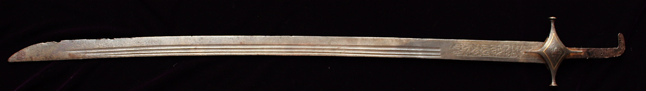

Impressive, with old blade.

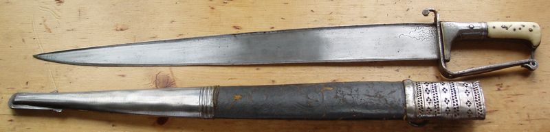

For comparison of styles here is my one and only example of a Persian blade complete with the much copied Assad Allah cartouche. The small cartouche, I am told, reads 'O fulfiller of needs'.
Norman.

The scabbard drag on the item in question is a nod to the scabbard drags on British military swords. This Afghan sword is a local attempt to copy British style swords and scabbards. From my enquiries these modifications were done to existing swords and scabbards in the later 19thC when local Afghans were recruited for service with the British colonial forces. The similarity of the drags is obvious. I suspect the scabbard in question if not the complete sword is at the earliest late 19thC although I hate to say I'm with some others in that sometime in the 20thC seems more likely but I would like to be wrong.

Old 27th June 2025, 07:11 PM   #22
Posts: 9,708

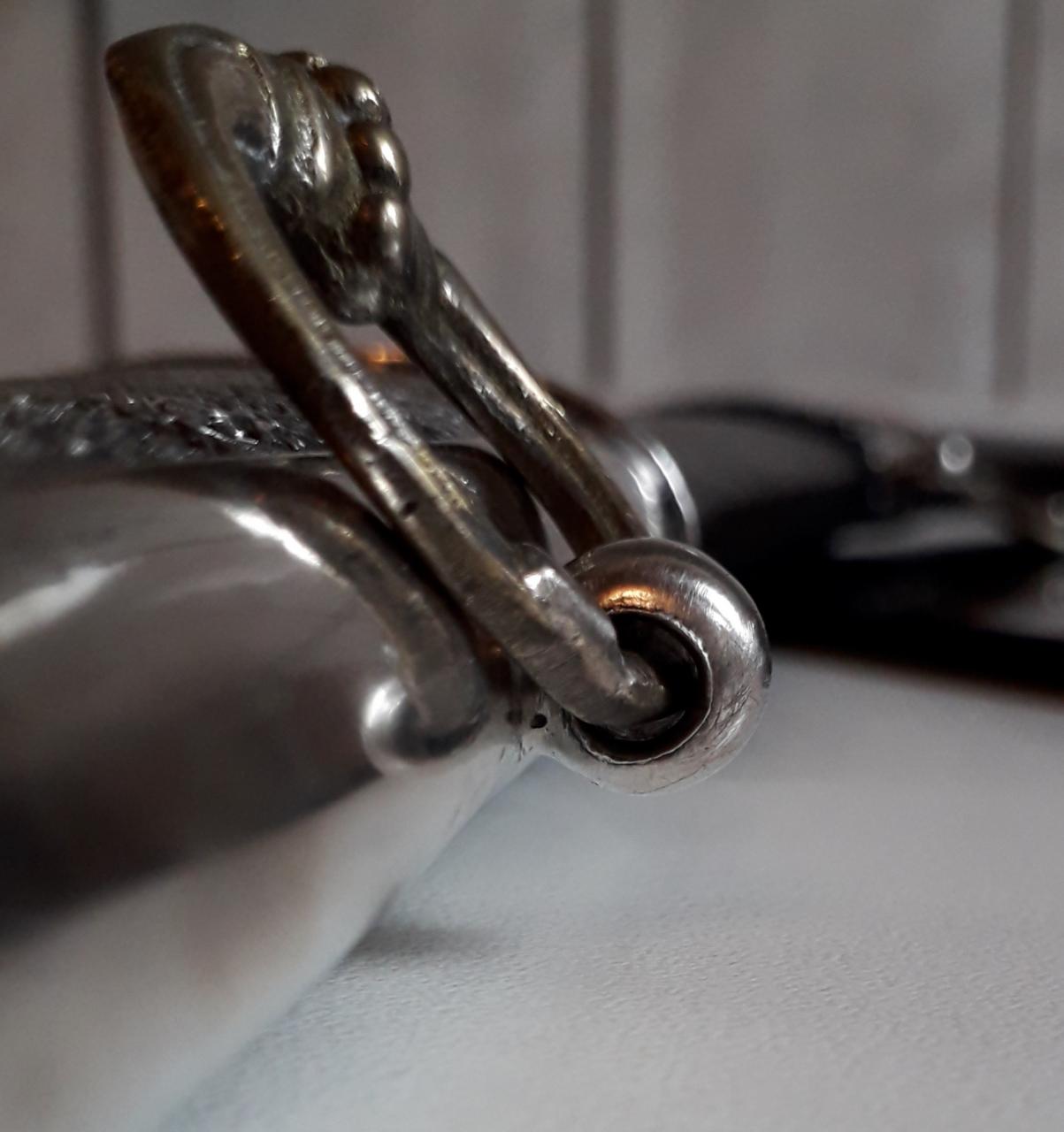

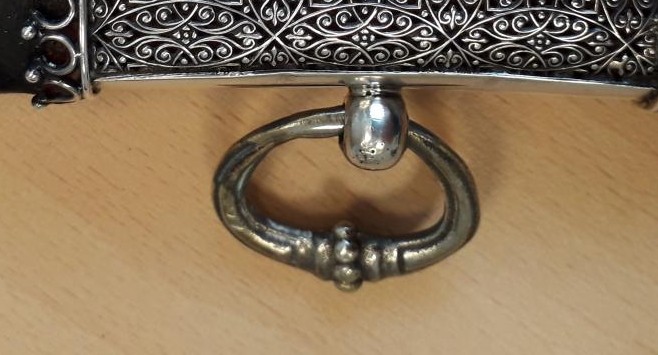

Like I said before, I know next to nothing about Persian and Indian blades. But here some observations:
a. The suspension rings show wear
b. The hilt has dents
c. The top scabbard shape is compressed

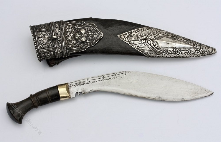

Default Kothimora
Some very interesting observations, especially on the apparent wear on some elements, which of course suggest age. As always, and as with the blades, it is possible older components used.
Robin brought up a curious dagger in his collection several years ago which is actually more like a dirk (14" blade) and the blade appears European from an old hanger. It has a clipped point, and familiar sickle marks, both suggesting 18th century Eastern European blade, likely shortened.
The mounts with hilt and scabbard fittings en suite in silver against the dramatic black material contrasting. .....and as he mentioned in that post the similarity to the Nepalese 'kothimora' kukri's. These silver mounted examples against colors of choice (often regimental) seem to favor the black which shows off the silver well.
These are more a presentation type weapon, typically to officers retiring or other significant circumstances.
What is remarkable is the style of craftmanship, and the gestalt which seems to have certain degree of similiarity. While this styling seems compellingly like the kothimora, could it be that the artisans producing these in the years of the British Raj (until 1947) might have created these kinds of weapons for broader scope of presentation type situations?
Old 27th June 2025, 10:46 PM   #24
francantolin
Posts: 959
Excuse the question,
did you test the silver quality on the hilt ?
Seems too shiny / nickel-white metal alloy
It is that shiny because I polished it. Normally I don't do that with old pieces, but the patination wasn't pretty.

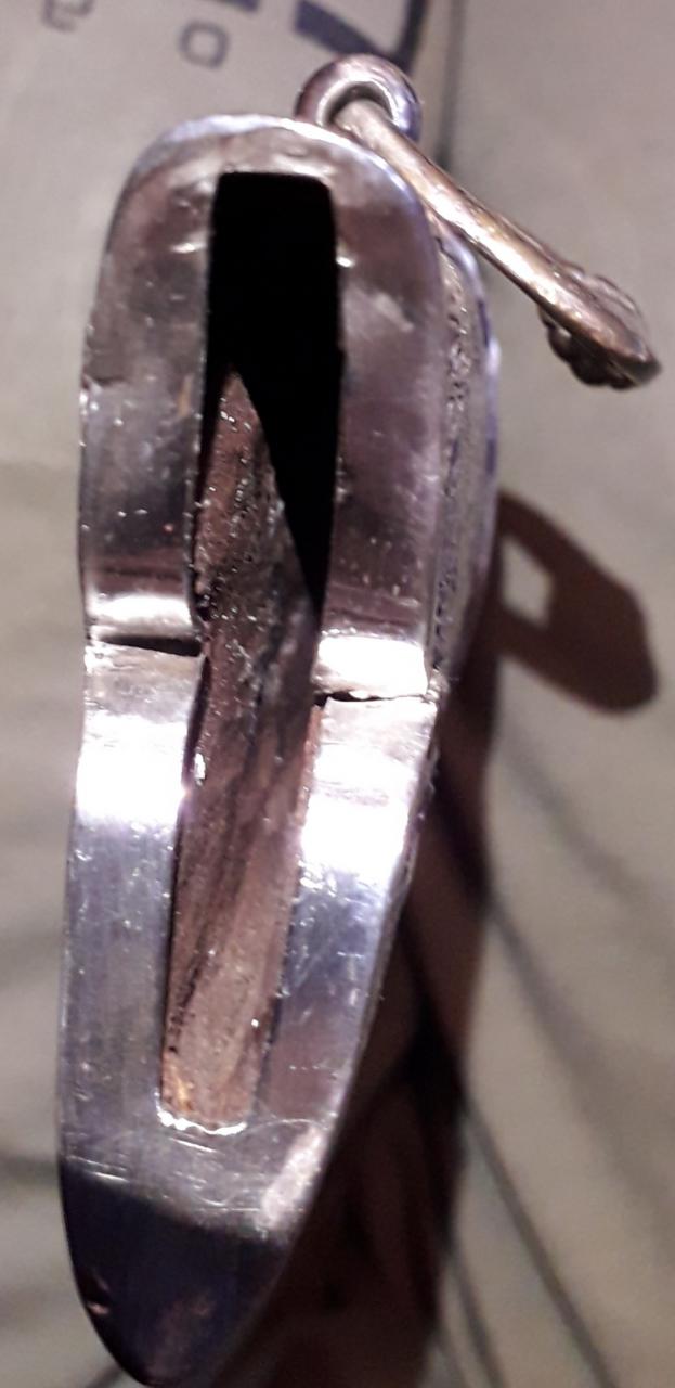

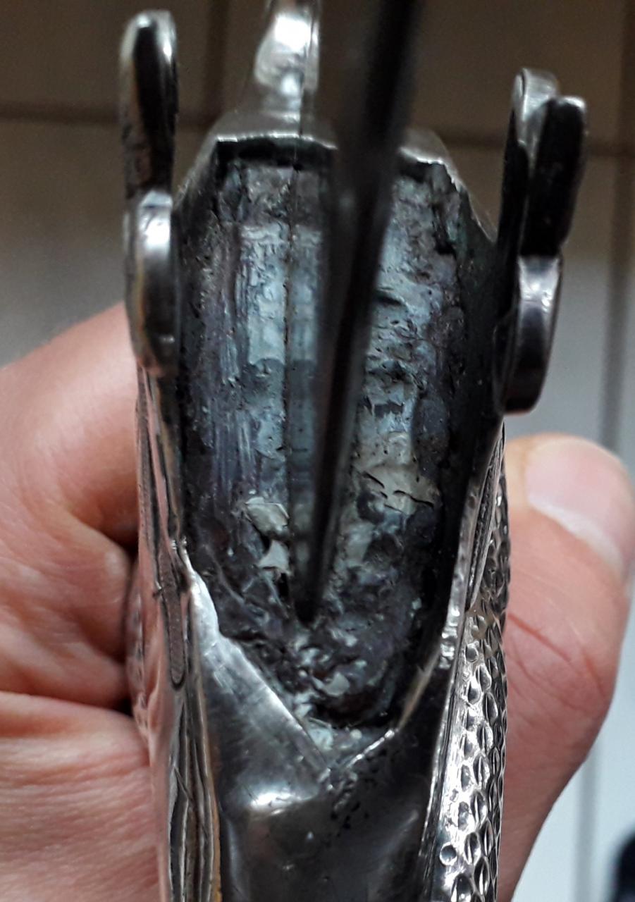

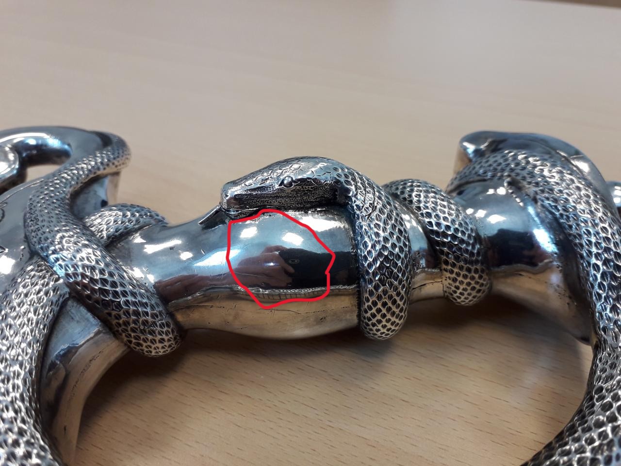

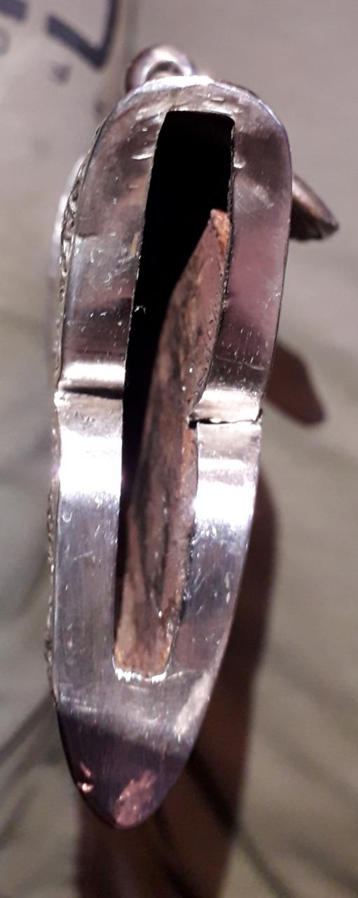

Some further pictures for better estimation of the age. At first the wood of the scabbard, which doesn't look recent:

Join Date: Jun 2020
Location: Germany
Posts: 274
At next the suspension bands. They show traces of wear. Of course not exessive, but I don't think that such a saber was worn every day by the owner:

The "filling" of the handle. It is the same you can find by old Tulwars, something like natural resin and paste which has a stone-like texture. It doesn't look very recent, too:

Location: Germany
Posts: 274
At last the pierced silver fittings. The ornaments were likely embossed with a tool and refinished by hand. To cut that fine decoration completely by hand would be very exessive work, so it not surprising that it was made in a more simple way. However, that may speak against a product far before 1900.

Old 28th June 2025, 12:58 AM   #30
Gonzoadler
Gonzoadler's Avatar
Join Date: Jun 2020
Location: Germany
Posts: 274
Thank you for your input, that is the same I would say, too. An old blade with fittings from the later time of british colonial era in India.
The Afghan style could be a good sign of a production in northern India, like my other dirk-like piece could be from that region, too, because of the Kukri-style fittings.
