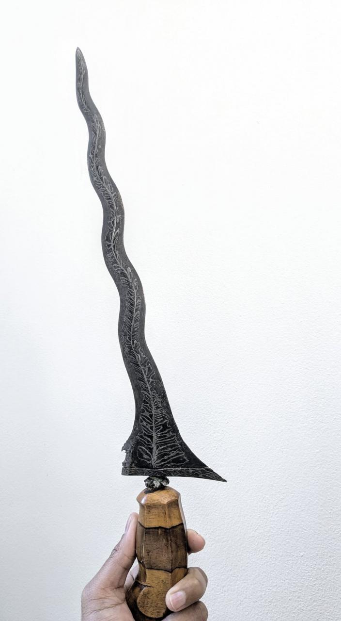

Snatched this up for a bargain at a local auction. Javanese keris it seems, in a Bali sandangan.

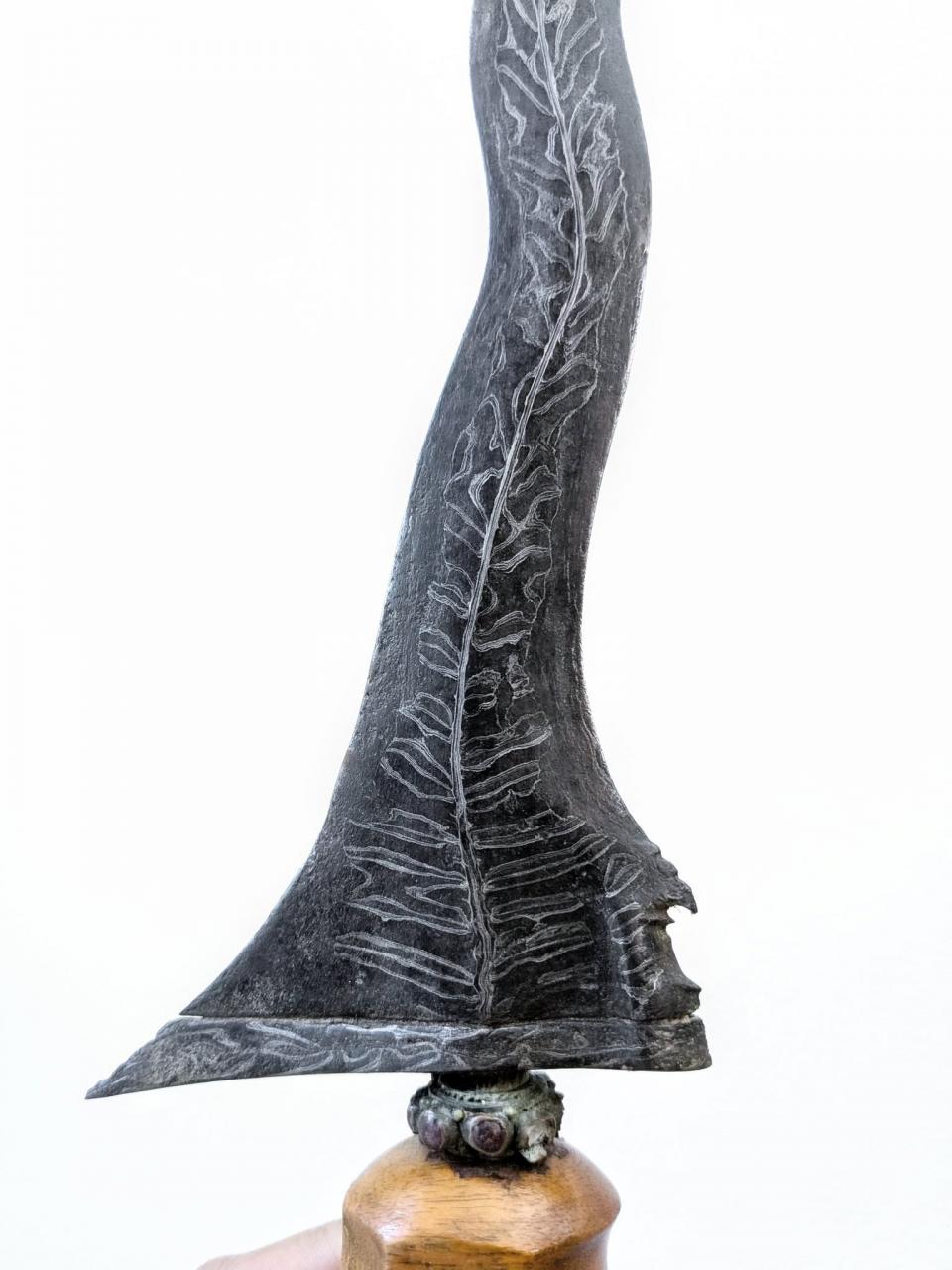

May I please request an ID on the pamor? It looks kind like ganggeng kanyut to me but I'm not so sure.
Ditto dhapur - I checked the Surakarta pakem and could not find an equivalent, but I did not look to deeply.
As for classification, any info here would be welcome. Though I realise not every keris can be classified and even then can be difficult through just photos.

I can't classify it, but it looks like an aquatic plant; Hydrilla or water Thyme.

Nice old keris Jaga. Any wrongko?
We are looking at a remnant pamor motif here, & what we are seeing is not the complete motif. We can see that the "leaves" of the motif are offset , so I doubt that we have one of the blarak motifs. We have no idea at all of what the outer edges of the motif looked like, but looking at the motif in the sorsoran, before it becomes distorted by forging, it might been mayang mekar, but I lean more towards one of the ron (leaf) motifs. As the motif moves towards the point it becomes stretched, and just looking at this blade section it seems to present as ganggeng kanyut or any one of several other possibilities. In any case, in an older blade such as this, it must be recognised as skilled work.
Identification of the dhapur also poses problems, & for the same reason that the pamor motif is not easy to read:- erosion. However, it is a 9 luk blade, it had a kembang kacang & not much else, so I think I'd probably elect sempana.
If we wish to try to fit it to a tangguh classification, we need to base that on what remains to be seen, & what that remnant indicates. The kembang kacang is only a stub, this indicates that when the blade was made it was made with a rather thin & whispy kembang kacang, the point of the blade after the last luk is long, very slightly curved gonjo, no visible ada-ada, no kruwingen that I can see, shallow blumbangan, skilled work in the pamor motif. Taking all these indicators & eliminating the ineligible candidates, I feel inclined to back Madura Sepuh, ie, Old Madura.
In the hand, I could well change my opinion.

Thank you, Alan. I appreciate your generous insights as always.
Also please accept my apologies as I left you hanging. I completely imagined having responded already. Too much parallel processing.
The wrongko is a Bali kajongan. Unfortunately it's got a chip on its front edge. The inlet is also far too big for the keris so I plan on redoing at some point. Adding it to my long keris maintenance backlog.
