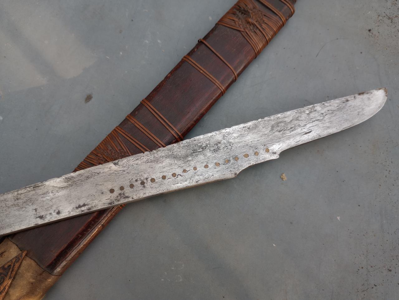

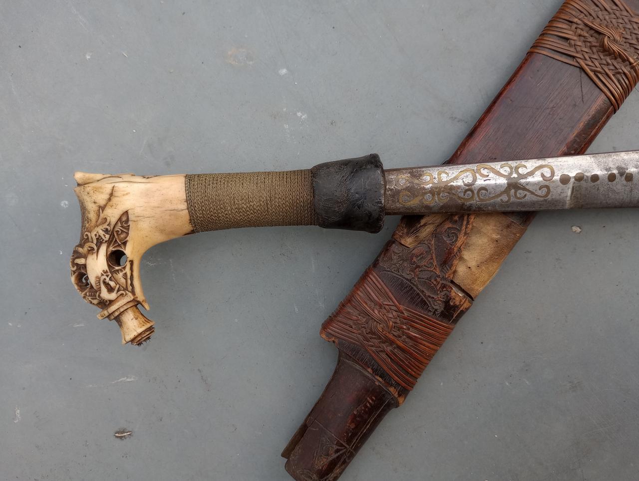

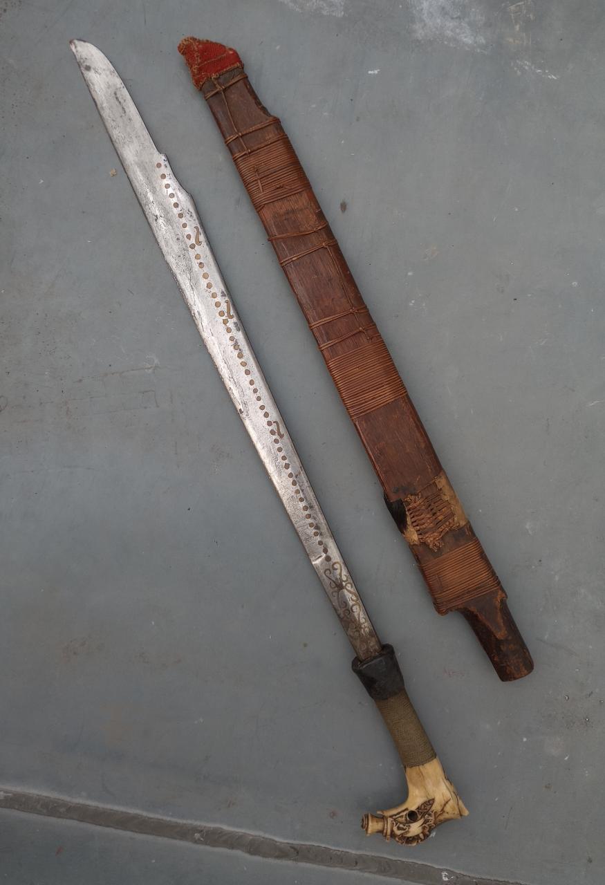

Here some pictures of my mandau which I think qualifies as mantikei.

And thank you for providing the word "mantikei" for laminated mandaus, I searched for nothing in my memories for this word!
PS: I see a little bit of rust at the tip of the blade from your nice mantikei mandau you should care about!
Sajen is online now   Reply With Quote

Originally Posted by asomotif View Post
Roughly / locally forged blades are sometimes referred to as "mantikei".
I have 1 blade in my collection with a similar surface as this one.
They are rare, but I am not sure if they have a special status.
