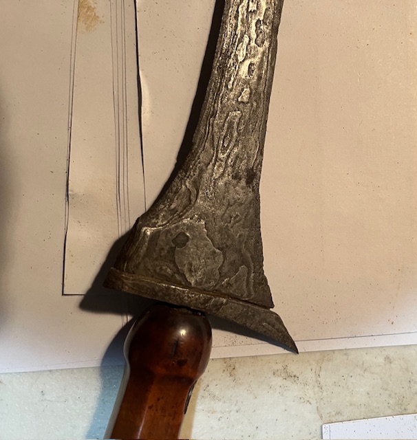

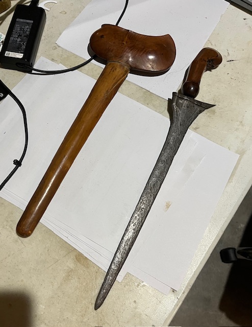

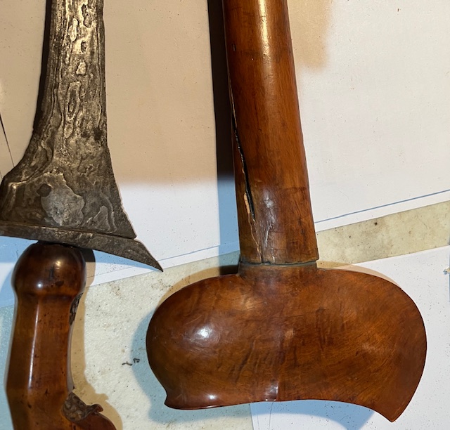

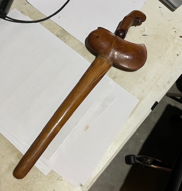

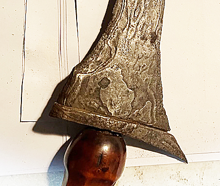

I acquired this kris, which I believe is Sumatran. The blade is layered and shows severe etching from cleaning. The edge is still very sharp, though. The handle is wood with carving. The sheath, unfortunately has damage that was poorly repaired. Even if I could get the old repair glue off there will still be pieces of wood missing when I reset the cracks. Leaving it alone for now.
Question for the forum: How old is this kris? The ganya is separate from the blade. Are the wood handle and sheath original to this blade or later replacements. Any idea of the wood species used on the sheath, in the event I try to repair it?
The blade is approximately 31cm.
A big "Thanks" to all the forum members who have given me great information on all of the various ethnographic weapons I have posted here!

Hello AHite,
My opinion the blade is very likely Madura or East Java. The sheath could also be Madura or East Java, but West Java is a probability as well.
I am not sure about the hilt, but probably it is also East Java, thus the combination of the sheath, hilt and blade in my opinion makes sense. However the combination of the fittings does not really matter since it is very normal a blade and the dress got changed/switched.

I agree, this is not a sumatran kris.
I don't understand the comment about the sharpness of the blade. Krises are thrusting weapons and although some blades are sharper than others the blades are not supposed to cut (as in a slashing weapon).
Handle and sheath are parts which are often replaced and blades are sometimes adapted to different cultural contexts.
It will be certainly ok to repair whatever you have ( and also turn the orientation of the handle which is wrong and add a suitable ring or mendak because it is missing, if the handle or ukiran has been glued needs to be loosened by means of heat because it is supposed to be friction mounted with some cloth or rope around the tang)

My comment about the edge sharpness of this blade is just an observation. However it happened the edges are very sharp, despite all of the erosion of the surface.
I am not sure where I would source the appropriate ring. I had the suspicion that it was missing one, based on the photos of similar keris I have looked at. Also, how is the handle supposed to be aligned? Thanks for the information!

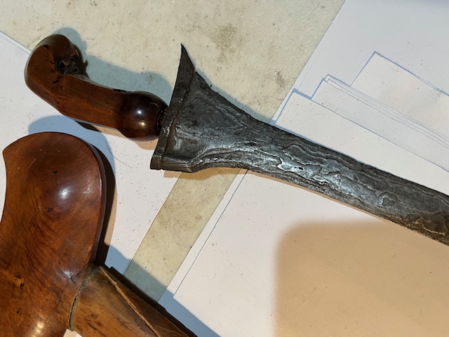

the hilt should be turned 180º, in other words it has to face the other way around. Please observe other Javanese krises on the forum and you will understand how to turn it.
The Mendak or as you say " ring" can be purchased there are many sellers who sell rings of many types. You need one which would go on a a Keris like this please take a look here
http://www.vikingsword.com/vb/showth...=madura+mendak

I tend to agree with Rasdan on the blade origin. Certainly not Sumatran. Blade is most likely 19th century. It is difficult to know if the wrongko is original to the blade based upon your photos. How well does the blade fit into the sheath? I would think it is unlikely that the hilt is original to this keris since this is a Surakarta form of planar hilt that would not be a natural fit for it.
You can find both new and used mendhaks fairly easily in places like eBay. And yes, the hilt should be turned 180º for a proper orientation.

I'd be inclined to think of this keris as "generic Javanese".
As Rasdan has said, blade is most likely East Jawa, maybe Madura.
The wrongko could be from anywhere, when I see these slightly fatter gayamans I tend to think of Banyumas, but I've seen the same or similar from along the North Coast of Jawa, & the far East of Jawa, around Banyuwangi.
The hilt is a Javanese planar hilt, stylistically very possibly Surakarta, but again it could be from anywhere, East Jawa uses this planar style also, & it actually originated in Cirebon. Photographs can often distort the true form of a subject, and this hilt looks a bit to short and bunkul a bit too heavy for Jawa Tengah.
In any case, a pretty nice old "every man's" keris, well worth a bit of effort to give it a facelift.

I have a similar looking blade (also of some age) on a Bugis dress, cross contamination of blades and dress are very common and not necessarily the product of foul play. It still happens and happened in the past too.

If I may post a comment upon this Keris, is a mixmatched between several "pakem" or I sould say "langgam" (perceived style). Obviously this keris blade was forged using langgam East Jawa/Madura. But to my best guess, that it have a tendency toward Madura. Since the Pamor is "Nggajih- ngambang" (floating and staggered as in animal's raw fat). I can not tell if keris was forged using two-toned pamor, until it was dipped in warangan to show pamor's gradation. The resemble of "tikel alis", is a tad off from "pejetan", I suspect that this practice was meant to uppen the offered price, from regular Keris Brojol.
Scabbard is standard Gayaman, with kind of thick upper head, I think it's Ponorogo style. Hilt is obviously Surakartan, for commoner (abangan) since it has no intricate details. No "mendak" (ring).
Thus far, even if the Keris was OK, it's kind of "owahan" (modified). But surely sufficient for beginers to have one.

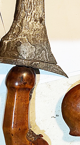

Actually, the jejeran does have cecekan.
In Jawa Tengah, a planar hilt lacking cecekan is usually used for sandang walikat dress, it does not relate to hierarchical status.

That little bit of adjustment that I did prompted me to have a closer look at what remains of the tikel alis.
This keris has the older style of tikel alis that goes right through to the front of the gandhik, & the blade overall has suffered some erosion. That erosion has taken definition from the lower edge of the tikel alis, that is the reason that it looks a bit queer. There have not been any alterations to the blade intended to increase perceived value, it is just an old, simple blade that has suffered some neglect.
It is always difficult to try to make a balanced assessment of a keris from a photo, in the hand many things become apparent that are simply not obvious in even the very best of professional photographs.

Unfortunately, them pictures were one sided, only turned same side but upside down. I wonder if we were fortunate enough to have another side to make further assament to be discussed further, as to make comparison.
I agree, upon inspection, the tikel alis is leaning toward Middle Mataram, the difference perhaps berm-gap between Blumbangan/Pejetan to bottom of Tikel-alis clearly looked as if it was pinched.
By contrast early Madura was leaning toward Hindu Majapahit/Singhasari. In which the tikel alis should be like "J" as in fishing Hook, with bottom end of hook crashing toward edge of gandik.
