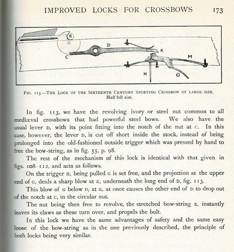

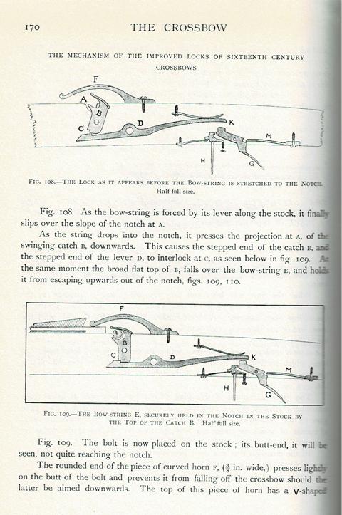

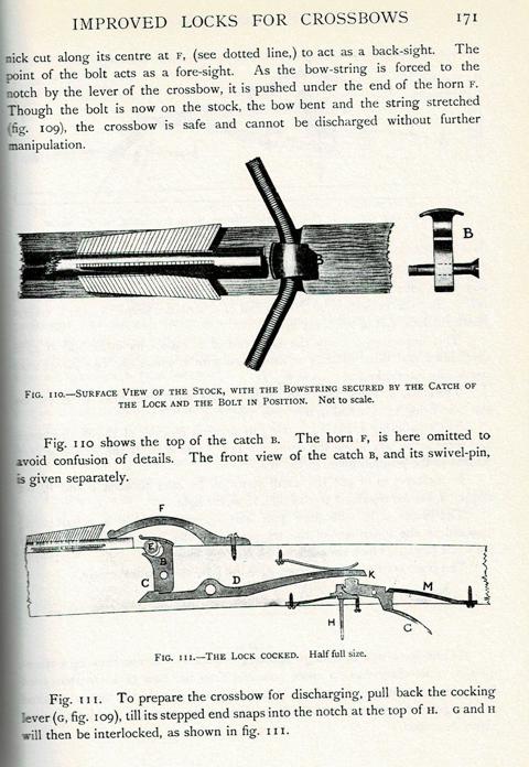

Another question, does anyone have schematics of how such a crossbow should work from the inside?

I hope these pages will help you
corrado26

Do you mean the arming method or the trigger action, Marcus ?
I believe there are various arming systems as also a few evolutions of the trigger system.
The arming of the model under discussion may be seen HERE and HERE.

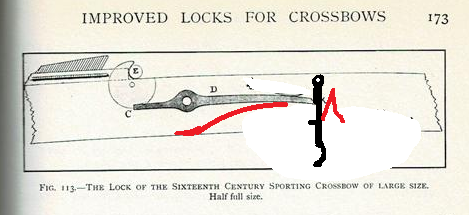

corrado26
corrado26's Avatar
Join Date: Dec 2014
Posts: 1,252
I think after the shot you have to turn back (c) by hand until (d) will engage again, that's all. Then you can stretch the string again
