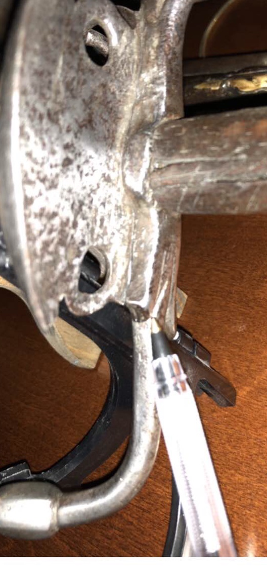

PClemente
Join Date: Nov 2012
Posts: 42
Hey Lads,
Here are more detailed photos of the exact area I was thinking where the guard intersects the quillion.
What do you think of this spot?
Thanks Again!
PClemente is offline   Reply With Quote
Old 6th February 2018, 05:15 PM   #9
Aha! is seee the feature fernando was looking at, it's not another repair. he was seeing it at the wrong angle it that projection i've marked....looks like a lump head on. where he circled it in yellow.
the bit you point to with the ballpoint could be a broken off projection or could have been made like that, still looks a bit blurry to me. If it was broken off, it'd likely have a grainy break surface, with sharp edges, but could have been filed or worn smoother over time. it could have connected elsewhere on the guard, and be smoothed down there too. a field repair?
i have a late 18c french dragoon sword modified or repaired for US continentals that has a branch removed & smoothed to where it is barely perceptible to the eye, but you can feel it a bit lumpy there. anyway, the minor defects add character and improve the story...

PClemente
Join Date: Nov 2012
Posts: 42
Sorry for the confusion.
I circled the point that I was referring to.
What do you think of this area!
THanks Gents!
Old 6th February 2018, 07:47 PM   #11
Yes, it sure looks like is missing a part ... or more .
