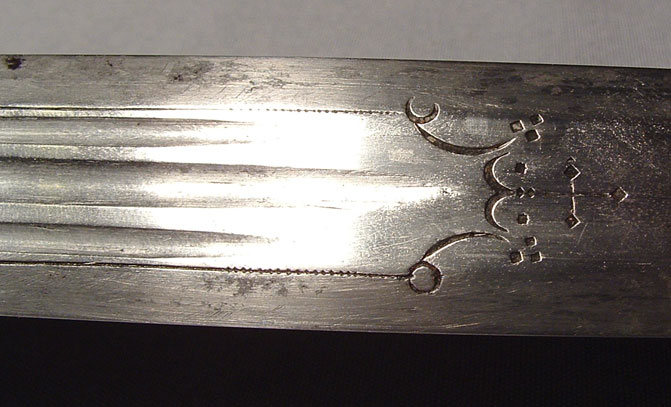

This is one the most incisive and well punctioned anchors i have seen. I picked it from the Internet, October last year, and i deeply regret i didn't register its provenance ...most probably a selling site. All i ( surely) know is that it was struck on a boy's kaskara, .
Perfect, isn't it?
( I hope i am not exagerating )
Fernando

Hi Fernando,
Thanks for posting the 'anchor' this is the symbol I was alluding to before and it reminded me that it was on LEW's kaskara (not nimcha). http://www.vikingsword.com/vb/showt...ht=sudan+german
In the process of trying to find LEW's kaskara I found Jim's four crosses thread.
http://www.vikingsword.com/vb/showt...t=nimcha+german
I will see what I can find on them now that I know what to look for.
Thanks and welcome Don F. That mort is exactly what i was talking about with Hounslow hilts with German blades.
Good Stuff
Jeff

Outstanding responses guys, and now we are rollin' !!!
Great anchor Fernando, and thanks Jeff for more great links.
S.Al Anizi, thank you so much for the kind words and acknowledging the thread, which is developing just as I had hoped to prove a valuable resource for us all.
I hope everyone is noting and reviewing the thread as we go as when a thread becomes multipaged it is often easy to miss important posts, just as I did with Don's significant contribution.
Jeff, thank you for finding the crosses! The three crosses I saw were linear, and as noted on one of the 'Zanzibar' nimchas. These crosses 'pattee' are in an interesting configuration, and seem in a cross pattern itself. We do know that the four cardinal directions were key in folk religion, and again, we wonder if the duplicity here is intended to compound the potential talismanic potency.
Thank you guys!

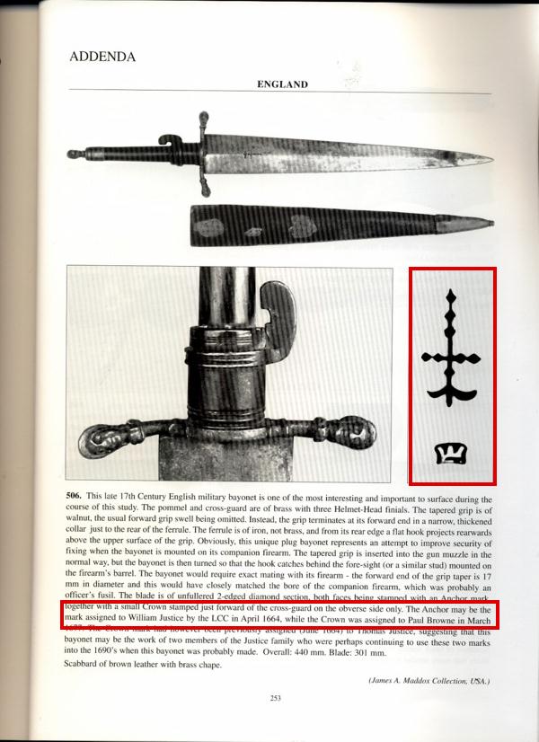

More on the Orb and Cross. This is from Gyngell's Armourers Marks Pg30
Jeff
