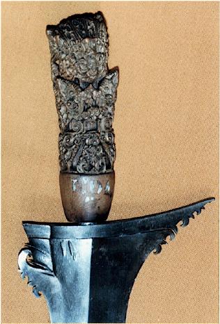

I agree, we can say that Kedah pieces are more rough and rugged compared to Pattani and Kelantan, but in some cases, I see these rugged keris are also being attributed to Pandai Mamat which is either from Kelantan or Pattani . Then we have other Pandai too..
As for the dress, I think we can safely guess that yours are from Kedah. The buntut that you have on your keris is very interesting.
Below is a picture of a keris Pattani sorsoran from the "Senjata Pattani" facebook page which is strikingly similar to your keris.

Rasdan, thank you very much for the picture. There are similarities indeed, yet becouse of the deep Jenggot it looks like a blade from Narathiwat.
Attached the Sorsoran of a Keris, which is provenanced from Kedah. It isn't, of course, a Pandai Saras (there is no Ada-Ada, the cross section is hexagonal).
The Buntut of The PS Luk 9 is actually missing, the other picture is showing a Sulawesi sheath. 2011 I didn't know nothing about Buntut forms from Kedah, so this elongated Buntut was my only possibility to guess.
Like you, I also think, there are so much different features, which originaly could be distinctive for some talented smiths. There surely was an immense intermingling of influences, somewhere is a good post of DAHenkel about that. Clear archetypical forms are rare, perhaps almost impossible, and I feel at the moment, Kedah is bladewise especially "eclectical" - a lot of blade styles and mixing of elements from different locations.

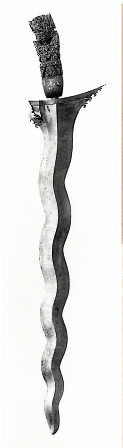

Yes Gustav, the nearer a keris to our present time, the more intermingling features can be seen. I sometime feel that this type of keris are almost impossible to classify with some acceptable accuracy.
G'day Alan.
Pandai Saras, Pandai Mamat, Tok Chu etc are supposedly pandai keris that makes keris to a certain style. It is said that Pandai Saras came from Majapahit. The closest name of a Majapahit Empu to Pandai Saras that I had heard is Empu Ki Sarap. Some say we can attribute these names to certain time period, but I doubt it.
On a different note, I am most interested to a ricikan on the ganja of many pandai saras keris which we can also see on some later Balinese keris - some Bugis and Palembang keris also have this ricikan. I am not sure the name of the ricikan which I mark in the picture below (the Balinese keris is from your website).
Do you know the name of this ricikan and does this ricikan present in older tangguh say, prior to the 1800's? - if we associate tangguh with time.
Also, what are the characteristics of a Madura Sepuh keris present on the above keris?
