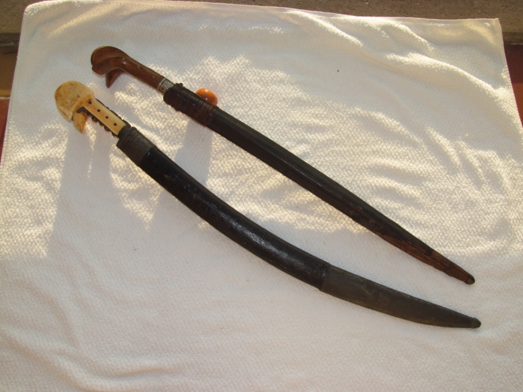

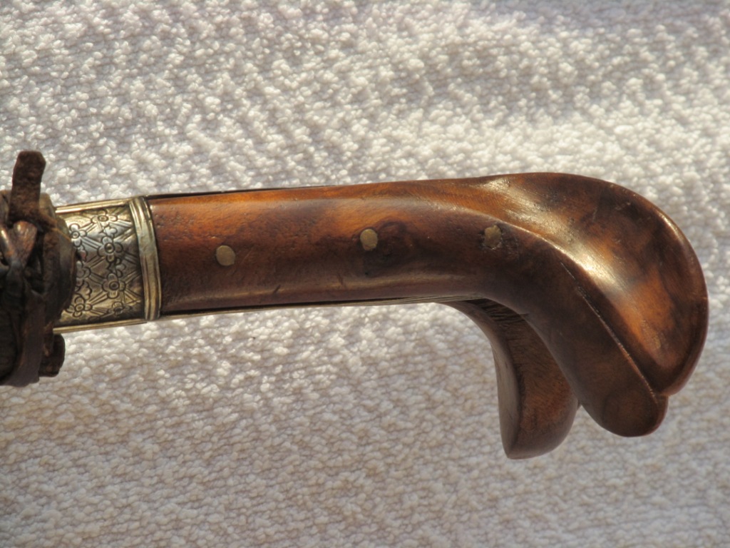

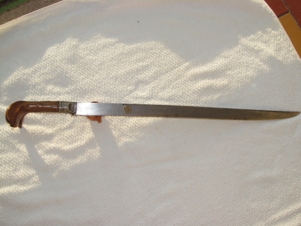

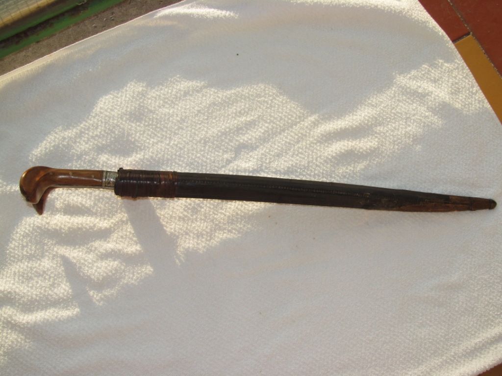

This one is 71. 5 cms long, without sheath 69 cms, blade 55. 5 cms long, 2. 9 cms wide and thickness is 5 mms. The handle is made of hard polished wood, the blade is probably forged from folded steel. I cannot read arabic and would be pleased if you could help me with translation. I do not know origin ( I bought both this yathagan and previous "sabaghan" in Prague antique shop a few years ago).

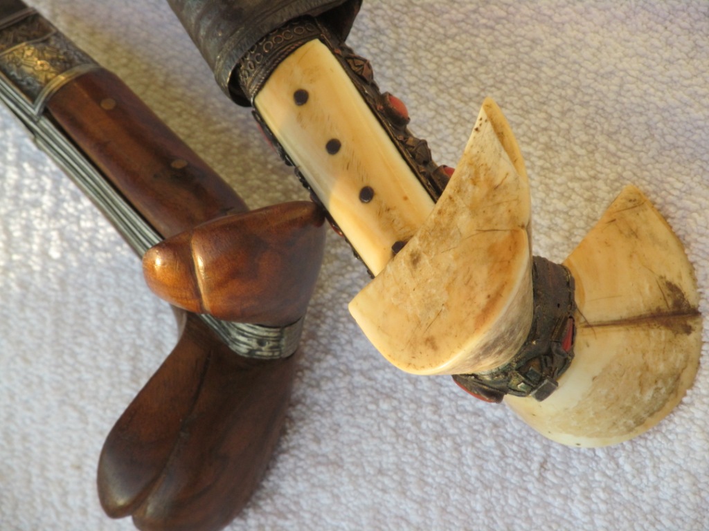

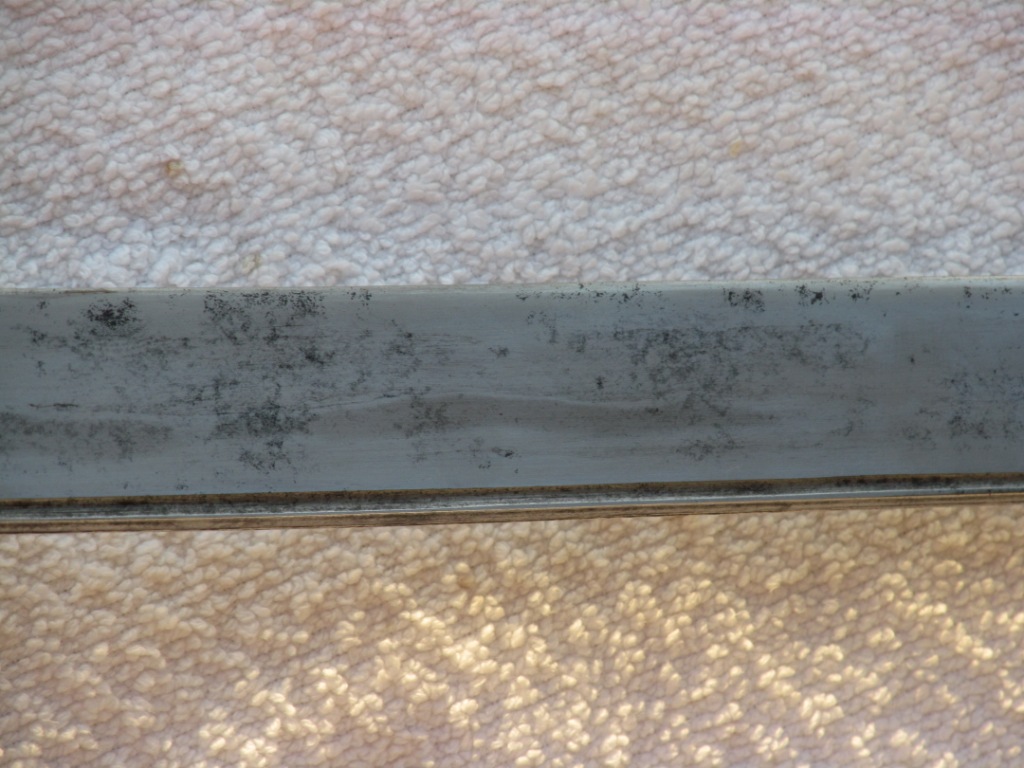

Adding some additional photos

Hi Martin

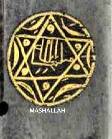

inside the "Solimane star"
"MASHALLAH" either "WHATEVER ALLAH (GOD) WILLS"

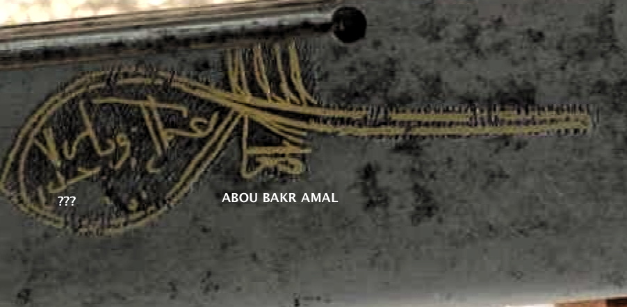

inside the "tughra"
the buckle of the "tughra" means "AMAL" either "MADE BY"
then inside a name ABU BAKR and then second line indecipherable
probably, the second part of the name, but as it's not Arabic, cannot read it
very nice yatagans, specially the scabbard, who kept the leather part for suspension

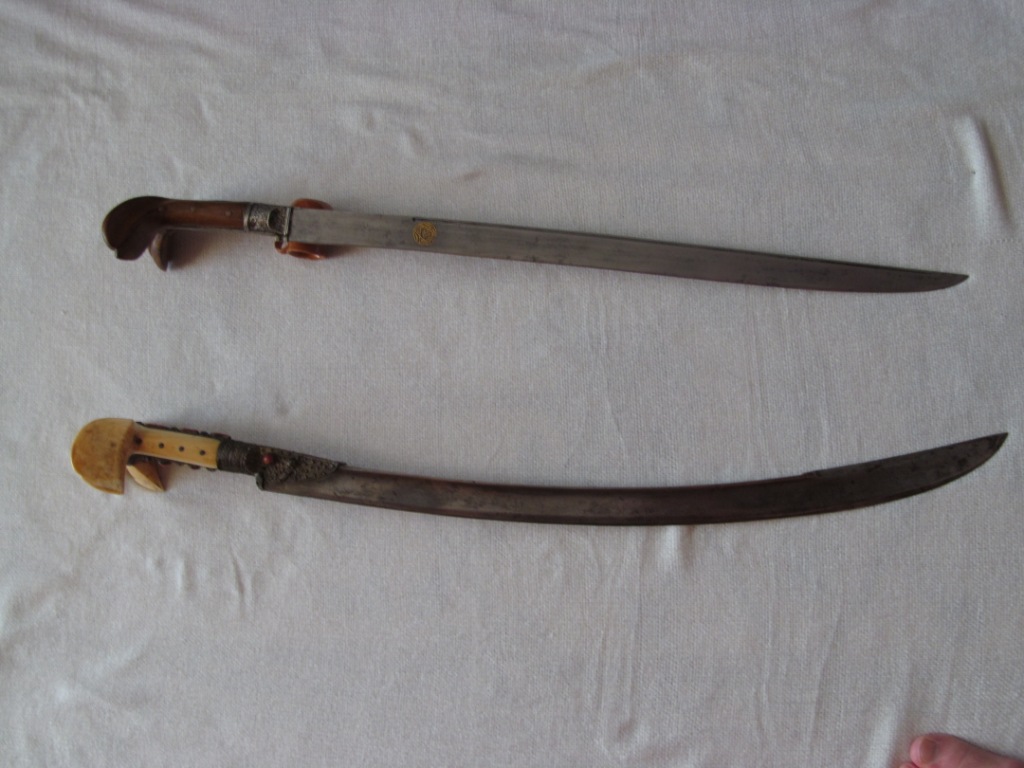

The ivory hilted sword looks like a Balkan hilt with a kilij blade.
Never seen that before.

There is none. In Astvatsaturian's book on Turkish weapons (in Russian), there is a table showing various yataghan hilt variants, but there is no attribution of hilts to geographic areas. Astvatsaturian does divide yataghans into basic groups (A, B, C, etc.), and makes some assumptions on origin, but admits these are just her own assumptions. She is wrong on some of them, like plaing Greek yataghans in Eastern Anatolia, for example. From what I recall, there is nothing like your yataghan in the book, except the hilt variant shown in the afore mentioned table.
Elgood's latest book only deals with main Balkan yataghan types, and Croatian and Turkish catalogues are just books with a lot of pictures and basic descriptions, but no attribuions. Well, the Turkish catalogue (in Turkish) acually classifies all yataghans as Otoman, which is not very helpful.

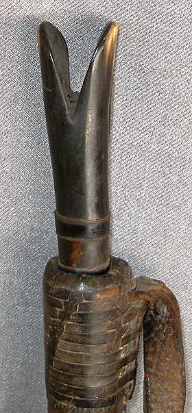

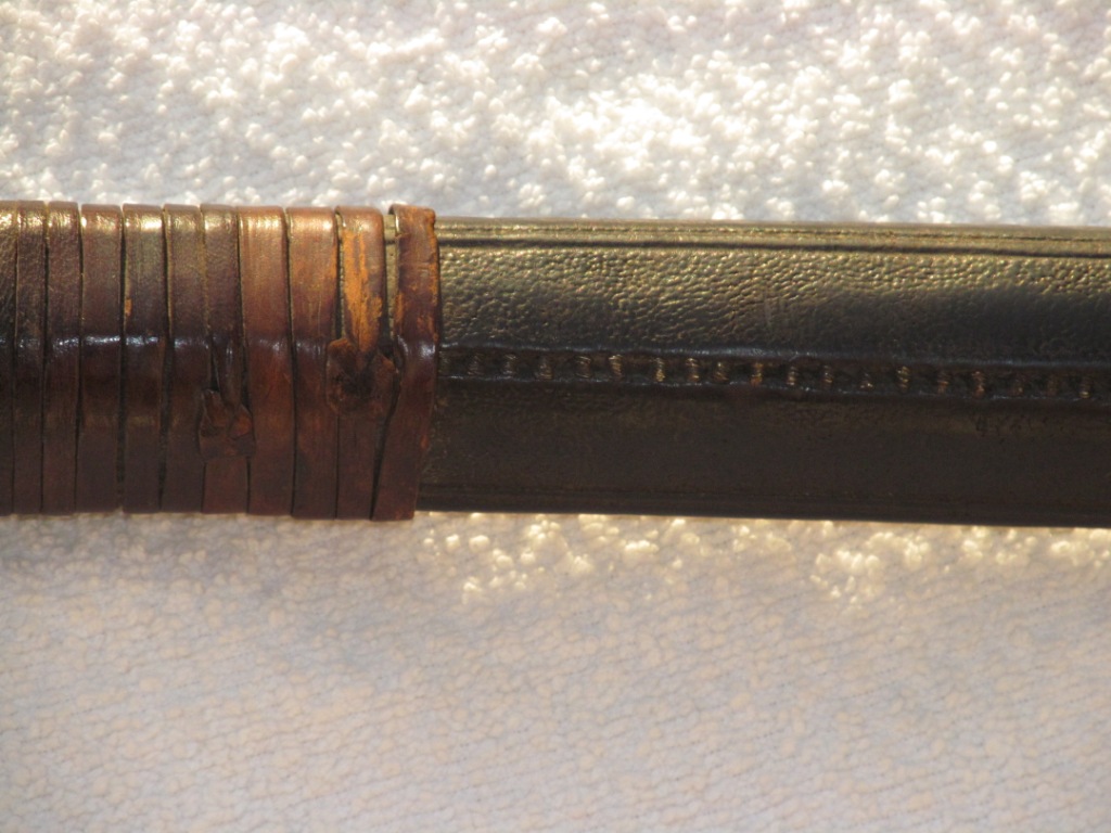

This one is obviously an unusual type with its straight blade, and I have not commented simply because I have no idea where it could be from. There are a lot of straight blade yataghans in the Croatian Museum catalogue, suggesting that straight blades were popular in the Western Balkans, but this one is more slender compared to the catalogue examples. The leather wrapping at the scabbard mouth is reminiscent of Asia Minor examples. The ears and the bolster are of a rare form.
Nice yataghan in any case.

Hi,
Trabzon piece owned by Lew, scabbard mouth somewhat similar.

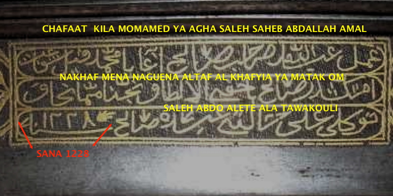

Great post. Maybe you can help me too. Can anyone translate this? I am not even sure I have the right side up!
Overall length with scabbard: 31”, w/o scabbard 29”, length of cutting edge: 22 1/2"
These photos are not up to my normal standards. I took them with a cheap camera I keep in the car for emergencies.

Hi "dana"
1st line
AMAL ABDALLAH SAHEB SALEH ARA, YA MOHAMED KILA SHAFAAT either
MADE BY ABDALLAH OWNER SALEH AGHA (title for a civil or military officer) O MOHAMED, INTERCEDE ON BOTH, IN THIS WORLD AND IN THE HEREAFTER ...
2nd line
OM MATAK CHADRE SALEH YA KHAFYIA AL ALTAF WAGUENA MEMA NAKHAFeither GOD WHO HIDE WHAT WE DON'T KNOW
3rd line
TAWA KOULI ALA ALETE ABDO SALEH - SANA 1228 either I AM DEPENDING ON (GOD), YOUR SLAVE SALEH - DATE - 1812
two words, not Arabic, have escaped from the understanding of the translator, may be in Turkish language
line 2 "CHADRE SALEH" ??
fantastic yatagan, I should like to have of the same quality
