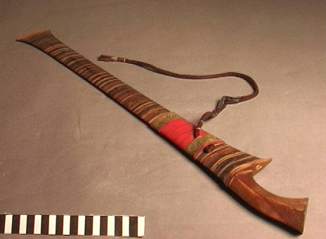

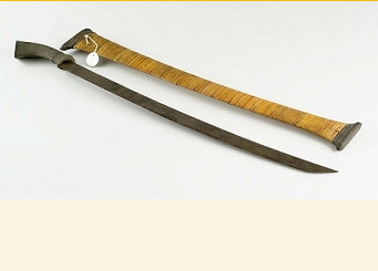

Hi,
here some examples of our national museums.
The size of the first one ( Tropenmuseum ) is sadly not mentioned
the descriptions give the places "Banten" and "West Java."
I'm curious about the balance of such a long thing, how does that feel?
the other one is 74 cm.
Arjan
