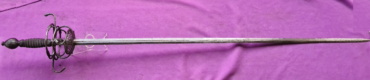

Would you agree this is a XVII century "Milanese fencing school" rapier?
The estoc blade has a diamond cross section and measures 107 centimetres (over 42") not counting the ricasso; with a width at forte of about 13 mm (1/2") and a thickness of 7 mm ( less than 5/16").
Single deep fuller in 1/5 of its length and point of balance 5 cms (2") from the guard.
Do i see a Pappenheimer touch in the guard little basket ... married with a swept hilt (lace) concept ?
But what do i know ?
I am not even at home to check on Norman's, to try and classify the pommel; a sturdy one, by the way!
Any coments on tis piece, Gentlemen?

Hi 'Nando,
My first thought on this interesting piece was that it might be a Pappenheimer rapier of ca. 1625-30, the pommel though obviously in excavated condition and of English provenance. My expert friend Ottmar has corrected me this afternoon; while confirming my opinion that the pommel is an inapt English find, he says the rest is a civilian rapier of ca. 1640, probably German, and the wire binding is a modern replacement.

Hi Guys,
I have seen a few similar spanish blades c 1650, but without the lasso guard and with straight quillons. The grip is obviously "new" (18th C?) .
A serviced heirloom? A reworked, "updated", ceremonial sword?
Italians did have a tendency to curve _both_ quillons toward the point.
Best
M

I am very much with Michael as my first impressions were in accord with his, as everything I could find in Norman directed toward English origin for this elongated globular pommel. Obviously the pierced shells directed toward a pappenheimer as well. What was distracting me was that as Celtan has noted, the blade resembles rapier blades which were in use mid 17th and into the early 18th century by Spain. It has seemed to me, by the markings and inscriptions, that these were likely produced in Solingen for export.
The wire wrap is indeed replacement, but cannot say from photos exactly how old. I believe that Michael's very well informed friend is quite on target in the German assessment and period, and the sword well illustrates the very composite nature often seen in rapiers as they were reworked to maintain servicability and often changing fashions.
I think that the well established connections between Germany and England in the time period noted may account for the variation in components, as this was during the time when the contingent of Solingen swordsmiths went to England with the establishment of the Hounslow manufacturing center. This is not to suggest this is a Hounslow rapier, simply that a well established contact was in place between the two countries with regard to these commercial matters.

Hi Fernando,
very nice rapier, this pommel is used frequently in England in the early 17thC but in my opinion and in this case it belongs to this rapier and the rapier is indeed German, ..............so is the pommel.
For comparison see a rapier in my collection signed by Clemens Meigen with the same type of pommel and the same hexagonal bulbs in the ring-guard and a similar fluted quillon block as the pommel .
best regards,

Thank you all, Gentlemen.
It is no surprise that the wire wrap may not be the original one, as so often happens. I don't think however that it is a modern work, but has probably taken place during its service life. It is a perfect job, with a rather intrincate wiring and embelished with two little turk heads.
Concerning the pommel; reading Norman and checking on type #36, mentions are made on this fluted variation to appear in Brithish illustrations. But checking on plates #49 and #51, we observe these types mounted on swept hilt swords of North European origin. Also in the Wallace Collection we find these pommels, for instance A 627 and A 630. Reading the respective notes, we notice that, the first is mounted on a Milanese swept hilt sword and the second also on a Italian example.
We know that the rigour of these things deserves a pinch of salt. It might be that, for experts, this pommel may look inapt in this sword, but i happen to like it and am glad that it is a period item, nobody stating the contrary ... plus its self speaking aged texture.
Oh, i see that, while i build this response, Cornelistromp has posted his opinion on this piece.
Let me digest what he has to say about it.

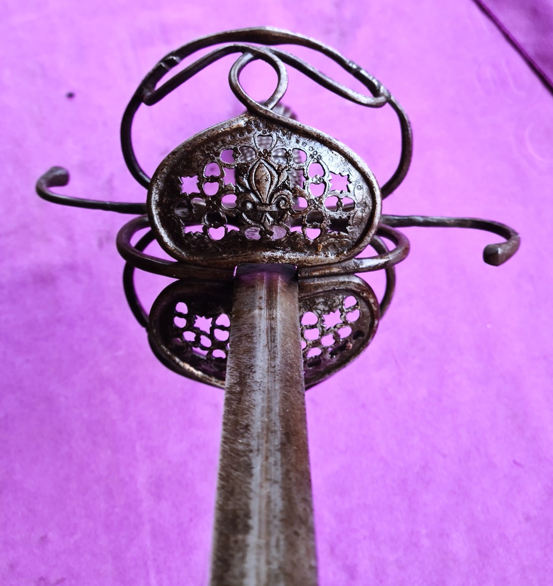

Hi 'Nando,
The pommel obviously is in excavated condition as compared to the rest of the iron parts.
Michl

In my earlier post I mentioned that there were of course distinct affiliations between Germany and England in the 17th century, and the Hounslow factory was begun with German swordsmiths brought there by invitation by the English king about the time of the English Civil Wars.
I agree that the metal used in various components would result in different types and stages of corrosion and wear. As noted, the rewrapping and refurbishing of hilts often accounts for the somewhat composite nature of rapiers typically found. These swords were often reworked as they, like many weapons, often had service life which lasted beyond a single generation.
Once again returning to the multinational nature of these components, the shells in the guard, which are as agree of pappenheimer style, in the pierced openwork seem to reflect a quatrefoil shape. While obviously an architectural feature often used widely, it brings to mind ecclesiastical style, and reminds me of that in many English churches.
I do hope this suggestion might be considered as I would like to know if the shape of these designs might be relevenant in possible further English origin for this rapier.

It definitely does, Cornelis and Jim,
The fact remains though that the pommel is in excavated condition and could never have originally belonged.
m

That exactly the right size and type of pommel is found is way too coincidental.
no, my vote goes to ORIGINAL.
the color of the metal and the pitting is consistent with other parts of this rapier.
Because mostly the pommel is touched over the time by hands here one sees more severe pitting.

Very true. Hilts _and pommels_ are often replaced because of hand-sweat's salinity. And due to the different steel qualities, swords retrieved from churches or tombs often needed to have both replaced.
In cold, dry climates, _oiled_ blades kept protected within leathern scabbards often survived for long periods (even if the scabbard did not) , while he exposed hilts/pommels suffered direly.
IIRC, we had an interesting thread on that years ago, didn't we Jim?
To me, the pommel looks good, but it might be a replacement. How easy was it to replace a pommel?
Nando, is the sword well balanced? If its not, there we have the answer.

I follow your reasoning, but I differ somewhat. I believe that the part of the sword that is mostly in contact with the hand is precisely the pommel, specially if it is as big as this one is.
I speak from personal experience, I often carry swords around, and to control their movement while walking I usually keep them held by the pommel. Try it yourself.
