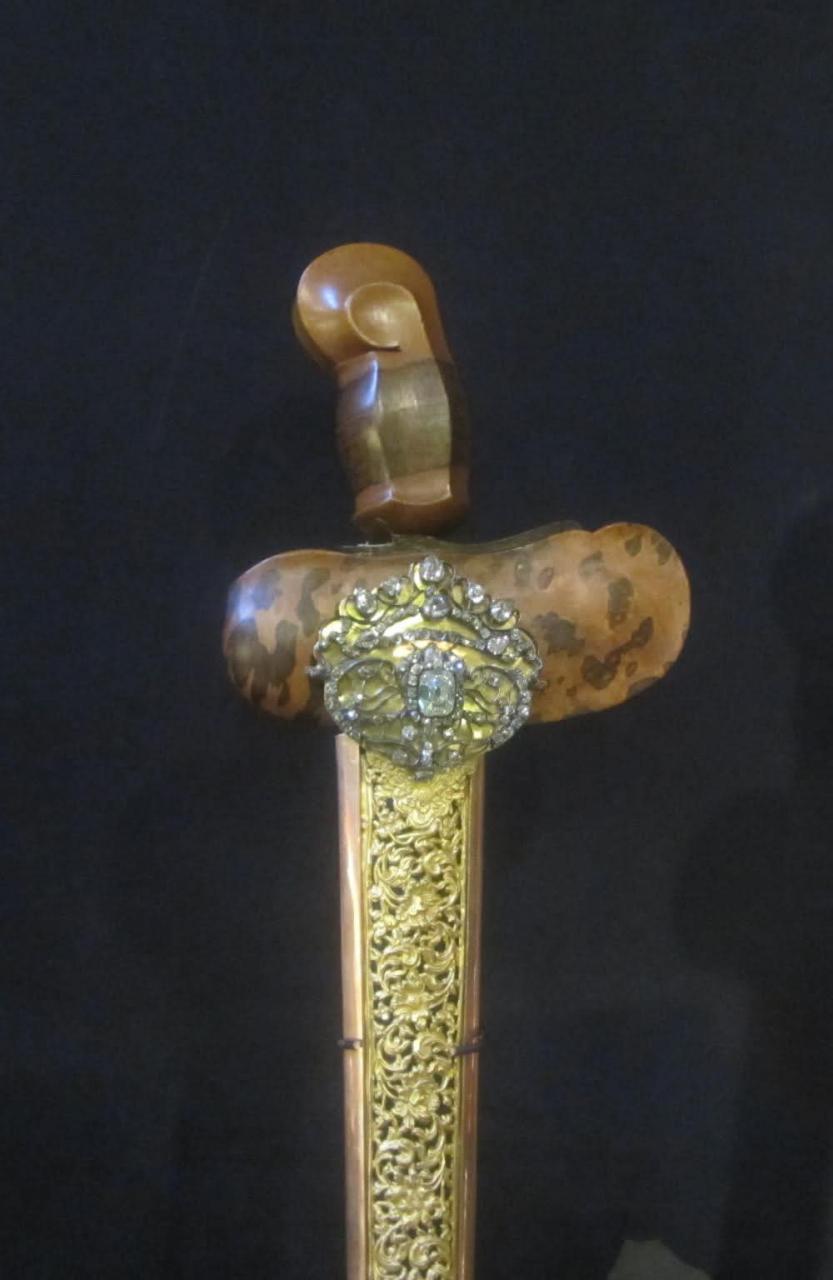

Another keris with ricikan similar to mine once belonged to Sultan Tjakradiningrat II of Bangkalan. It was presented to him by the company for assisting in the suppression of a rebellion in Cirebon. Like mine, the blade juts out slightly from the warangka.
