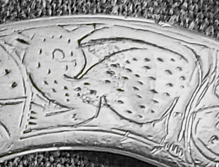

Thanks Lee!
I see on the ring a rabbit, and on the brooch... a squirrel? Not so impressive as Jim's wolves!
