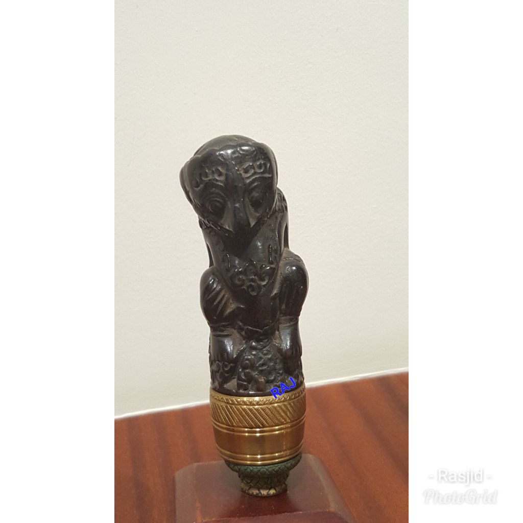

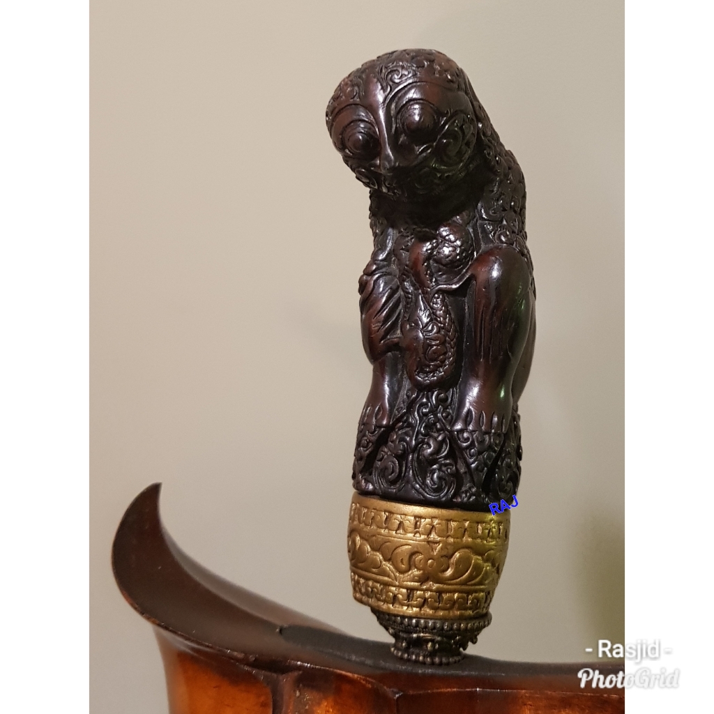

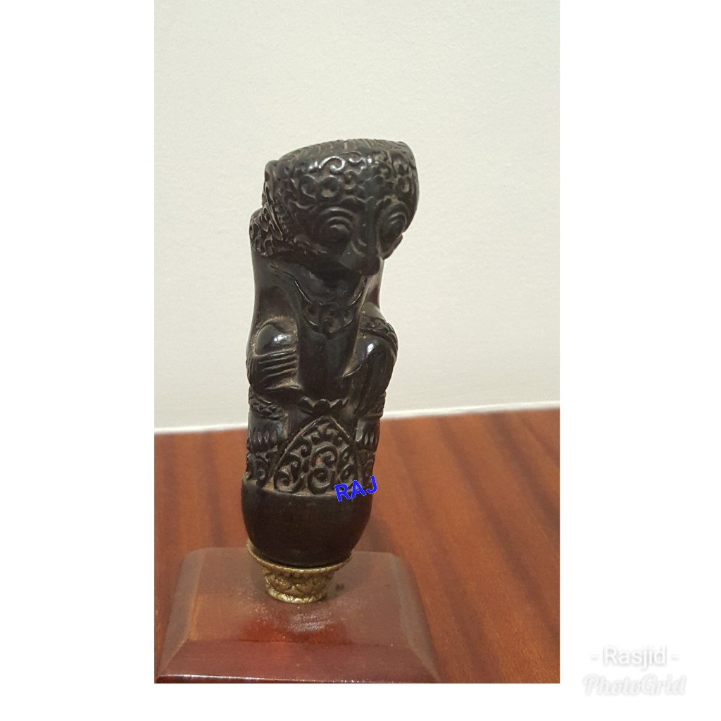

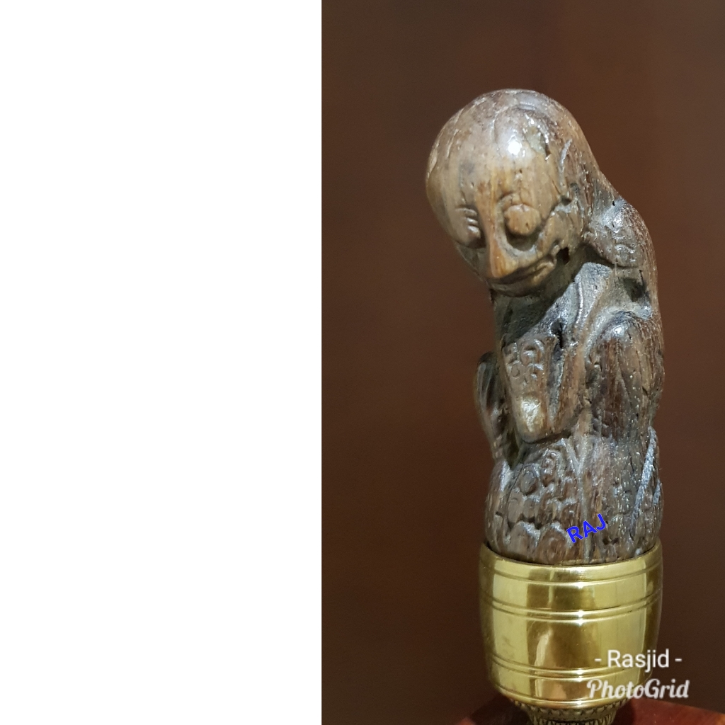

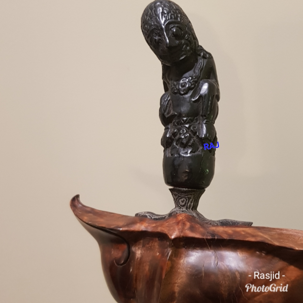

My samples here: its just a variation from the carver?
1. One crown over the head
2. With snake over the shoulder
3. Something in front the chest, or pendant?
4. Round head?
We really do not know for sure, but what we can be sure is:
1. Material used
2. Carving quality
3. Old or newly made or processed
4. If any fixing being done
Rasjid

Very interesting questions Rasjid, I have the same with no definite answers
However it seems to me that these are just variations of the Cirebon "buta bajang/ Bima" style whatever you call it. In his book "Gods, Demons, and Ancestors" Marco Noris calls the hilts with a bird shaped nose/ beak as "pulungan".

Yes Jean, agreed. They all similar but from local discussion they talks some differences if they have crown and no crown? Means younger age or older?
When we discuss like more specific detailed about hilt, its become more complicated as who is the real trend setter to make statement?
For Keris, we can from keraton Solo for example about Solo keris.
Alan mentioned many times, keris knowledge change following which group you are belong too... its the nature but if we are discussing a high level keris, even from photo given at certain degree we can come into a conclusion or general agreement.
rasjid is offline   Reply With Quote

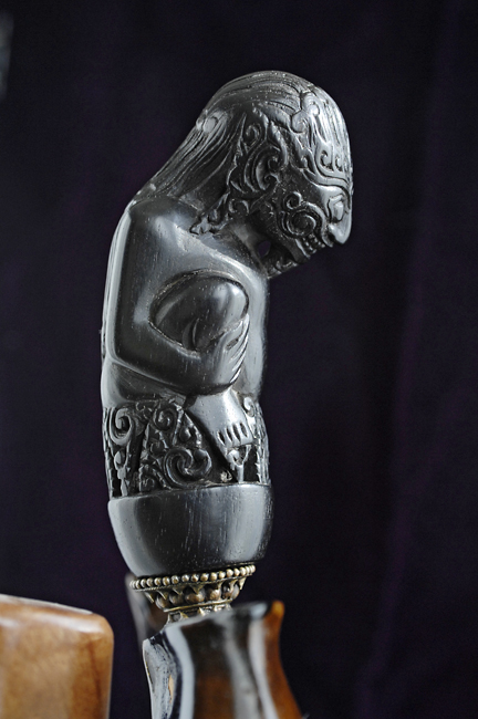

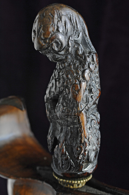

Here are a couple of my Buta Bajang hilts. One is very old and the other is a nice contemporary hilt that i believe holds to traditional design. I don't know if either of these has characteristics that would lead a more knowledgeable collector to label it "pulungan". It does seem that the body position in these two hilts are somewhat different, with the contemporary one in a deeper squatting position and the old one seems more seated atop something. That in itself might designate these hilts by completely different specific names.

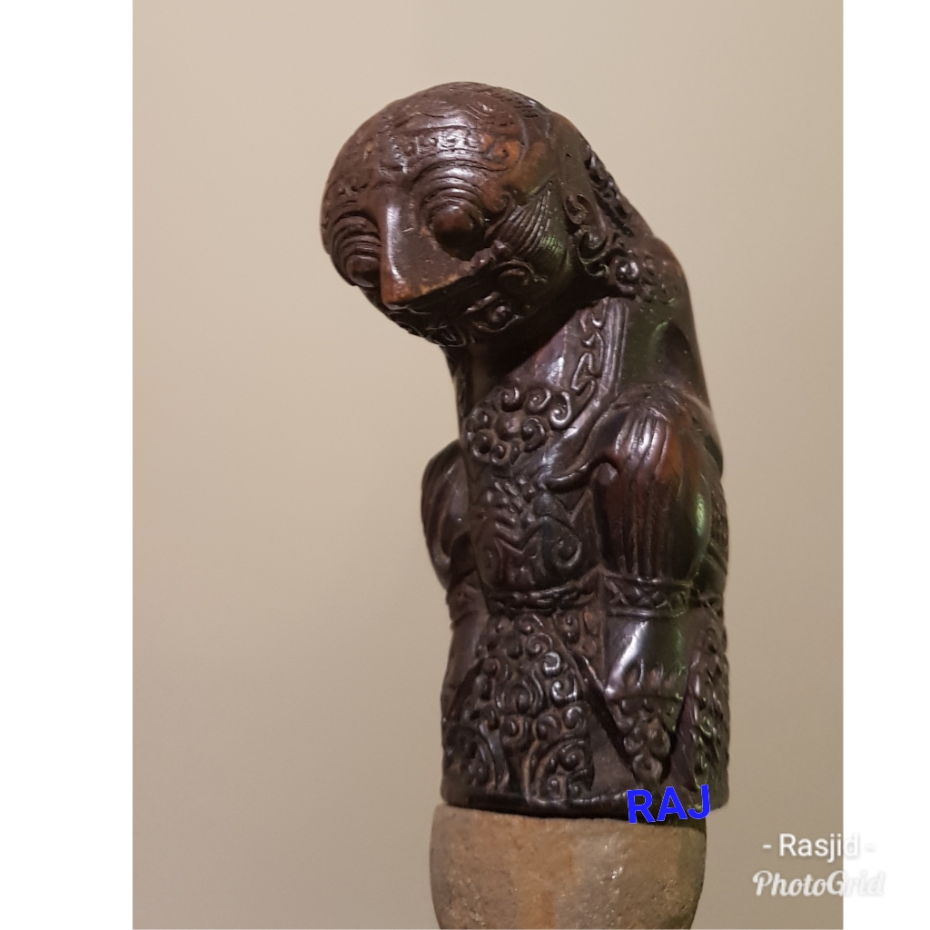

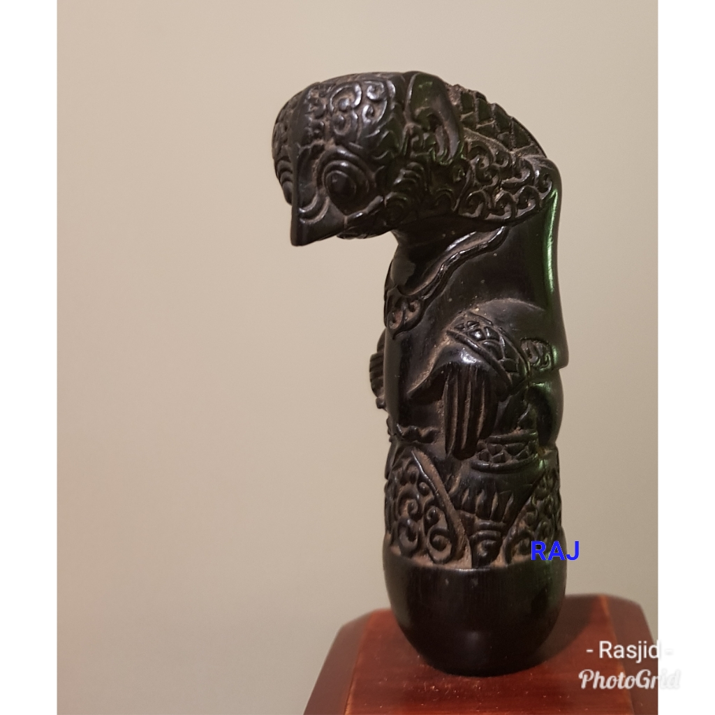

David,
I have one also...
bold, wood n fossilized, heavy in weigh.
called buta bajang? I'm no expert and not involved in the naming game. Its old and made from wood material.
Rasjid

Thank you Jean. Is this yours? Nice one.
A new thread would be good for bebekan.
