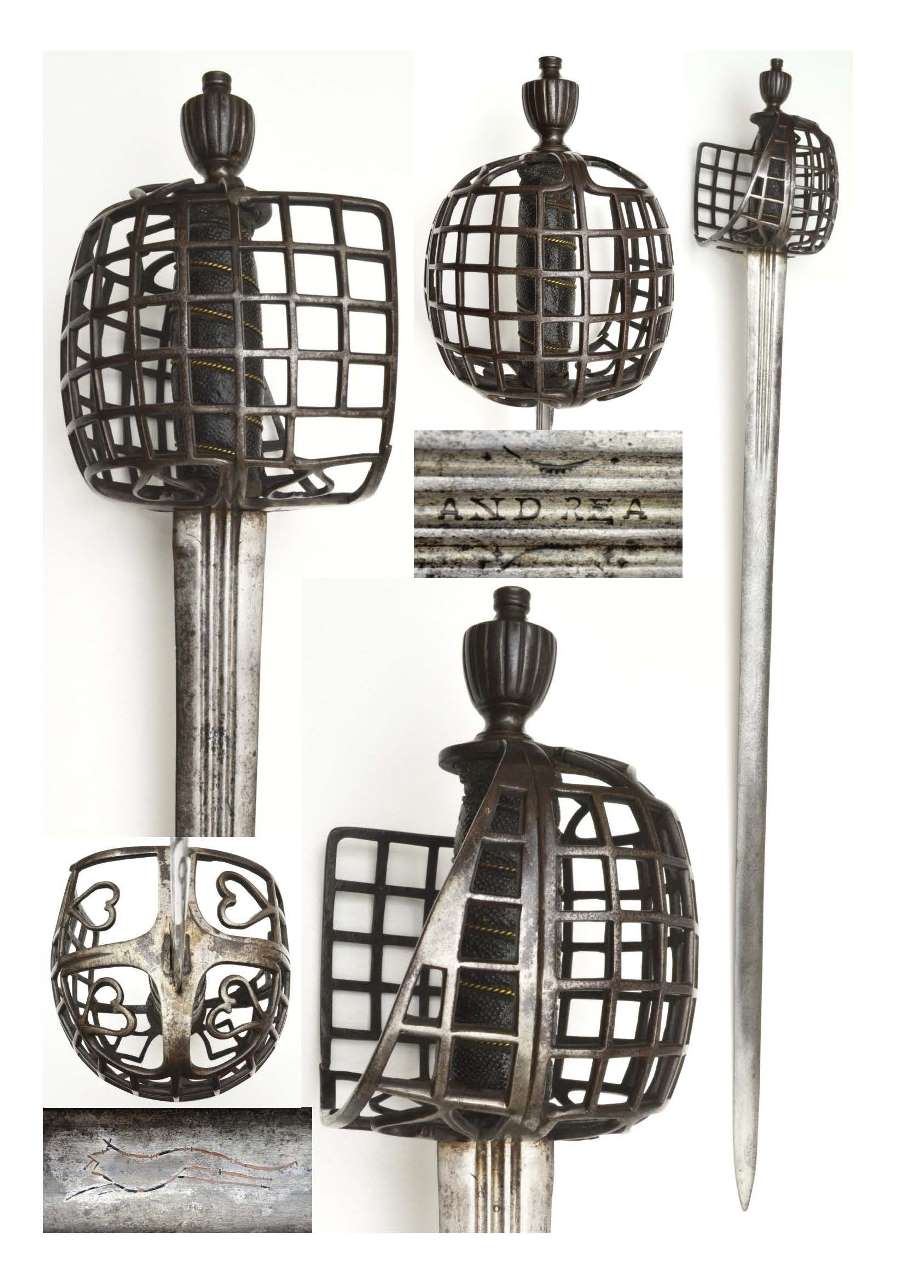

On the blade of Cathey's latest baskethilt post: take a look at the blade of her S hilt brass basket on page 1 of this thread. Same blade. I have personally seen multiple examples of this blade type in the brass S hilts of the mid 1700s, and as I recall, Neumann shows one as well. That being said, my bet is that they are German imports of the 1700s.
--ElJay

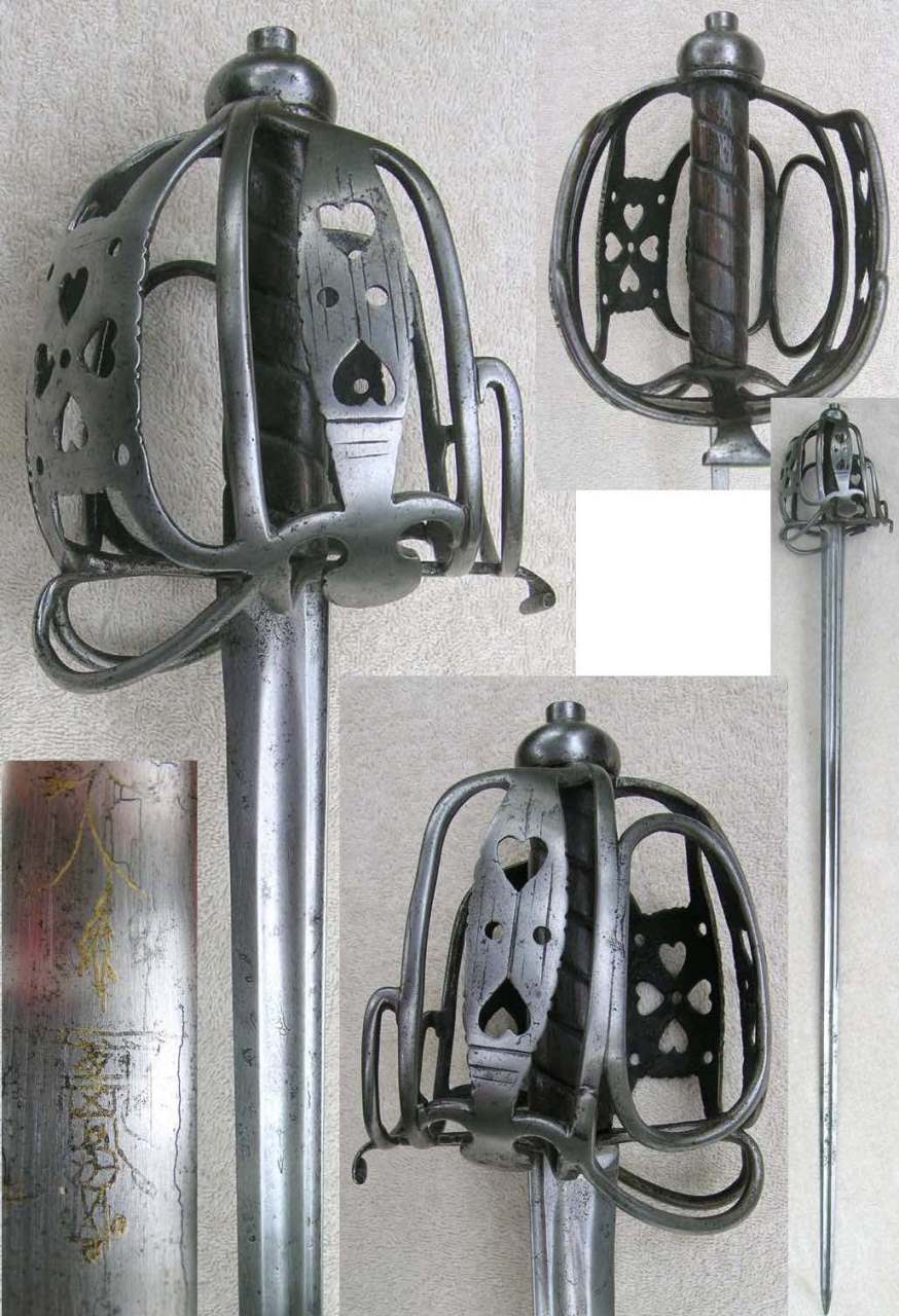

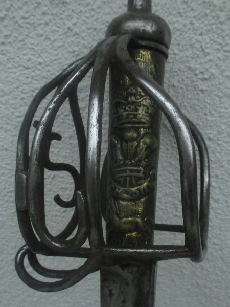

Default BASKET-HILT c1745 British Dragoons
HI Guys, another British basket
Overall Length: 117 cm, (46.1 inches)
Blade length: 101.5 cm, (40 inches) Back blade from hilt for 58cm
Blade widest point: 3.128 cm (1.2 inches)
Marks, etc: Remnants of etched pattern inlaid with gold on both sides. Scottish thistle and sun design still evident
Description
BASKET-HILT British Dragoon Guards Troopers Sword pattern 1745. Unusually Large Basket hilt with typical heart design and English style Bun Pommel. Wide central fuller full length of blade, slight remnants of etched pattern inlaid with gold on both sides. Scottish thistle and sun design still evident. Blade is 101.5 cm, back blade from hilt for 58cm.
Dragoons were originally intended to be used as mounted infantry. In the early 18th century, cavalry was divided into 2 categories - regts of horse and regts of dragoons. The regts of horse were used in the traditional role of heavy cavalry - i.e. shock action. Dragoons were used mainly for reconnaissance - and usually fought dismounted in battle.
References:
BEZDEK, Richard H. SWORDS AND SWORD MAKERS OF ENGLAND AND SCOTLAND pp 282
MAZANSKY (C.) British Basket-Hilted Swords: A Typology Of Basket-Type Sword Hilts. Pp97 Fig Fle & 125, Fig F17c
Scottish Sword & Shield Catalogue September 1994 Pp 6 No 8.
Wallis & Wallis Connoisseur Collectors Auction Spring 1996 15/5/96 Lot 126.
Wallis & Wallis Connoisseur Collectors Auction Spring 1998 7/10/99 Lot 82.
Wallis & Wallis Connoisseur Collectors Auction 5/5/04 Lot 52
WILKINSON LATHAM, John, SWORDS IN COLOUR Plate 29.
Cheers
Cathey and Rex

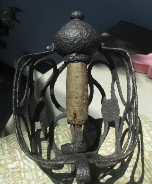

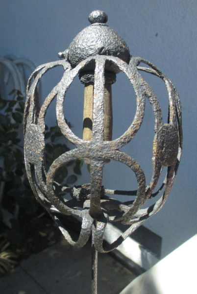

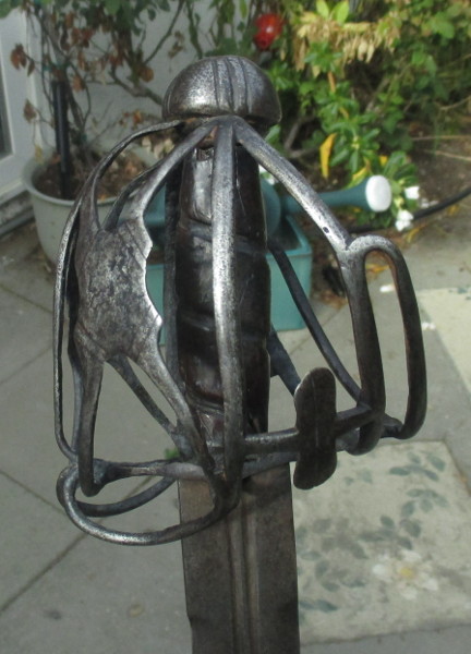

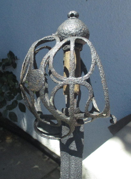

Here's my next basket.
English, ca. 1620
32 1/2" de blade, with short central fuller.
Excavated condition, but retains part of the grip and both brass wire Turk's head knots. The knucklebows are screwed to the pommel. Interestingly, this basket has the feature of a screw-on capstan. Most hilts of this basic pattern are dated in the late 1500s, but I date this one to the 1620s because of the total lack of the long quillions that characterize earlier examples.
An interesting feature of this sword (and something that I didn't think to photograph!) is what looks like langets at the blade shoulder. However, what appears to be langets are actually a repair. This blade apparently broke right where the tang meets the shoulder. The repair was effected by making a tang that has ears protruding on either side of the blade. The blade was inserted
between the ears and the whole welded back together. I'll be able to access my collection again in a few weeks, and will try to remember to photograph the repair.
E.B. Erickson is offline   Reply With Quote

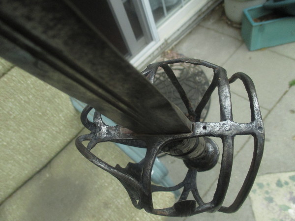

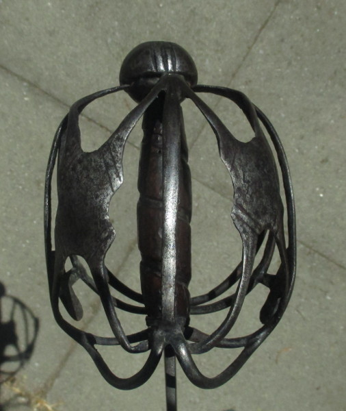

Another one.
English? Scottish? Probably dates 1680 - 1720 or so.
31 1/2" de blade with two narrow fullers extending about 8" down the blade. No stamps or inscriptions are present.
Hilt of fairly typical form for the late 1600s with plain unpierced panels with some simple filed/engraved lines. The grip appears to be original. An interesting feature of this sword is that rivets have been used to reinforce the hammer welds (see last photo). However, there's also an additional hole by the blade, and what is this hole for??? Securing the liner?
This is one of the lightest basket hilted swords I have seen. The hilt is composed of rather thin elements, and the weight of the sword is about 1.8 pounds.

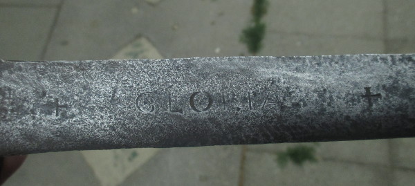

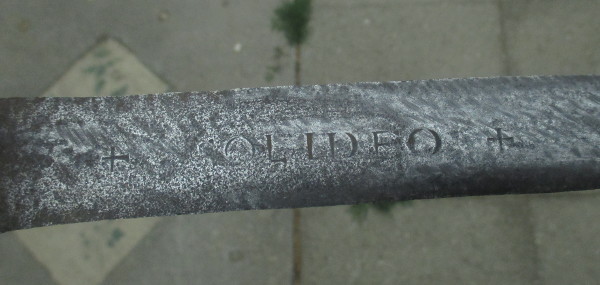

The first of my Mortuary swords. This one may not even qualify as a basket or half basket (not enough protective bars making up the hilt), but since Mazansky covers Morts in his book, this sword is not inappropriate for this thread!
Mid 1600s in date, with a 32 3/4" de blade inscribed on one side "+ SOLIDEO +" and the other side "+ GLORIA +".
What makes this sword of interest is that it has a thumbring, a feature not found commonly on English swords. The hilt decoration is composed of four grotesque faces, and foliage with some sparse piercings. The grip is one of my restorations, and the diagonal lines seen in places on the blade are artifacts of where some idiot in the past used an angle grinder on it.

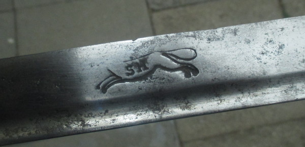

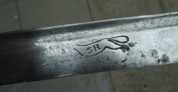

English, early 1700s.
30" se straight blade with a single back fuller, stamped on both sides with a running fox and SH.
This is apparently a grenadier's baskethilt of the 23rd Regiment: the Royal Welsh Fusileers. The grip is of embossed brass, each side with a crown, POW feathers, the motto "ICH DIEN", and a Hanoverian horse. Neumann shows this same grip design on an S hilted hanger (sword 26S), which is dated to about 1745. I think that the sword shown here is a pattern used ca 1700 by the 23rd. The blade is not shortened, and the fuller ends about 7" from the blade tip.
Mazansky shows several hilts of this type in his book.
Salaams E.B. Erickson The running fox with SH beautifully illustrated on the blades is of course from the Wood Street, Shotley Bridge Factory !! now refurbished as a fine house. What is not that well known is that the company also acquired the local Inn closeby... The Crown and Crossed Swords.
Ibrahiim al Balooshi.

The whole idea here is to learn from these weapons, which we are all doing together, so no such thing as an amateur....especially when one has the courage to step forward and make an entry regardless of status.
Thank you so much!
Very much agreed, the blades are intriguing, and offer us much toward learning more on the history of each sword as a whole.
On that note, I would ask more on a question Cathey directed to Eljay (post #89) concerning the Samuel Harvey mark often seen on British dragoon blades, in many cases initials SH in the running wolf.
It seems that at some point the 'S' was dropped and the 'H' stood alone on the 'wolf' (fox as termed in England).
I tried to find what I could on the Birmingham swordsmith Samuel Harvey, which apparently was the name of Samuel Sr. (b.1698) ; junior, and his son the third. Senior died in 1778; junior in 1795 and grandson in 1810.
Since all three had the same name , that would not be the cause of the omission of the S.
It would seem that there were a number of variations in marks, in that a slotted hilt (c.1780) had a crown over H/vey....some were marked S.Harvey with no fox.....some cavalry blades were inscribed Harvey and one example (I think in Neumann) has a fox with only the H, dating from 1750-68.
Does anyone have more data on variations of Harvey stamps?
While on many types of swords, some of the British dragoon basket hilts had Harvey blades......any examples?
Salaams Jim, I stumbled upon this http://drbenjaminchurchjr.blogspot.c...3_archive.html which examines the Hounslow Factory(and a possible copy of a sword in the USA) and indicates that the H in the Fox is from that Foundry...thus perhaps not the Harvey designation. I have somewhere in a pile of notes a sword photo with the Harvey stamp in a block with HAR then VEY underneath.
Salaams Cathey ~ May this have a bearing on your #154 and #156. The single H being for Hounslow not Harvey?
Quote" A "Hounslow Mark" was placed on a sword manufactured in Great Britain by the Hounslow Sword Factory, established in 1629 when a number of German swordsmiths emigrated from the continent to England to begin work at a sword factory, located in Hounslow about 12 miles just to the west of London, that was established by an entrepreneur named Benjamin Stone. The different swordmakers put their individual marks on the blades they manufactured but some put their names on instead. Many blades were left unmarked. Not a great deal is known about the individual marks but the swords produced by the Hounslow factory were the best made in England, even if they did not quite match the quality of the swords made on the continent. The Hounslow factory made thousands of blades and swords".Unquote.

Hi Ibrahiim al Balooshi
I thought you may have solved this mystery until I looked at the dates Hounslow was in business. I have gone through a few articles on the Hounslow makers and whilst two of these show pictures of the fox with the H and describe this as an authentic Hounslow mark, there is no historical link in the body of the articles to support this or link it with a particular maker.
It appears Hounslow opened for business in 1620 and ceased manufacturing in 1660, which in some cases is earlier than a number of blades I have seen that bear this particular mark.
One explanation might be that a family that left the Hounslow business continued to use the mark into the 1700’s. Time wise the Harvey family remain a better fit for the dates of swords bearing this variation on the fox mark which we do know they used. Also apart from the missing S, the fox mark is virtually identical to the one used by Harvey.
If we could find a link between the Harvey’s and Hounslow then we might be on to something.

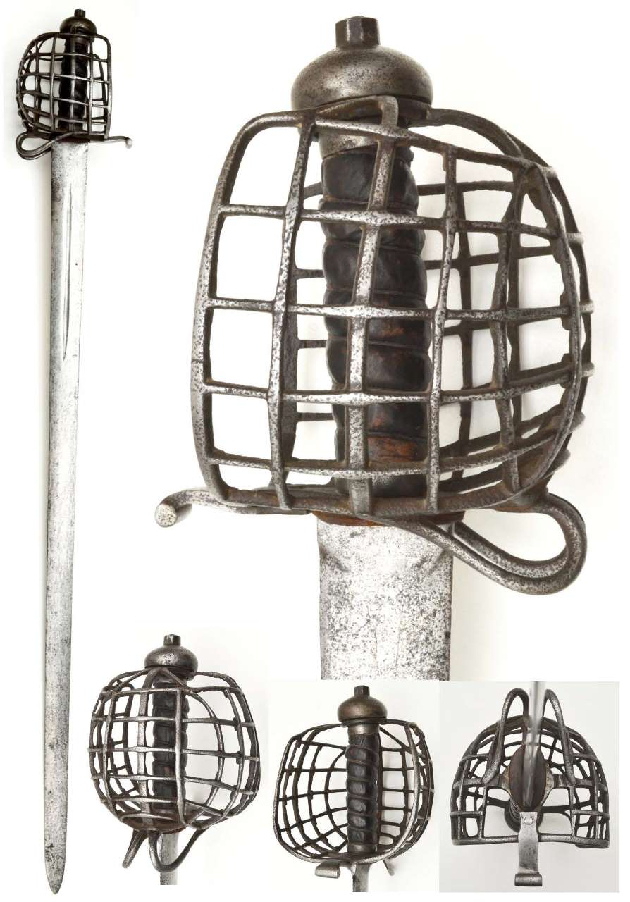

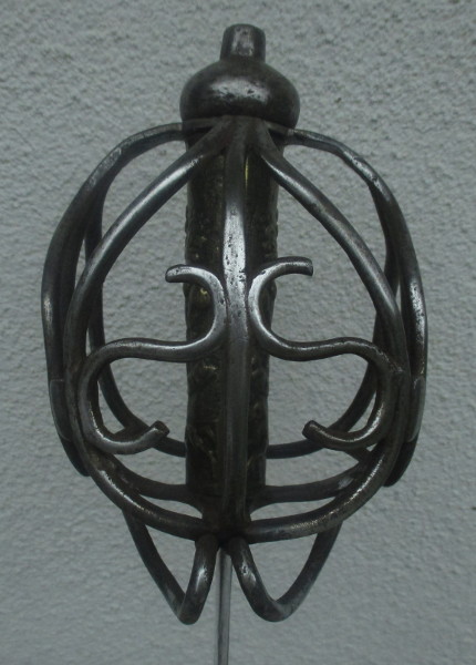

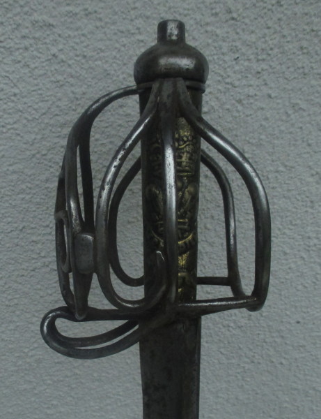

Default Howard Basket Hilted Officers Sword
Date: 1740-55
Nationality: British
Overall Length: 103.5 cm (40.7 inches)
Blade length: 87.4 cm (34.4 inches)
Blade widest point: 3.673 cm (1.4 inches)
Hilt widest point: 10.6 cm (4.2 inches)
Inside grip length: 9.5 cm (3.7 inches)
Marks, etc.: Mark ANDREA and the 17th century version of the so-called “Passau running wolf
Description
The hilt is constructed of fine iron cage work three quarter guard formed of a vertical and horizontal arrangement of narrow bars joined at the top by three scrolled bars, each with pierced diamond-shaped central panel, to a ring beneath the pommel. The spaces beneath the guard with three openwork hearts. There are a number of very old period repairs to some of the bars and one of the front bars has a crack toward the blade. The grip is leather warped with brass wire. The pommel, an Adams style urn shaped one, is almost certainly a replacement dating from 1785-95. The broadsword blade has three short central fullers and bears the mark ANDREA and the 17th century version of the so-called “Passau running wolf mark”.
General Remarks
Described by the Baron of Earlshall as “An English Cavalry sword, very probably for an Officer in the Household Cavalry and dating from 1740-55. The pommel, an Adams style urn shaped one, is almost certainly a replacement dating from 1785-95. However, it has an extremely good 17th century double edge blade mounted.”
The term Howard hilt comes from the connection based on plate 43 in John Wallace’s Scottish Swords and Dirks. Wallace connected the pattern with Howard based on a similar sword in a portrait of General Sir Charles Howard in the uniform of the 3rd Dragoon Guards.
References:
Bonhams Knightsbridge Wednesday 26th November 2008 London lot 89 pp33.
NEUMANN, George G. SWORDS AND BLADES OF THE AMERICAN REVOLUTION pp71, plate 29.S
WALLACE, John SCOTTISH SWORDS AND DIRKS plate 43
Cheers Cathey and Rex

... Mid 1600s in date, with a 32 3/4" de blade inscribed on one side "+ SOLIDEO +" and the other side "+ GLORIA +"...
Hi Eljay.
Most probably there is nothing new in what i am saying but, the term SOLIDEO may have a rather intentional meaning, when inscribed in a sword. As you know, the solideo is a cap used by bishops and such name originates in the latin "soli Deo tollitur", which means "only before god you take it off". I just thought its inscription in a blade will have the same purpose; something like "only in the name of God you will unsheath it" .
Old 7th September 2015, 12:30 PM   #205
E.B. Erickson
Join Date: Dec 2007
Posts: 61
Hi Ibrahim,
Thanks for the thoughts on SOLIDEO GLORIA.
It also means SOLI = only DEO = God GLORIA = glory; so "to God alone belongs the glory", or "Glory only to God" or something similar. A sentiment that fits well with the Puritan theology of many of the Commonwealth forces during the ECW!
--ElJay
