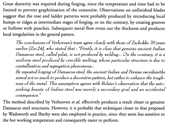

estcrh
estcrh's Avatar
Join Date: Jun 2012
Location: USA
Posts: 1,492
Originally Posted by Emanuel
I hope our forum smiths do chime in on this. If you polish and etch an old wootz cake/ingot you see the pattern. No forging required.
Emanuel, I have never seen an old wootz cake so I could not respond to this but what happens once you start forging this old wootz cake, you can not make a blade from a polished and etched unforged wootz cake/ingot, it needs to be forged. Are you suggesting that anyone can forge a watered steel blade from it or did it take specialized knowledge in order to do this?

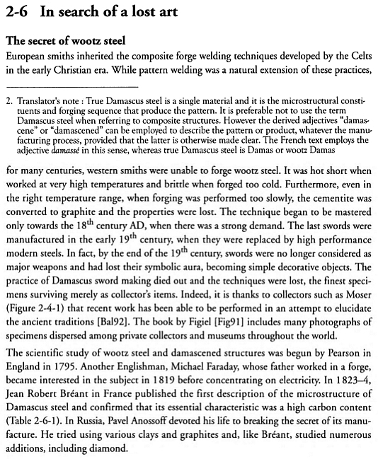

Microstructure of Steels and Cast Irons, Madeleine Durand-Charre, 2013

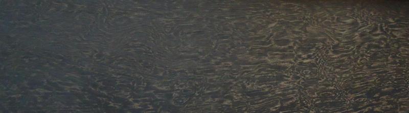

The issue of inherent ingot patterns and the final blade patterns was discussed extensively on a Russian forum with professional bladesmiths, including the "dean" of Rusiian blademakers, Mr. Leonid Arkhangelsky. According to them, there is no doubt that the inherent structure is important, but only a true master is capable of creating complicated patterns seen on Persian and later Indian blades.
Only Persians with their secret tricks of forging were able to create rich and complicated patterns like Taban or Khorasan.. Indian masters were using a different technique: their hallmark was the "salt-and-pepper" pattern in which dendrites were crushed into small spheroidal segments. After ~17th century there was an inflow of Persian masters into India, and the patterns of Indian blades switched to the complicated Persian examples. Syrian pattern is well-known as Shams: low-contrast, short, almost straight lines.
They all used the same Indian ingots, but the final results were different.
Why?
As bladesmiths told me it all likely depended on the technique of forging: turning the billet in a predetermined way to create twisted patterns of dendrites, keeping the pounding in the same position/direction for the Shams, or beating the hell out of it to obtain the Indian "crystalline" wootz. And on top of it, heating the billet to a certain color between forgings was also crucial.
Even on the same blade one can see different patterns: even the best Taban blades always have almost "shams-y" pattern close to the edge, the result of more vigorous pounding in one direction.
And that is what happens now: metallurgists can make beautiful wootz ingots with a pattern indistinguishable from the old Indian ones, but the bladesmiths do not have secret "protocols of forging" that were worked out over multiple generations by Persian masters.
Anosov figured out how to make wootz ingots, but his blades had coarse and simple pattern: he did not know how to forge his material.
And that is the real secret of wootz.

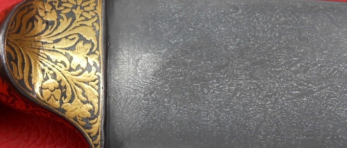

Anosov shoud be honored for his re-discovery of the process of obtaining raw wootz material and his insight that it should be forged at low temperatures. However, he simply did not have access to the old "recipe" of forging complex patterns ( akin to Taban/Khorasan). In his defence, only one of the contemporary wootz smiths is capable of doing it, and doing it with long blades.
There is a lot of information on Anosov's blades in the new book by Kirill Rivkin. He also characterizes them as pretty simple .

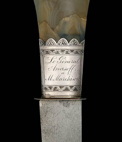

AFAIK, his blades were never produced for mass use or export; he made only a few examples. I am unaware of his blades being used as fighting implements anywhere in the world.
He published his report in 1841, but was transferred as a governor to Tomsk in 1847, where he could not continue his work.
After his departure production of bulat in Zlatoust has stopped: his instructions about the process were deliberately brief and incomplete. A couple of workers in Zlatoust who actually did the job, produced a small number of blades, and then it was just like in India and Iran: skill transfer stopped and the secret was lost again.
As an example of Anosov's bulat ( wootz) work, here is his famous hunting knife that he presented to British geologist Murchison who visited Zlatoust.
It was sold at Sothebys (?) for something like 50,000 GBP ( I might be wrong here, but the sum was obscenely high)
Another one is his shashka: look at the pattern, pretty coarse and simple.
It is bulat, no doubt, but in the best possible case it is Sham.

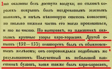

I do not support reading popular magazines and books published today. I prefer to read historical sources. So I read Anosov and what he wrote about his work. I think there is no doubt in the words Anosova?
I understand that many in the forum do not speak Russian, so I give the translation, the selected phrase:
1) etching on the plate (wootz) were large curls (tracery), "Kara-Khorasan". Another experiment was repeated with a simple iron. The same result was obtained. Resulting in a small plate wootz was also a "Kara-Khorasan".
2) Get the "Taban" (think about it, "Kara-Taban") with medium curls (tracery) and a dark background.

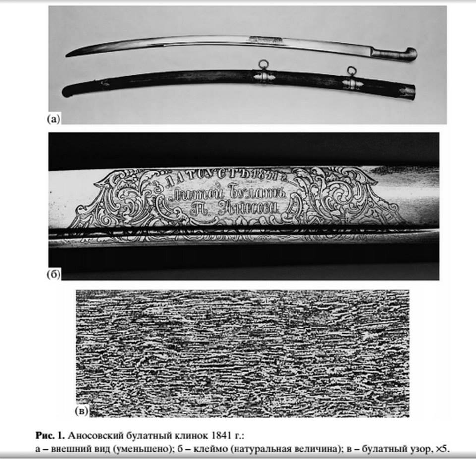

I showed pages of authentic books Anosov of wootz (1841). I hope no one will argue that Anosov - written with no errors? (He understood the wootz) At the same time, I did not say that did not Anosov damask blades of Wootz steel such as "Sham". There were more than other blades. But did Anosov and "Kara-Khorasan" and "Taban".
On one blade of the "Kara-Khorasan" had 10-20 blades from "Sham". Can someone show 10 blades Anosova? I think the analogy is clear? Blades Anosov save too little. But Hermitage has blade Anosov of wootz steel "Kara Khorasan". Anyone can go to St. Petersburg and look at this blade.

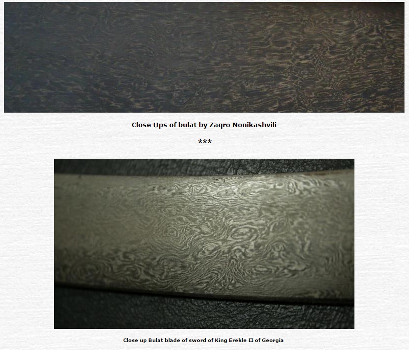

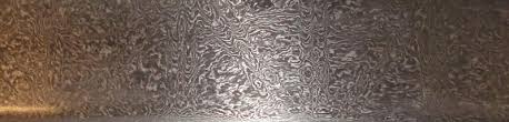

Old 22nd February 2016, 10:45 PM   #140

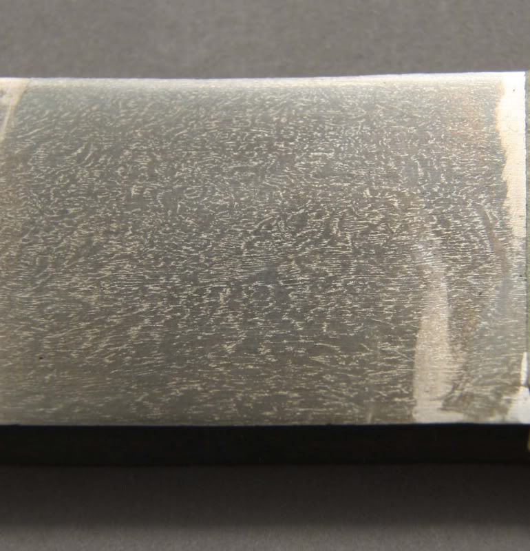

The REAL modern wootz!
I give you examples of bulat blades by a Georgian master Zaqro Nonikashvili.
Last edited by Jim McDougall; 23rd February 2016 at 12:02 AM. Reason: confrontational wording

Simplistically then, we're discussing a base dendritic pattern in a high-carbon steel that is the result of the metal smelting process, through more or less slow cooling of a crucible charge heated to mostly liquid phase.
This is followed by a mechanical deformation of this pattern through the forging process, either by fullering, or grinding/cutting grooves into the blade. The grooves are flattened, resulting in the
Mohamed's Ladder pattern. The same fullering process would be used on a homogeneous plain steel blade, you just don't get any pattern.
I guess the original Ladder pattern was simply the by-product of the drawing out process of the cake to a bar that could become a blade. A fuller may have been used at first to move the metal, while later grooves might have been cut into the bar on purpose to expose deeper layers and accentuate the patterns.
As far as I'm concerned then, Anosov understood the first step, producing the high-carbon crucible steel with visible pattern. He may not have known which trace elemental amounts were most effective at producing the darker contrast bands due to the technical limitations of his age.
Whether or not Anosov replicated the precise mechanical deformation in the second step is irrelevant to me. Modern smiths now understand both steps pretty well. Does the "secret" of whether you should strike the blade 40 times this way as opposed to 50 times the other way really matter?

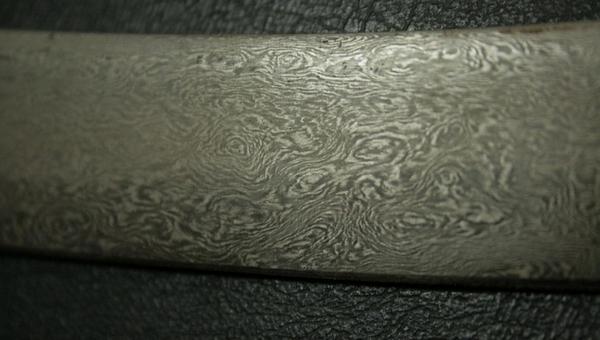

Here is a link to an excellent article which explains Zaqro Nonikashvili's "Georgian crucible steel technique".
http://ceroart.revues.org/2557?lang=en
estcrh is offline
Old 23rd February 2016, 12:55 AM   #145
Emanuel
Emanuel's Avatar
Join Date: Jul 2005
Location: Toronto, Canada
Posts: 1,242
Mind you, my comment is specifically about the kirk narduban, not the kara khorasan.
Thank you Ariel and Eric! Magnificent stuff!
Emanuel is offline
Old 23rd February 2016, 01:18 AM   #146
Indeed, magnificent!
Just to think that the guy managed to reproduce the most difficult wootz patterns without having any theoretical ( written) or practical ( apprenticeship) help.
This is a work of a true genius. He is a Mozart of wootz.
ariel is offline
Ariel,
I do not believe the top 2 images shown in above Post#140 are modern production. The lower image is more like it. I think the 2 above are closeups of genuine antique blades added for marketing purposes, as to show what wootz/bulat looks like, casually adding Zaqro Nonikashvili name into association.
ALEX is offline
Old 23rd February 2016, 01:45 PM   #149
ALEX
ALEX's Avatar
Posts: 936
Originally Posted by ALEX
Ariel,
... just to be clear on who's who.

Old 23rd February 2016, 01:54 PM   #150
ALEX
ALEX's Avatar
Posts: 936
here's closeup of a modern Indian-made Kard that can be picked up for under $200, and not the best by far. There are wootz(?) ingots with better "structure" readily available for less than $100. I do not understand what is the big deal with Russian geniuses creating unimaginable bulat masterpieces? Are they any different or am I missing something?
