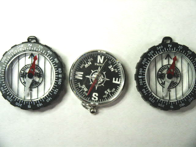

JENS
In an earlier post I stated that the tip end compass was pointing in the wrong direction, and I did not know why.
I think I have an explanation for the confused compass.
While I was doing the Case knife test that was suggested by FEARN I inadvertently got the compass to close to the magnetic knife holder and it switched the needle magnetic field, to where outside the house the needle pointed South instead of North.
I did demagnetize the compass using a demagnetizer and then re-magnetized it back to "normal".
The moral of this story is be careful with your compasses and strong magnetic fields from any source.
ANN

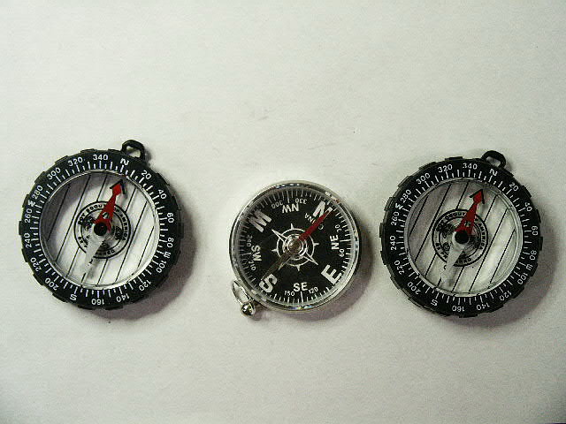

I have failed to follow up on my closing part of this great thread of yours.
I have no idea as to what effect if any the insulation of the hilt has on the weird magnetic properties of the dagger I call Mysore.
I also stated I would take some pictures of the reversed pointing compass (points South not North), caused by the strong magnetic field of the knife holder in the test suggested by FEARN.
The first picture shows the South pointing needle and the second one is after I demagnetized it and magnetized it back to normal and the third picture is the little demagnetizer I used for the process. The little hole is to place a blade of screwdriver into to make the blade magnetic.
I must commend you on this excellent idea you had on the question of "Magnetic Weapons". It was for me a great learning process and also great fun, a hard to beat combination!
I just hope you did not get to upset with me on my Southern kidding to you on the "hard questions" comments, I made, all in jest, all in jest.
You did good!

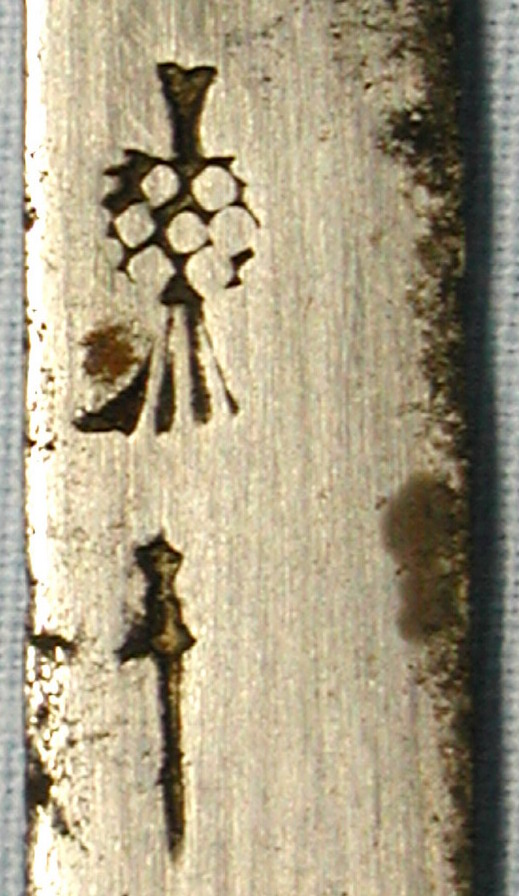

Hi Battara,
The katar shown has a funny history. I got it almost thirty years ago, in England I think, and a year or two ago I showed a picture of it to a friend, shortly after he came back with the following story, after having visited a friend of his, who has some books about English cutlers. They agreed that it was hardly an Indian mark on the little knife – but it could be English – so they started to look through the books: The small knife has a cutlers mark in the blade. The mark belonged to John Jencks, 1576-1625. He got his cutlers mark in London 1606-7. He was born in Blackfriars and died in the Tower of London. His mark was a thistle and a dagger.
For further study see: J.F.Hayward: English Cutlery. Victoria & Albert Museum, 1957. Masterpieces of Cutlery and the Art of Eating. Victoria & Albert Museum, 1979.
I forgot the cutlers mark.

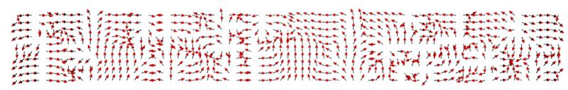

Attached is a numerically simulated magnetization in 15x2cm FeNi sample, rapidly cooled from Curie temperature.
a. The magnetization is parallel to the local direction of the magnetic field, therefore the paper and iron dust would procuce a similar picture if placed on top of this sample.
b. Equilibrium configuration is a result of such things as a competition between exchange and dipole-dipole interactions for a given shape.
c. The loss of precise magnetization is more or less a smooth function of temperature. Since Fe has Curie temperature of about 1000K (700C) it is not that noticable at the room temperature, but becomes an essnetial issue when you heat any sample to 500-600C. Initial magnetization, i.e. whether magnetized or unmagnetized iron has been used, becomes at this point mostly irrelevant.
d. The attached simulation was performed in the absence of external fields. Earth's magnetic field is truly irrelevant since it is extremely small; on the other hand the presence of other magnets like magnetized anvil and so on could have made the magnetization to be more uniform.
