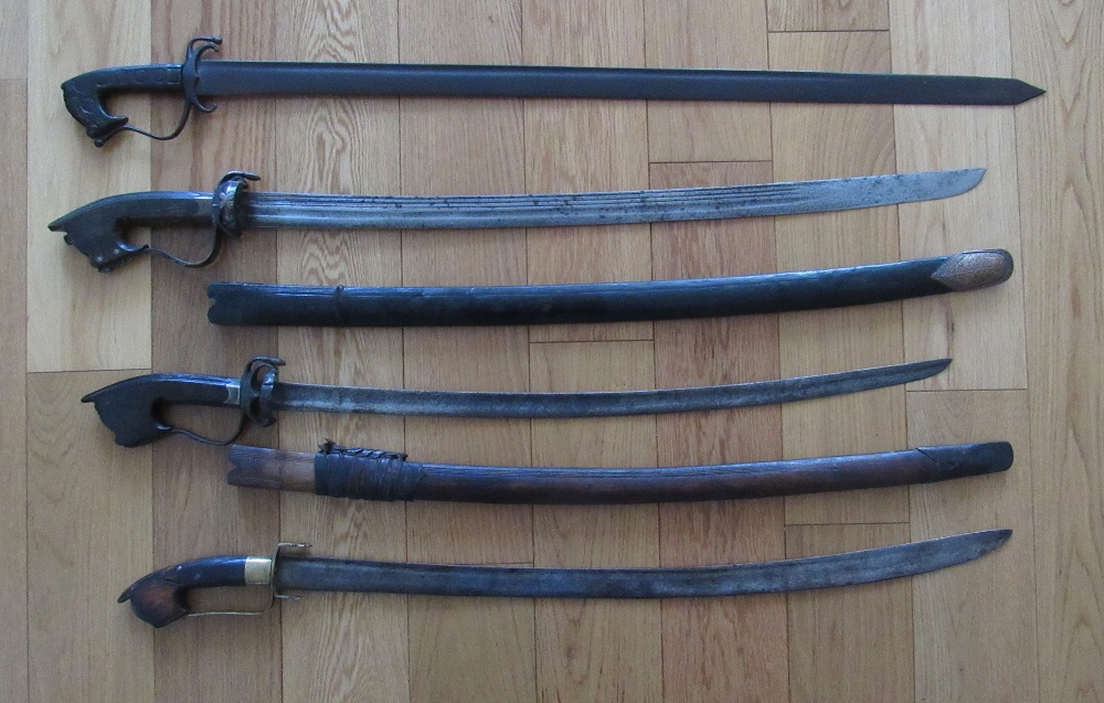

Wanted to add these three with notes:
1. This is what may best be called 'Maghrebi' as these are found from Algeria to Morocco, but typically they are known to collectors as Moroccan sa'if.
The mark at the forte is located in the same place as typically these are found on Algerian examples (Briggs, 1965). There are varied marks but significance unclear.
2. This is the so called 'Zanzibar' form, which term seems to have developed in the 80s and possibly from numbers of these which were apparently sent into Yemen from there. This was one of about 40 discovered in a Yemeni arsenal (?).

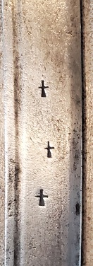

The markings of three crosses on the blade may be interpretations of German blade markings.As previously noted, Buttin (1933) makes no notice of these being peculiar to Zanzibar and terms them Arab sa'if only.
3. A sa'if of 19th c.(possibly earlier) Hadhramaut, according to Elgood and Lebedynsky, which may have silverwork from Hyderabad. There appear to be two hilt forms, the one with canted pommel and hand nock, and this more karabela form. Hadhramaut is of course a Yemeni region.
The pages are from Elgood ("Arms and Armor of Arabia" 1994) and Buttin, collection catalog 1933.

Wonderful grouping!! These are excellent examples of these sa'if of the Arab sphere. It is important to note that this does not mean 'Arabian' as in Arabia proper, but in the places where Arabs populate the regions, not meaning to get into ethnic discussion.
By the same token, the Moroccan example has long been known colloquially as a 'nimcha', by collectors, but overall, these are all simply termed sa'if.
These are likely 19th century but could be earlier, especially the one you note as Yemeni, which is actually more to the Hadhramaut regions (as described in Elgood, "Arms & Armour of Arabia".
Thanks! As it happens a copy of that book is on its way to me now from the US. Took me longer to find a copy of the book that I could afford than the actual sword! Look forward to reading it.
The example with extended crossguard ring has also been somehow classified in collectors circles as 'zanzibari', however in Buttin (1933) these are noted as Arab sa'if, with no mention of Zanzibar. Naturally these were present there, but by no means were they exclusively from there. It seems this classification appeared in a number of references in 1980s.
The blades on these are invariably trade blades, German of course, and the blades are typically early 19th c. These were most typically acquired from Bedouin traders by armorers mounting blades into hilts in locations often in Yemen. With the Moroccan examples (which were often Algerian as well) these were mounted with trade blades, and armorers often added the 'sickle marks' approximating the so called 'Genoan' marks.
The straight blade on the 'Zanzibar' example is of a type of trade blade usually into Ethiopia late 19th c. which usually ended up traded into Yemeni markets. These were often mounted in Yemen on silver hilts of a different form. Ethiopian swords often went into Arabia as the Arabs were after the rhino horn typically on the Ethiopian shotels for their kahdjhar daggers.
Ah, very interesting. I thought there might be a connection to the Omani kattara (although the tip on the Zanzibar is not as rounded), and I knew a lot of the Moroccan blades are European, but I hadn't made the link between the straight bladed Zanzibar saif to the Ethiopian market. The straight bladed gurade swords I've seen usually have different styles of fullering.

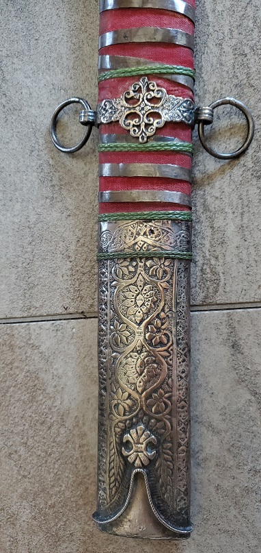

EDIT: And to add, I really like how that red contrasts with the silver on that karabela's scabbard! You see that on Dha scabbards sometimes as well.

Interestingly, the Omani 'kattara' (another collector oriented term, these are simply termed, again, sa'if). The curved blade version of these open hilts of somewhat flattened cylindrical style are actually the 'kattara', and these are usually with German trade blades.
The open hilt broadswords regarded as kattara over the years with the rounded tip are typically with very thin, flexible blades as used in the traditional dance ceremonies...however these were popular with Omani merchants and prominent figures as status aligned accoutrements, these often had trade blades.
In Burton (1884) these 'kattara' open hilt swords are noted as 'Zanzibar' swords, just as listed in Demmin (1877), however they are profoundly Omani and found in the Omani ruled Sultanate of Zanzibar.
Its great you have the Elgood book coming! It is one of the few references which direct us through the mysteries of Arabian arms, and Robert Elgood is one of the most tenacious and thorough researchers.
The Moroccan (Maghrebi) version of these sa'ifs indeed used all manner of trade blades. These have even been found with ANDREA FERARA broadsword blades and other European examples. These were long termed (incorrectly) 'nimcha' which has become a colloquially used term for them.
The 'Zanzibar' type of Arab sa'if as discussed, was present in Zanzibar in degree, much as were many forms, as this was a busy trade entrepot. However while there are some examples with motif distinguishing the Zanzibar location, others are simply corresponding to hilt forms known from western India into the Arab sphere. As noted, the trade blades into Ethiopia (then Abyssinia) often filtered into trade centers in Aden and Yemen. It is not surprising to see them on various type hilts.
The Ethiopian shotels with straight blades, like most of these trade blade variations had different fullering in accord with which suppliers were providing them. There were mostly British with many German types. Many of these blades coming into Harar to Armenian merchants were inscribed with Amharic inscriptions and Lion of Judah, so often Arabian swords from Yemen are found with these. The term gurade typically typically refers to European style stirrup hilt sabers provided into Ethiopian military strata.
Thank you for the note on the red over silver banding. Elgood notes this as a Hadhramati characteristic coming from swords mounted in Hyderabad India in accord with their mercenary forces active there. These kinds of styles found as far as SE Asia, and even Central Asia (Uzbekistan) are often found in the Indian subcontinent conduit. A distinctly Arab feature however in the silver work is the element known as the aghrab (=scorpion), which aligns with the evil eye superstitions.

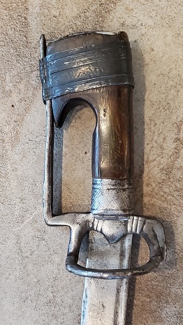

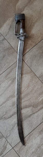

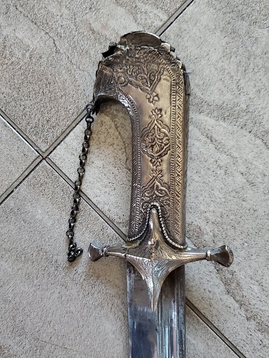

Werecow, this is a really nice Zanzibari, or probably more appropriately, East African saif. Great to see it complete with its wooden scabbard. It is interesting that these swords almost never have any blade marks.
I know nimcha refers to the overall sword size, but since I do not have a better word to describe this hilt type, I will keep using the term "nimcha" here. When it comes to the difference between Maghrebi, Arab and East African nimcha hilts, the shape of the grip and especially the angle at which the pommel is tilted is in my experience more important in determining the area of origin than the presence or lack of a guard ring. Some Maghrebi examples, especially earlier ones have a guard ring. Then there are some examples from Oman/Zanzibar and the Comoros without a guard ring at all.
Here are my few examples, of which the one with the straight, single edged blade has no guard ring and a sort of a "crab claw" like guard instead.

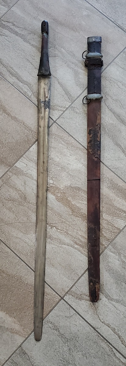

I think that's actually the first nimcha/saif I've seen with a backsword blade! Very interesting. EDIT: Actually, there are a couple on the first pages of this very thread! My memory is not great. }|:oP
I've seen a few of the Manding swords with straight blades as well. Sometimes it's easy to get them confused, especially when they are not the kind with the bulbous scabbards. Case in point:
Contrast with:
